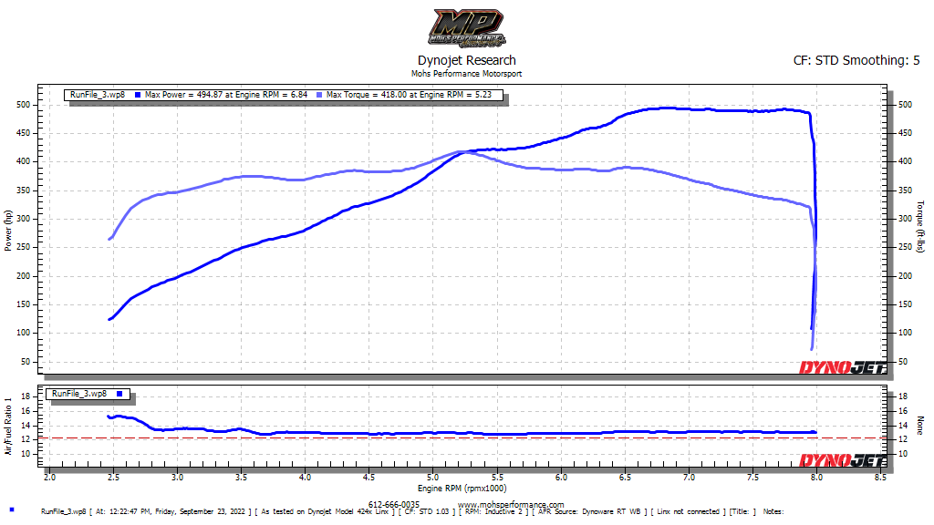

Yesterday I put my 2020 GT on the dyno (Dynojet).
Before I did the following mods, I dyno'd the car, completely stock, on 91 octane. It made 401 hp to the tire.
Then I decided to do a FBO mod package:
Stainless Power Headers
Steeda H Pipe
Comp Cams 433430 Stage 2 Cams
Ported CJ Intake with VMP Twin 69 TB
PMAS CAI
Lund e85R Tune
The car made 494 hp and 418 tq.
I'm not sure if I should be happy with these numbers. I've seen a few video and posts showing power in the 520ish range with this combo.
Thoughts and ideas from the experts here?

93 rear wheel from bolt-ons with cams and E85? I'd say that's pretty dang good.
As others said, don't look at the final numbers but more so the gains. That could be a stingy dyno, and I think it is as most people get a bit more than 401 stock. So on another dyno you could easily hit 520, but the overall gains would still be the same at ~90.

That is yesterday's session. I'll post the before when I can get it scanned.

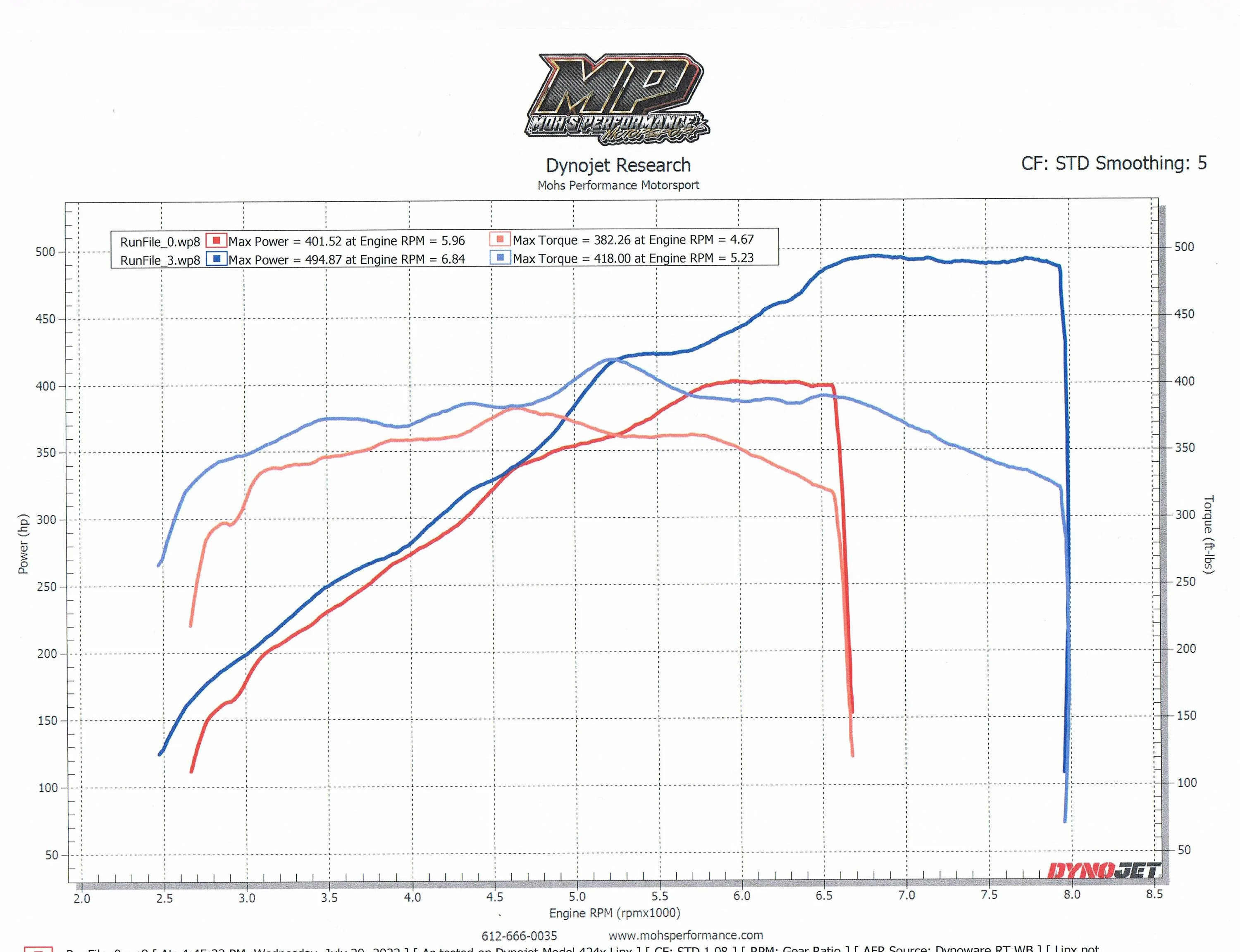

Seems odd that it falls flat at 6500. If you are thinking of another tuner, give Wengerd an email.
That's the stock tune with no mods. The blue is after the mods
93 more HP is a lot more power.
What others claim, is just that. What others claim.
I don't understand why your original dyno-pull was stopped at 6500RPM
