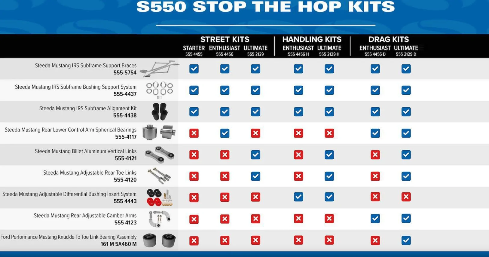

As far as suspension stuff, since you have updated springs, get the stop the hop kit from Steeda. That really stiffens up the rear and makes it feel more like it is on rails.

Every Mustang can use the Steeda 555-4455 Mustang 'Stop the Hop' Starter Kit (15-26), but since you're doing HPDE, you may want to grab an Enthusiast/ Ultimate Kit.
