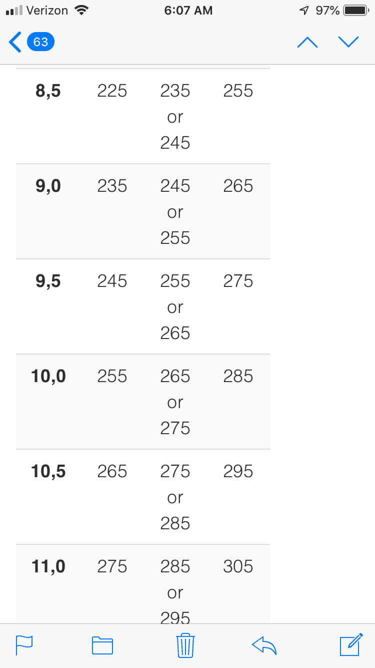

I, like you will be driving my Mustang GT PP2 all year long. With 19”x10.5/11” rims, and not knowing what to do, I grabbed inexpensive winter tires that were the smallest that would fit the stock rims. I found at tire rack a price of $225/tire for 275/35R19 Blizzak LM-32s. Better to go cheap and figure out what works. My thinking was to grab the narrowest tire that is listed to fit my rims. Based on the attached, I grabbed the 275s. The left column is rim width followed by min tire width, typical tire width and then max tire width. I am thinking that they may be a bit too wide but that was the narrowest I could go. To help, I plan on adding 100-200 lbs to the trunk to help
