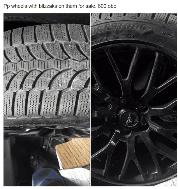

Just found these from a PP package GT. They already come with Winter tires. Would these work on my 15 Premium Ecoboost? I suspect they do work but just double checking before I go ahead and pay for them.

They should fit just fine, just make sure you put them at the right spots though. In case you didn't know, the fronts are thinner than the rears for the PP.
