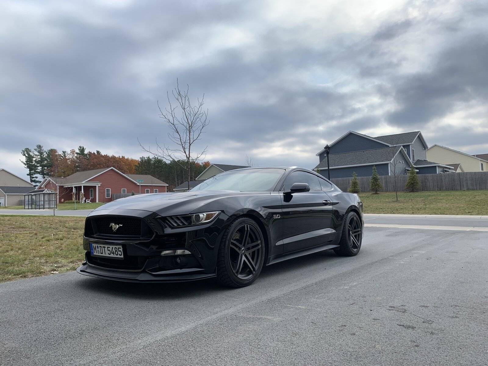

My winter 19s are very close to factory PP specs: 19x8.5F and 19x9.5R. I can’t recall the exact backspacing, but they are slightly more aggressive than stock (maybe an additional 10mm each).
Tires are 255/40/19F and 275/40/19R.
