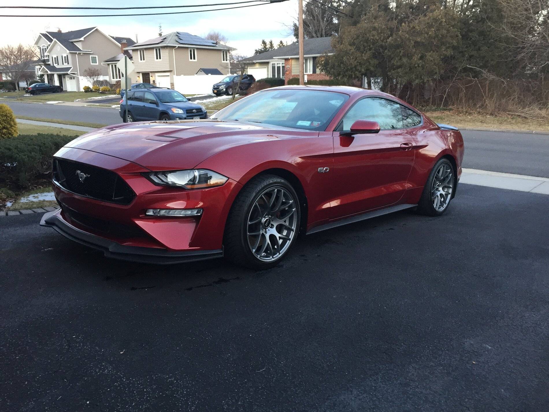

Just to post an update. My 275/35R19 have been pretty good in snow. I have even passed a few SUVs with all seasons that were slipping. Got really funny looks as I, a rear wheel V8 muscle car, passed them by with no signs of slip. I do religiously use snow/rain mode.
I decided to put the snows on a separate set of wheels. Since I already had the 275's, I used the chart to find the narrowest wheel that would still fit that tire. I ended up with the 19x9.5ET22 for the front and 19x9.5ET45 for the rear. I wanted to keep the offset as close to stock as possible. These wheels will allow me to go as small as a 245 or 255 if I so choose next time.

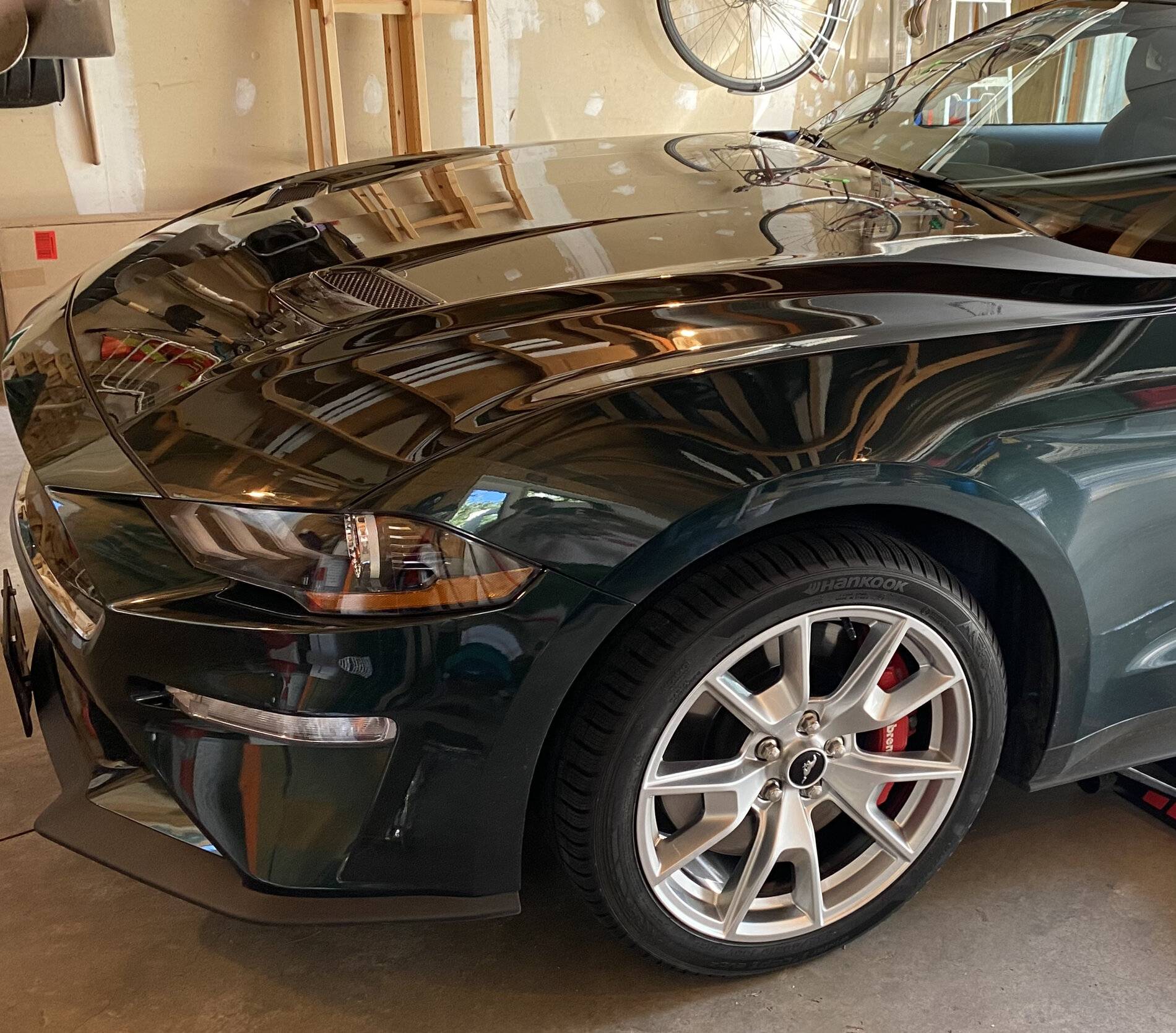

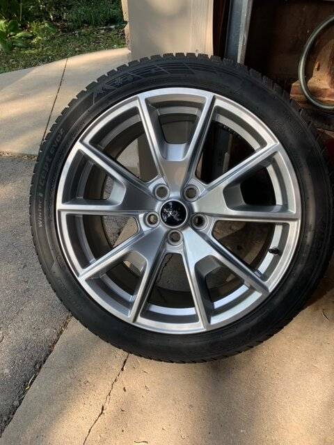

Anybody have experience with Hankook Winter I*Cept Evo 2 tires?
Picked these up together with the like-new 50th anniversary package wheels they came on at a really good price.
Online reviews for them are generally positive but can anyone tell me how good they are on a S550 Mustang?
Haven’t put them on yet, still another month or so before I do that. The pic of one of them on my Bullitt was taken when I was just making sure they would clear the big Brembos (they do).

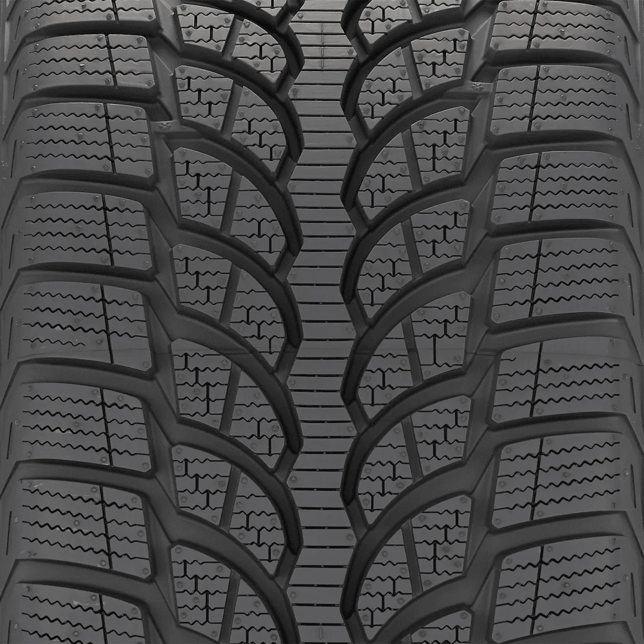

Below is the tread pattern of my Blizzak LM-32 tires.

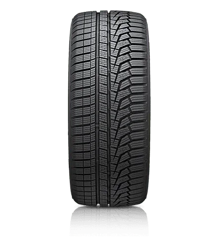

This is your Hankook Winter I*Cept Evo 2 tires
You can see, these only have a narrow section near the outside of the tire (right) that is designed for snow. I have to guess my Blizzaks channels are wider still than those in the snow section of your Hankook. The inner part (left side in picture) channels look rather narrow and might not do so well in snow. I would suspect this tire to be for performance driving in cold weather tire than a true all cold weather tire which includes snow and ice not just cold temps.
If it were me, I would go REALLY, REALLY slow if I am caught in snowy/icy conditions with the Hankook tire and avoid snow and ice at all costs with them if possible.
