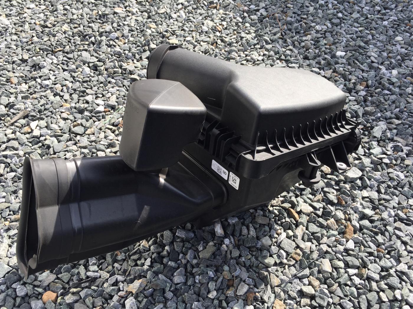

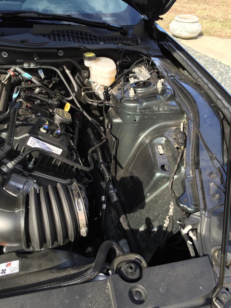

Orginal post updated with testing results! Today was a beautiful day here to work on the car! 65 degrees! If some are curious here is what the stock air box looks like out of the car.

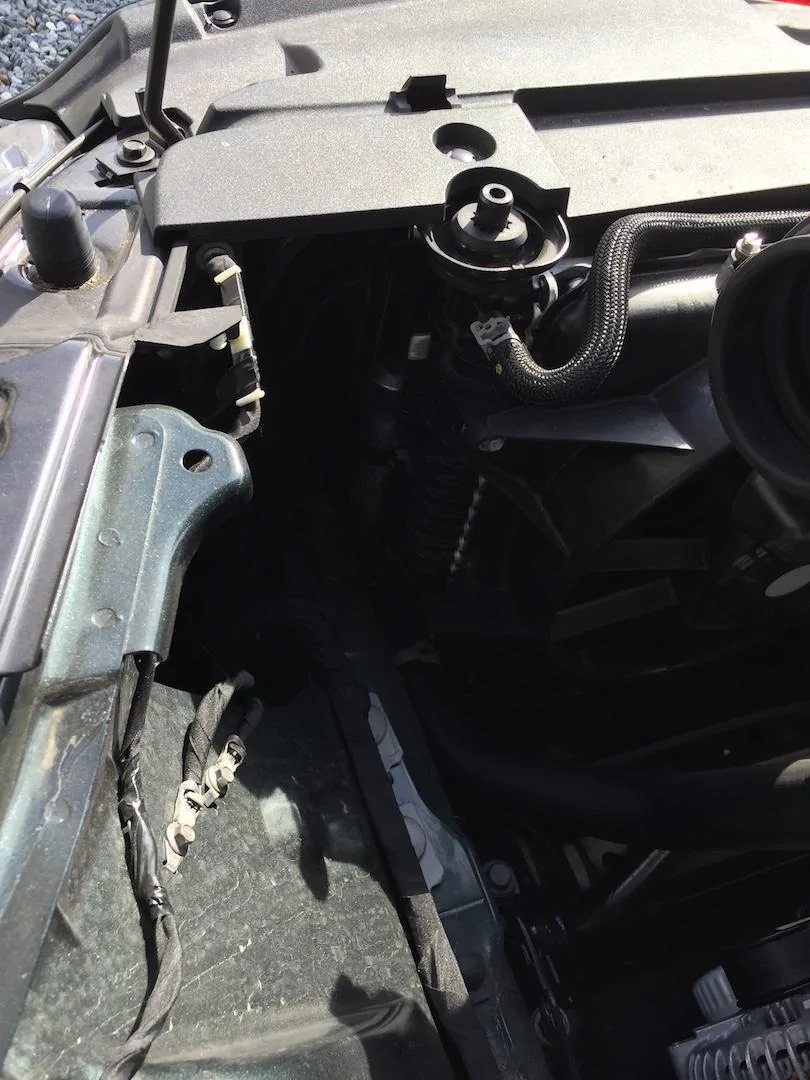

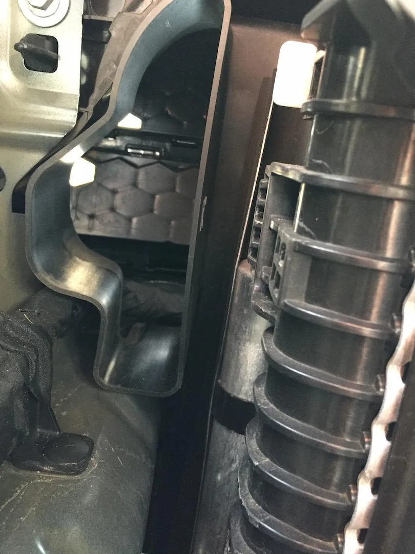

Because most of the filter body is inside the fender well I don't need my airbox. Basically the fender well now acts as the airbox for the filter. It does a decent job of shielding the filter from hot air from the engine and has a large volume of air entering from the grille area to feed the filter. To top it all off the filter is protected from water from all sides and from underneath due to the splash shield.
IAT's were tested with using the gauge mode in the instrument cluster. This was not the most accurate gauge of air temps but it was good enough for testing. Like I said before the temp sensor is most likely located in the MAP sensor itself which is in the middle of the intake manifold. So air temps read here will be heated from the engine itself and not reflect actual air temps at the filter inlet. I am not looking at the actual IAT's recored but rather the change in IAT's from location to location vs stock.
The K&N drop in filter will most likely not have any effect on IAT's as the airbox is drawing the same temp air in from just behind the grille. What the K&N filter does is increase flow through the intake.

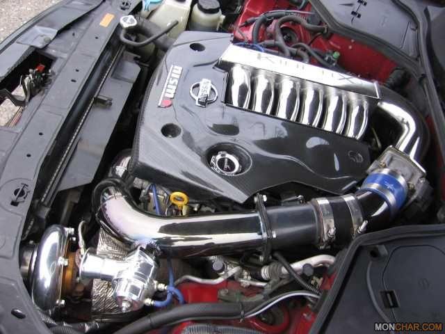

The sound will be nuts with all stainless tubing. I want a stainless intake manifold along with the air intake. I had such a setup on my G35. I find the engines are similar and the Cyclone would really fly with a turbo.

Thats exactly what I want! A crazy aggressive sound on acceleration!

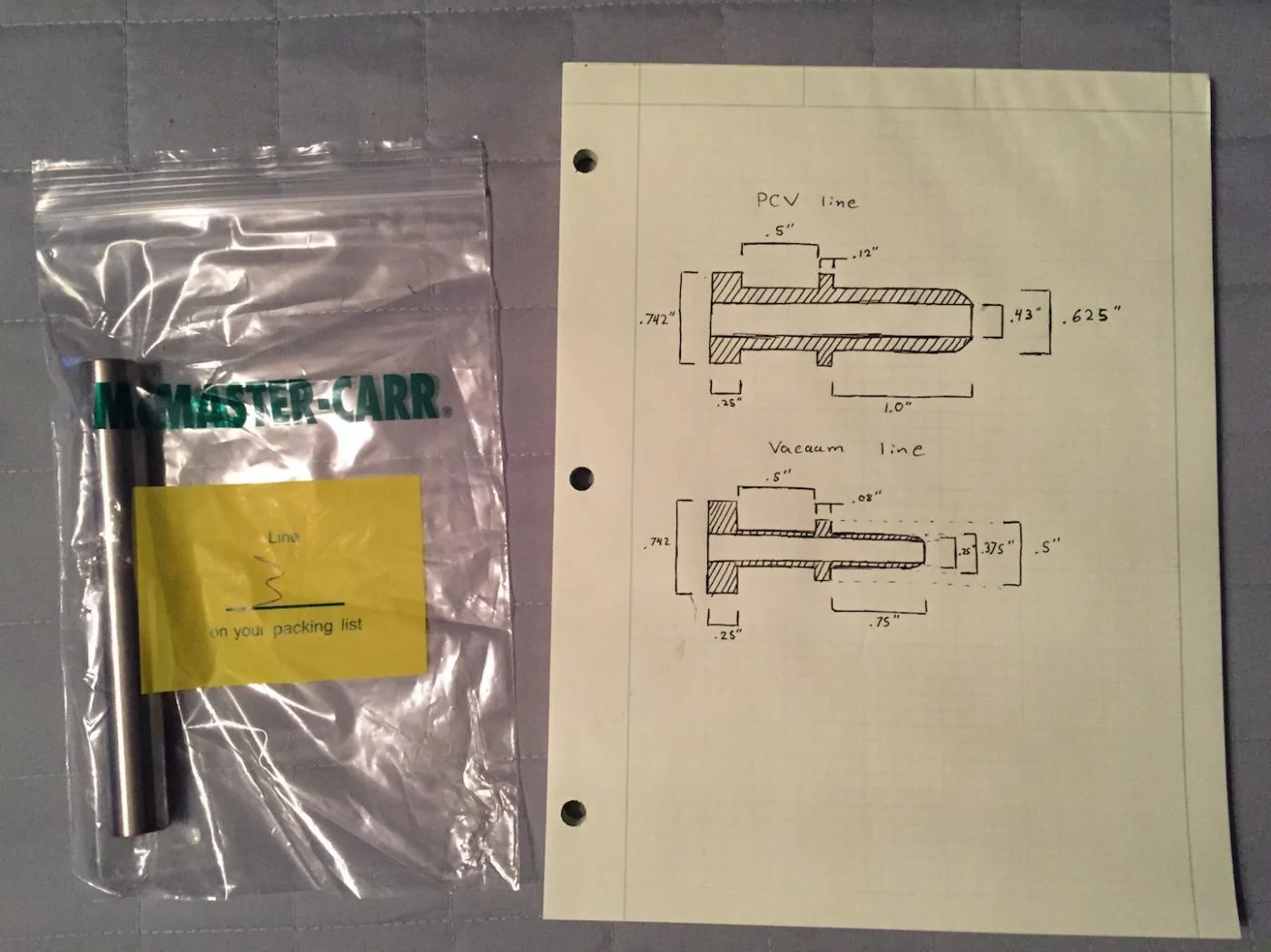

So not much is going on at the moment... Waiting on shipping yet again... I have purchased everything I need to complete the intake. The most notable update are the vacuum line connections. I got accurate measurements of the stock fittings to be able to reproduce them in stainless. By this time next week (hopefully) this 304 steel rod with the help of a lathe will become my new fittings!

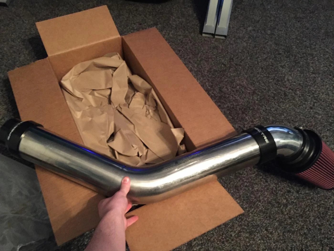

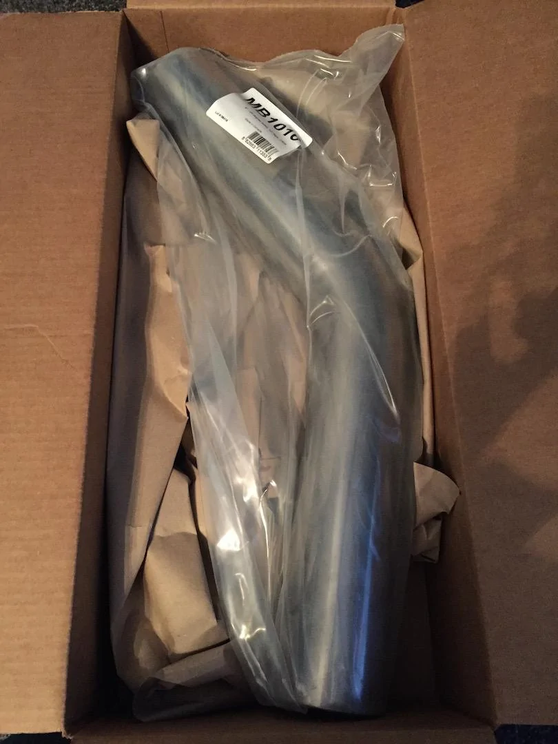

It has finally arrived.... Had to throw things together to see how it would look like! Obviously things are not cut yet so it will be much smaller when finished.
