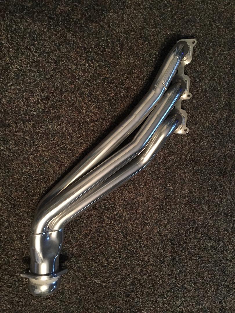

Well guys I think the LT headers are coming off... They provide an excellent power increase and with a pair of high flow cats I think they will be perfect! That said with my 6 being my daily driver I think I need to downsize to shorty headers. They should provide more low end which is what I am really looking for. Sometime this week or next I will be switching back to the stock manifolds while I wait to sell the LT's and get shorties!
So if anyone wants to take a stab at LT headers I think mine will be up for sale soon! If and when I do post them Ill be asking $320 for them. They are the ceramic coated headers to and not chrome!

What's wrong with long tubes?

Nothing with the LT headers specifically! They are just not quite fitting in with the sound I want to achieve. Shorty headers are the cheaper route vs buying high flow cats and will/should provide more low end power!
