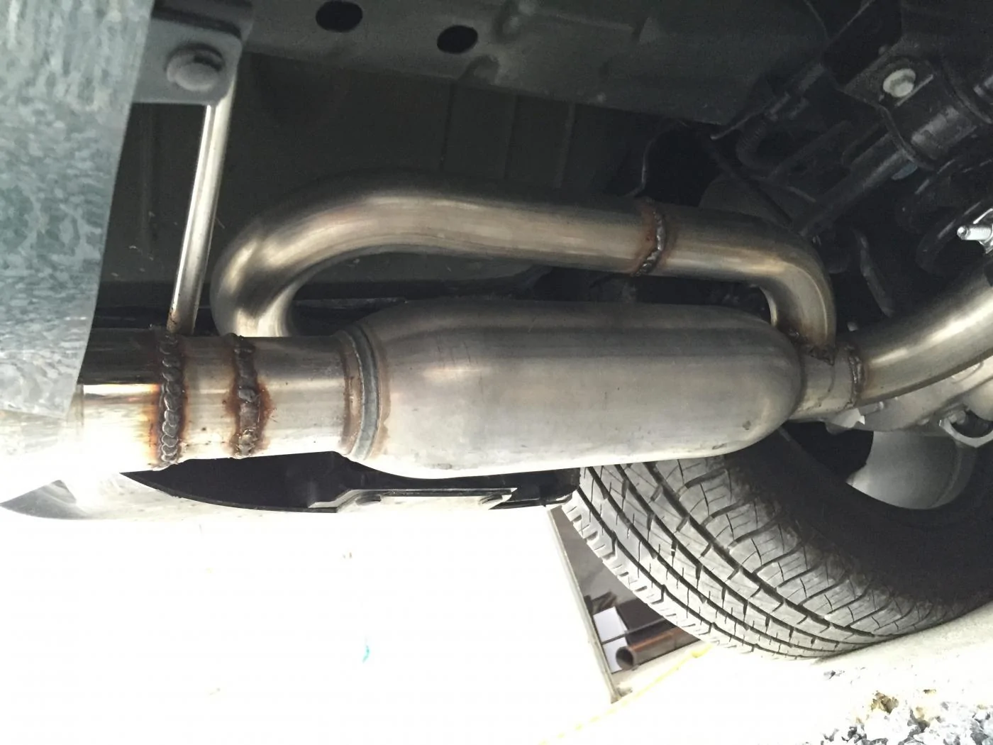

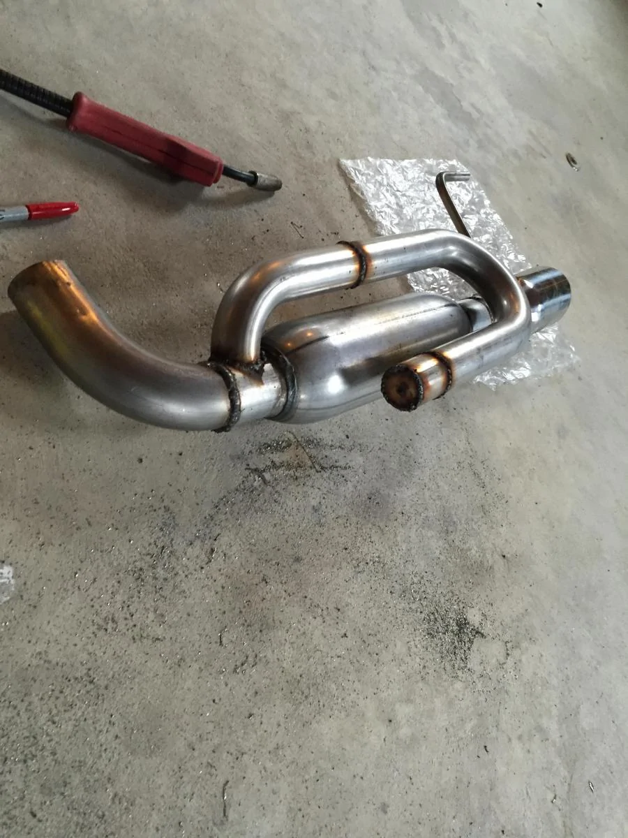

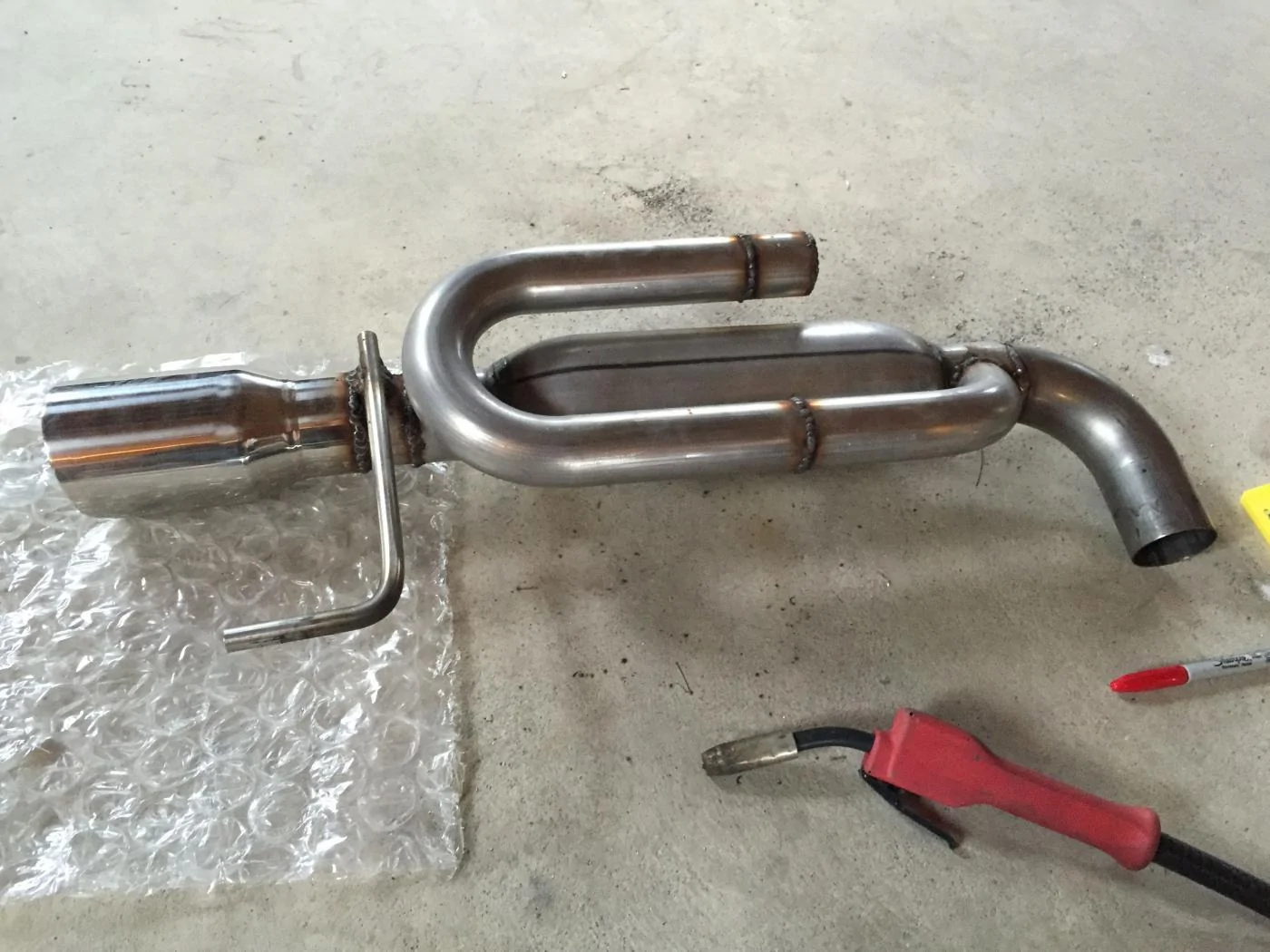

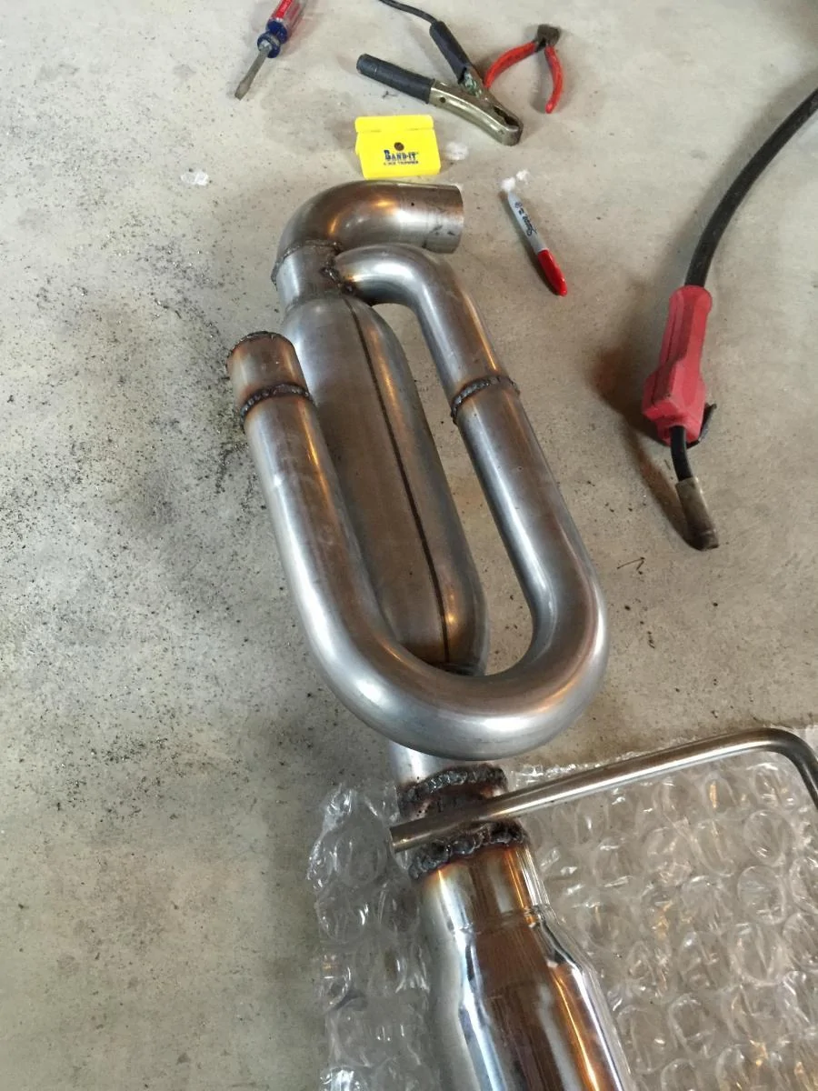

Drone situation update....
No more drone!!! My resonator idea worked! Eliminated drone by about 90-95% without effecting exterior volume. Pics of my setup below!
Ps: no making fun of my welds..! haha first time I have welded stainless.
