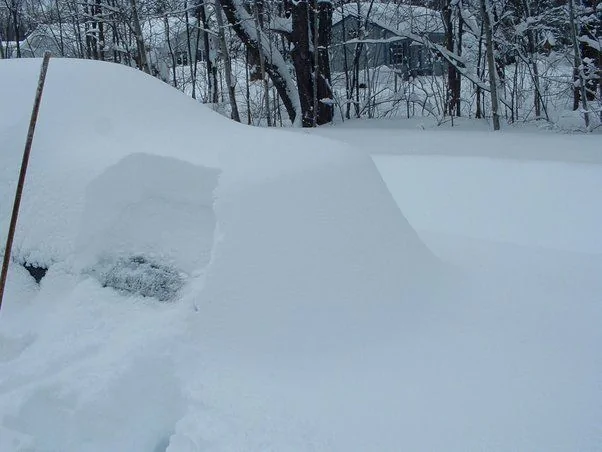

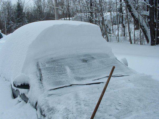

Water ingress and freezing aside, how about the weight? What if the car is nice and clean in the evening, you go to bed, and when you wake up in the morning and look out the window you see something like this?
Is the roof strong enough to withstand that kind of weight?
If you're ok that my most recent experience with multiple feet of snow on a convertible top was in 1978 (two back to back snowstorms that dropped about 3 feet of snow total), yes, the top is plenty strong enough to hold the snow weight.
