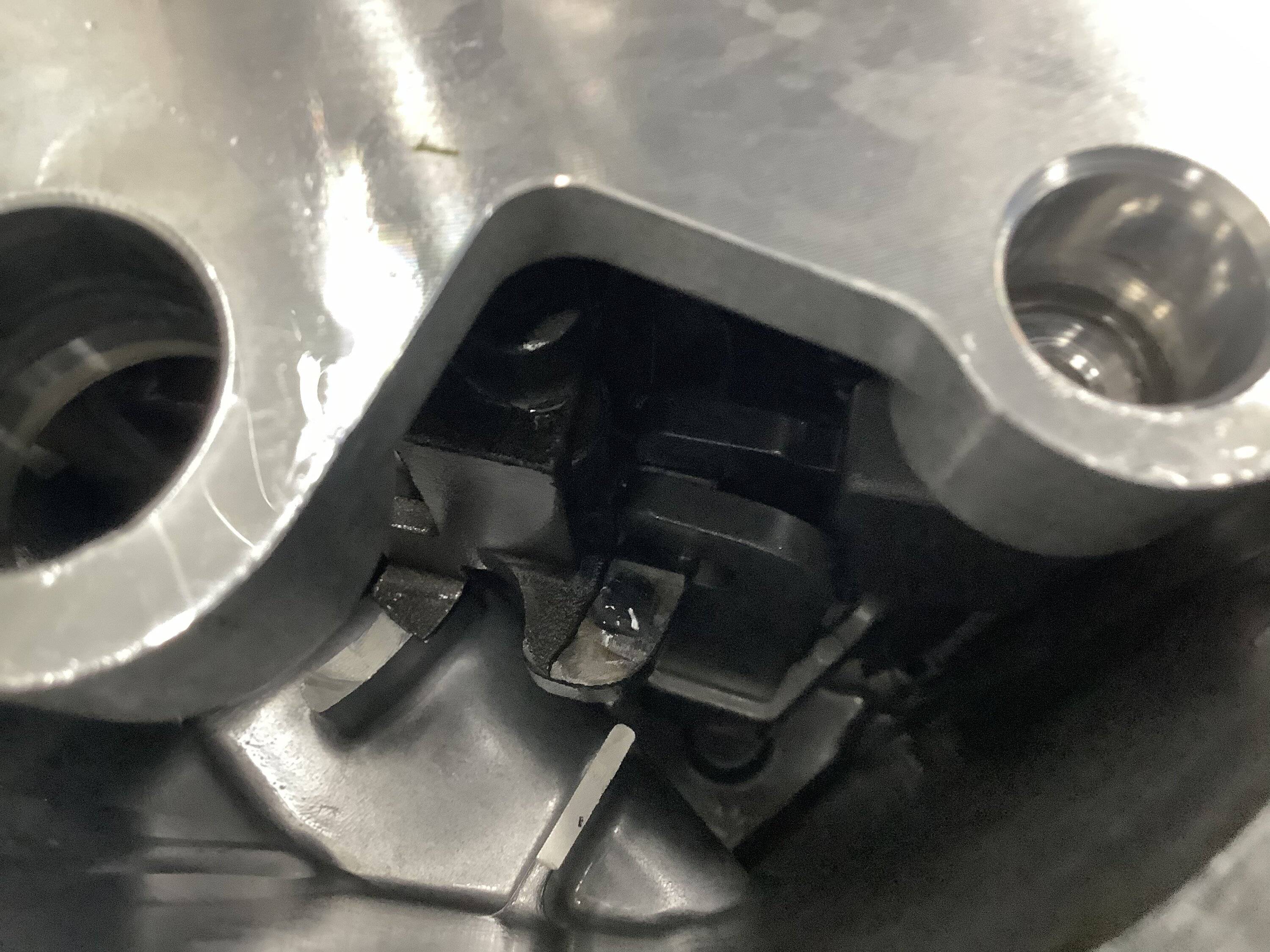

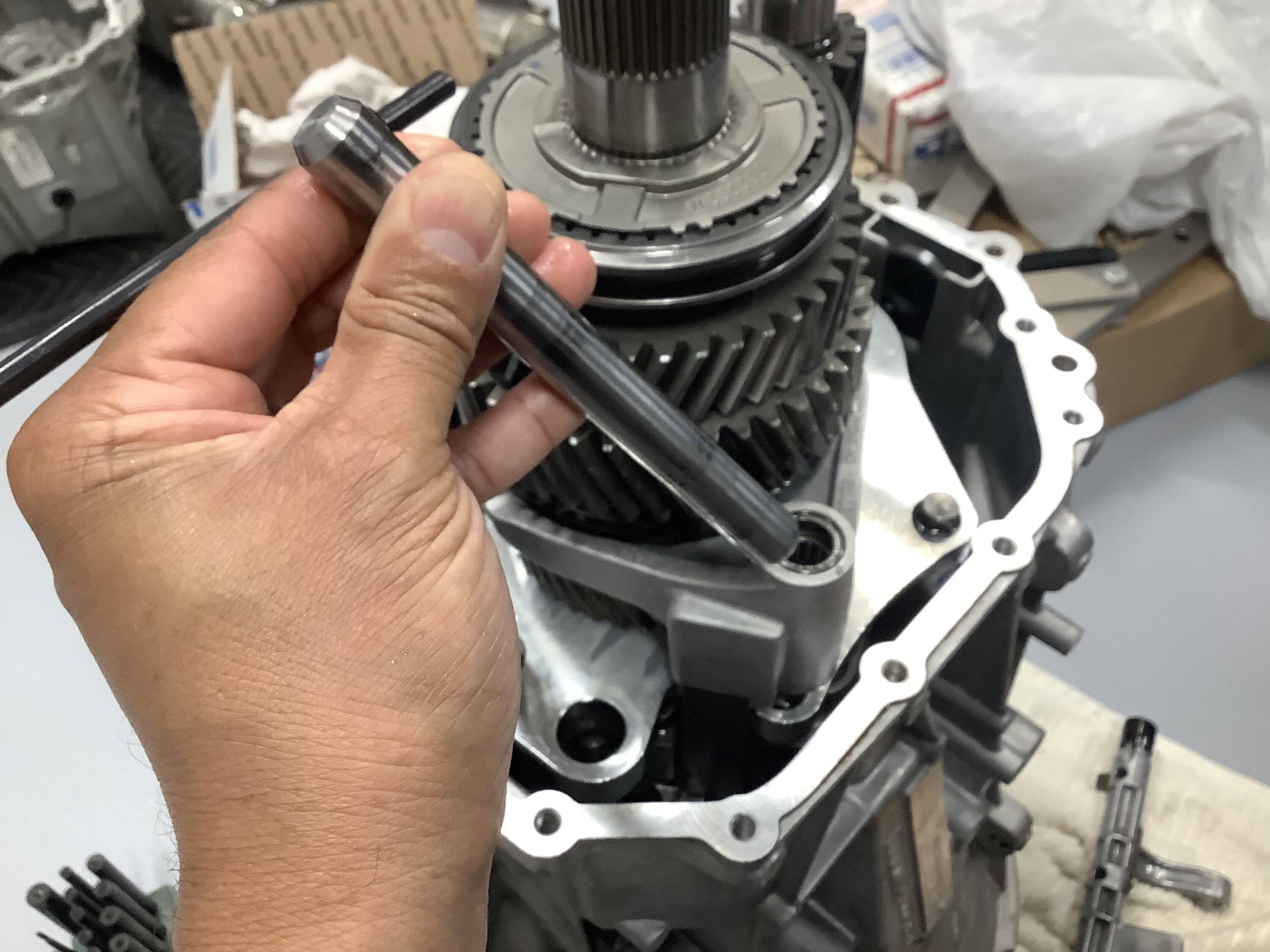

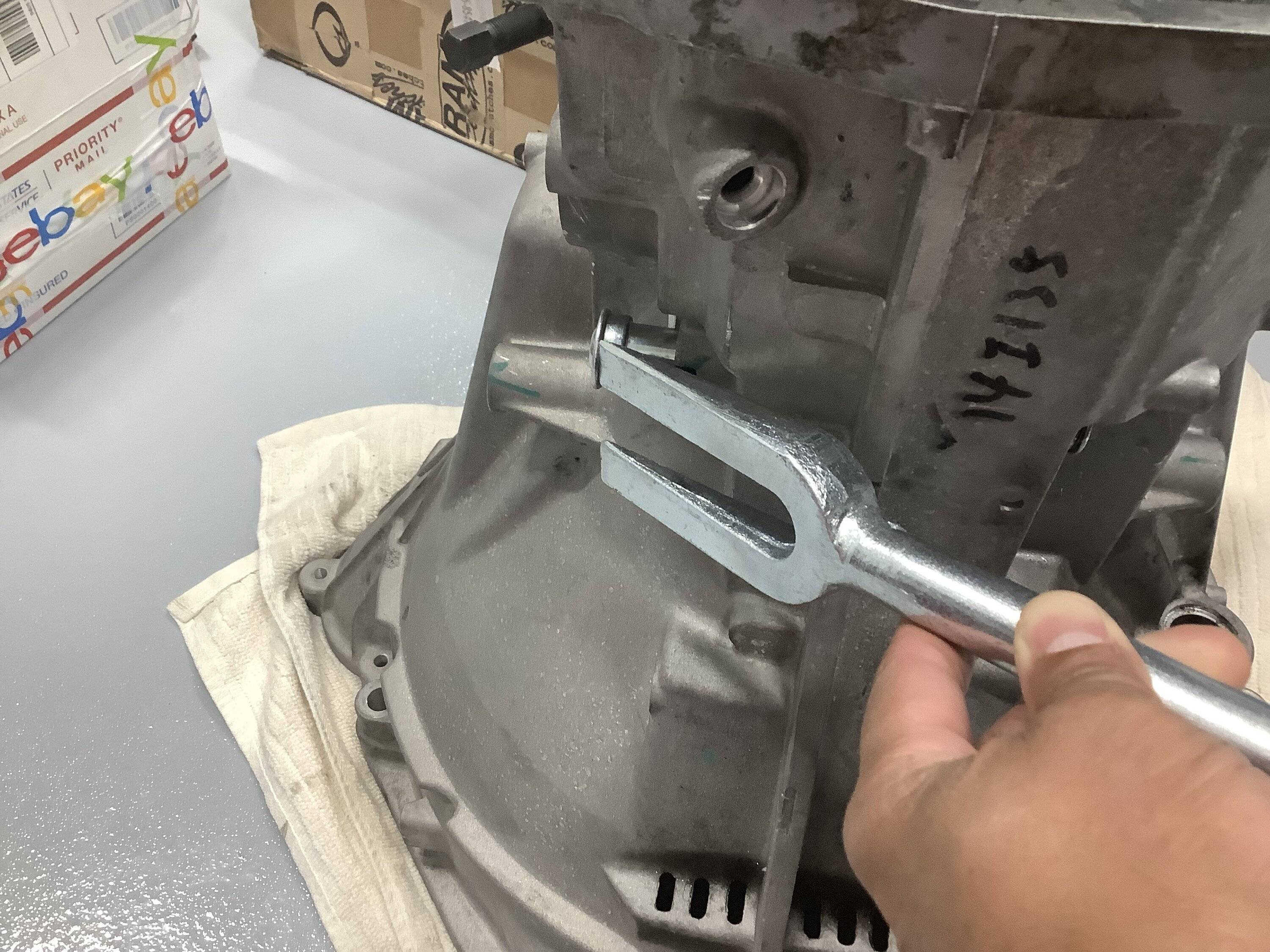

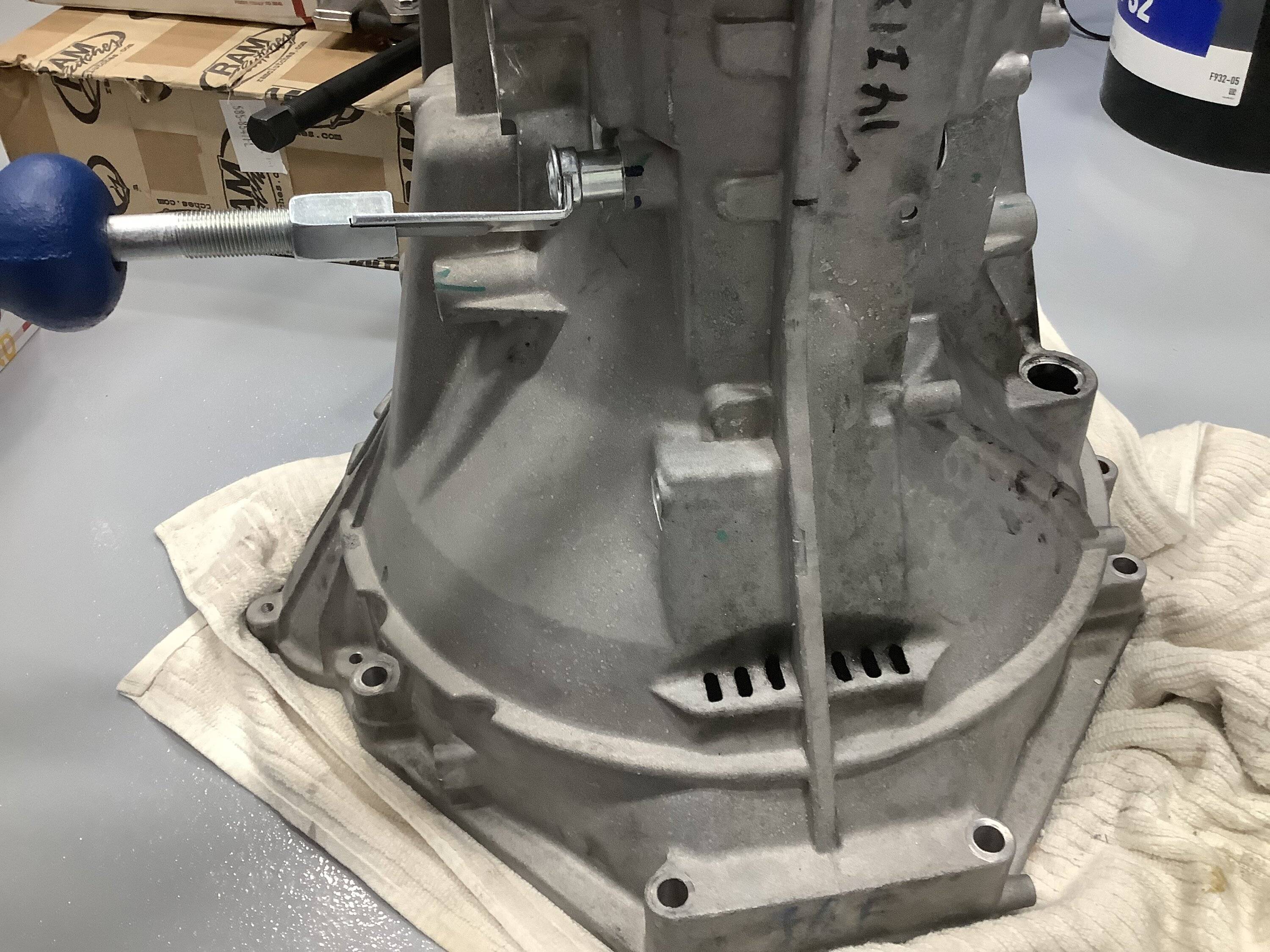

The two large detent pins have proven to be a huge PITA to remove. I managed to remove one from the right side of the casing, using a combination of a modified slide hammer adapter, a half shaft removal tool and a 5 LB hammer. By the time I got to the left side, my modified slide hammer adapter was rendered useless from the beating it had taken on the right detent pin.
I located another Detent Removal Tool online and they want $282 for it. Ridiculous pricing!!!
https://www.freedomracing.com/308-812-detent-remover.html
I continued searching and found another used one (different brand) which looks almost identical to the expensive version, so I ordered it. Weā€˜ll see how things shake out once I receive that tool in a few days. Hopefully this will do it, as I can’t see spending almost $300 for a tool that may only be used once.

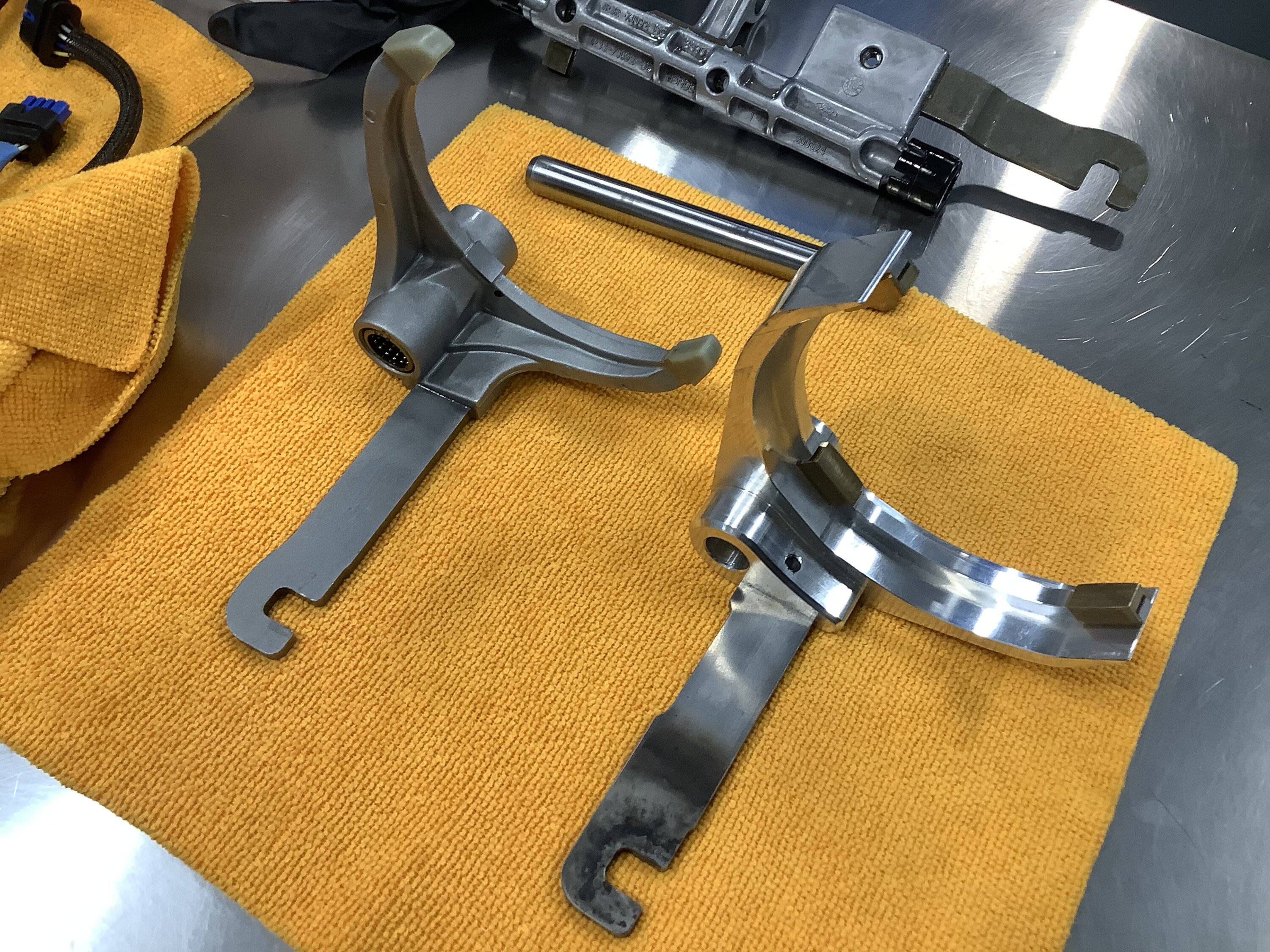

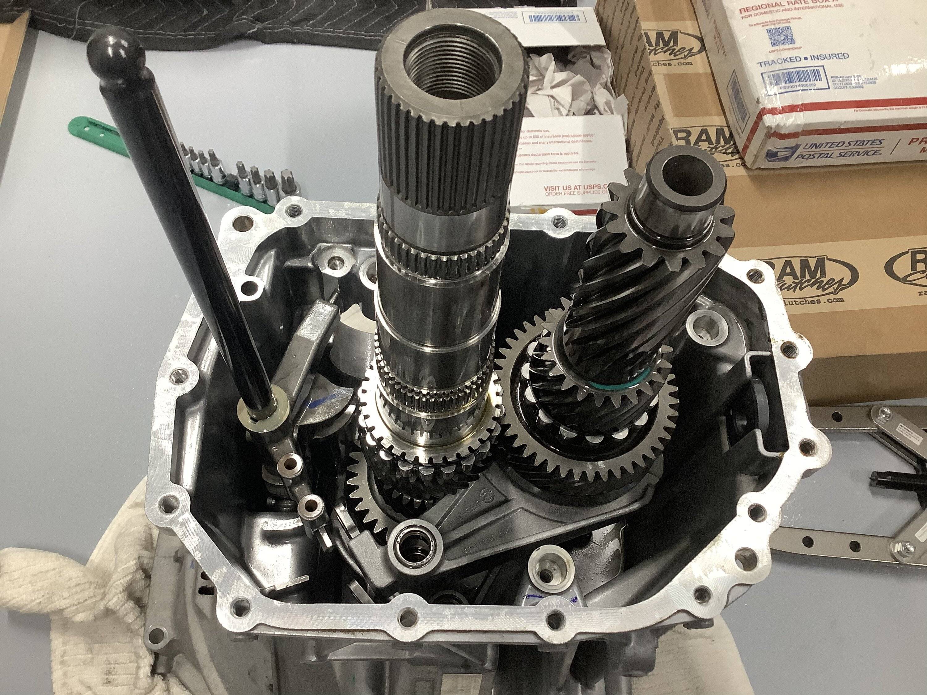

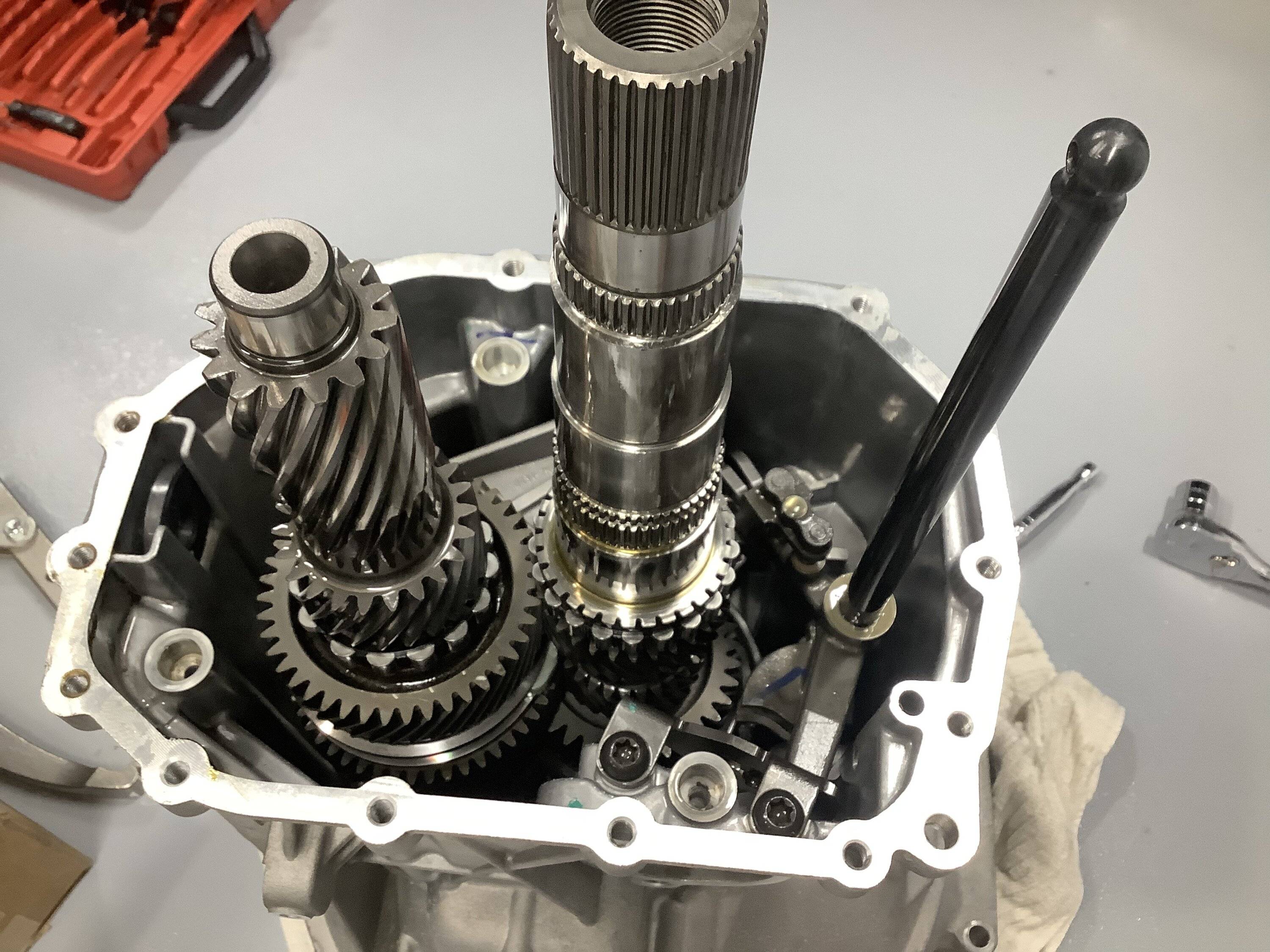

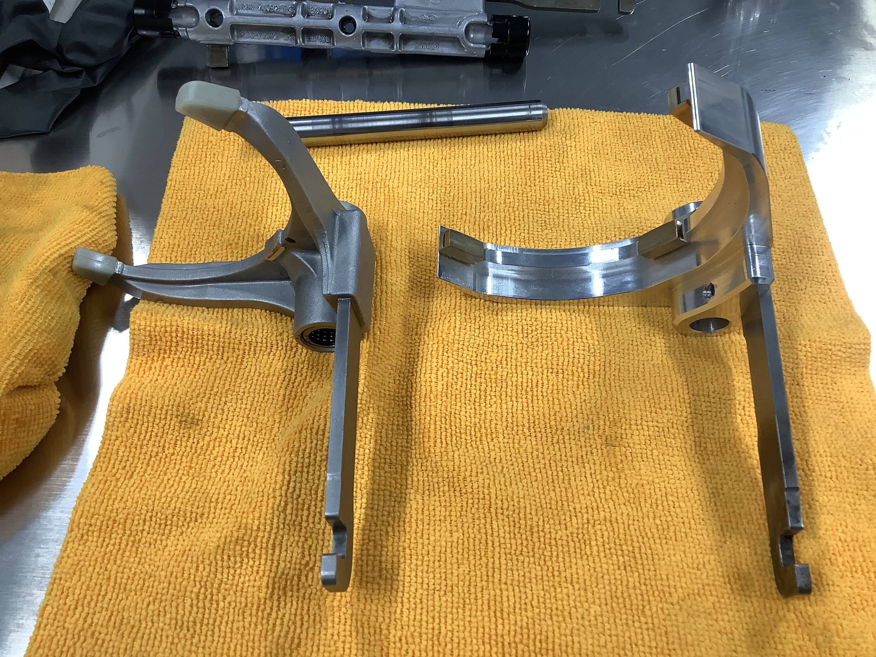

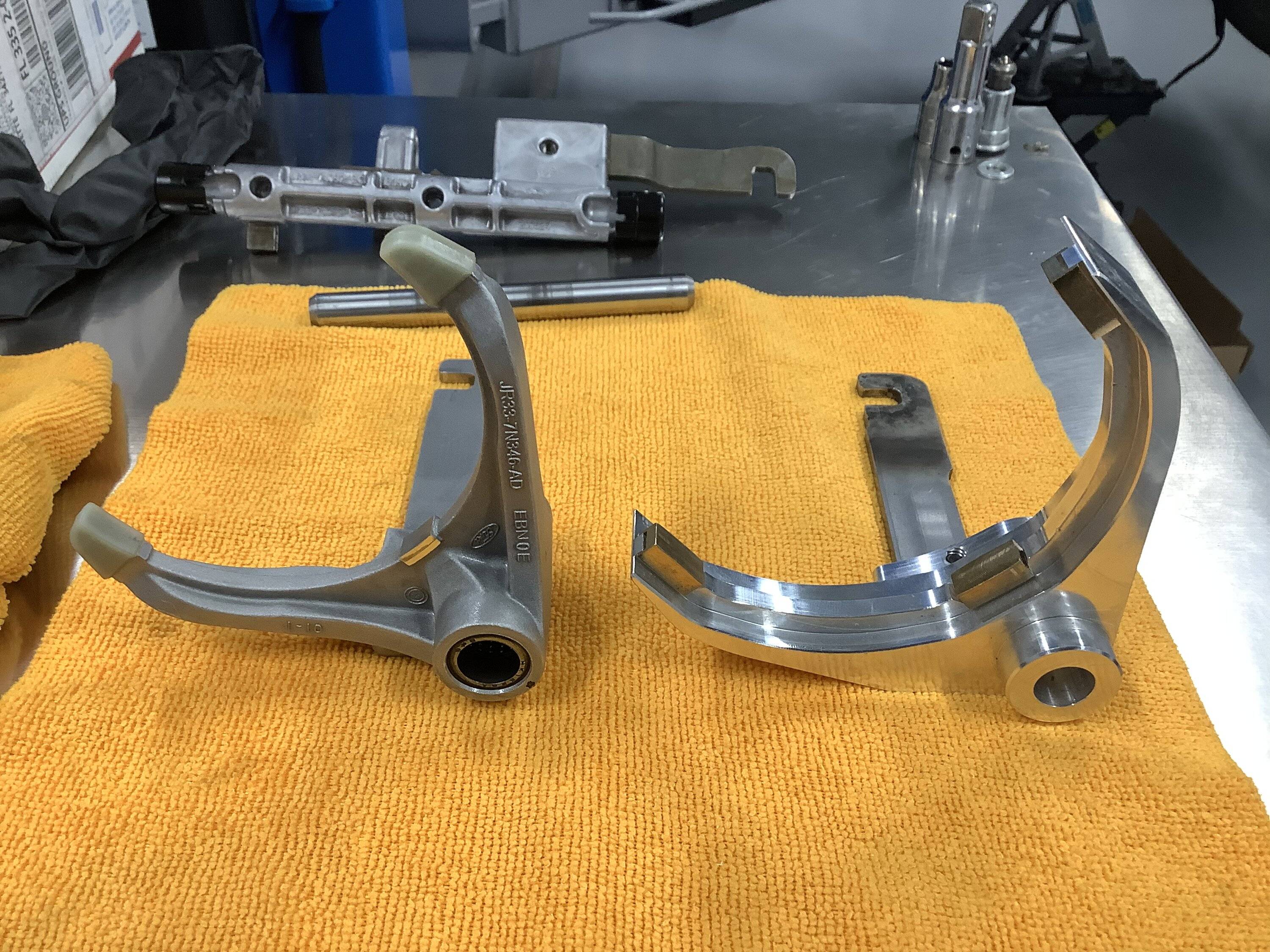

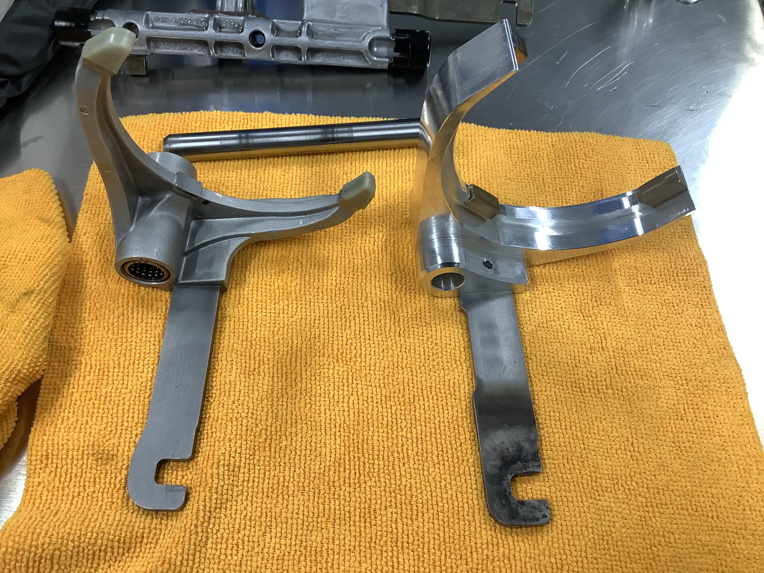

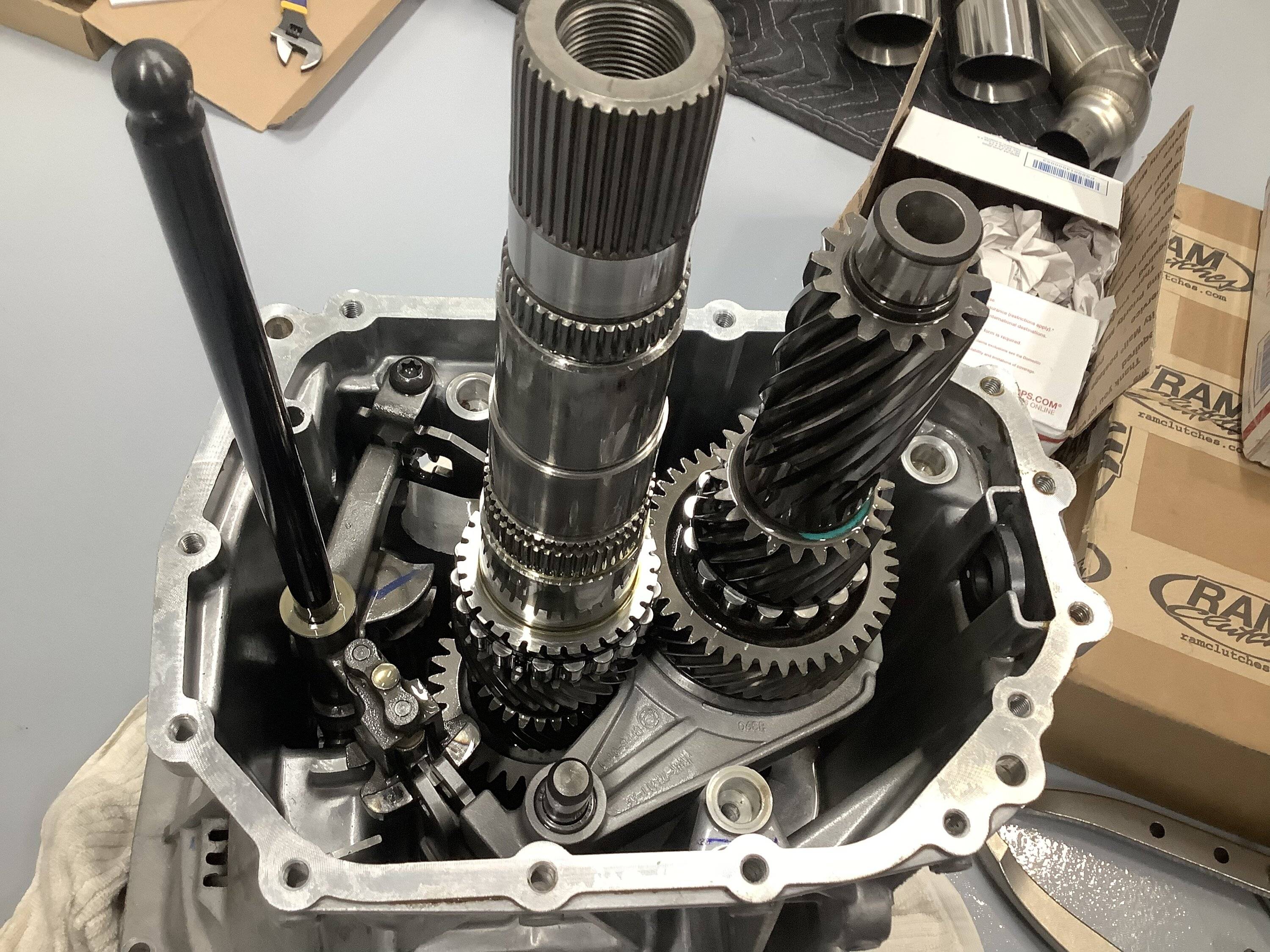

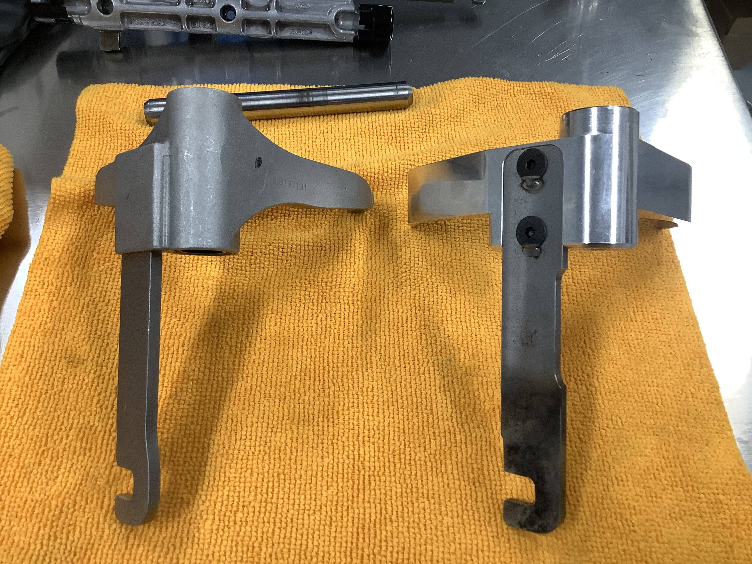

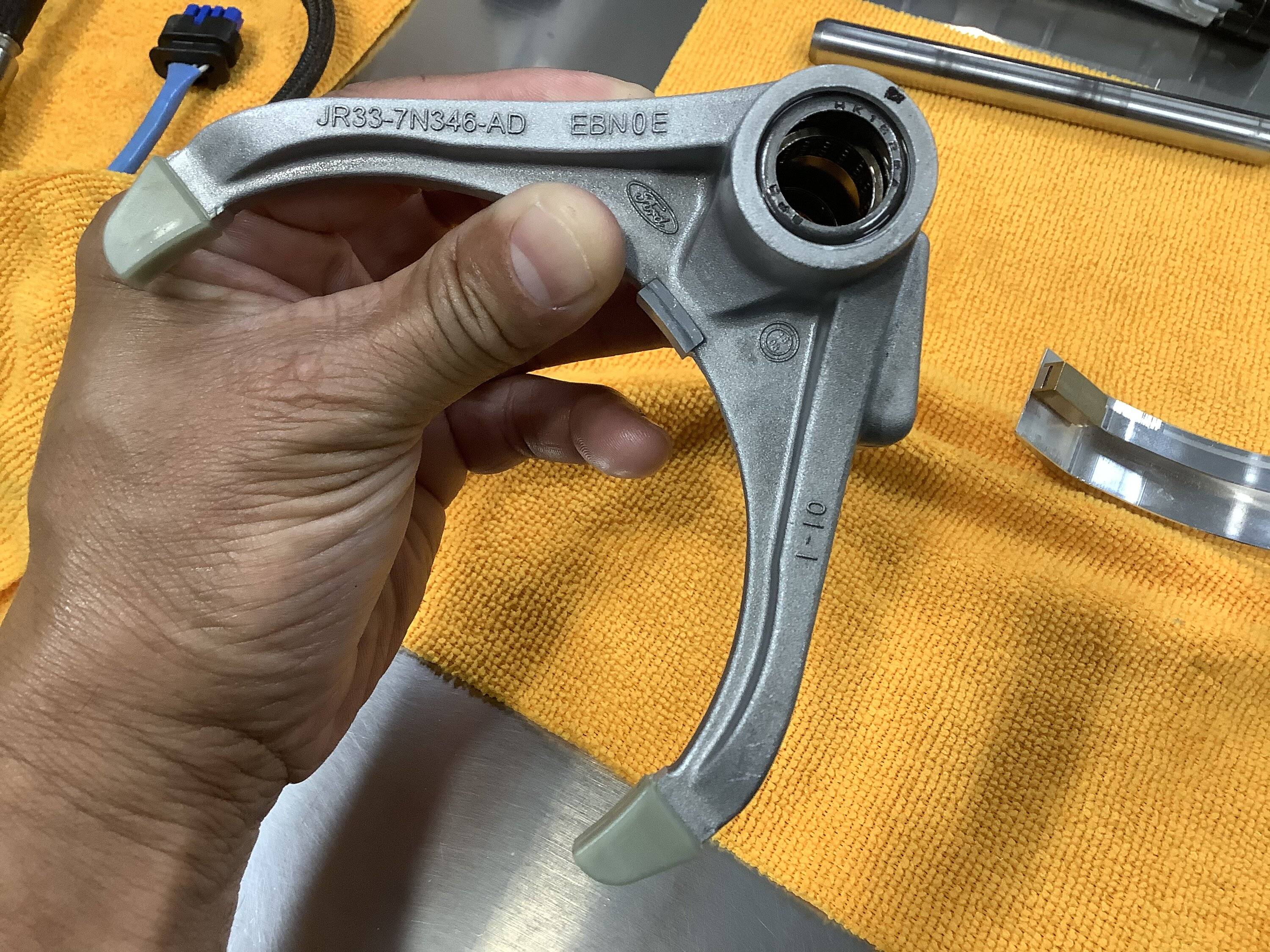

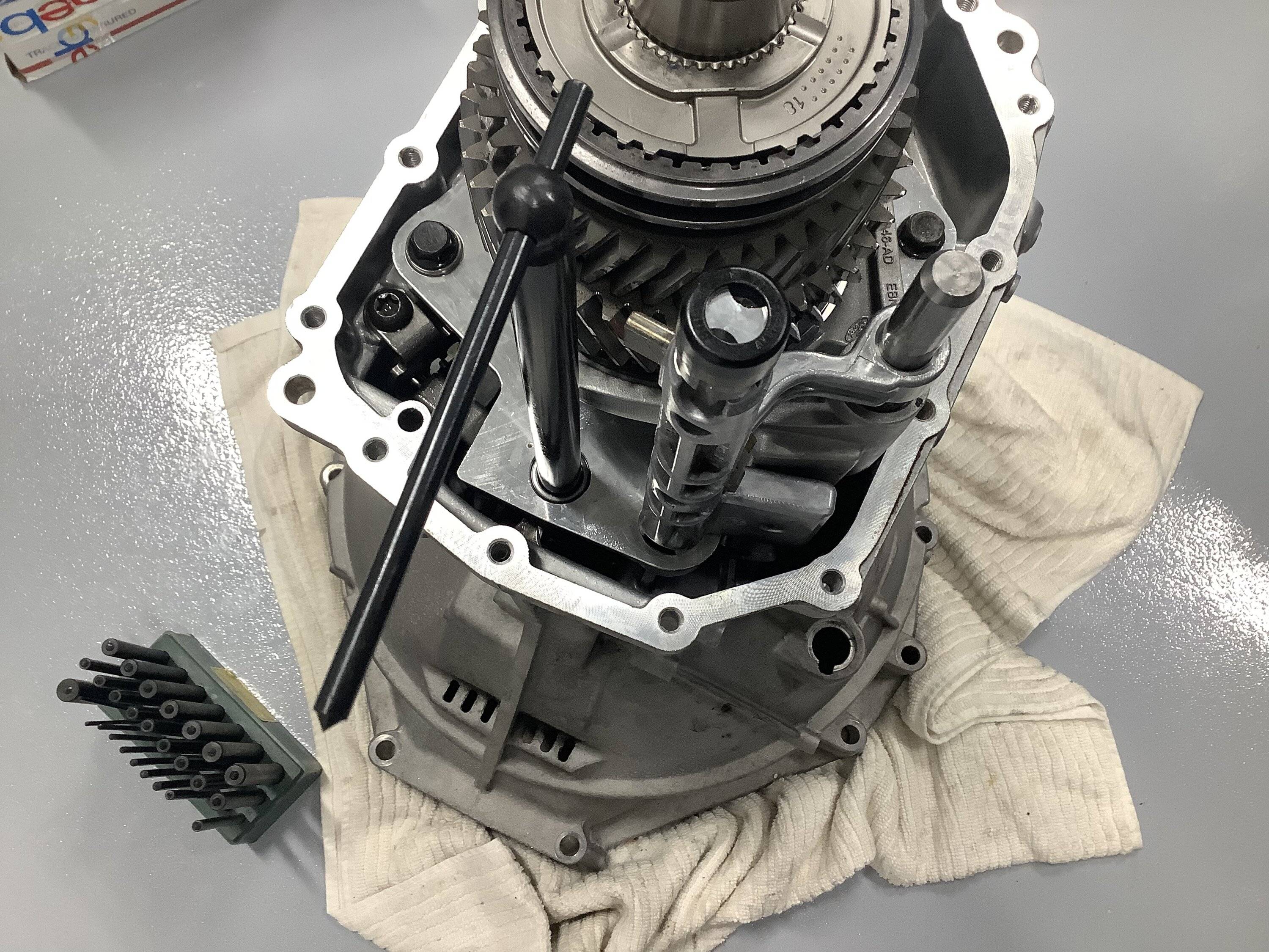

Still waiting on the detent pin removal tool to arrive. In the meantime, I removed the 1st/2nd shift forks and reverse rail. Note: In order to get these out, I used a transfer punch that fit into the hole of the shift rod and used it to engage the gears. I then put the transmission in what I believe to be 6th gear to release the 1st/2nd shift forks, so that I could remove them. Here are some comparison pics of the factory 1st/2nd shift forks and the new billet one that I will be replacing those with.

So although the service manual specifically states the shift forks are forged steel it appears they are the special lightweight, non-magnetic version. That's a forgery alright!

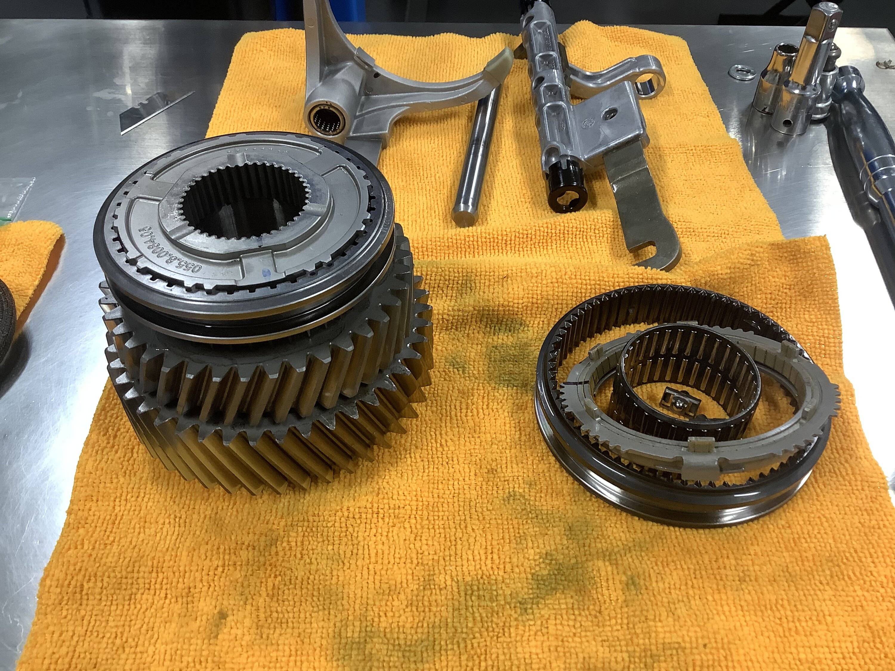

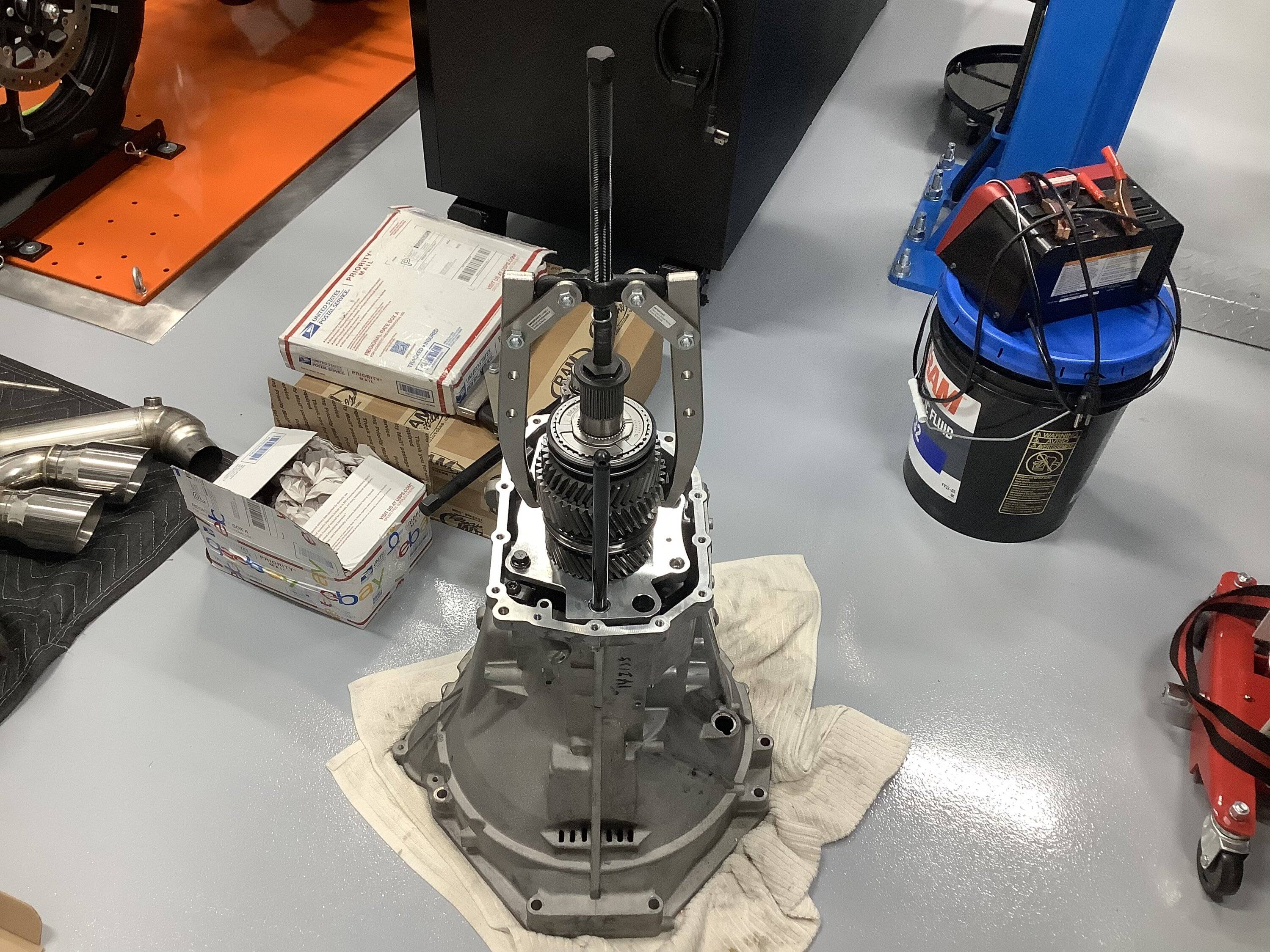

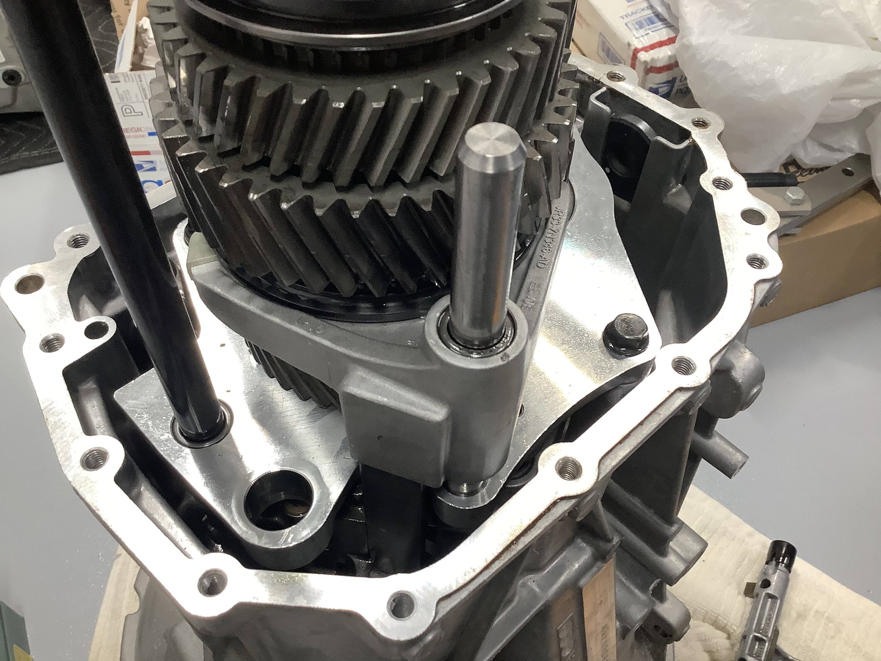

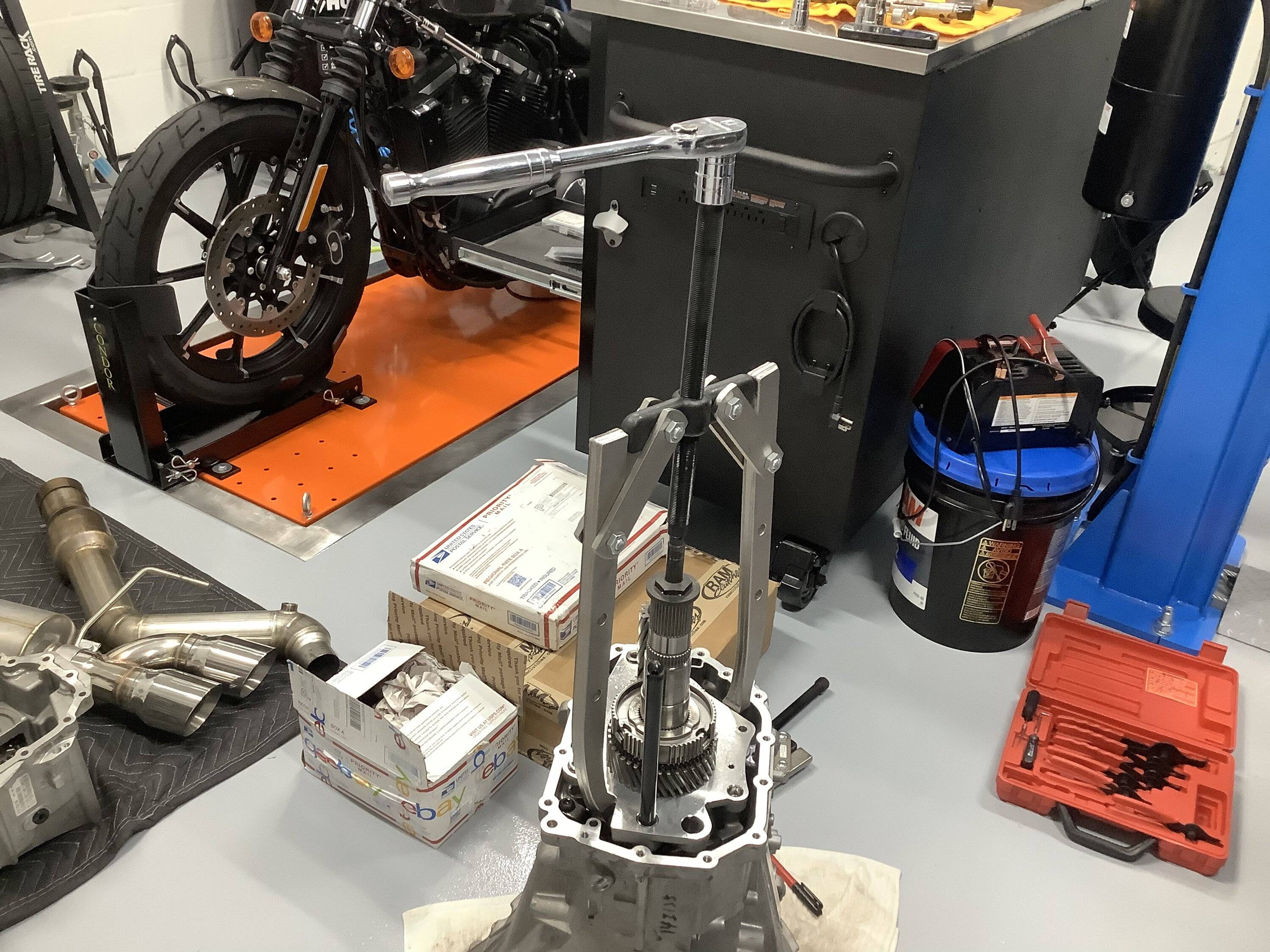

Update:

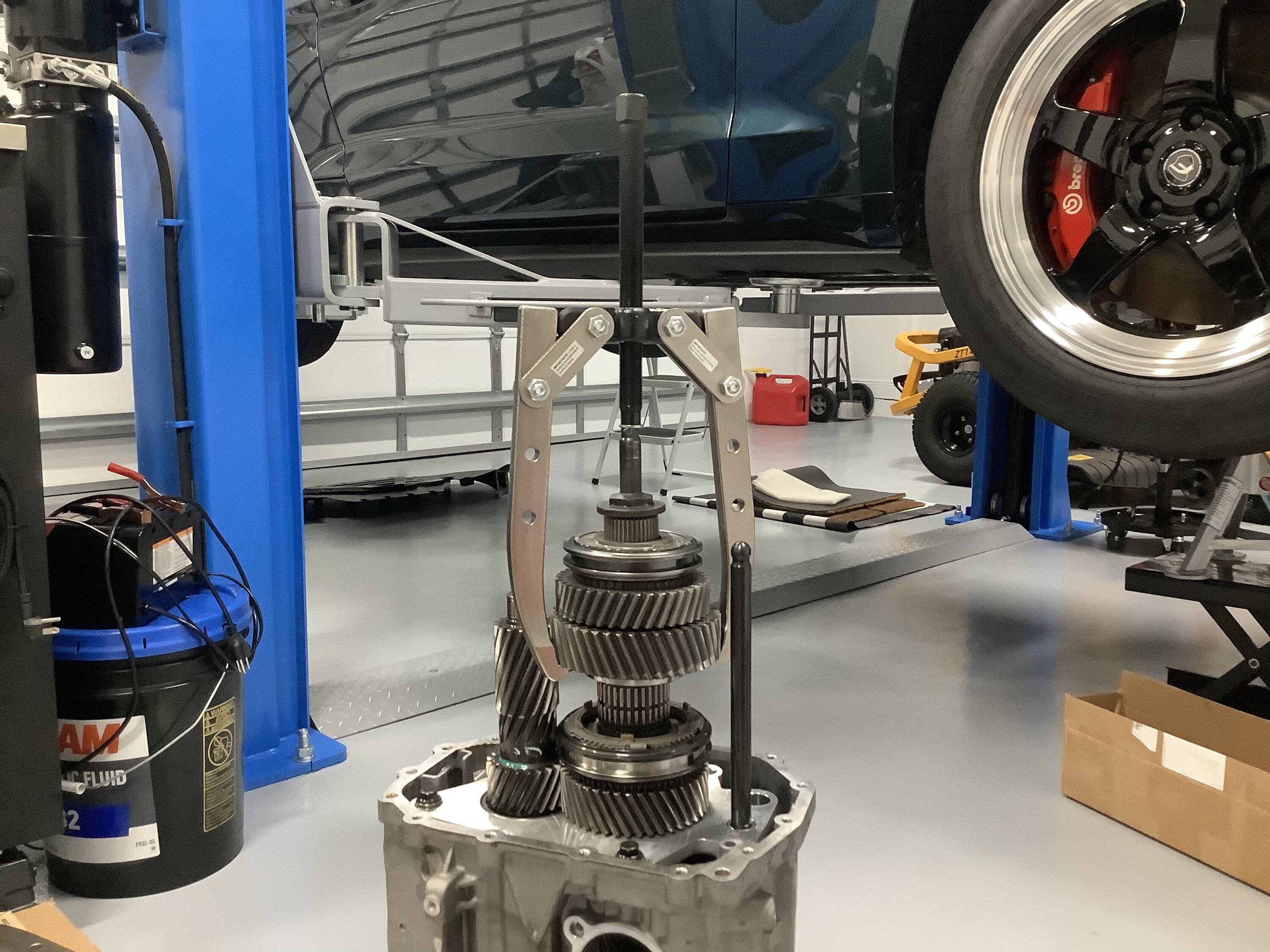

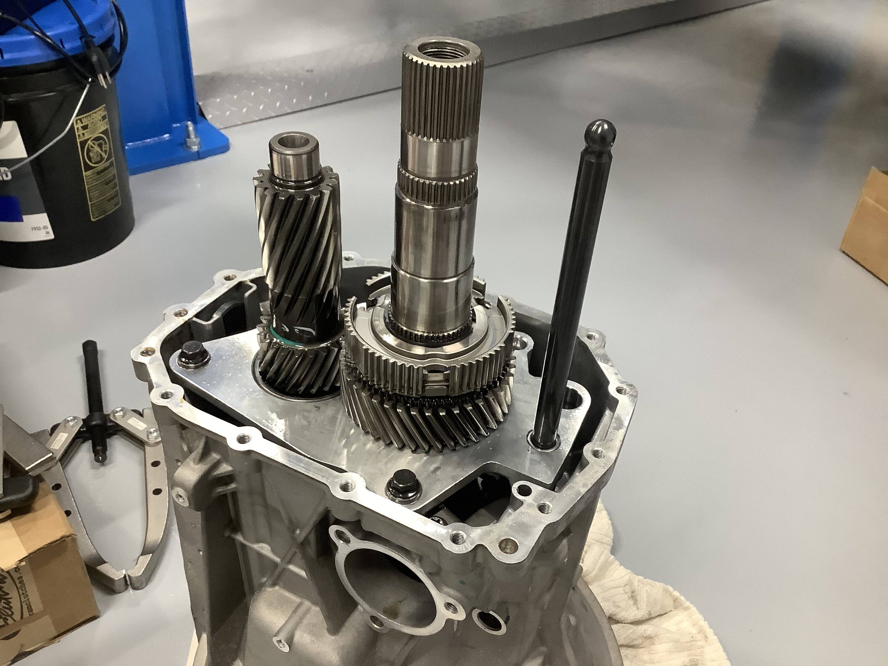

Pulled all gears, synchros, support plate and shift gate.
Tools used were medium and large 2 jaw pullers (to pull gears and synchros), 13mm socket (for support plate bolts) and T45 torx bit (for shift gate bolts).
Oh, indeed it is!

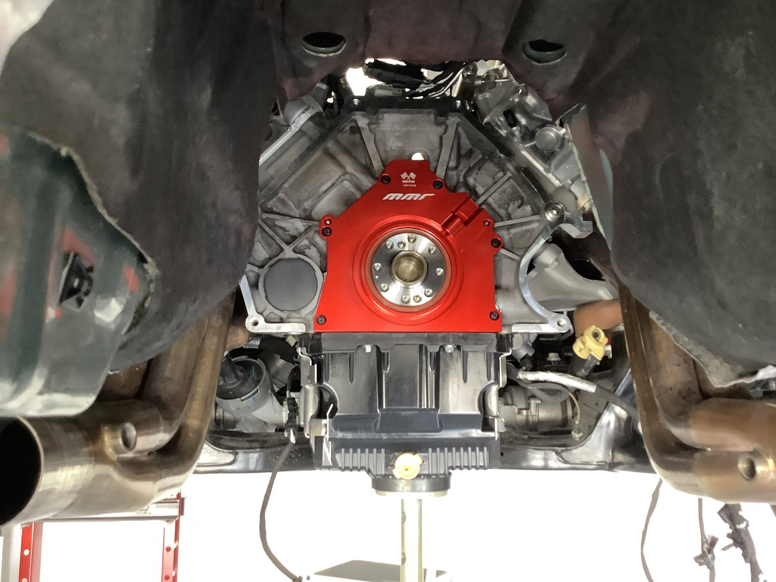

Today, I received a few parts from MMR, one of which was a billet rear plate, rear seal, trigger wheel and sensor. With the tranny and clutch out of the car, I figured this was a good time to do this mod. I didn’t have any issues with the rear seal leaking, but just wanted to make sure I had a fresh one in there since it’s so much trouble to get to. I do like the design of the MMR plate much better, as it uses a rope style viton gasket and doesn’t require the use of RTV sealant like the factory plate.
This was a really simple install once I managed to remove the factory plate, which seemed to be fused to the back of the block.

That’s a good looking piece

Yep! It’s too bad it’s gonna be hidden behind the transmission, just like the clutch. The seal looks and feels like itā€˜s a higher quality the factory seal too.
