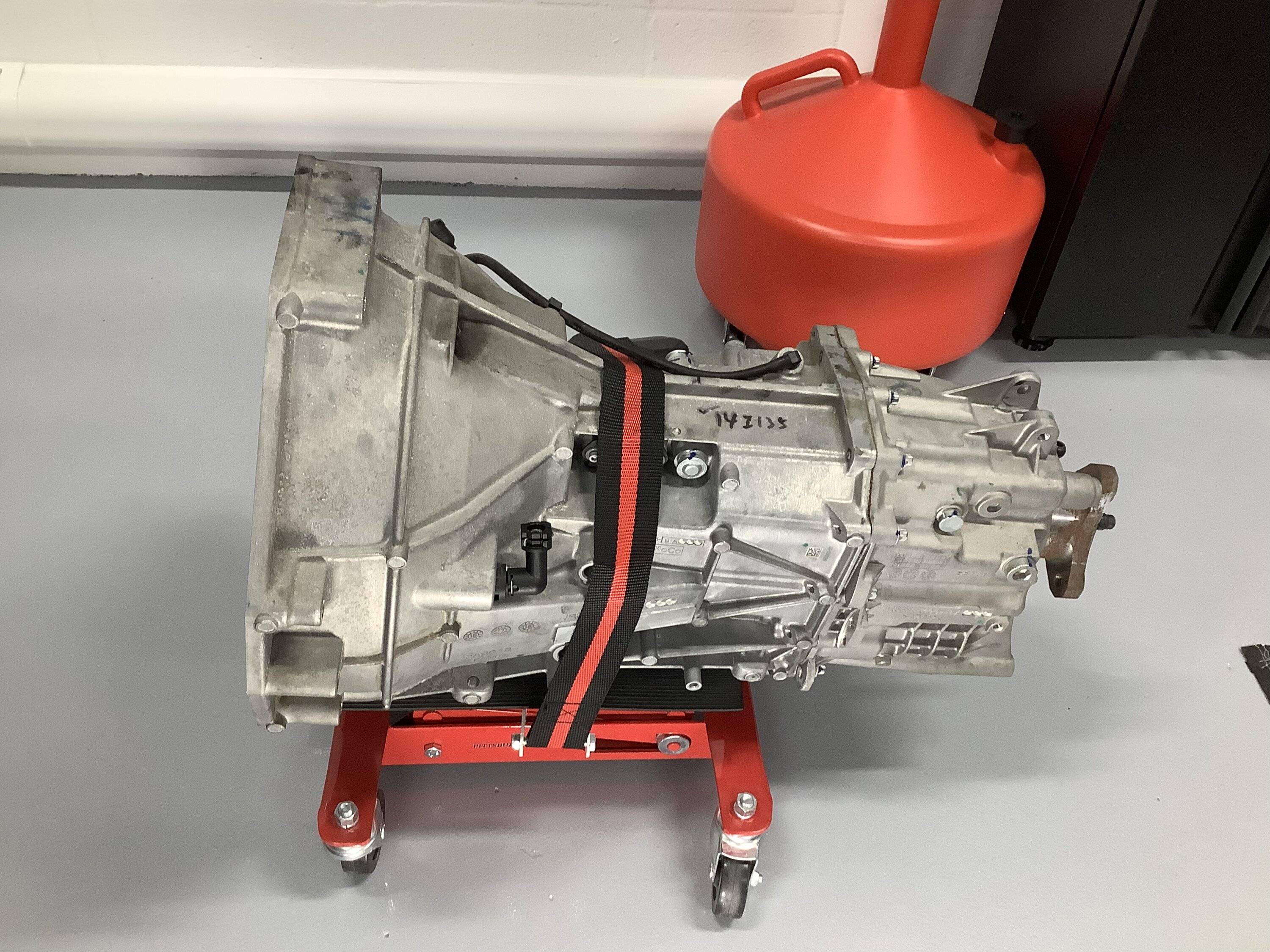

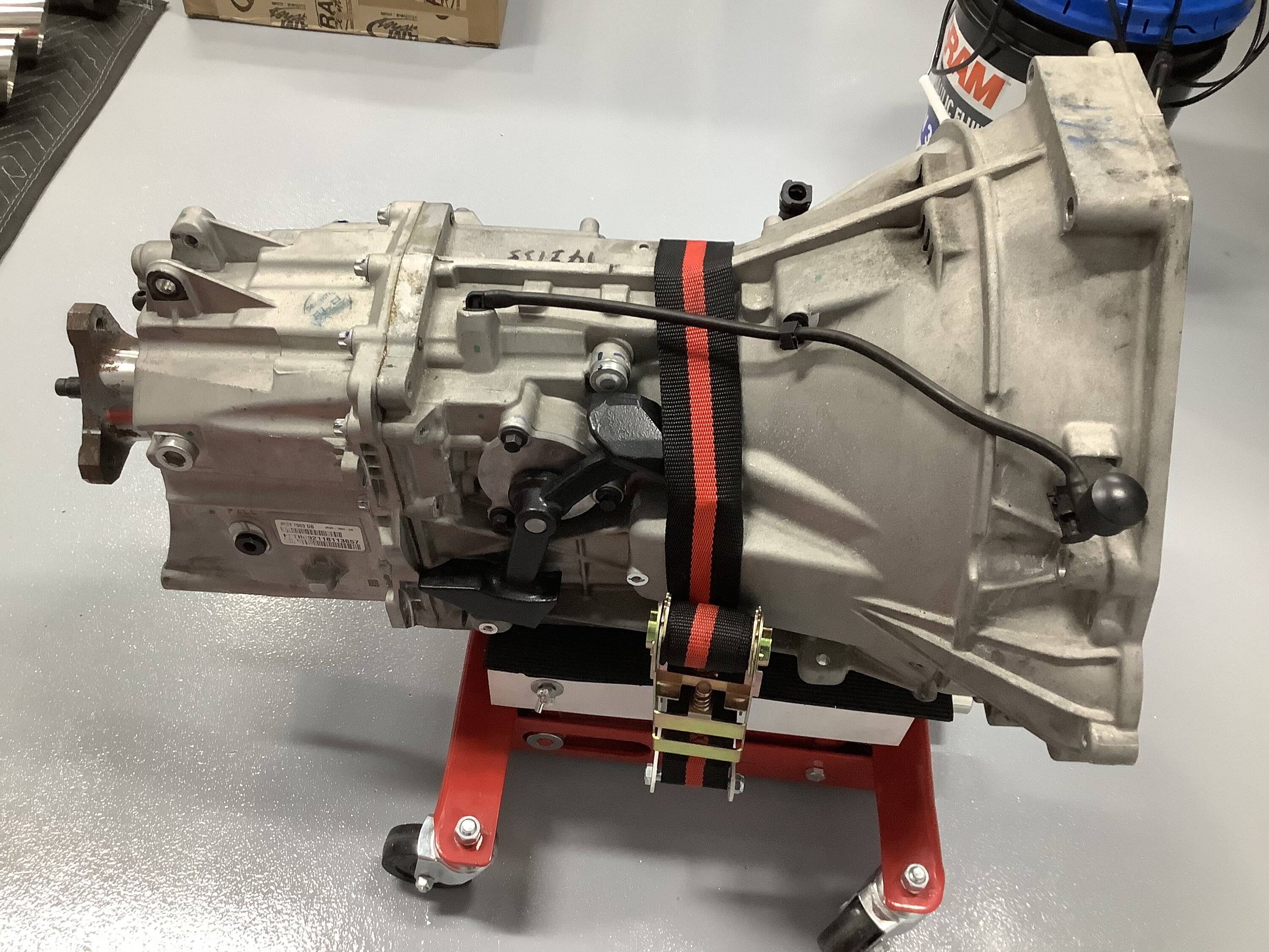

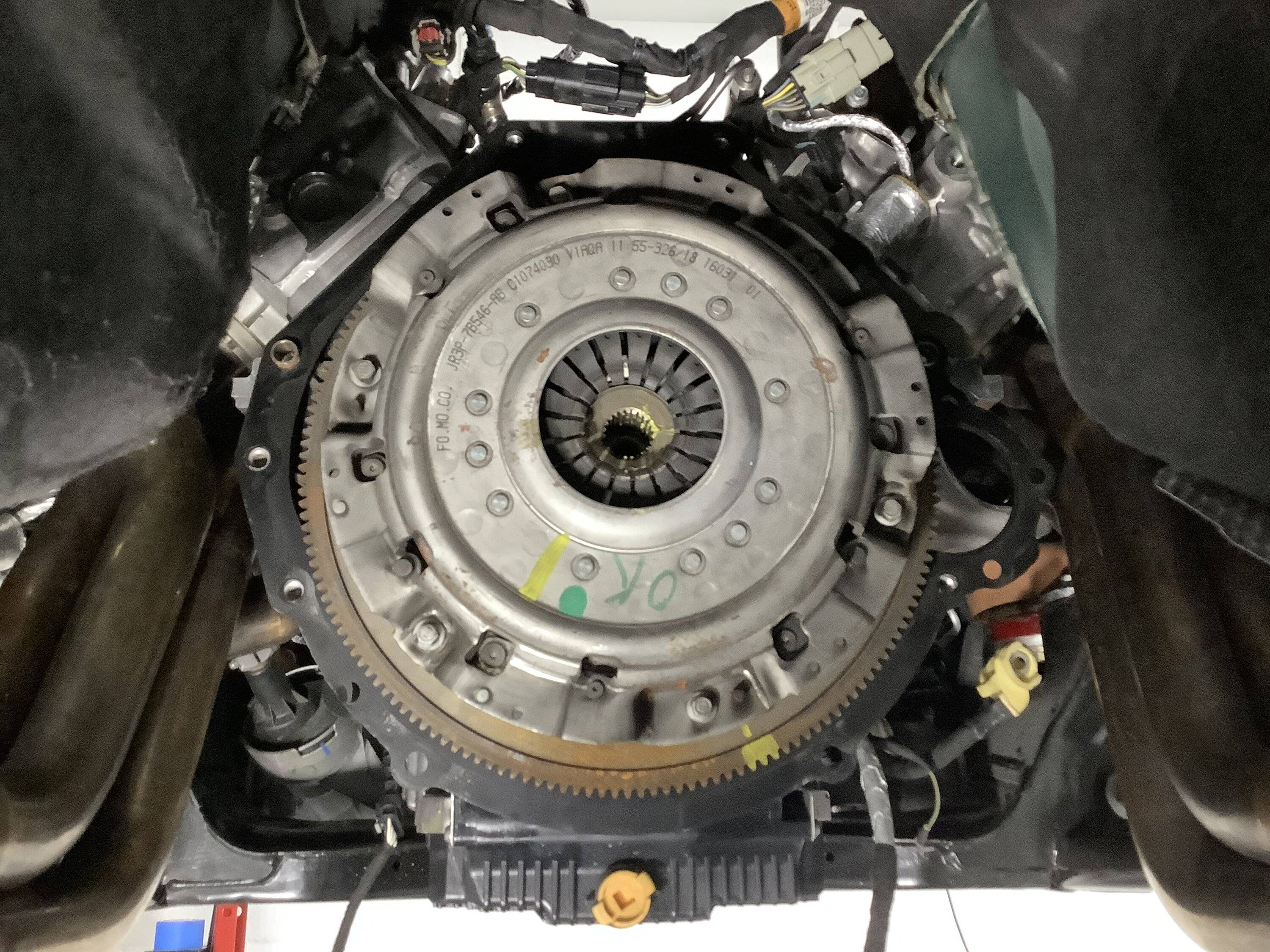

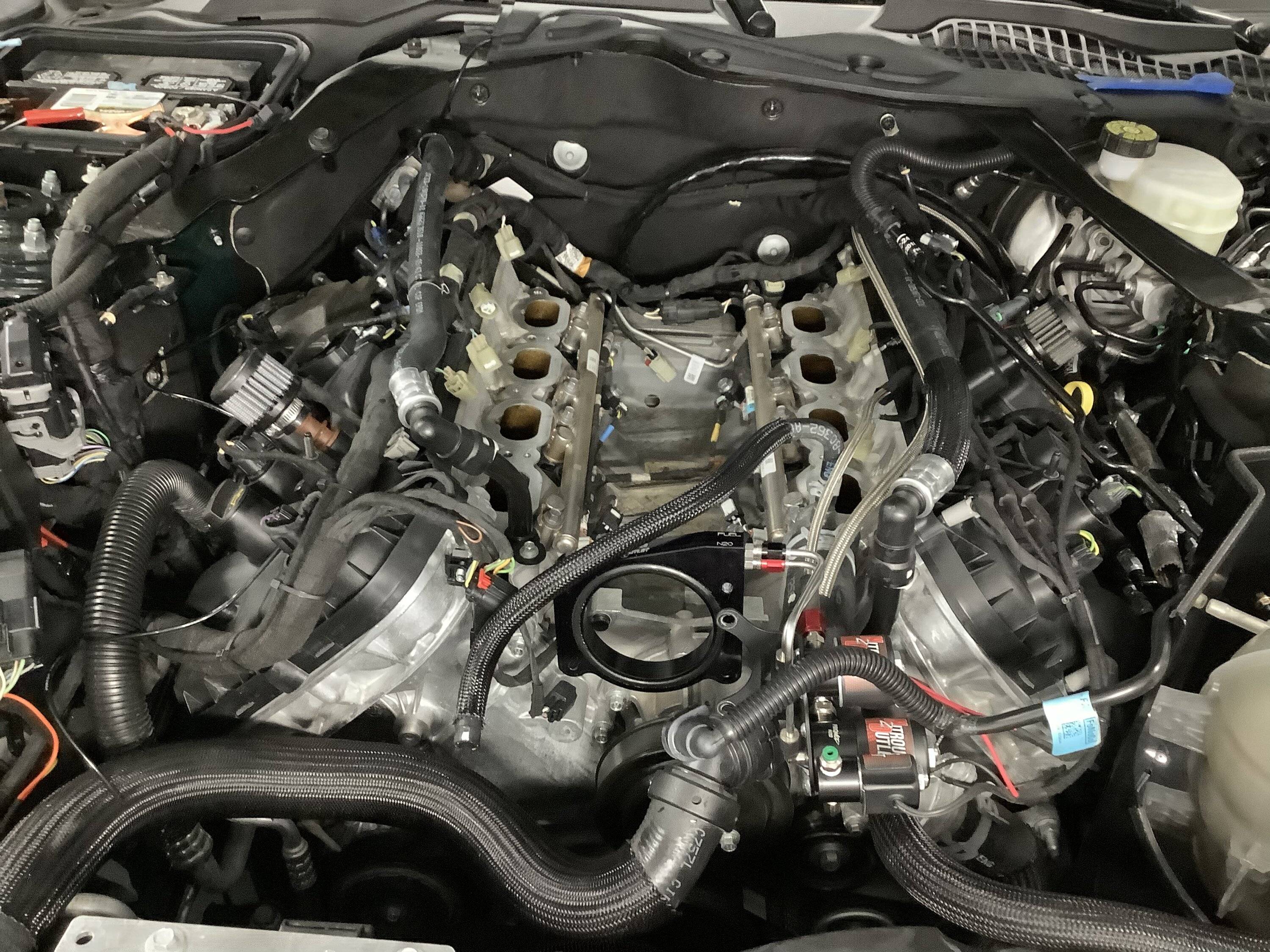

I was able to pull the tranny today. Unfortunately, I ended up having to work low to the ground because of the type of tranny jack that I have. I pulled the intake manifold to get to the top two bolts which made it so much easier. I had read that tip from another member’s post about his tranny removal. I’m gonna try and pull the clutch tomorrow, inspect it and get some good pics to post. Here is where I am as of this evening.

Interested to see how splitting the case goes. Have heard that just the plastic parts swapped for bronze makes a worthwhile difference in feel during shifts.
Is there any truth to the front bearing being starved for oil on long pulls? Believe is was one of the track forums that posted repeated failures until oil cooler setup with a return that basically fed oil to the front of the trans.
I’m interested in seeing what’s going on inside the casing. I‘ll be able to confirm whether Ford upgraded shift forks from cast aluminum to metal.
I hadn’t heard about the bearing starvation issue before.

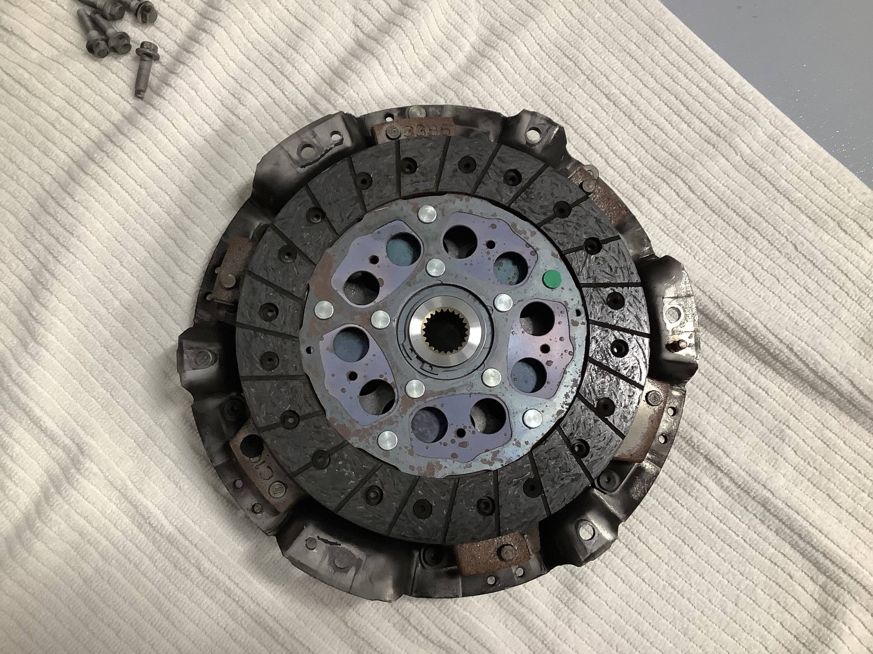

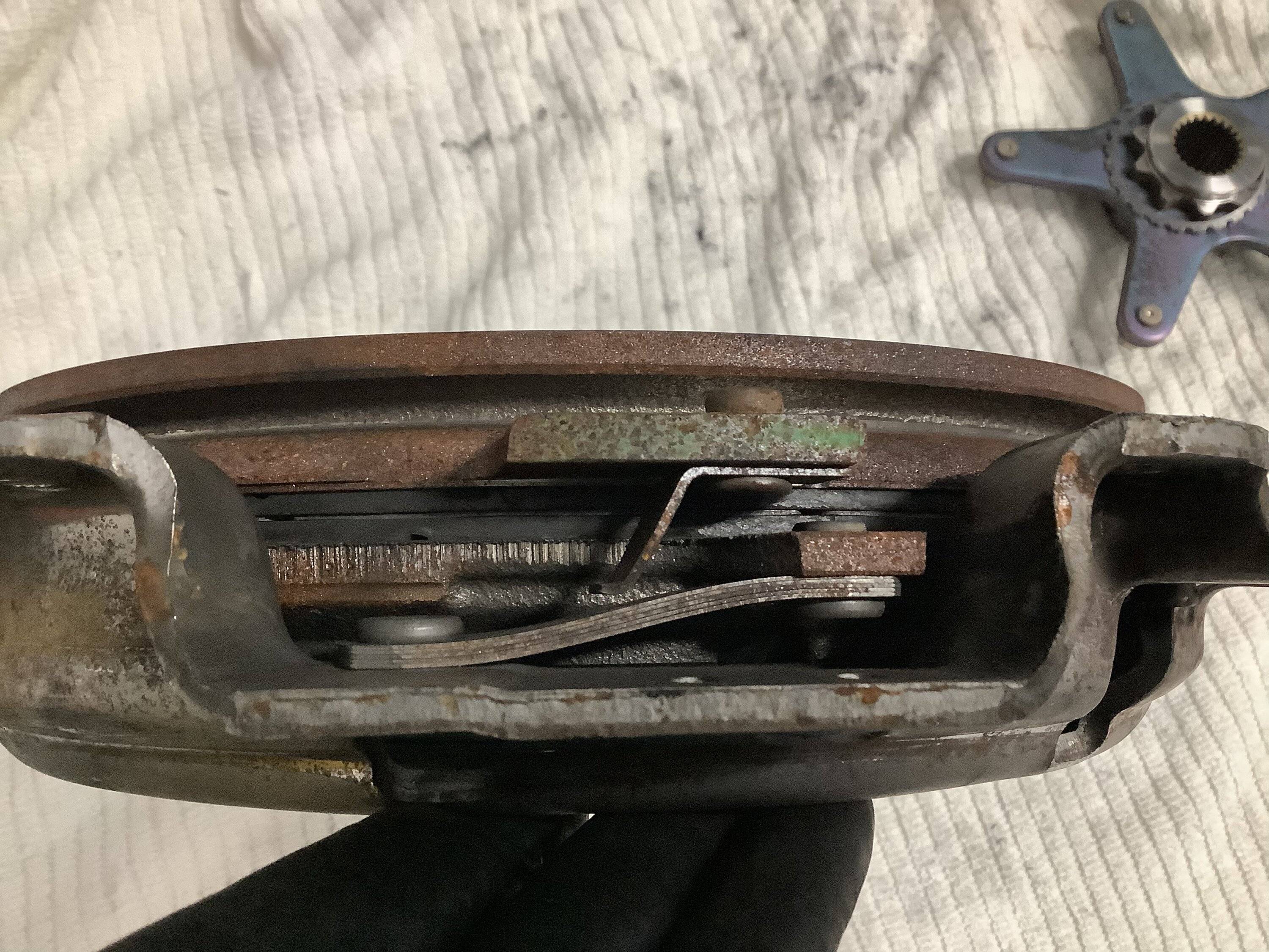

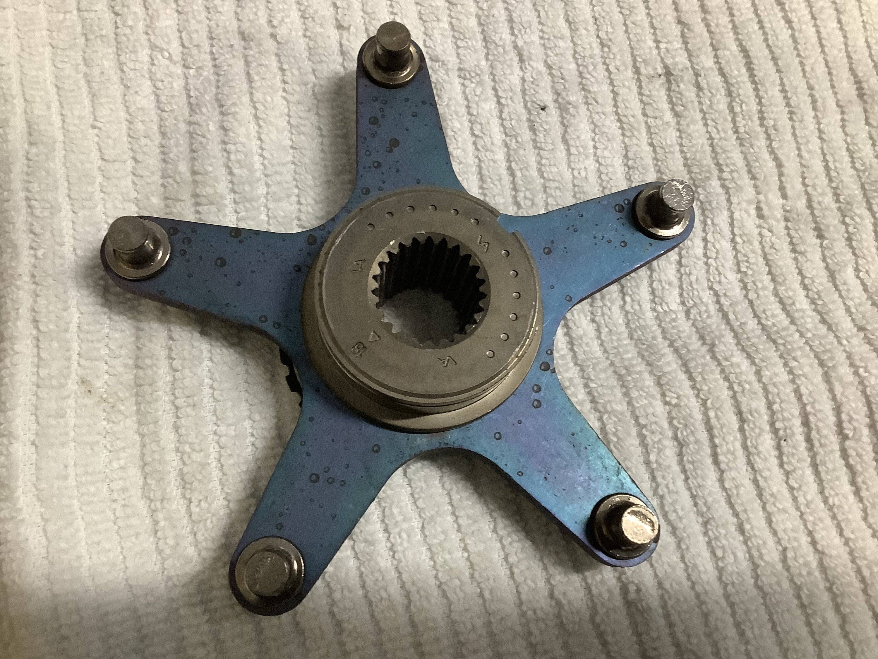

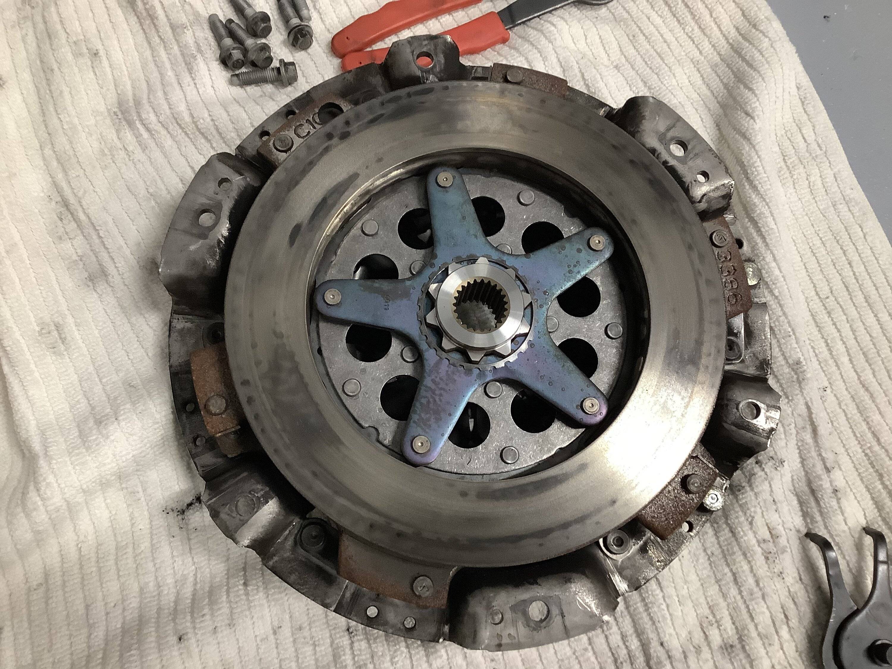

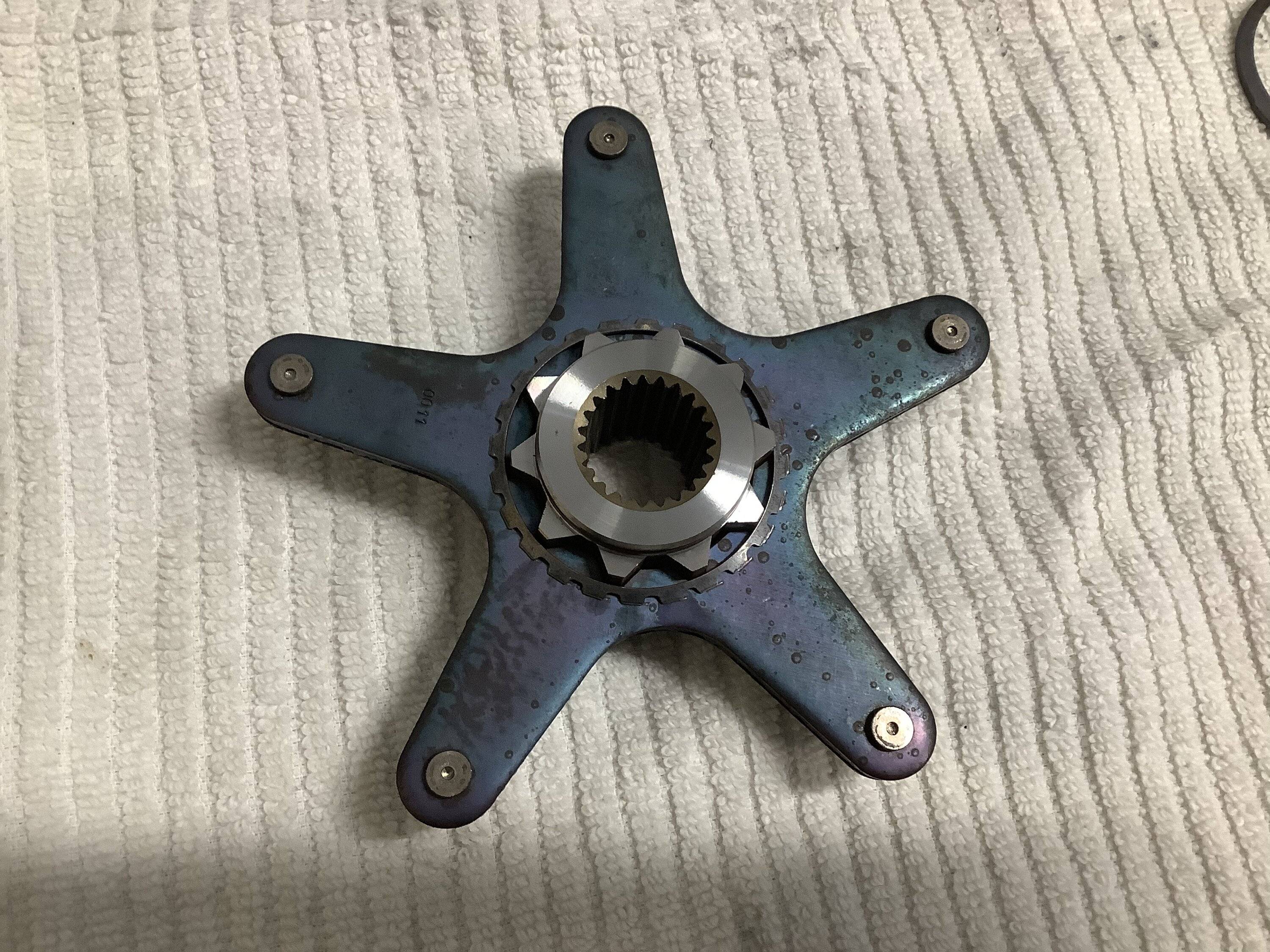

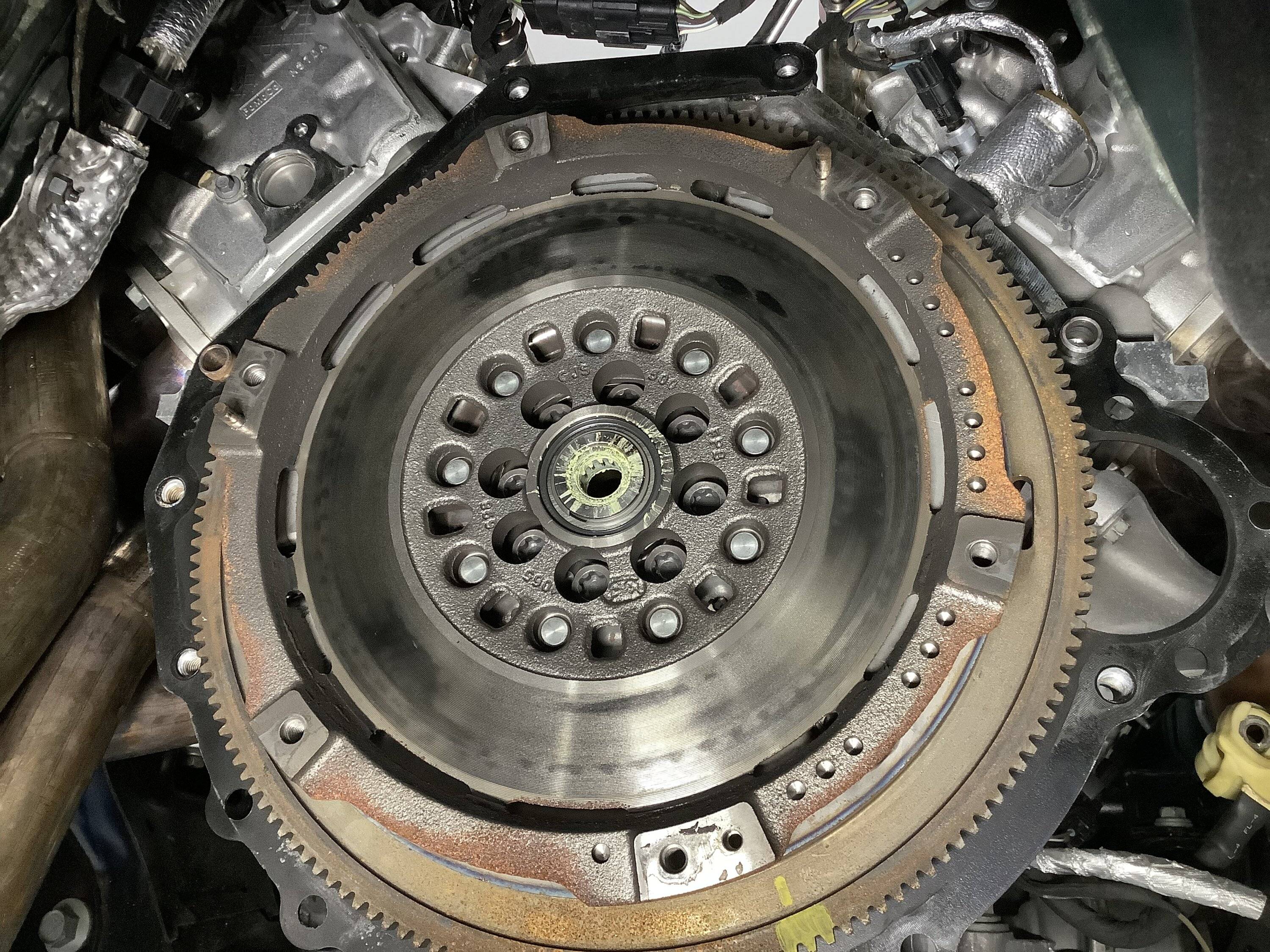

Clutch pulled this morning and it appears that things might have come to a halt temporarily until I can source a Torx Plus 55 impact rated bit to remove the flywheel. I have a standard T55, but don’t want to risk damaging the bolts, as the T55 seems to be a little loose.
I did disassemble the clutch as much as I could (most of it is held together with rivets). Here‘s what it looks like. As evidenced in the photos, there are several hot spots on the flywheel and clutch.

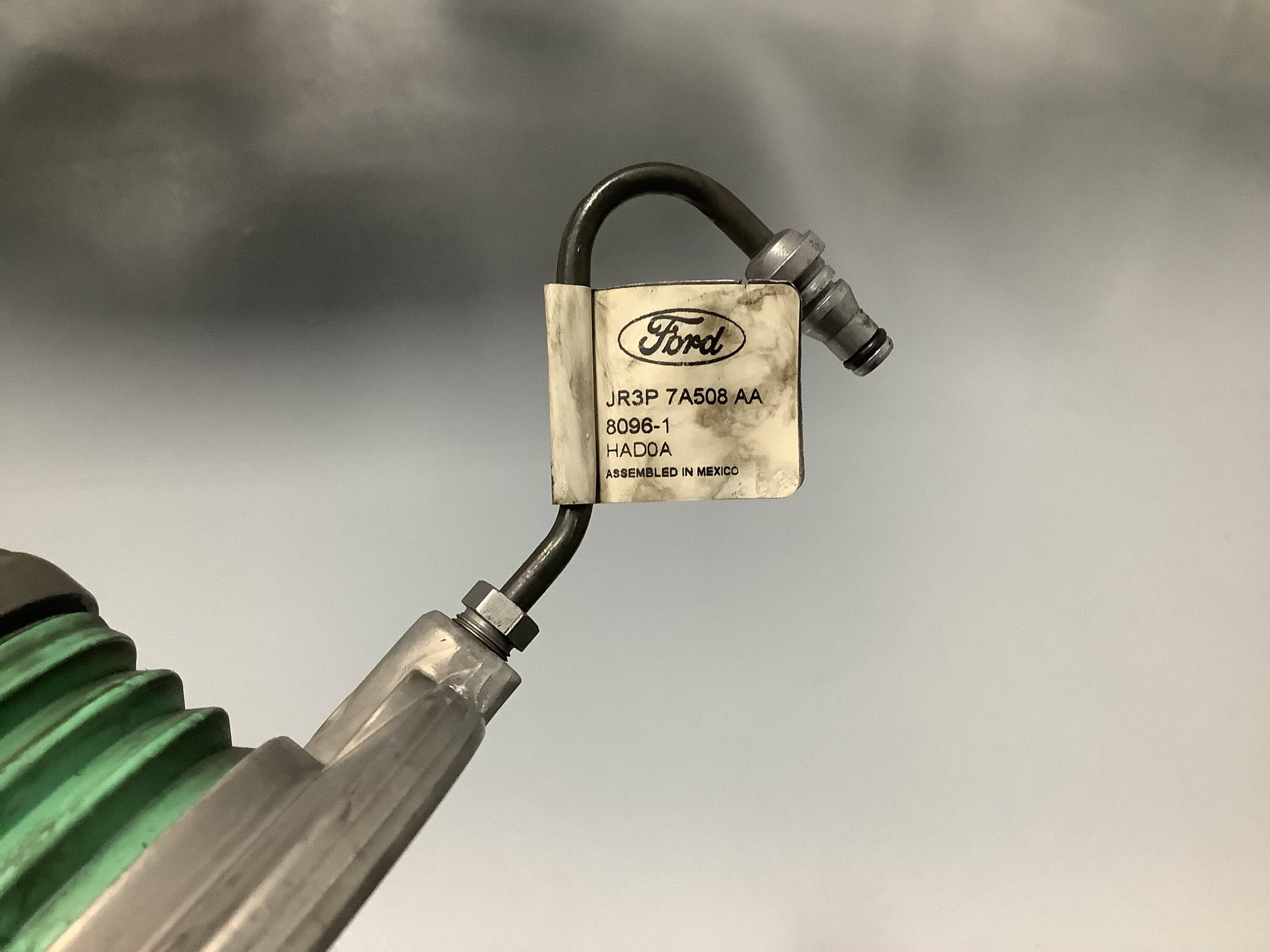

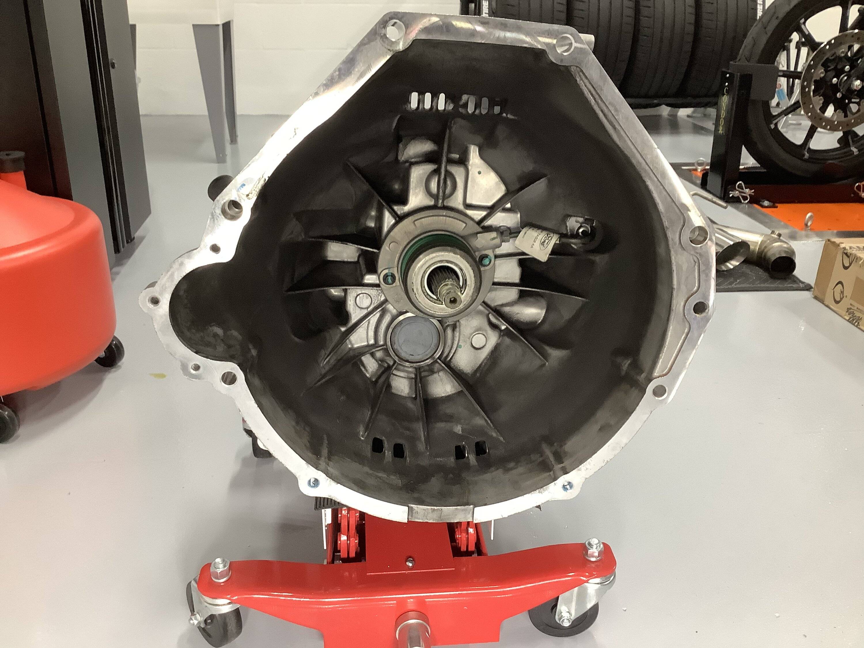

Upon removing the throwout bearing from bellhousing, it seems to be really wobbly. Can anyone confirm if this is normal? Maybe someone has a new one laying around that they can check to see if it has no wobble, wobble, shaky, shaky? Here’s the part number on the tag that’s attached to it.

you don't "release" the clutch, you slowly EEEEEASE is out. If you're doing the former then the chirp is probably caused by accumulation of prior low-grade "abuse". When the plates suddenly friction up against the disk you get chirp. If your slave/throwout no longer has good control all the way to the end, then that too can suddenly cause the parts to bind and chirp.
I see what you’re saying, but I have no instances of low grade abuse with the clutch. I do ease out of it the majority of the time during normal driving. I should have clarified that the chirp occurs during stop light takeoffs and parking lot maneuvers. I do however, quickly release the clutch intentionally on hard launches and quick shifts.
