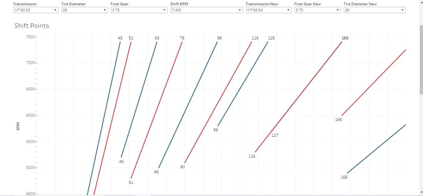

WildHorse
N/A or GO HOME
Jun 28, 2017
270
10,297
8,350
Home World: CLASSIFIED
Puddintane
'17 S550
The torque of forced induction overwhelms the downsides of the d4. And it's negatives become positive
Not everyone goes FI. Ford doesn't offer a FI GT, therefore the 18+ MT82 just plain sucks. Haha. It's basically a highway transmission. Zero need for 2 overdrives & a 3.31 gear.
Even 3.73 don't improve it at all.
Red is the 18+

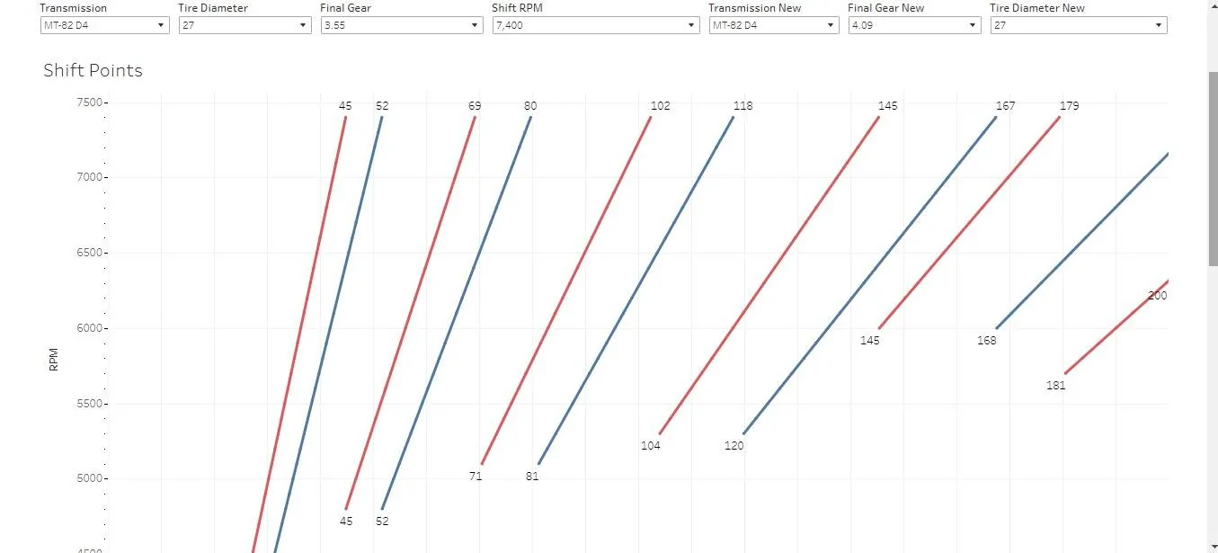

WD Pro
Jan 18, 2018
132
6,821
13,672
United Kingdom
Lime GT
Red is the 18+
Are you able to do me one of those based on the D4 with a PP1 rear tyre with the only difference being a 3.55 v 4.09 ?
It would be very much appreciated ... :like:
Cheers,
WD :like:
