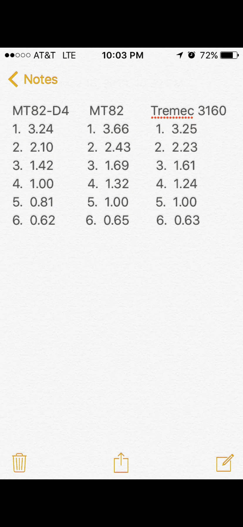

Part of the difference in perception is that the newer cars that have the D4 also have a redline 400rpm higher.
Where a 2017 GT-PP could go 64mph in 2nd gear, a 2018 GT-PP can go 78 in 2nd gear.
...So, with the combination of taller 2nd gear and higher redline, you're waiting longer for the shift to 3rd.
Also, out of the 3 transmission choices the D4 has the biggest gap between 3rd and 4th gears. One more reason to avoid shifting to 4th at a track or drag strip: You would lose a lot of rpm.
A car with the D4 can also trigger the 155mph governor in the top 3 gears. I don't know if that's really a downside, but it's silly 🙃
While I understand that a rear-end swap is way less expensive than a Tremec swap...
A 4.09 rear end would have your engine turning faster at 75mph, where a Tremec swap would barely make a difference in 6th gear, while making the car faster in all the other gears.
(To me, the fact that my GT-PP1 turns only 2100rpm at 75mph is a major selling point, and I don't care to change it.)
Another thing to consider is that different Mustang trims come with different size tires, and that can change the effective gear ratio. The next time you need tires, you could try a size that gears your car shorter.
GT-PP2 came with the 3.73 rear end, but the tire size made it like putting a 3.90 in the car.
