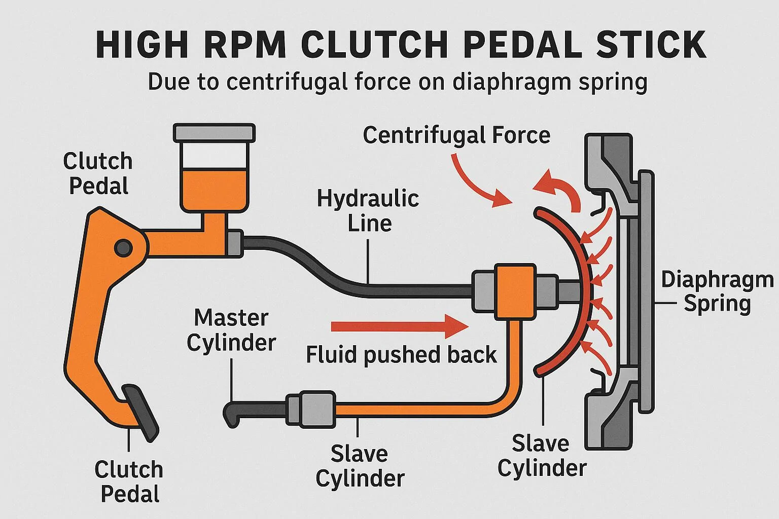

hydraulic system collapse under high RPM
Centrifugal clutch finger movement
At 7,000+ RPM, the stock diaphragm spring “grows” outward from centrifugal force.
This pushes the throwout bearing (TOB) & slave cylinder piston backward into the fluid column.
The backward motion forces fluid up toward the master cylinder and drops line pressure.
Weak master cylinder return
The stock Ford plastic master has a light return spring.
If fluid is pushed backward, the master piston may not fully return unless you pull it back with your foot.
Heat & aeration in the clutch line
The factory soft rubber clutch line can expand and heat‑soak near the headers, aerating the fluid.
Aerated fluid compresses instead of transmitting pressure, so the pedal goes limp until pumped.
Over-stroking the slave cylinder
The MT‑82 pedal travel is longer than needed to disengage the clutch.
At high RPM, this over-extension worsens push-back and can momentarily “trap” the pedal down.
At high RPM, the clutch’s spinning diaphragm spring physically shoves the hydraulics backward, the pedal loses preload, and you have to re-prime it with your foot and a few pumps. This is mechanical + hydraulic, not just “bad fluid.”
