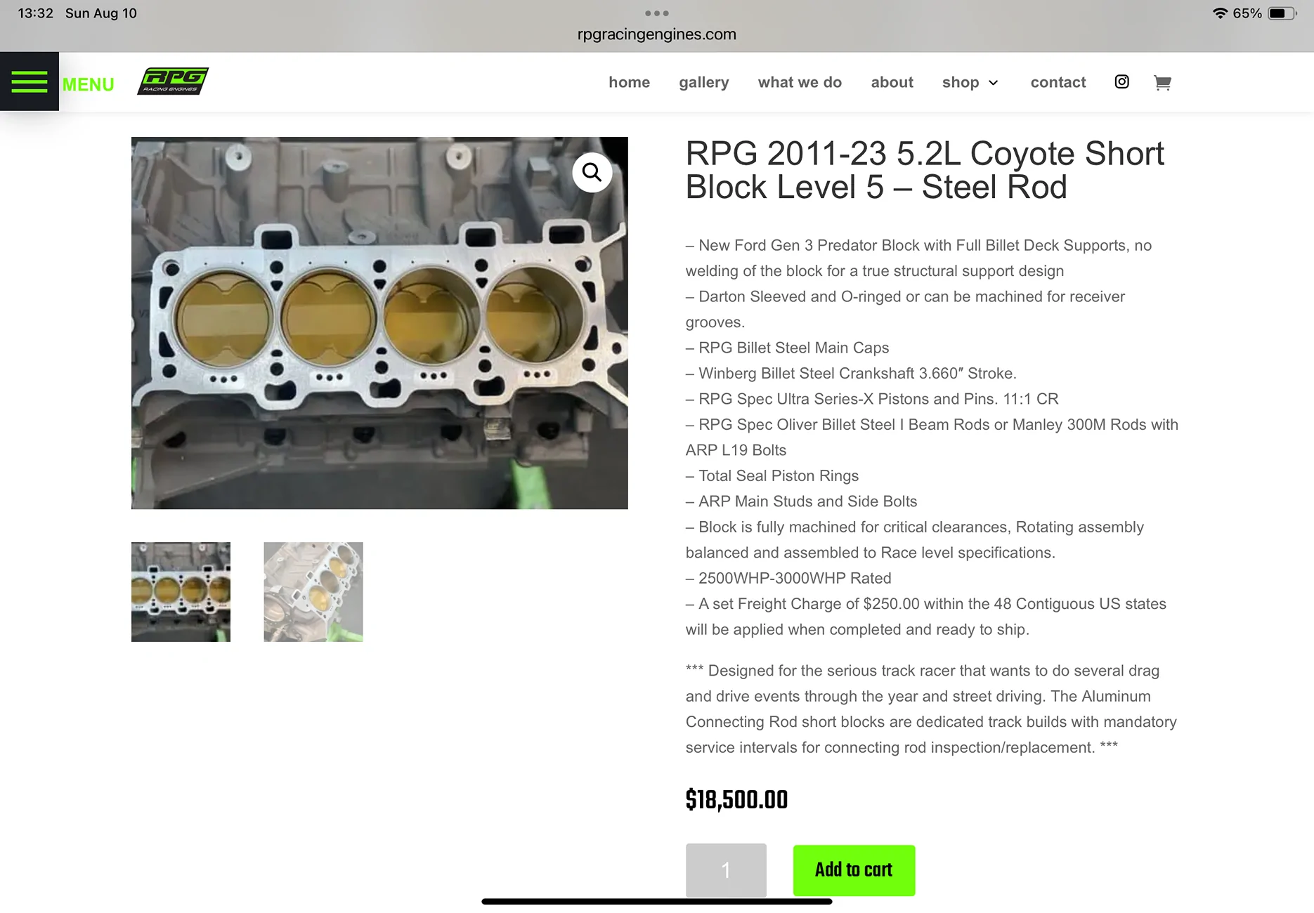

Thanks Terry for your reply. Everyone has given great recommendations for me to consider. BUT, I have decided I need to have major surgery on my right shoulder in November just like I did on my left shoulder this past January. And it takes a Solid 6-8 months to fully recover/heal and during that time. So I will now have to factor in how I will upgrade my engine/supercharger etc. However I have decided I will use my OEM block, Upgrade pistons, crank, rods, sleeved, O-Ringed, cryogenically treated etc, have the heads completely upgraded to handle 1500hp (which is close to the Gen3 block capability) but only run it at around 1000whp on the street and maybe push to 1300whp when I take it to the IND Half Mile race or 1/4 mile. I want it built to handle more than I will ever push it to increase reliability as much as can be. I know with the engine being 1108chp its not a matter "IF" but when and how soon or limited use until boom, Boom.

Thank you for your help. I have decided I would have to many areas I would need to beef up which for me, would make it not as fun to drive on the street. So I will Build my OEM block to handle around 1500hp and run it at a safe level like 1000 street and 1300 at the INDY half mile or drag strip. I don't mind buying an extra set of wheels for the track to handle the higher numbers as long as I can switch back to my two piece forged wheels.

That is true but I have decided I will build my OEM block, heads etc and keep it below 1500hp. I told myself before I bought the car, I will mod everything BUT, Not to a point to where it is not as enjoyable to drive at any given time.
