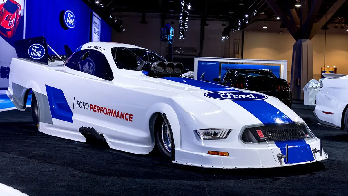

@DougS550 - Just trade it for this. It will probably be cheaper
Not sure on cheaper but not very comfortable for street but, awesome for stop light to stop light. lol
