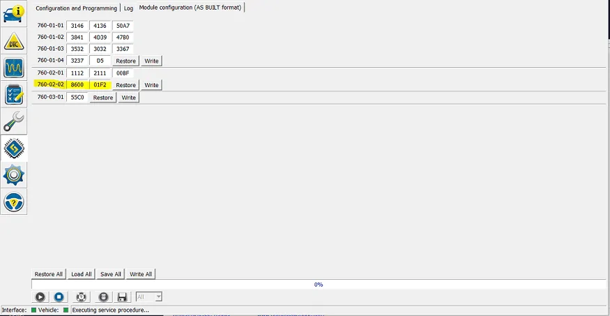

Quick update: I've got an idea and here's what I've come up with...
I took the value: 8600 7364 (I know I said it didn't work. Except that I changed it) Here's exactly what I injected in the ABS:
760-02-02 8600 01F2 (Here's where it becomes interesting! Forscan took it without any error and the Advance Track didn't trip! This could be the correct value somehow... I tried my car in my drive way and I put it on Neutral to check if I was on flat level. The car didn't move even though for me it didn't seem flat lol). I thought it'll be interesting to throw here all the values that we tried and it doesn't get any errors...
Here's a screenshot:

okay, so trying a lot of these values on my 2015 EB, and not having any luck.
760-02-02 8600 01F2 - Invalid Configuration
760-02-02 8600 1102 - Invalid Configuration
760-02-02 0200 319E - Programmed successfully, AdvanceTrac Service Msg
760-02-02 0200 218E - Programmed successfully, AdvanceTrac Service Msg
760-02-02 0200 127F - Invalid configuration
760-02-02 0200 73E0 - Invalid configuration
760-02-02 8600 3122 - Invalid configuration
760-02-02 8600 3223 - Invalid configuration
760-02-02 0200 71DE - Programmed successfully, AdvanceTrack Service, Driver mode not available
None of the above values ever made Line Lock option under Track Apps change from greyed out. I'm still believing there is another change somewhere else outside of 760-02-02 that needs to be made.
Giving up for now... :(
