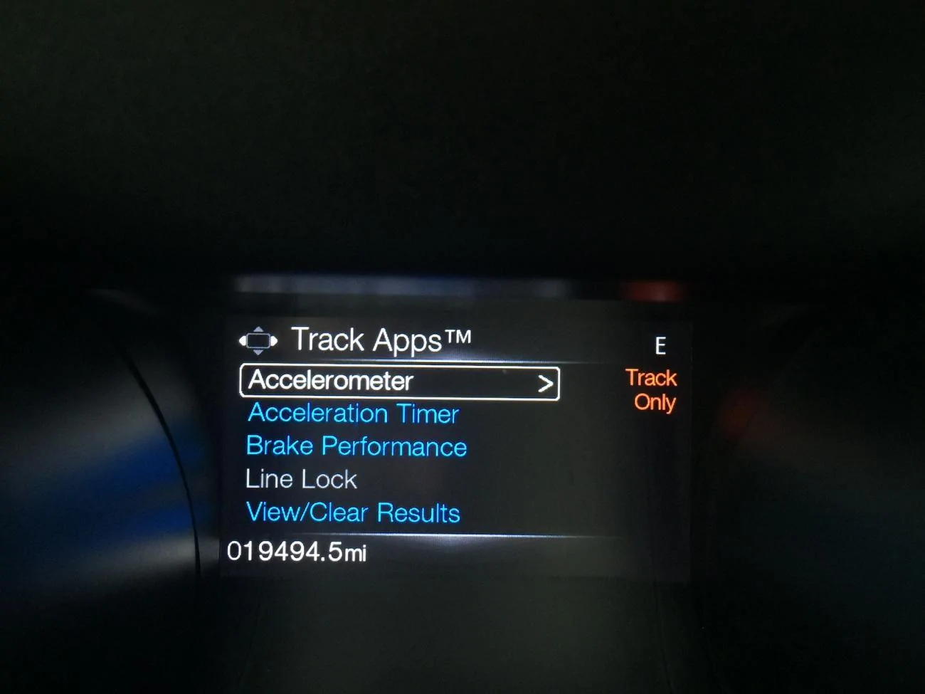

So I have Forscan and I enabled line lock. It shows up on the Track Apps screen but it wont let me select it so I must need to enable something else as well.
Here it is in Forscan
shows on dash but disabled

I found out how to enable line lock in the ABS module, which makes sense since that is what controls the actual braking of the front wheels to do burnouts. However when I tried it I received a advance trac error message and it was still not enabled in the menu. I will try again next week when I have more time.

I'm wondering the same thing. Look at the title of the screen, there is a PID controller for line lock. I guess the PID controller is to control the rotation speed difference of the two wheels, most likely by controlling the brake force.

Alrighty, after doing some research I found someone on an Australian forum talking about checking the ABS as well. The guy checked it and enabled line lock and it kinda worked... here's what he said:
Missed the ABS module previously. Enabled in ABS and IPC, now get the menu and go through the sequence.
But as soon as I hit ok on the final step, I get a message "not available, see manual". Car was cold and didn't have it in gear yet so not sure if that matters (Handbrake was off).
I believe later on he stated that he had to have it in gear and have his foot on the brake for it to work just like factory line lock. So in short, he did have a fully enabled line lock.
