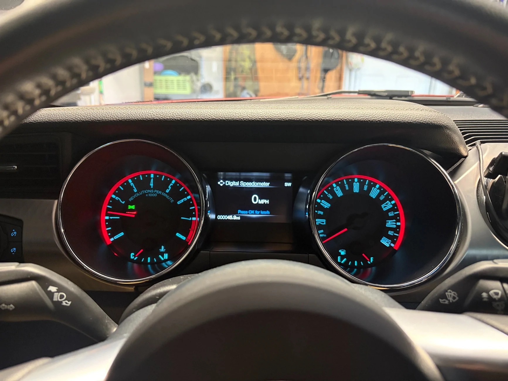

I've managed a successful swap of my 2015 IPC to a 2018 IPC (with updated Gauge cluster covers) to get the digital speedo without sacrificing the needles. What can I say, I like retro?

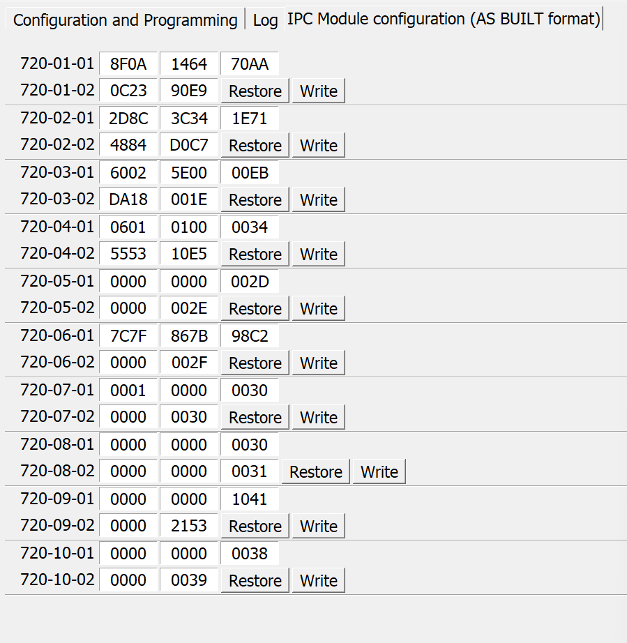

However, I cannot get the chimes / warnings for the Cross Traffic Assist working. The option shows up in the IPC, but no warnings.
Car has has auto cruise control and rain sensors added. Thanks Falk03!
Have completed some exhaustive searching and cannot figure this out. Would love some help!
My current IPC configuration is attached! Bonus photos of the "Daytona" custom faces from Moman in Poland!

Alternatively, if anyone has a standard IPC (not the digital) that is getting successful CTA warnings could post their As-Built Data, I am happy to troubleshoot digit by digit.

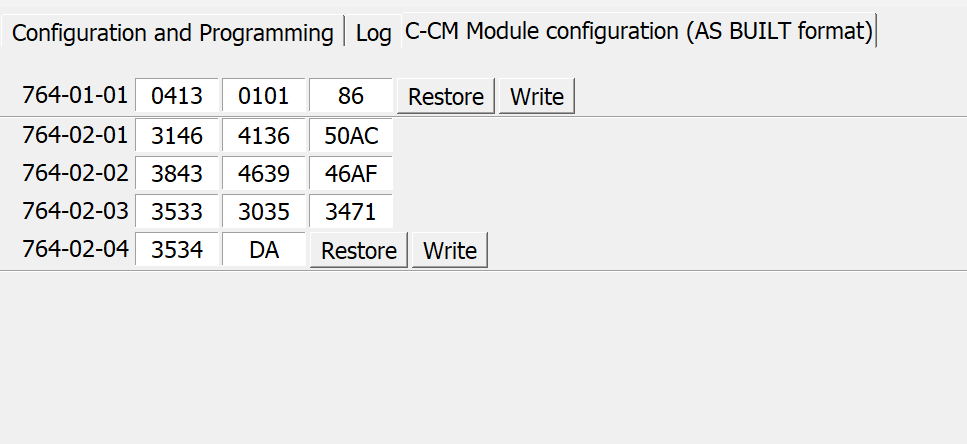

I do have another DTC I cannot clear: Code: U0158 - Lost Communication With Head Up Display
I did not install the HUD in my vehicle since the IPC has beeping and its own messaging.
Anyone know the As-Built to clear this error code and have the C-CM not look for a HUD?
