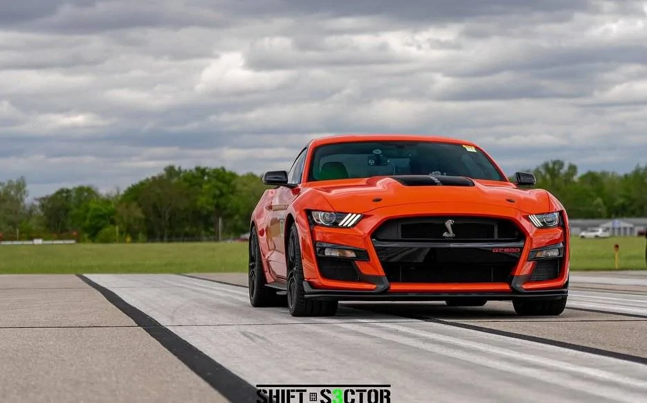

Unfortunately no, I took a slightly different approach to get it and sold my Mach1 to pickup a '22 GT500 :)
Wow that is a beautiful car. I'm sorry, but Ferrari has nothing on this. Ford wins again.
