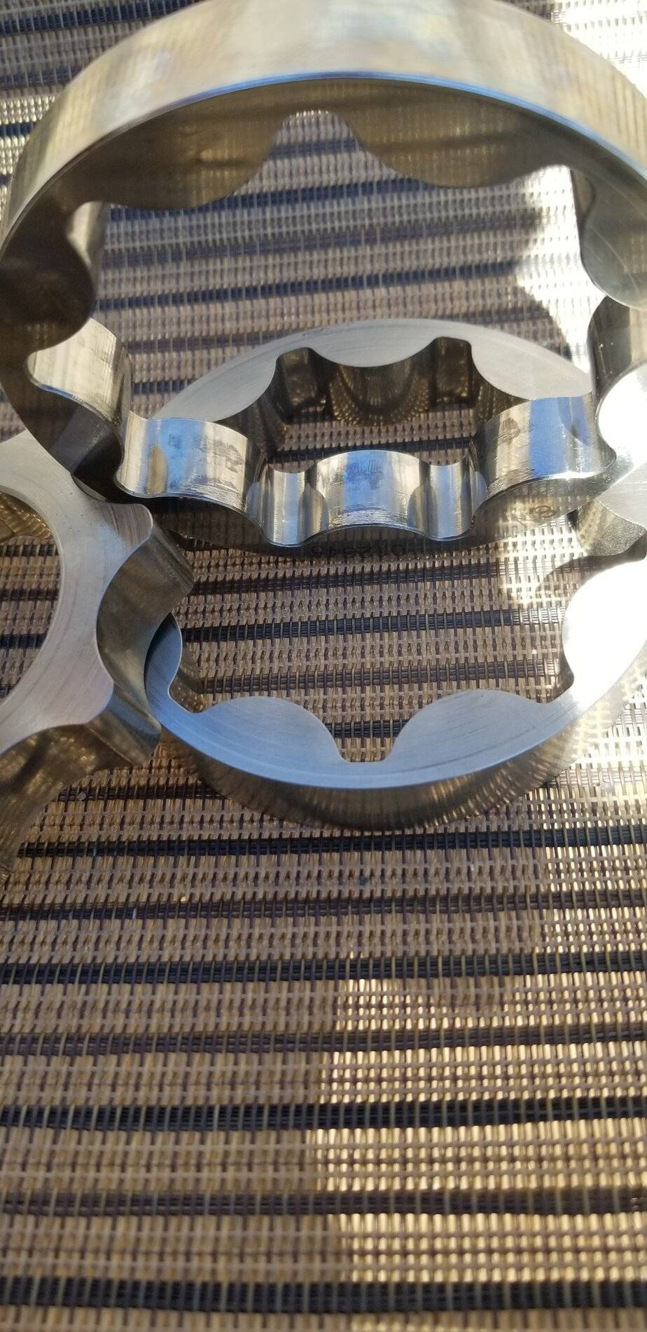

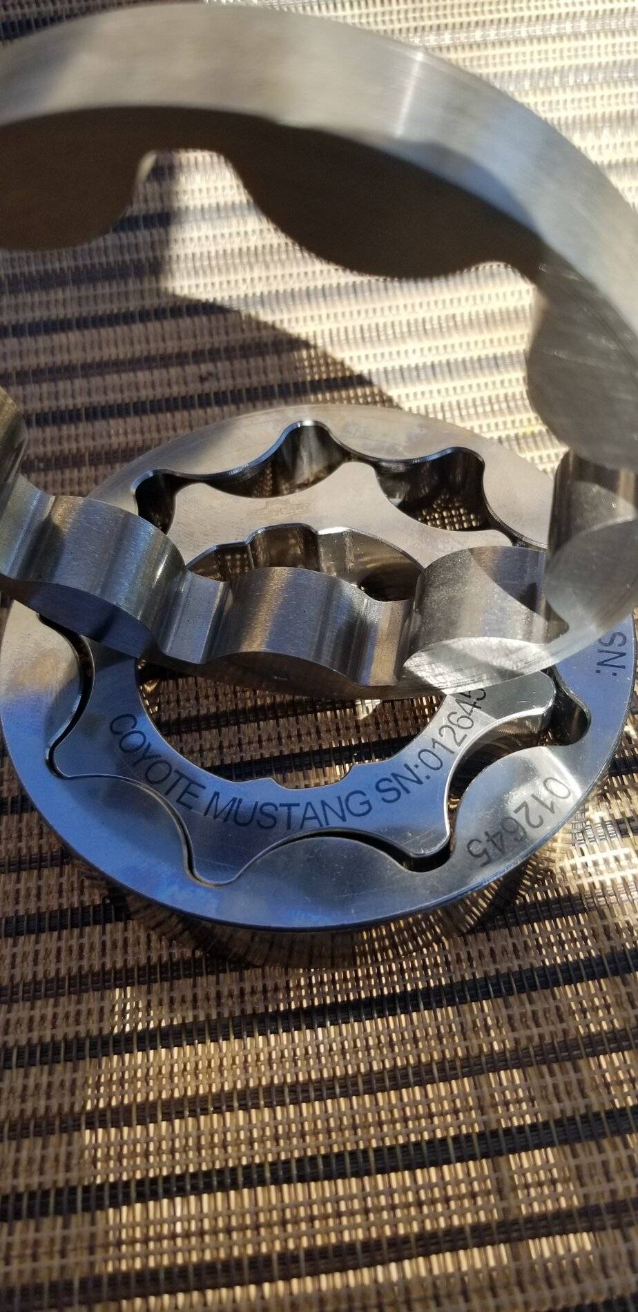

OK, so I've made it all the way through this thread.Just an FYI to general audience reading this very informative thread and may be new to the Ford Mod Motor World and 5.0 Coyote (thanks to @socketman for starting the thread) - the stock OPG should be a consideration for upgrading and here’s a good article covering the “why” of OPG failures:
https://lmengines.com/pages/why-mod-motor-oil-pump-gears-and-timing-components-fail
Notes:
If the car is used hard or is more dedicated to track use (drag racing, road racing or auto-x), where the car sees excessive and sustained high RPM’s, the stock OPG should be upgraded no doubt.
If the car is hardly used, or may just be a daily, a highway runner or grocery go-getter, the Ford OPGs will usually suffice for many miles/years as designed.

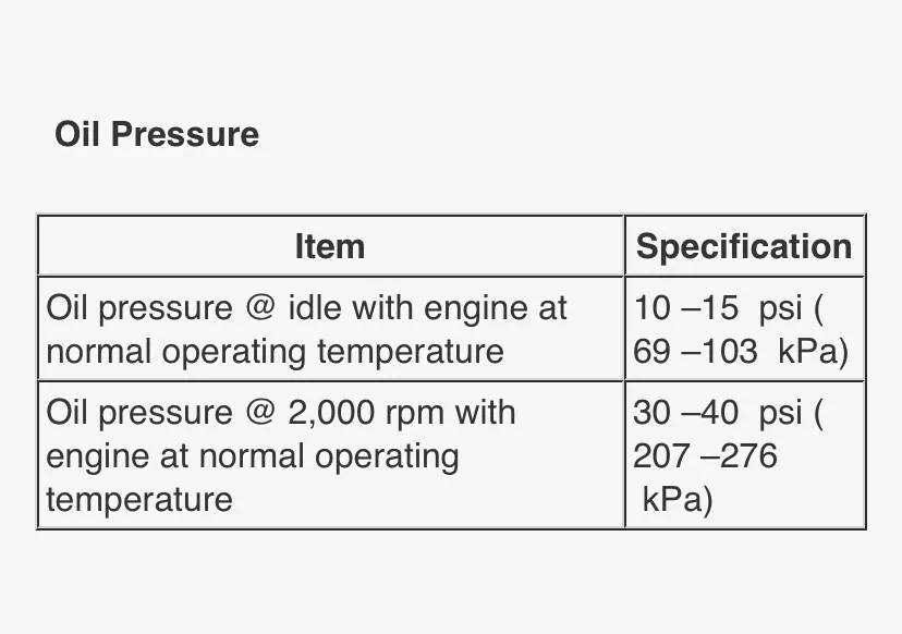

Question: What is the "normal" oil pressure range for a stock GT oil pump?
Granted, this is on the factory dash-mounted OP gauge, but with hot oil I see @15 PSI at idle and 40-50-ish while revving at @3000-4000rpms (I haven't looked what it reads at red line; watching the road at that point). Do those numbers say I have an issue that I should investigate even BEFORE strapping on a blower?
For only semi-frequent street flogging, and @700RWHP, should I go through the effort/expense?
