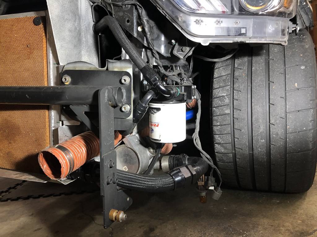

i had to pull my alternator to get at it (and to remove the coolant lines, since i went to a dedicated setrab 650 oil cooling setup at the same time), easy r&r.
didn't use the MMR (improved racing w/ tstat), mounted it here:
Cookiemonster
Dec 18, 2019
79
South of You
2019 M6 GT
Thanks, I was thinking I'd have to remove the alternator as well, but just wanted confirmation that I would.

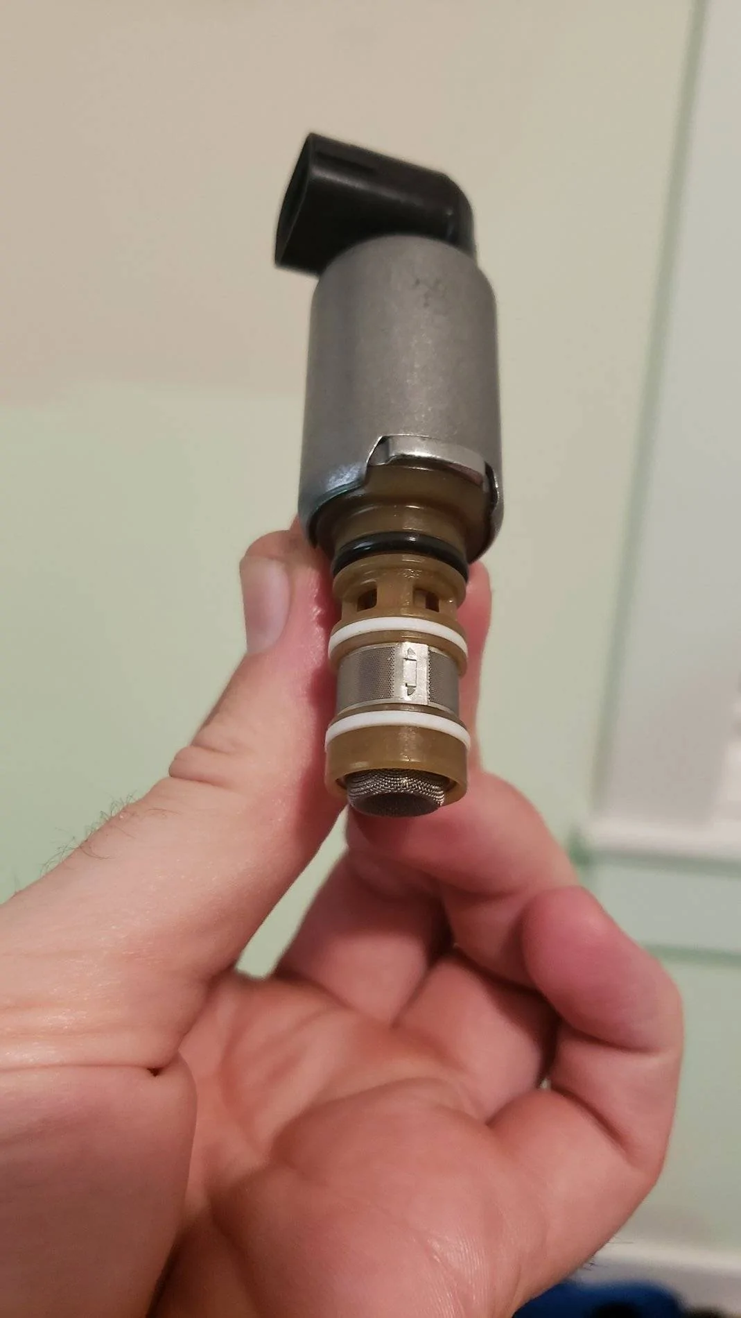

OK - So I took the stock oil crap off after removing the alternator which I had to remove the front anti-roll bar to slide off.
I came across the below solenoid and noticed on the MMR plate going to the block there is no place for it, nor is there on the oil filter adapter plate.
It's part # FT4Z-6C880-B
Here's a link to it and a diagram if that helps...
https://www.tascaparts.com/oem-part...29SpZCE8irdm7-Sm5H4Yq9Ikw8IY43MhoCSDIQAvD_BwE
And here's a picture I took of it tonight...
I just need to know what I'm supposed to do with this part. If it's not necessary and I don't use it, won't that trigger a CEL since I'm not plugging it into the harness? (FYI - I'm obviously still using that sensor since there is a place for it on the new kit).
Help!

I'll try to take a picture of the oil manifold that the above solenoid plugs into so you guys can see more of what I'm talking about.
I'm just trying to figure out if this piece is necessary and if it will throw a CEL, how to get rid of it.

The 2018+ Gen3 Coyotes have variable oil pressure controlled by the ECU. It’s supposed to improve fuel economy.
Yes, the ECU will post a code when that oil pressure control valve stops responding. I don’t know if the engine will enter limp home mode though.
Cheers,
Well shit. Thanks for the response.
Logic tells me I can't be the only one with an 18+ who's using an oil filter relocation kit/remote oil cooler kit where the stock piece is being removed.
Hopefully more people who have done this, mmr or other brand, will pitch in - I don't want to install headers and the motor mounts back on just to have to jack up the car and take them off again bc I needed to somehow tap the unit or swap it out for another.
To be fair, MMR said that this kit was completely compatible with 18+ models, so I'm not sure how they we handle this issue...

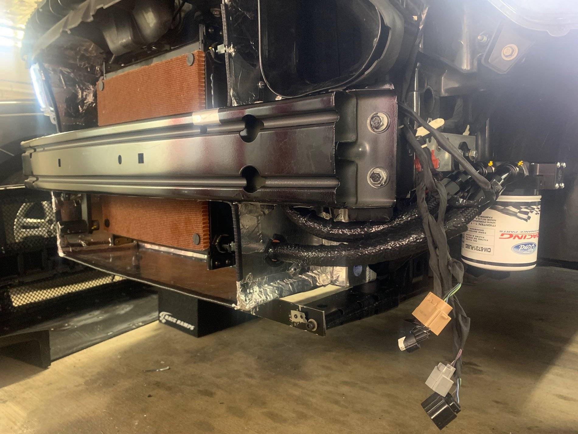

The stock water/oil cooler works very well - would not remove that if you can, and run both your MMR cooler and stock cooler. I run a Setrab 948 with an Improved Racing remote oil filter mount/t-stat and Improved Racing remote oil plate. Depending on your use the MMR kit on its own may be insufficient.

Appreciate the advice, but I've heard enough good things about having a remote oil cooler and ditching the stock one that I feel fine with just installing the MMR kit and calling it a day. HOWEVER...
The problem remains of if the oil bypass valve or whatever the hell the part I listed above is called can be left off the system without any negative effects (CEL, limp mode, etc.) or not. I wish someone did this on an 18+ and could tell me...
