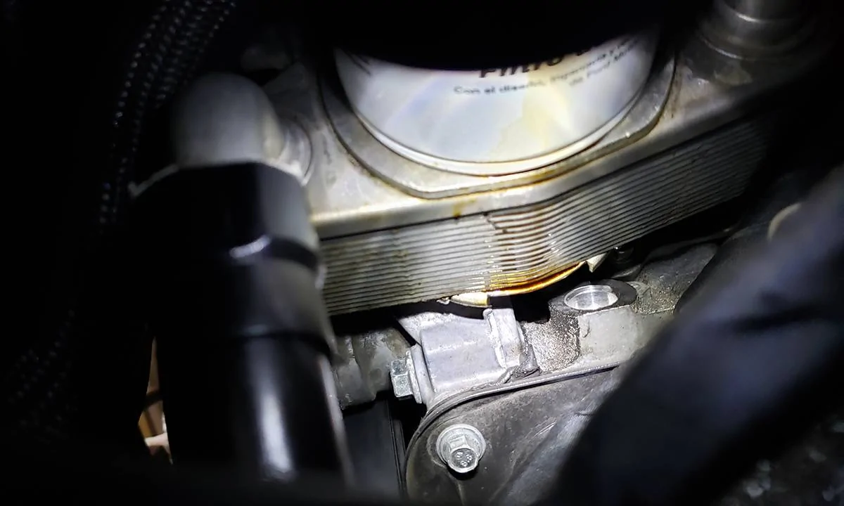

Hey OP, if you still have this issue, did your oil filter assembly look like this? With the oil leaking from the mounting adapter and not the filter?

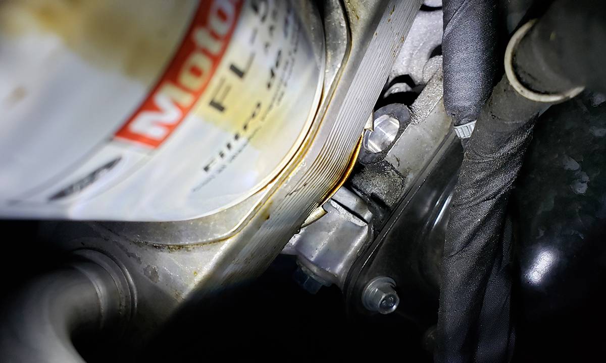

Here is a different shot of the oil filter adapter.
I have this problem on my 15 Roush. What did you do to fix it?
Took it in as it was under warranty. It was a defective oil adapter/cooler assembly. It took almost a week to get it all sorted out.
Good luck!
