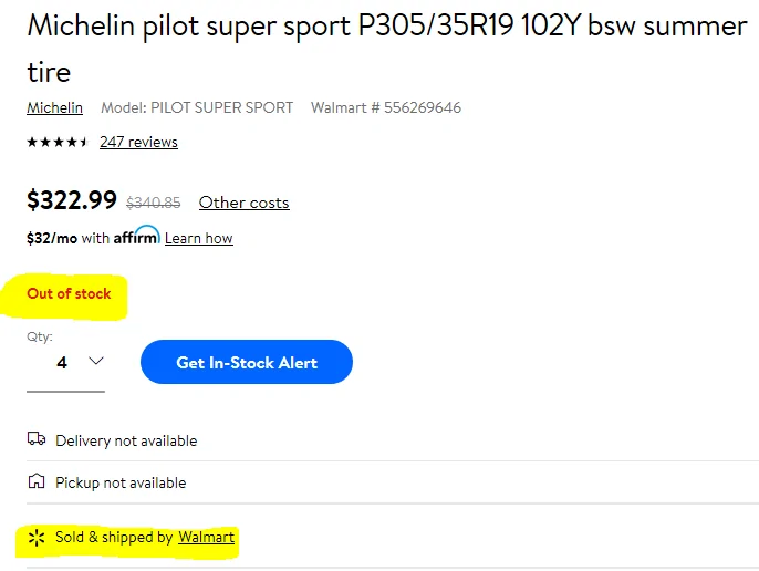

And this just happened...

Well, being you can't find these tires anywhere else, it was expected for them to sell out. Now to see if the orders that got in actually show up...
