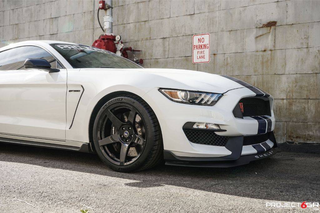

Project 6GR 5 spoke in gloss black. Pic is not my car but close. Mine is a 2020 HEP be here in early May .

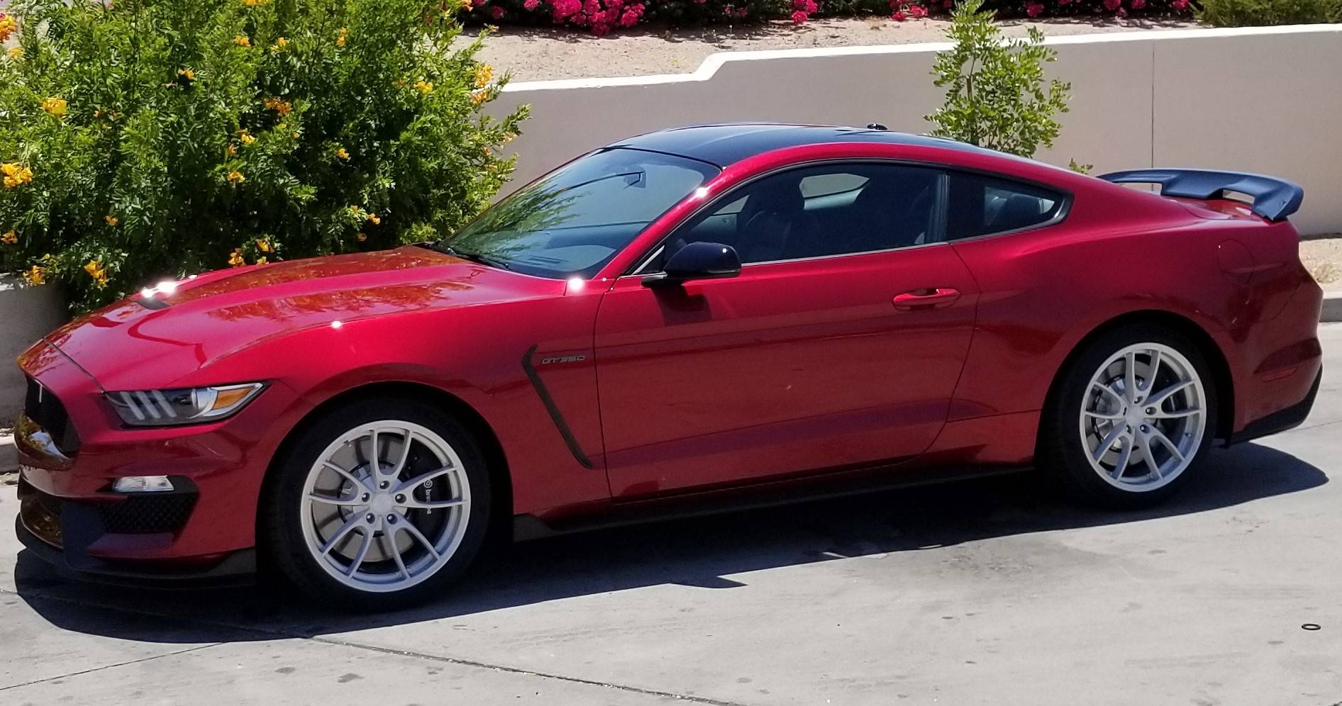

I put 295/35/19 PS4S on all 4 corners with my CS-21 wheels and have zero regrets. I used forscan to adjust the speedometer and love the setup. I did not want to use a 30 series tire as I did not want to lower the ride height any.
I almost bought those wheels, they do look great!
