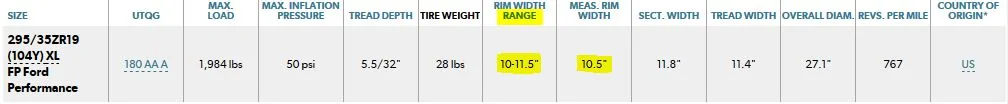

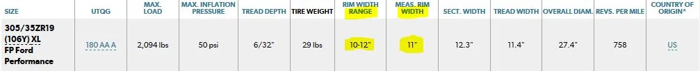

If you have a base, your wheels are 10.5x19 (Front) and 11x19 (Rear). R's are 11x19 (Front) and 11.5x19 (Rear).
Looking at the OEM tires (SC2's) you can see what the recommended wheel sizes are:
While the 295's will "fit" on any wheel between 10" and 11.5", the Measuring Rim Width (AKA - Design Rim Width) is the target width for that tire to meet its dimensional standards.
Same logic for the 305's in the rear.
https://www.tirerack.com/tires/tiretech/techpage.jsp?techid=199
