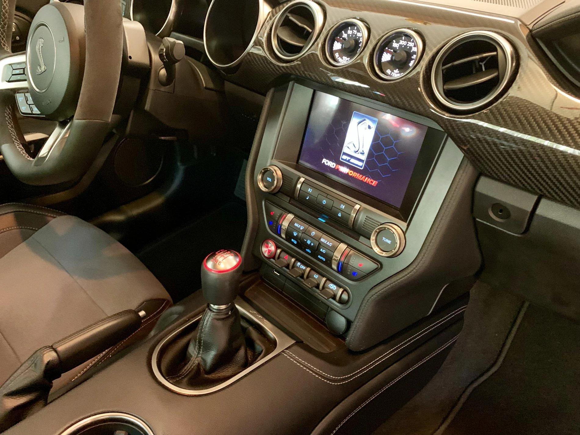

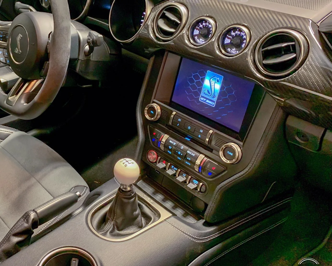

I highly recommend the MGW Shifter for the GT350. With the stock shifter I found it too easy to go from 2nd into 5th and a couple of times into 1st! Fortunately those couple times weren’t at high revs.
The MGW is much more crisp and precise, love it!
My plan was to use a white ball, but when it was installed the shift boot was stretched and I didn’t like the look. So, I stayed with the stock shifter, which I think looks best with the interior.
Here are photos of both knobs on the MGW.
