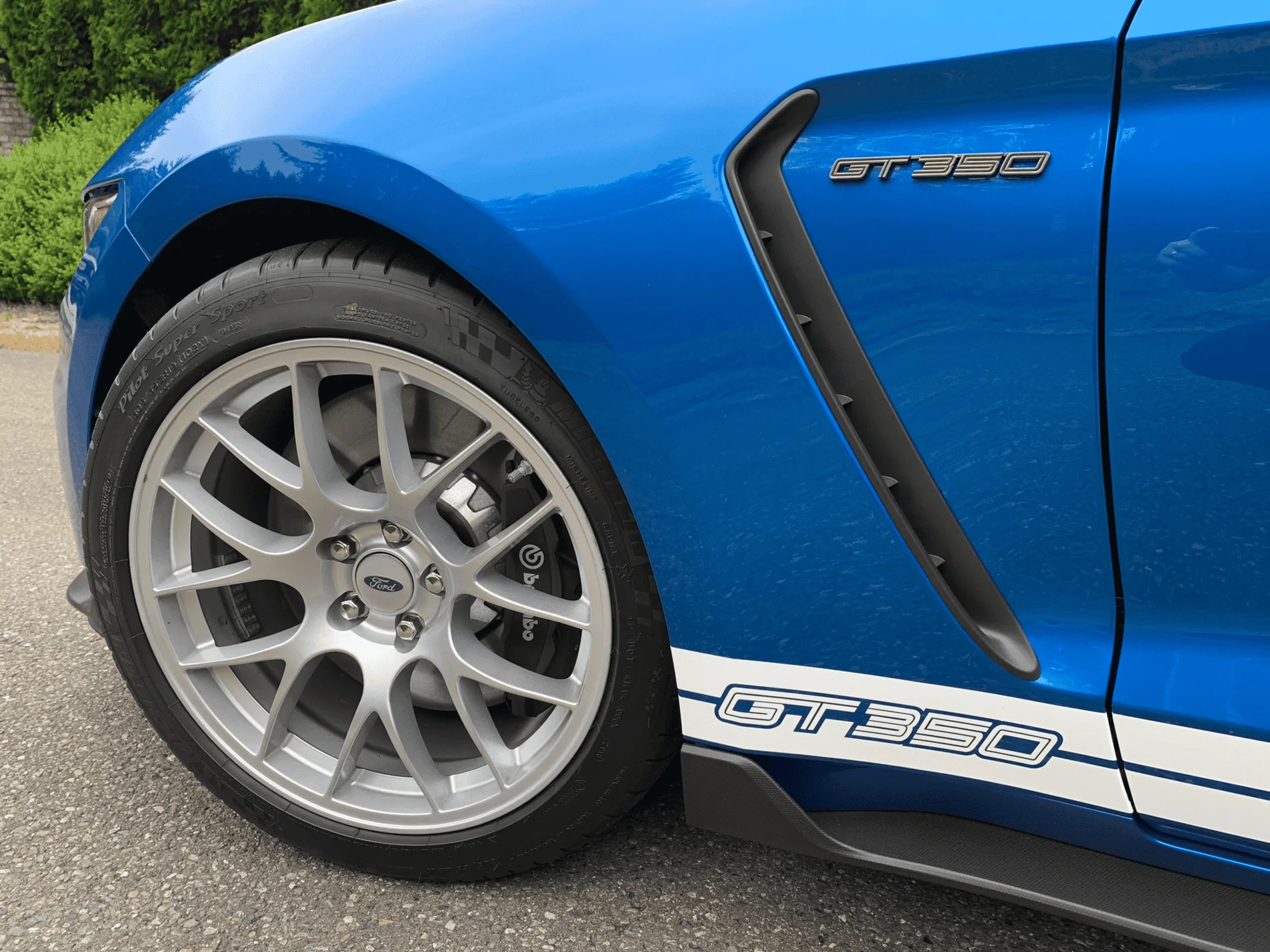

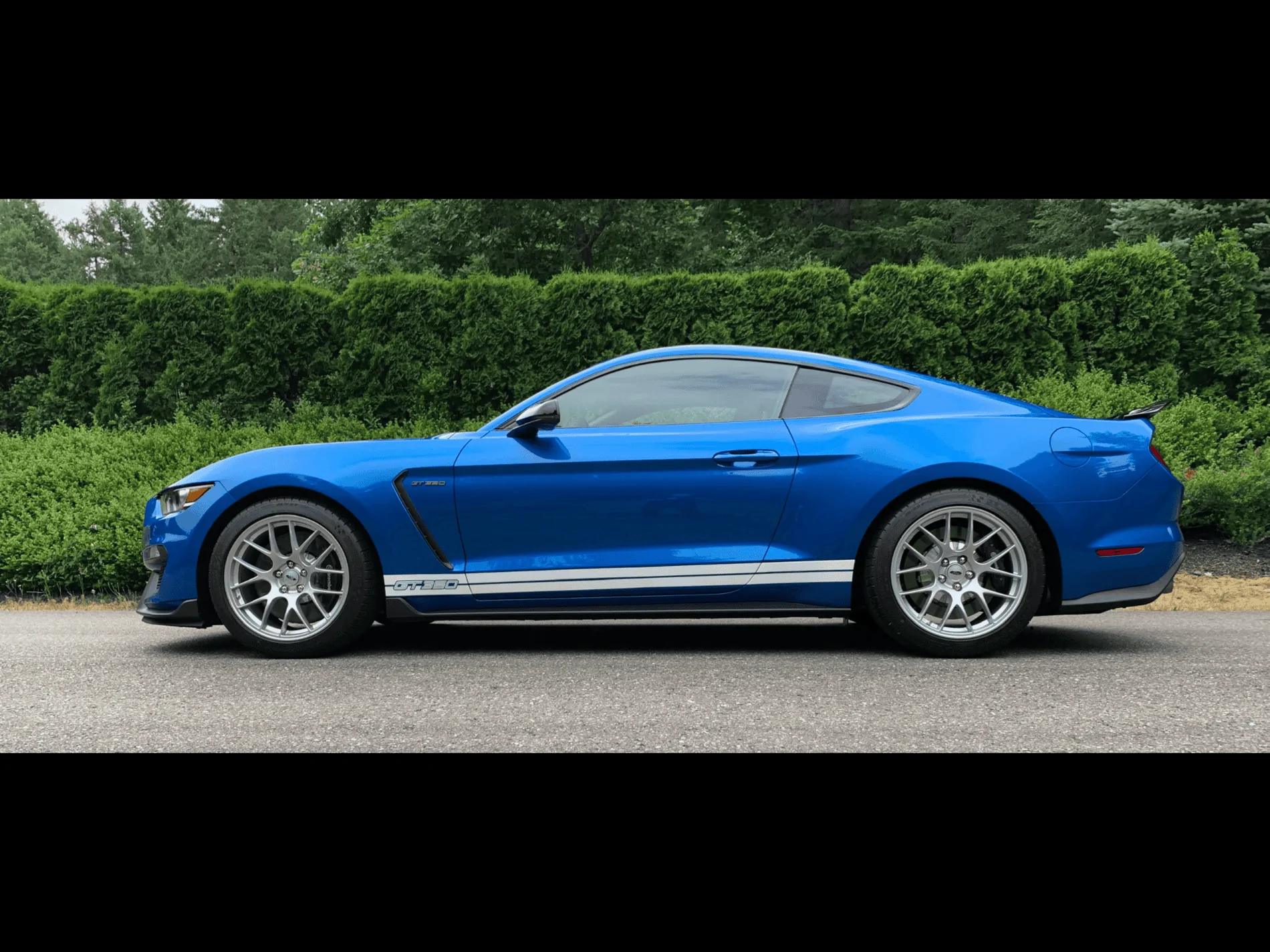

Very Very nice. I like the rim setup. The Ford caps in blue are a nice touch as well as the side stripe. Congrats !

Really like it! Super clean and like how the wheels brighten it up. Enjoy the new beast!

I like those wheels! Really gives the car a performance/classy look! Details on the wheels?

The Apex EC-7 wheels are Race Silver and I used a 19x11 square setup with 305 Pilot Super Sports. The fronts require spacers and longer studs, I had the studs trimmed so I could use the stock lug nuts.
I found the center cap "tops" on eBay (Dimension: 65mm. Material: Aluminum base, curved base. Emblem is self-adhesive, it uses adhesive sticker in the back just peel and stick.). I heated the caps that came with the wheels and removed the Apex center cap top and stuck the ebay emblems on.
