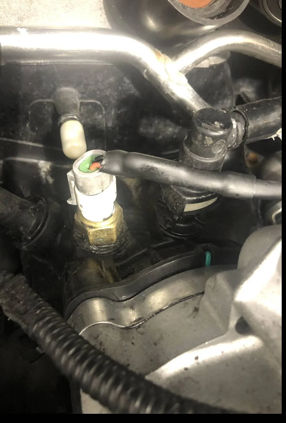

Where are you guys tapping the plumbing? I just ordered my Snow 2.5 kit, spoke to Lund, ordered the VMP IAT sensor y breakout wire. My assumption is in the charge pipe between the MAF and Throttle Body?
yea that will keep any siphoned fluid and or any that doesn't get into the shut TB off of the maf hopefully.

Anyone ever tapped into the intake for the IAT sensor? I'm reading that's the best spot but I'm scared to death to tap into a plastic manifold.

I'd rather not buy another manifold but I appreciate ya. I'll just tap mine.
