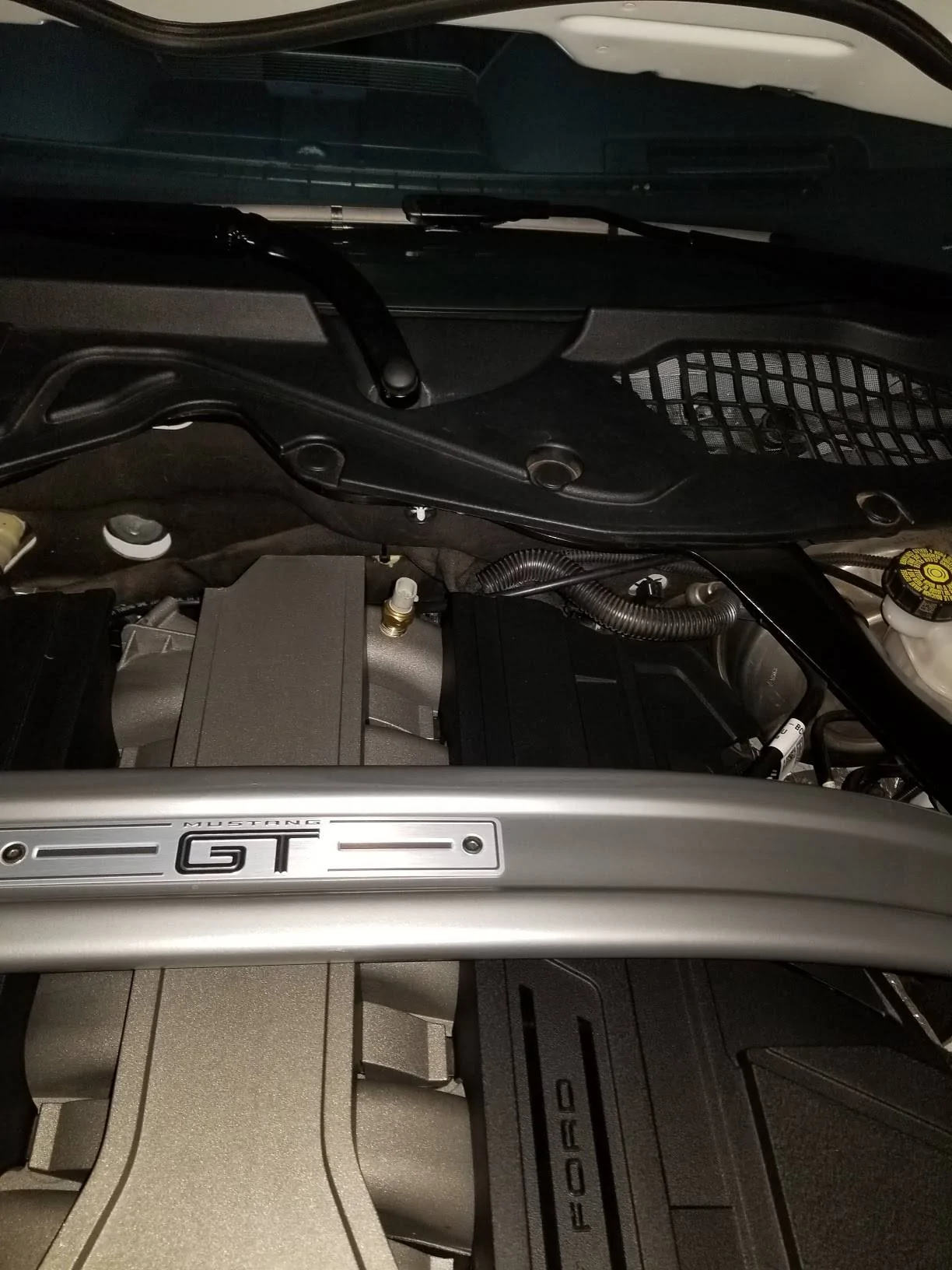

Here's my IAT sensor in the #8 manifold runner as Lund recommended. My meth nozzles are located in the charge tube, about 4" after the MAF sensor (I'm running the GT350 tube).
