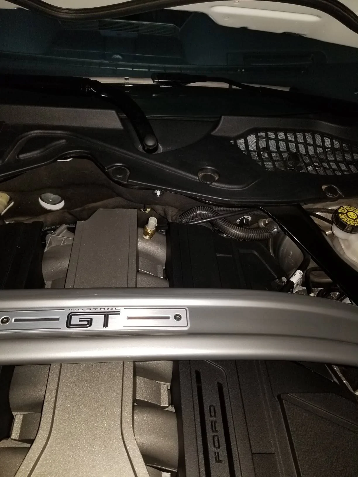

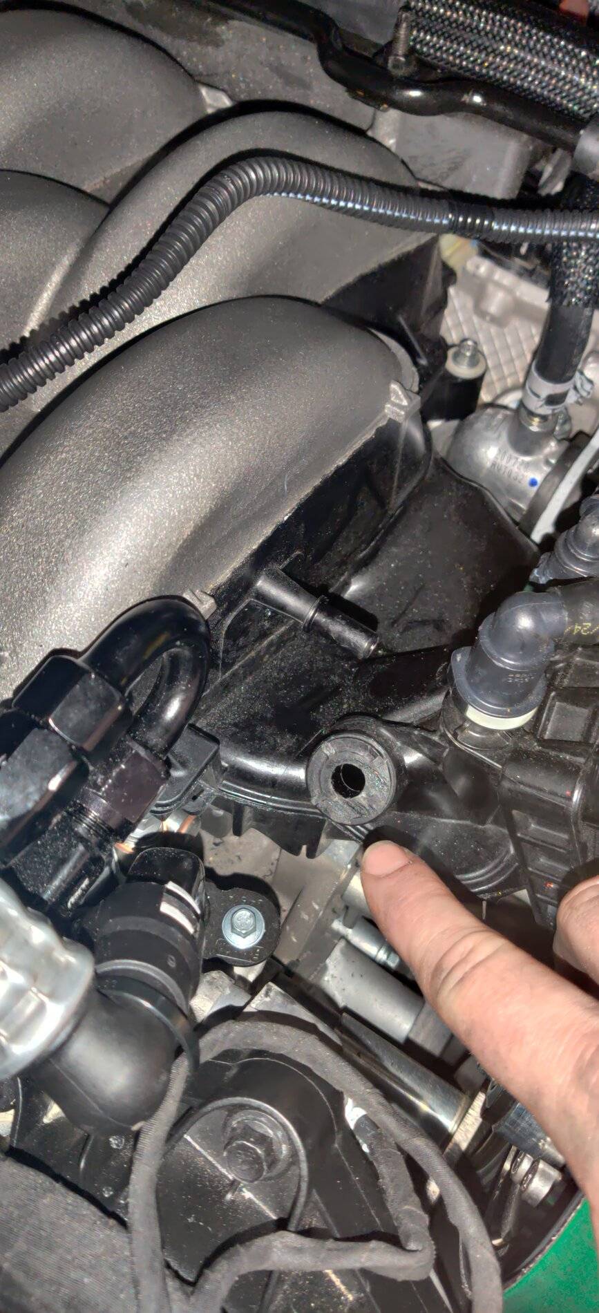

Planning on putting the temp sensor in the intake. Pic shows the vac fitting (the larger one) I am trying to remove. Is it threaded or press fit. I've tried twisting it some but don't want to break it.

Dremel worked, drill and tap tomorrow hopefully it isn't hollow.

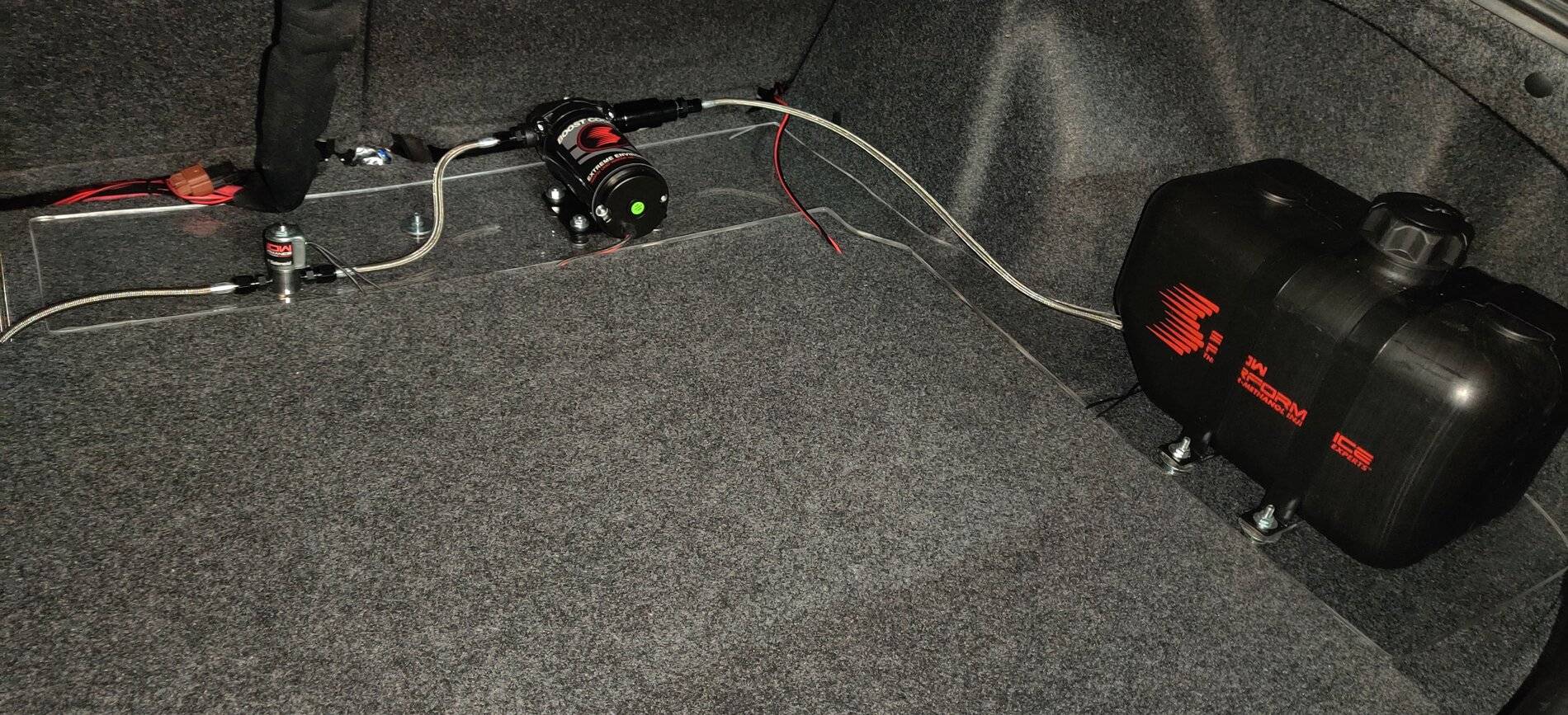

Trunk done, gauge done, wiring done, nozzle done, just have to drill and tap, waiting for Amazon. Hopefully it goes well as I am so close to finishing this. Probably not though if things go as usual.

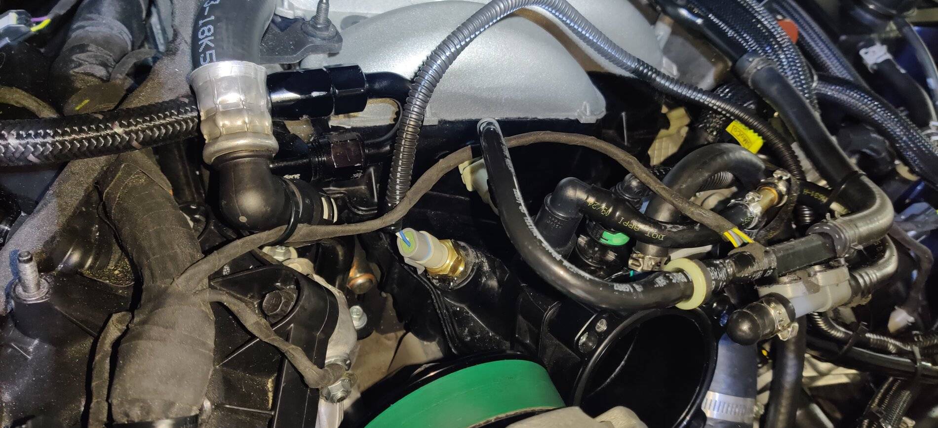

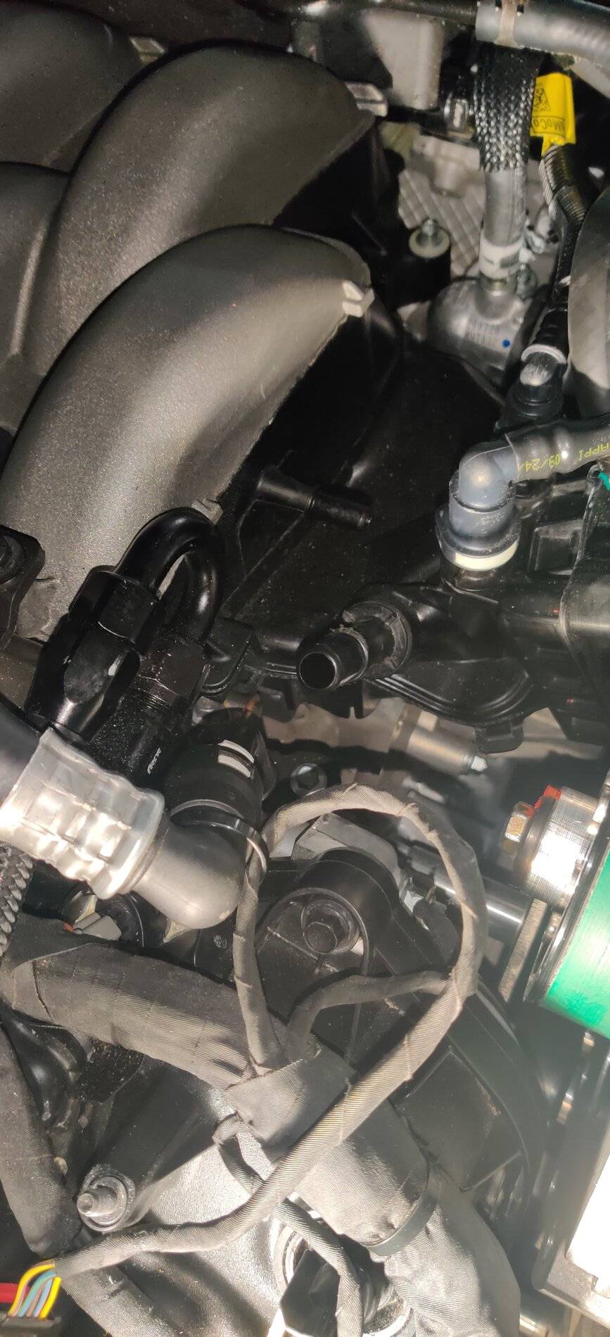

Took it slow, drilled up, tapped it, threaded it, hopefully holds pressure.
Need to clean up wires.

It will hold as much psi as the intake. The reason not to put the sensor in the runner is because the material is very thin so you only get 1 or 2 threads. There’s a much higher chance of the sensor blowing out. The vacuum port is very thick. Lots of material to tap.
