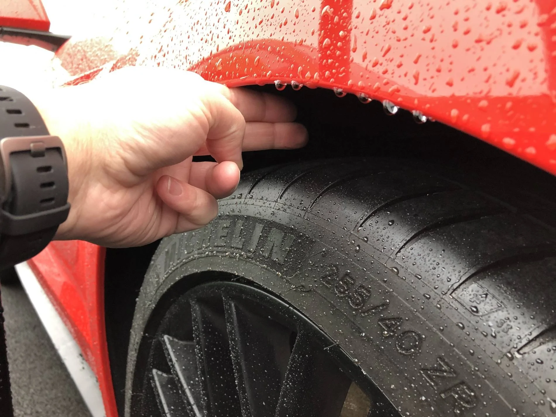

It also makes it more difficult because many of the cars I saw with the lowering springs look like they sit higher than my OEM PP1 Magneride height somehow..
I know you are comparing MR to MR, but I do think the MR cars sit a little lower than a standard setup :
It would appear that UK MagneRide cars may actually be a little different ... ?
Make your own mind up :

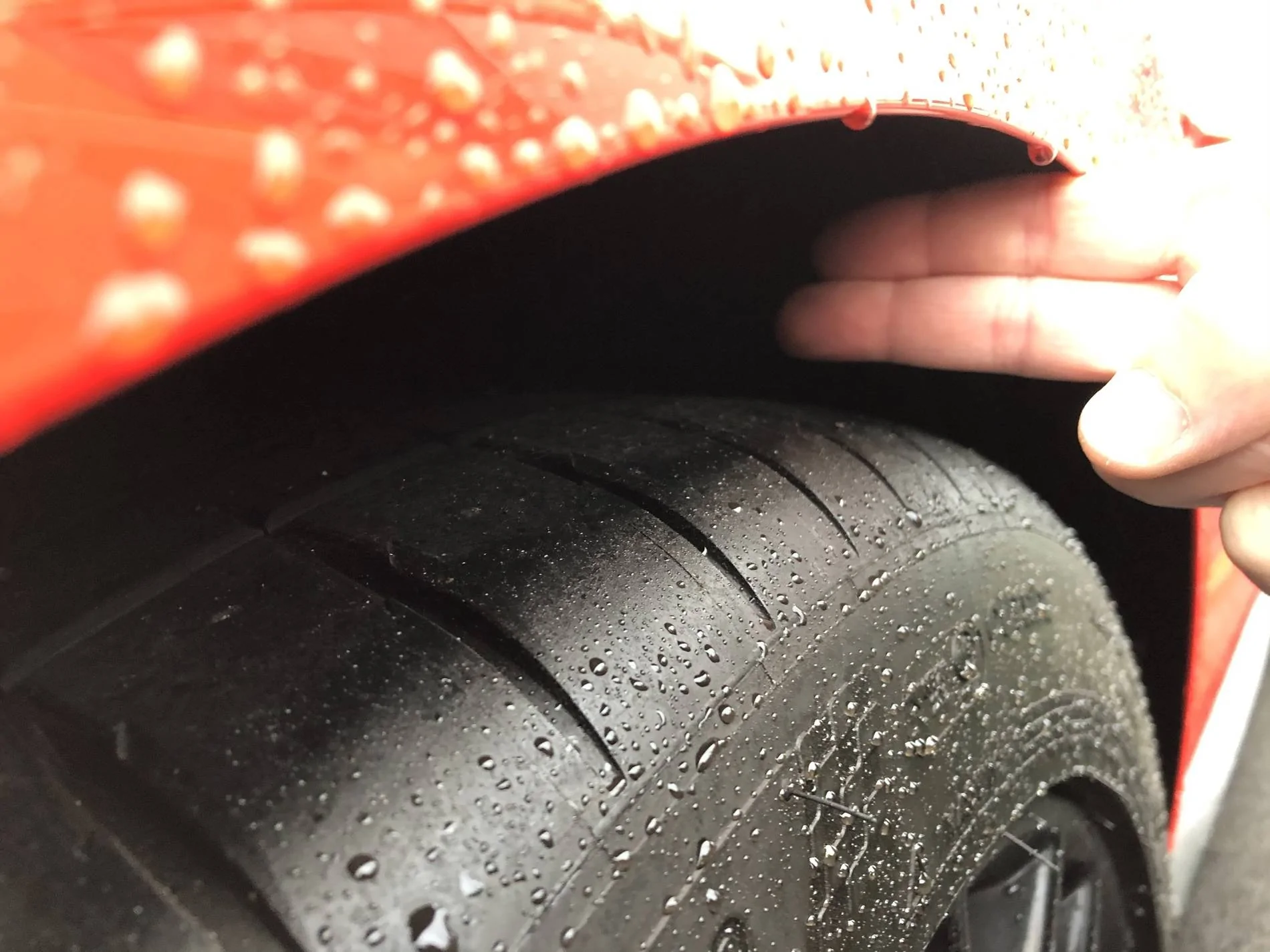

This was the first MR car my local dealer got in and it was also the first facelift. Rear tyre gap doesn’t look as big as some I have seen :
But that could be very subjective due to my arse being sat in it and the angle of the photo etc but ...

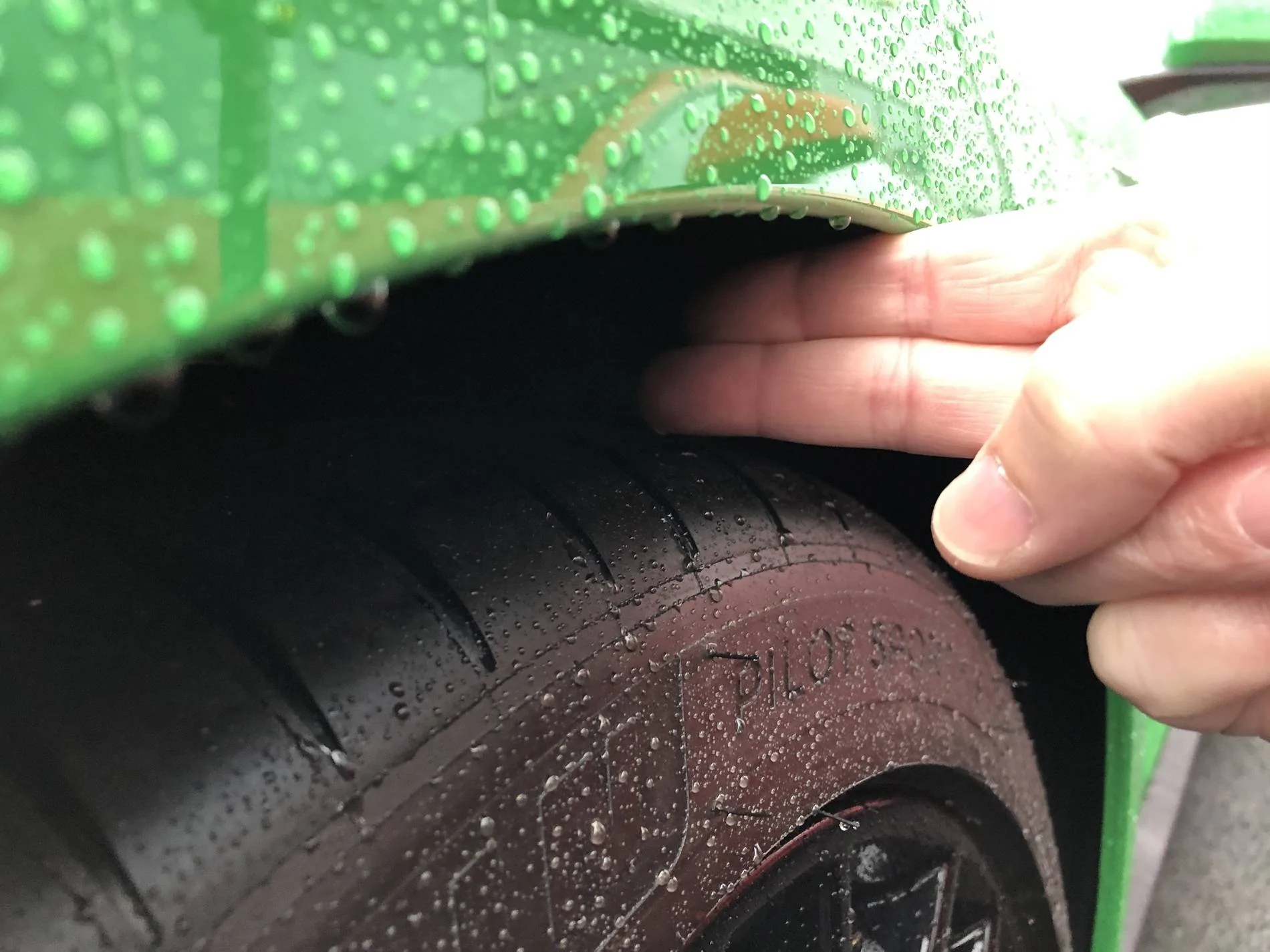

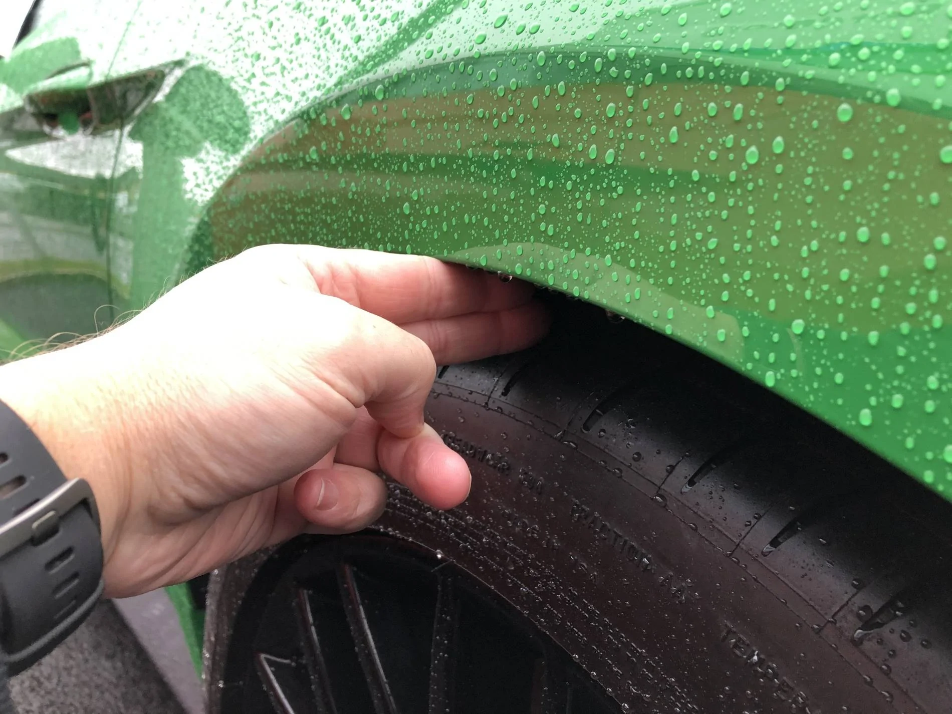

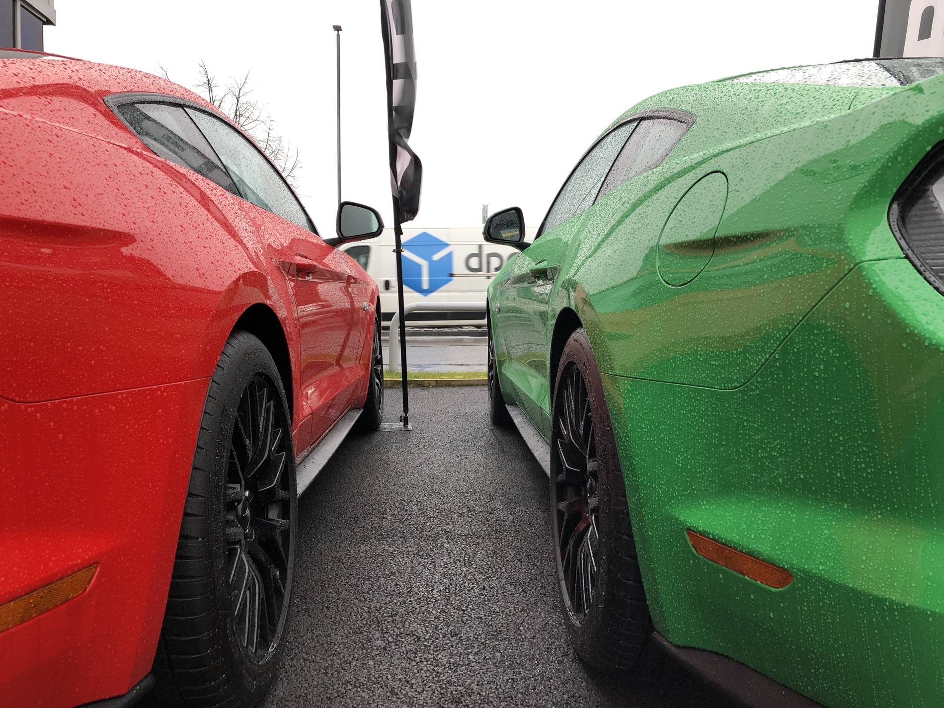

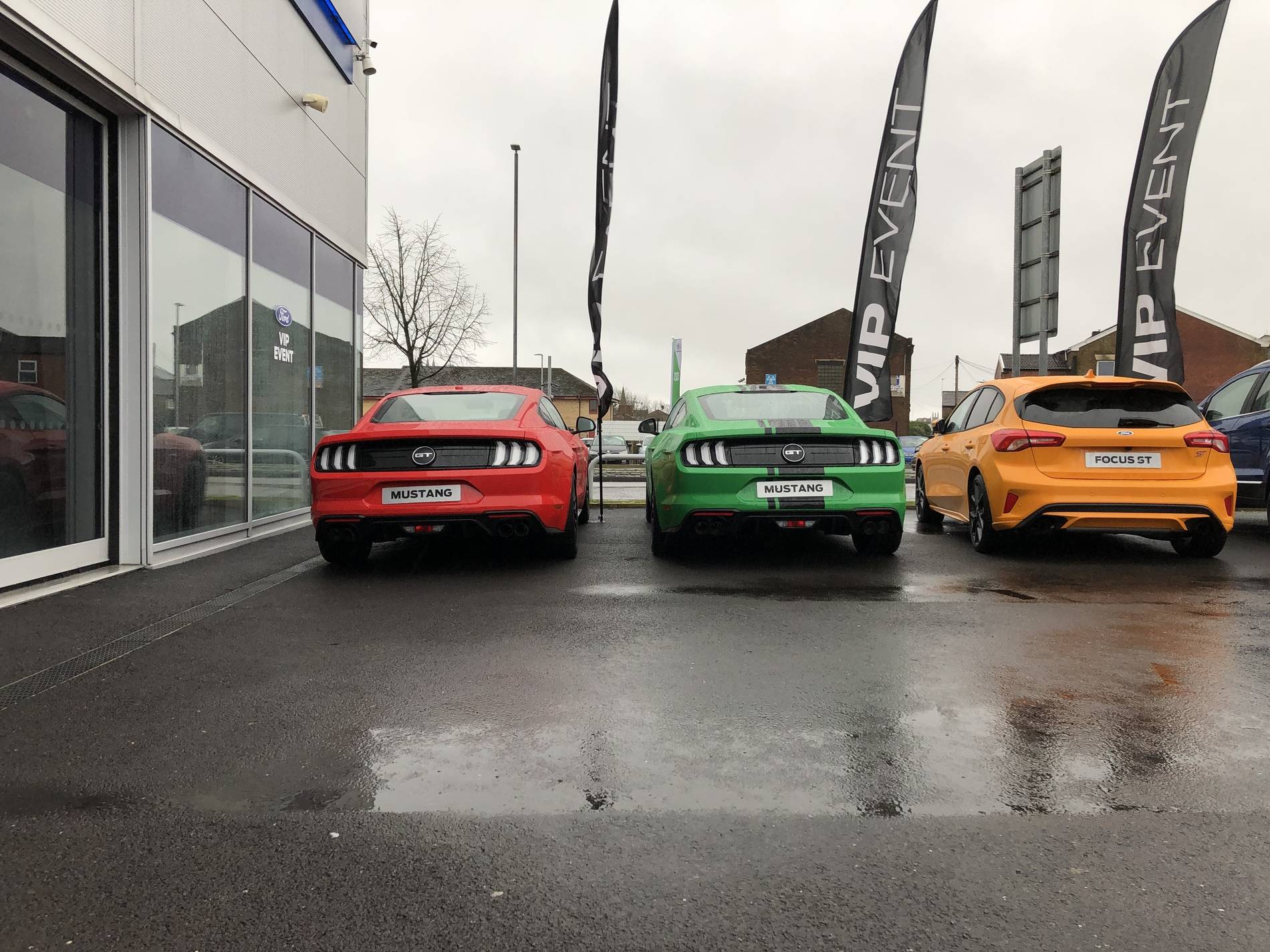

Toady I got to view two new unregistered UK cars, sat side by side for comparison. The green one is a MR car :
Rear - two fingers are a tight fit / won’t go in (:shock: :cwl:) :
Extra clearance on this one :
Exactly the same on the front :
Green MR car sits a little lower, even considering the fall of the ground :
It’s difficult to judge, but I also think the MR cars rears sit a little further out ? (Check the fist comparison photo looking down the side of them). Maybe it’s just a byproduct of being a little lower, but I don’t get the same feeling about the front ?
So what do you think ... ?

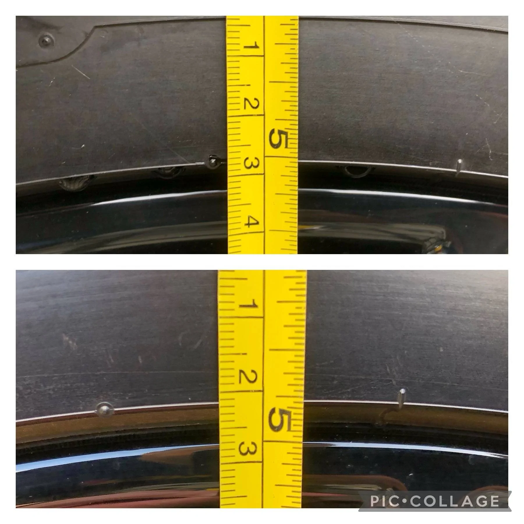

Only explanation I can think of is that they didn't clock the springs properly or something to do with the bushings? It's perplexing.

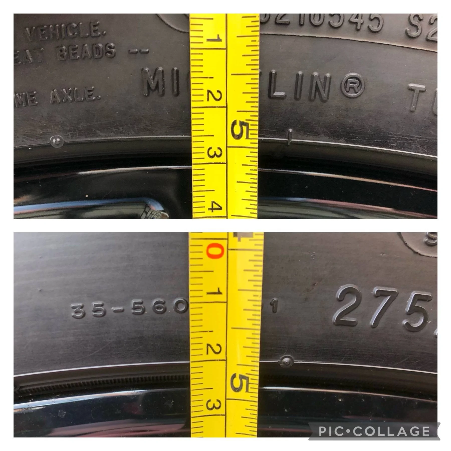

My experience from clocking the toe link knuckle bushing only :
OK, I know this was on the rear, but after having some suspension work done and the car settling for approx three months, I finally decided to clock the toe link outer bushings.
It really surprised me … :shock:
Using the arch to the line in the tyre moulding, I dropped 5mm from the right side :
And 6mm from the left :
Remember, this is just from one bushing :like:

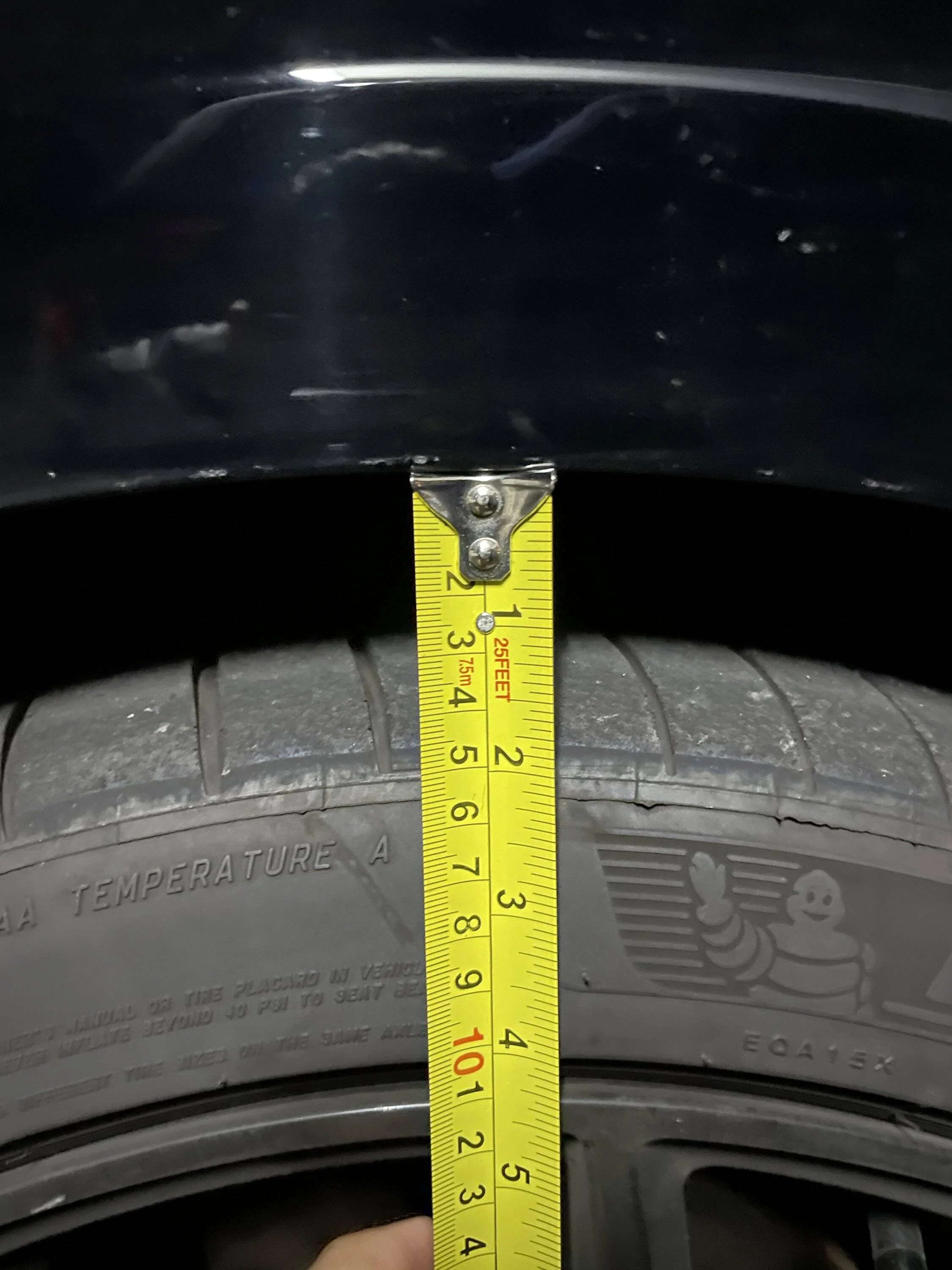

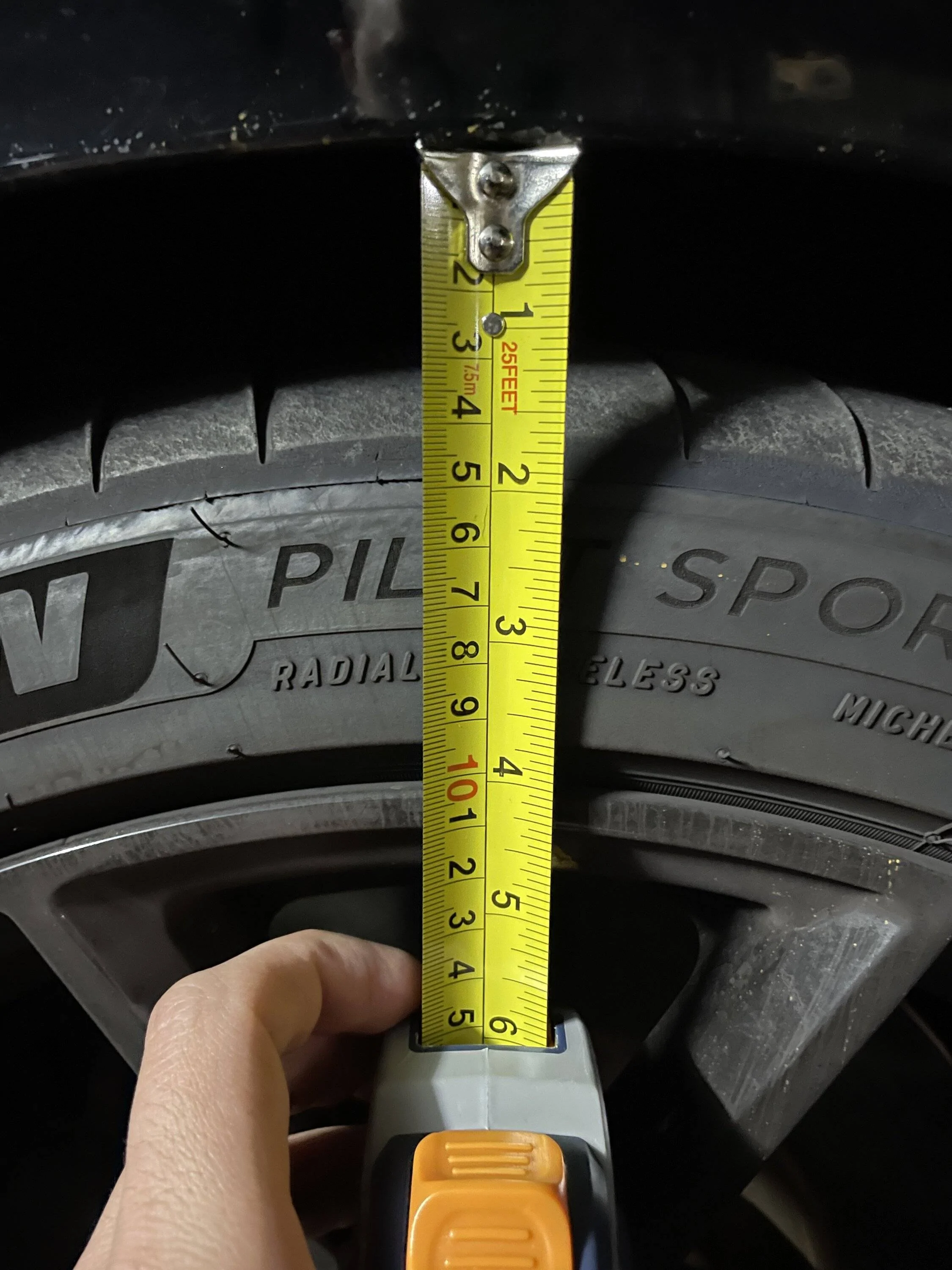

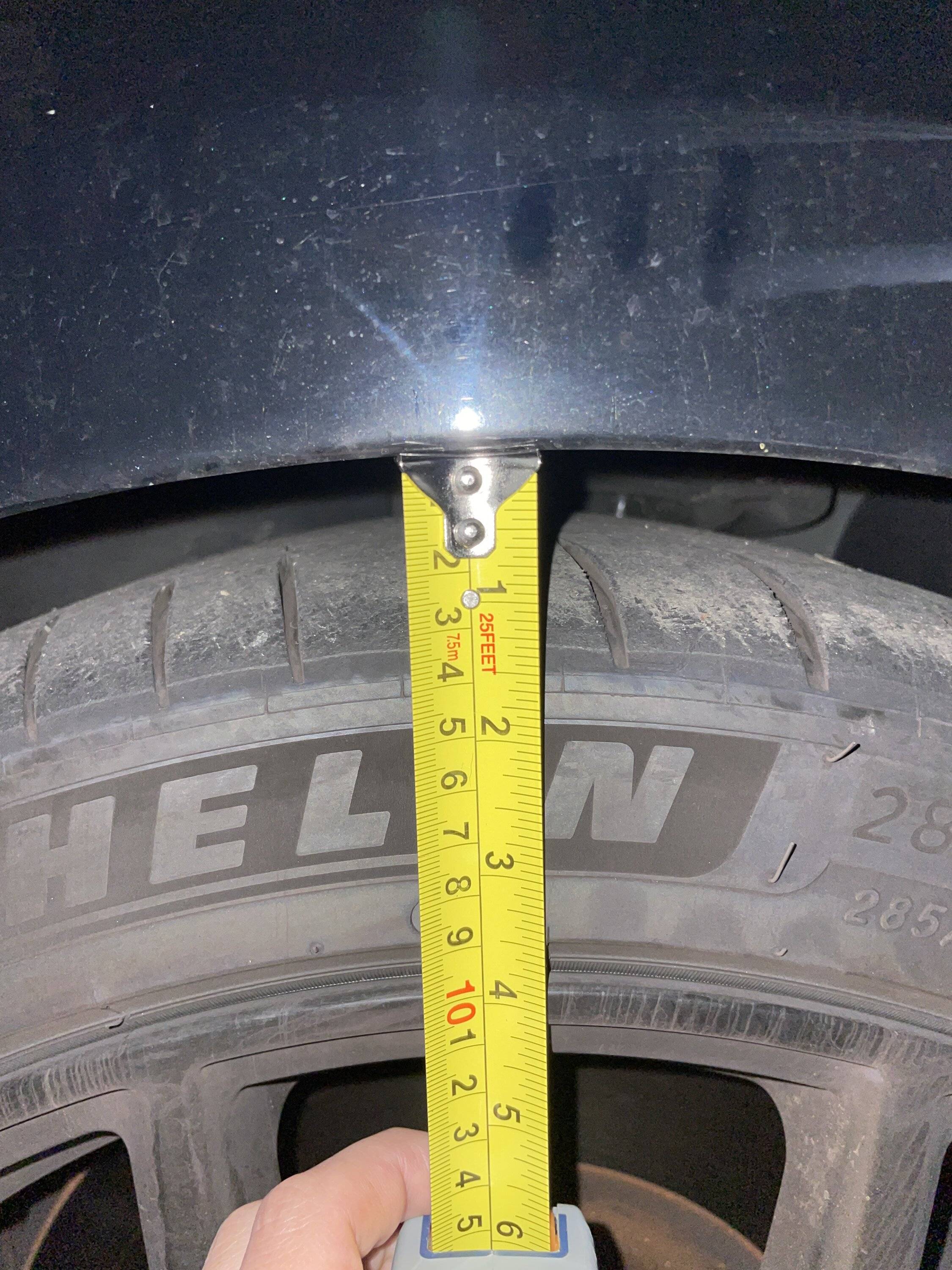

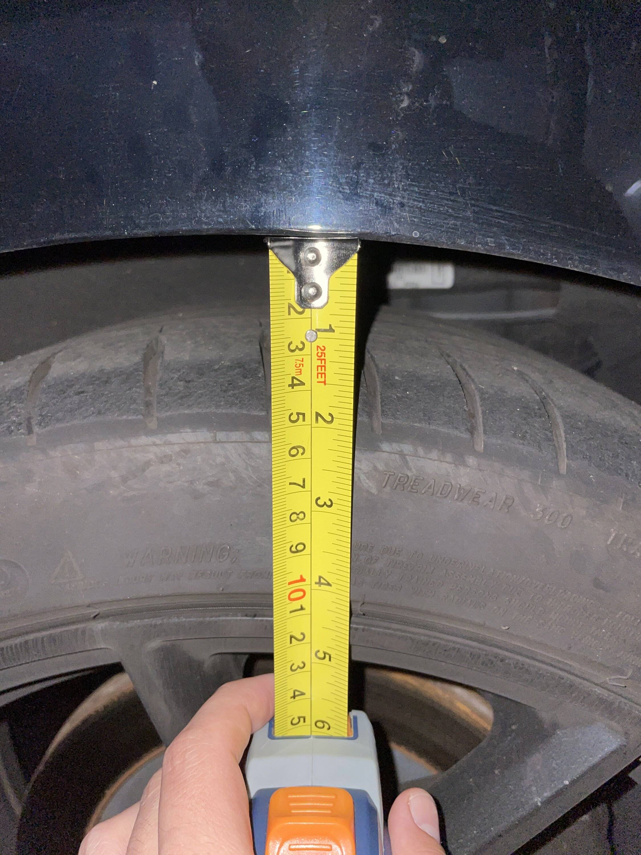

Here are some wheel gap pictures I took tonight - Rear gap is pretty even side to side, but the front two are completely different height(prob due to failed strut).
Assuming I fix the strut and the fronts are level again, springs with 0.5/0.75 inch front and 1 inch rear drop would look great imo. Maybe Steeda DR up front and Steeda Lowering springs in the back would get me there. This would also be ideal/optimal spring rate setup according to many other forum members (Stiffer front, softer rear). Although not sure if that is still optimal with my OEM PP1 sways.
Two separate mechanics have told me that I probably have a failed passenger side front magneride strut.
Passenger side front (Failed strut)
Driver side front
Driver side rear
Passenger side rear
