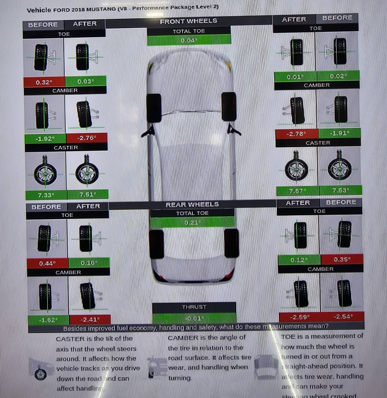

On another note, took the car to a performance alignment shop and asked for 2.75 degrees front and 2.25 rear. They set the front to 2.75ish but then couldn't get the rear under 2.5. They said I would need rear camber arms to get it back into spec since I'm lowered. I'm barely lowered than OEM and I think they just had a hard time getting the camber dialed in. They said 2.5 on the rear is a bit excessive but shouldnt be a problem for performance or wear.
Thoughts?

Just want to close this one out and let everyone know that I ended up needing to install the steeda rear camber alignment kit. Went to a different shop who got it done right. Rear was just not aligned properly initally.
