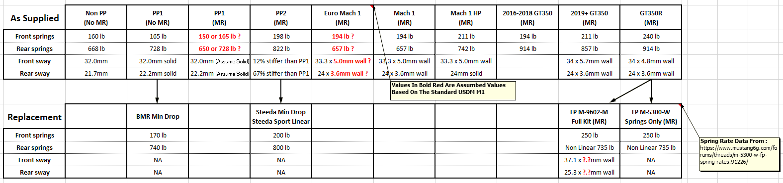

Now I have a couple questions and options with rough prices:
All are some variation of OEM or GT500/M1 dampers(not S197 GT500 magride), 5300-W springs, and/or full M-9602-M kit with VDM calibration.
1. Replace fronts with OEM PP1 dampers and be done with it for $950 total
2. Replace fronts with OEM PP1 dampers and add 5300-W springs for $1300 total
3. Replace fronts with OEM PP1 dampers and add M-9602-M kit for $2200 total
4. Replace fronts with GT500 dampers and be done with it for $1100 total
5. Replace fronts with GT500 dampers and add 5300-W springs for $1450 total
6. Replace fronts with GT500 dampers and add M-9602-M kit for $2300 total
7. Replace All dampers with GT500 dampers and be done with it for $1600 total
8. Replace All dampers with GT500 dampers and add 5300-W springs for $1950 total
9. Replace All dampers with GT500 dampers and add M-9602-M kit for $2800 total

your use case doesn't call for spending $$$$ unless you really just want to.
I just reconfirmed with BMR that the SP084 spring is a 1"+ drop (ick) and 246lb/in. So since the -W springs are similar rate but 20mm drop, go for those.
You don't need sway bars and I wouldn't buy bonded-bushing ones anyway. The VDM would have been nice to have but I think it only really matters for Track mode, and not the lower levels. So not really of any great importance.
The POINT is to replace the old GT350/PP1 dampers with the new ones because there is where the benefits are.
I can't confirm the M1/GT500 SKUs but your parts department can. And yes, they are totally plug+play.

I'll echo Shogun. W springs. Hold off on bars until you know you want them. You can buy the aftermarket ones separately, and that would probably be best. I question how necessary the bigger rear bar is.
The new GT500 dampers are 'dumb' 2-wire devices, so completely plug and play. They look identical. Because you're changing the physical damper, you don't need to change the VDM. The current the VDM supplies to produce the damping forces will stay the same as it ever was, you'll just have more damping force everywhere, because the dampers make more force for a given input.
Changing bars is not a particularly big job. They can be done whenever. You'll want to do the springs and dampers together, though.
If you're pinched on cash, then just do the springs and struts. The rear dampers are also a relatively easy swap and can be done later. Since you're not throwing a bunch of rear spring rate on it, it will still be acceptable with the stock rear. The GT500 version will help keep the rear overall motion more controlled, particularly on larger, 'roller' bumps.
