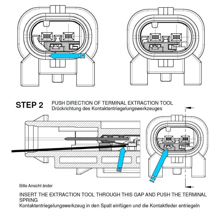

Anyone have any experience how to remove the upper shock mount on a magnaride car. I would think the plug has to be removed to get a socket over the wires. If so what did you use to de pin the plug? What's the torque on the nut?

I think the confusion here is not the shock from.the car, it the mount from.the shock I'm looking at doing. Want to change the stops for lower springs. It appears you have to de-pin the plug

I think that since cable comes out of the top side of the damper and through the mount, plug wouldn't fit thought the hole to move mount to the new damper. I looked up manual procedure, it's completely silent on this (unbolt damper, bolt new one in), if the damper comes with the mount, that might be the reason.

Here you go.
