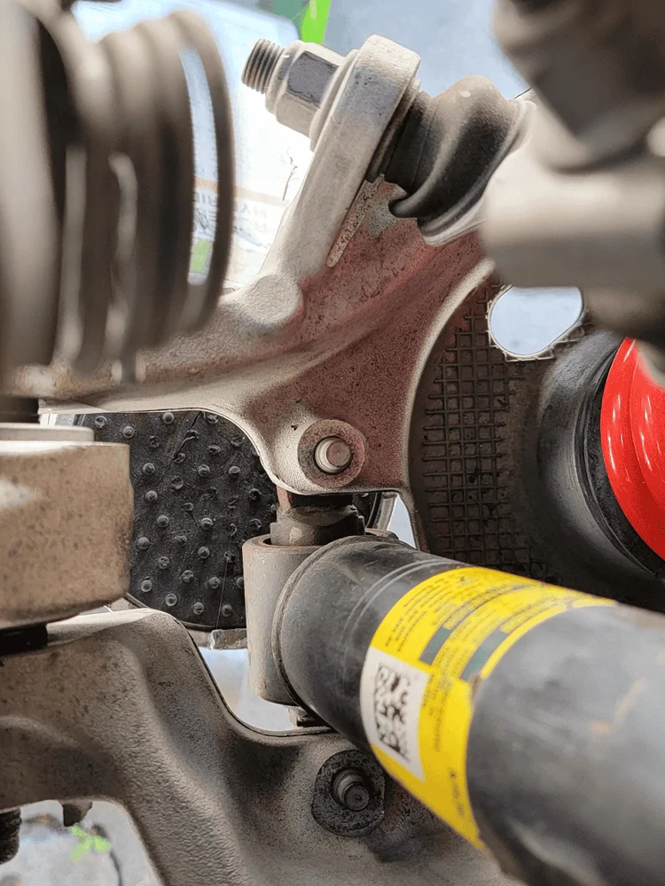

Any one ever have success removing the rear shocks from the lower control arms? I got them out when the cadle was out. Doing it in the car is a different story. I just can move them around enough to get them out. It's like a evil genius designed the opening.
Getting the Magnerides out of the top of the wishbone is bitch, because the housing around the bushing is about 2mm too wide to get it to pop out of the hole. It's just big enough that it tricks you into thinking you can do it.
Tuning on the opening with a die-grinder makes this job a lot faster. It's a completely unstressed chunk of aluminum in the way. Take a couple mm off and it's in/out easy on jack stands.

The stupid part is that there is just no need for it to be tight at all. There is all sorts of extra material on the control arm. Open up the hole a couple mm and it's Easy-peasy. You can see I've taken a smidge off that one corner and now it's in/out with no futzing about.
