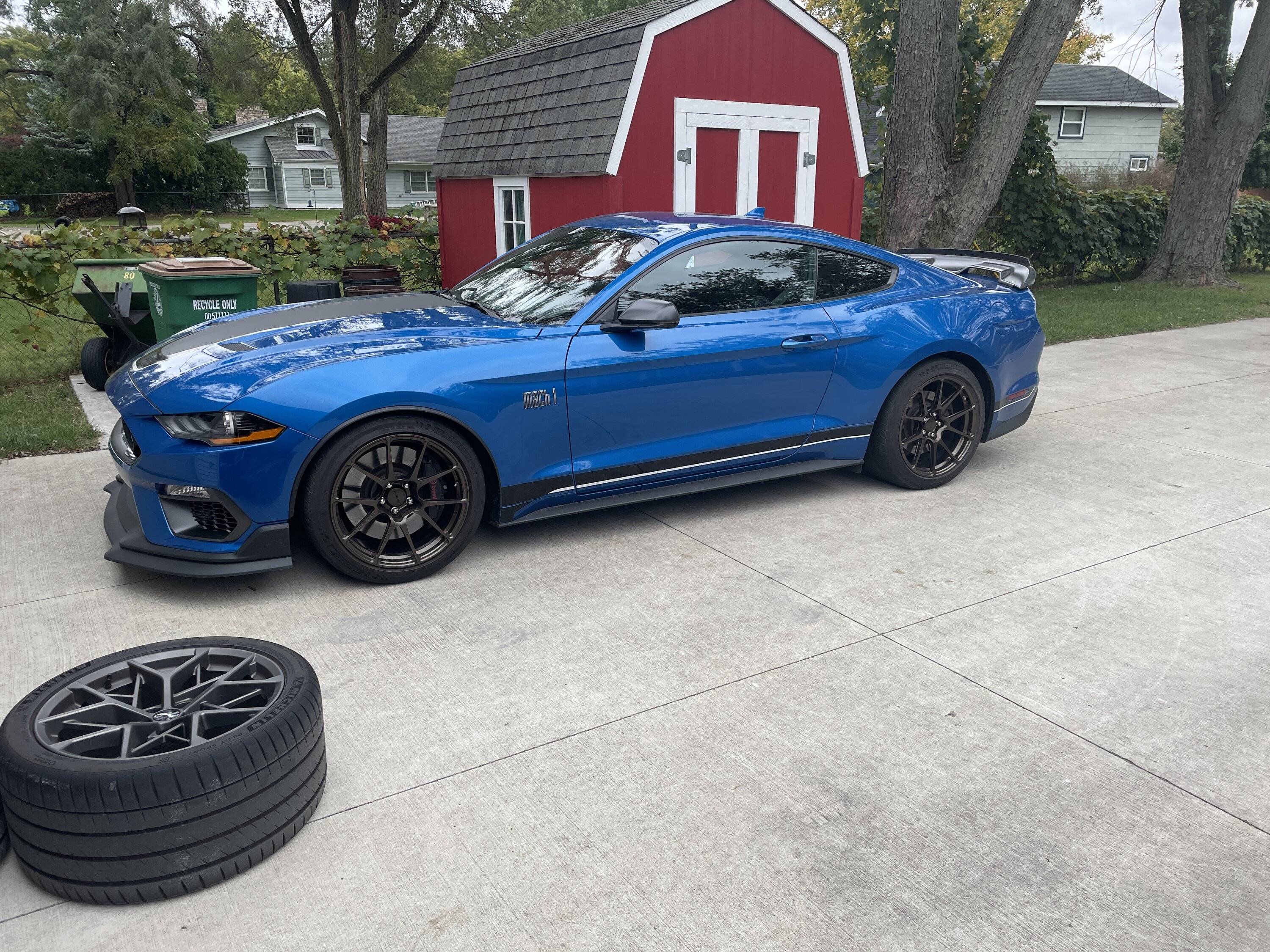

I can comment on the Apex wheels. I used the EC-7 for track. A lot lighter than the Ford Performance wheels.

Thank you. I think about 7-8 lbs lighter per wheel (Apex 23-24lbs; HP wheels 32-33lbs). I can't speak to whether this is noticeable on a 4,000+lbs car (with driver) but I like the idea of having a stronger (in construction) wheel and one that is easier to clean.

Yeah I suppose if I lost 30 lbs I would get the same results and it would be a lot cheaper.
The EC-7's are just over 24 lbs and the HP wheels (rear) were around 32 if I remember correctly. I purchased EC-7 ET52 with 2 spares and used 1" spacers for the front to make up the front offset. I also used GY Eagle Supercar F1 3R -305/30/19 and went square. So I have some spares if I mess up my tires on track and can use them front or rear.

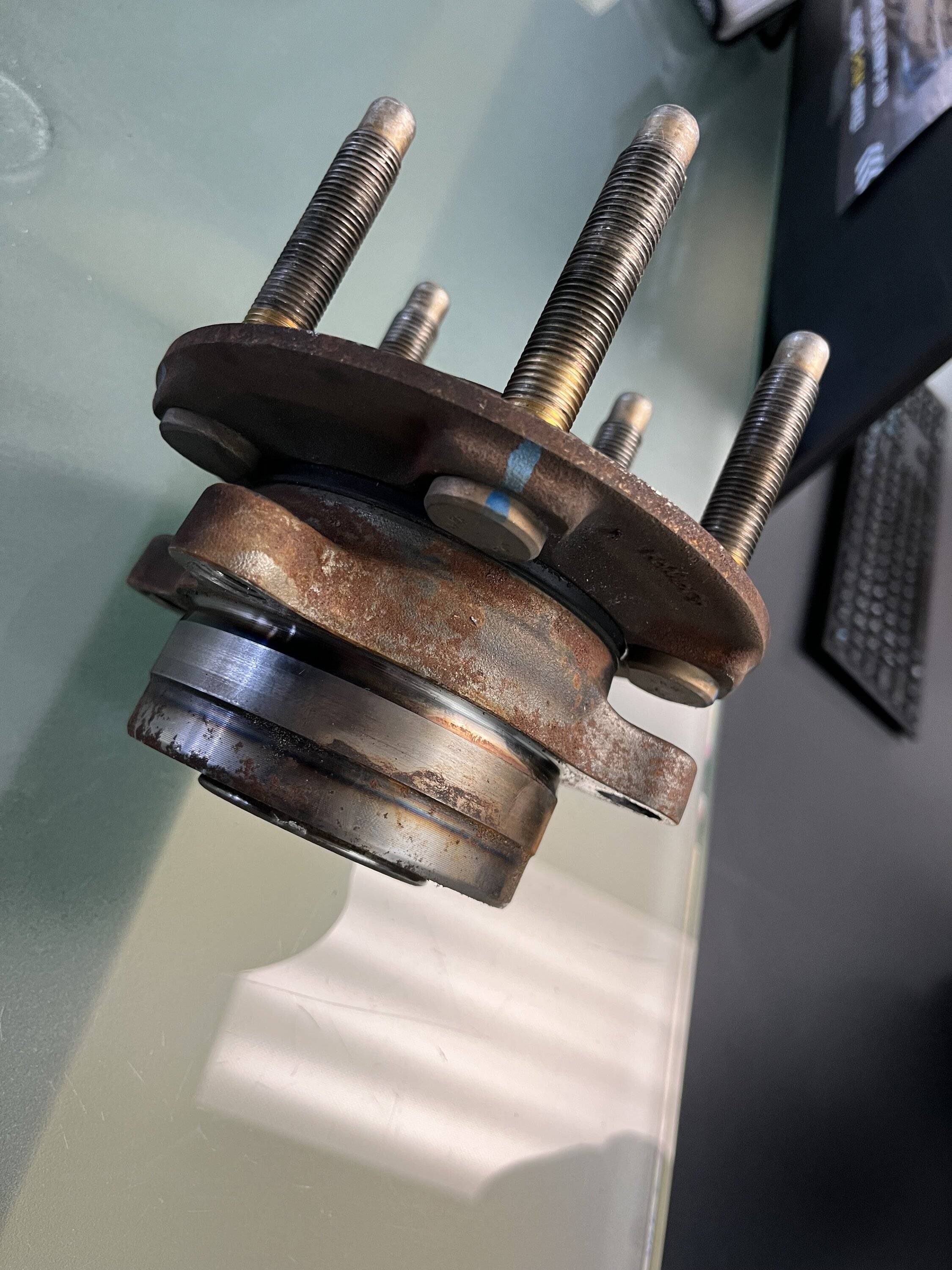

Funny you should say that. I had a front left bearing fail last year and got it replaced under warranty. Where did you get this information from? I would like to investigate more as this could be the reason of the fail.

Okay thanks for the link. I read through it. I am no expert BUT I can understand if you increase the offset therefore altering the position or as they mention the scrub radius, you will put the extra stress on the bearing etc. But because the front offset is 25mm, by adding a 25mm spacer on the ET52 wheel, you get a 27mm offset bringing back the wheel to the exact same position (well almost by 2mm). So you wheels don't poke out any different and the scrub radius is the same. The spacer puts the wheel back to it's original position.
That's my thinking but then I could be missing something.

Yes, that's how I look at it, too. But then I remember reading somewhere that wheel bearing failure can lead to a serious accident (wheel seizes). Not sure if they fail from one moment to the next or if one could tell that they're gradually getting worse. I guess with age comes anxiety, haha.

When mine failed, all the assists on the dash disabled showing many errors. They said it was the Tune Ring and sensor and the dealer replaced the entire hub. Let's hope we don't get any of these bearing seizures.
