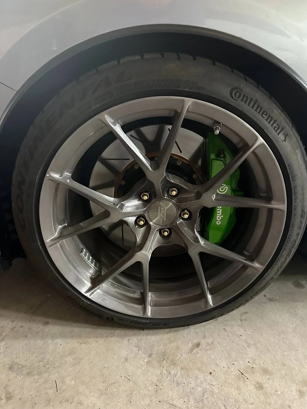

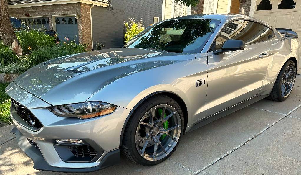

I did originally have these wheels on the stock studs. Fronts are 19x11 +24, rears are 19x11.5 +56. (GT350R fitment) No spacers. I have 305/30/19's on the front, and 345/30/19's on the rear. I did have to swap out the rear shock mounts to the J&M mounts (only ones I could find that would work with Magnaride, but still had to modify the cap they provide for the wiring, which also requires de-pinning the connector)
I now have ARP studs and Titanium lug nuts installed, just cuz.
