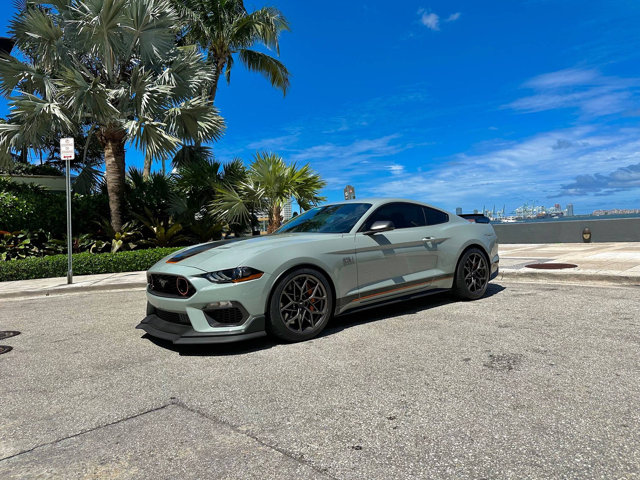

HP wheels mounted.. I think they don’t photograph as well as they look in person.
Will probably get a set of APEX wheels for the track in the future but just super happy with the HP look (and m5300w springs)

Oddly I don't think the car in general photographs well which I don't fully understand.

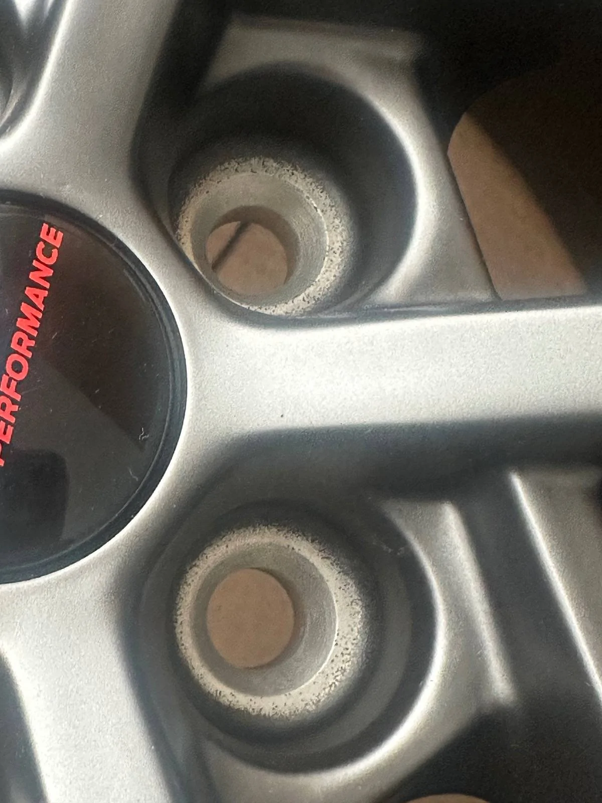

Anyone else purchase the HP wheels set from anywhere? I got mine from Levittown. So far two have come in and they seem to have very small dings and imperfections on the inside of the rim. Is this normal for casted wheels? (Hard to photograph)
Also, quite the paint job…
Those tiny marks are a non issue. The nature of you driving your car will give you much bigger marks eventually. It's on the inside as well.
As far as the lug nuts pockets go, those will be covered and even if you did have Powder Coat on the seats they would instantly chip off as soon as you torqued down your wheels.
I think your good to go OP. $1300 well spent.

Concerned about tiny tiny imperfections on the mass produced heavy AF Ford cast wheels? on the INSIDE of the rim? I'm not even sure the Concours d'Elegance judges will notice that.
Wait until you see what the tire shop monkey's do to them.

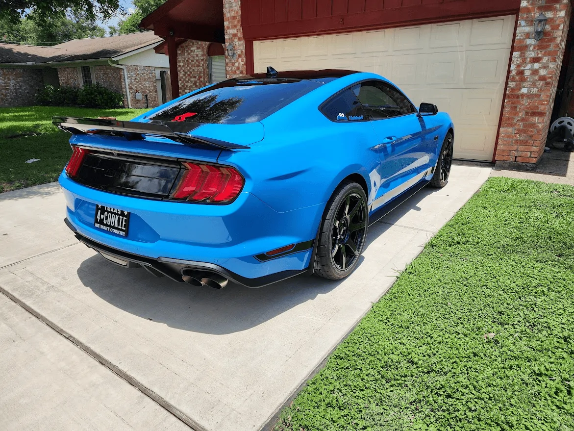

Sorry for the delayed response, i was on vacation. I went with the 305/35 for the rear. So now its 275/35 20 fronts and 305/35 20 rear on stock suspension. I don't think i need to lower the car at this point as I'm happy with the fitment and don't scrap on the driveway.

Yeah, you might regret lowering it. The 305/35 is quite a bit taller than the stock tire that the car came with, so that's why it fills the wheel well more. My preference is to keep within .5" of stock overall diameter, preferably closer than that. On 20's, that's 295/30-20.... I was set to go that route, but the wheels I wanted were on indefinite backorder with a minimum of 6 months wait time, so I went with my second choice, which I'm loving so far, actually. It keeps me in 19's, which I like, and allows for a super fat rear tire, but same-as-stock overall diameter to retain gearing. My car is 3.55:1, so I don't want to lose even more gearing with tall tires. 325/30-19. That said, I also do not think I'll be lowering the car, or if I do, it'll be with Ford Performance or Steeda minimum drop springs. Maybe .5" lower... It looks good to me. Maybe that slight .5 inch, but I'm unwilling to give up ride quality and ability to get into the driveway without scraping body parts. Heh. **car not a Mach1 -- is a GT.

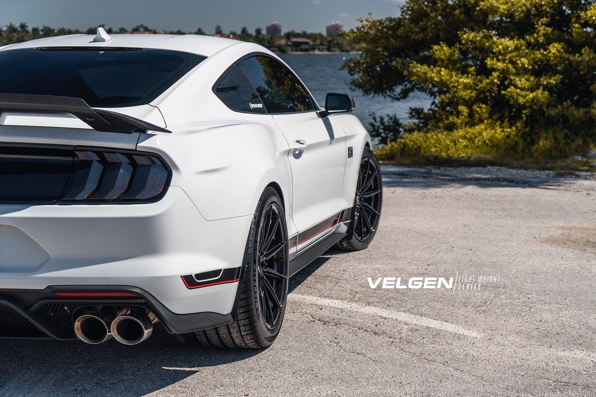

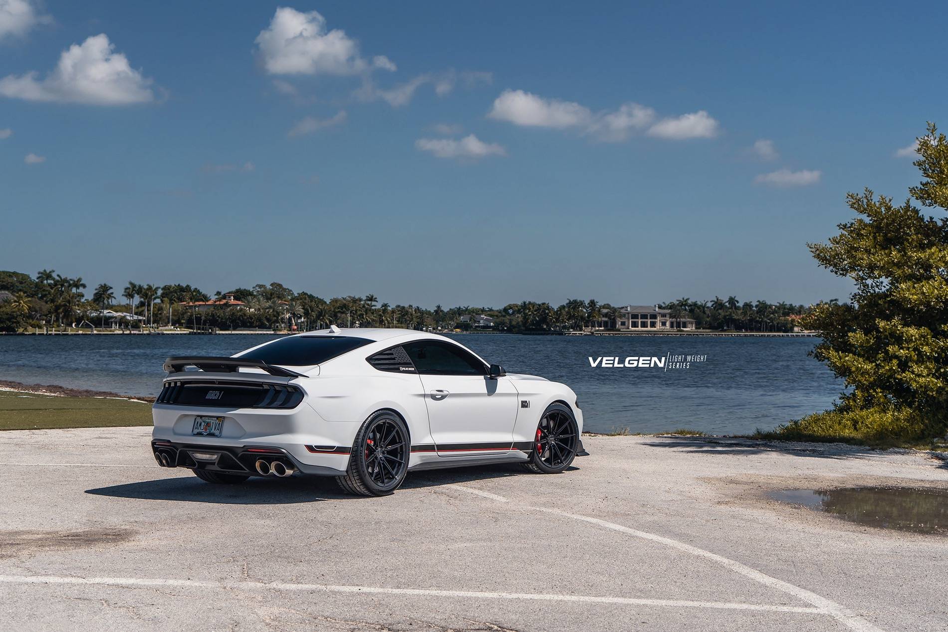

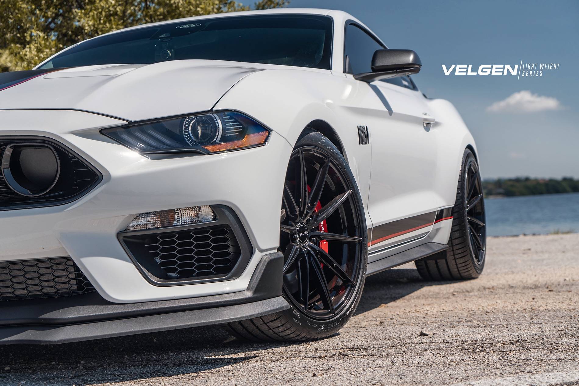

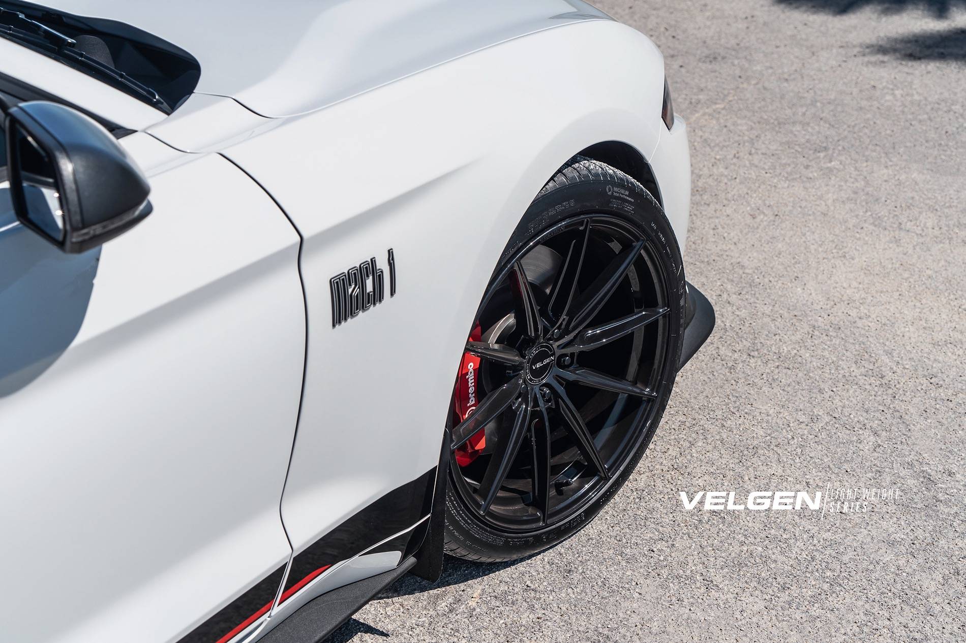

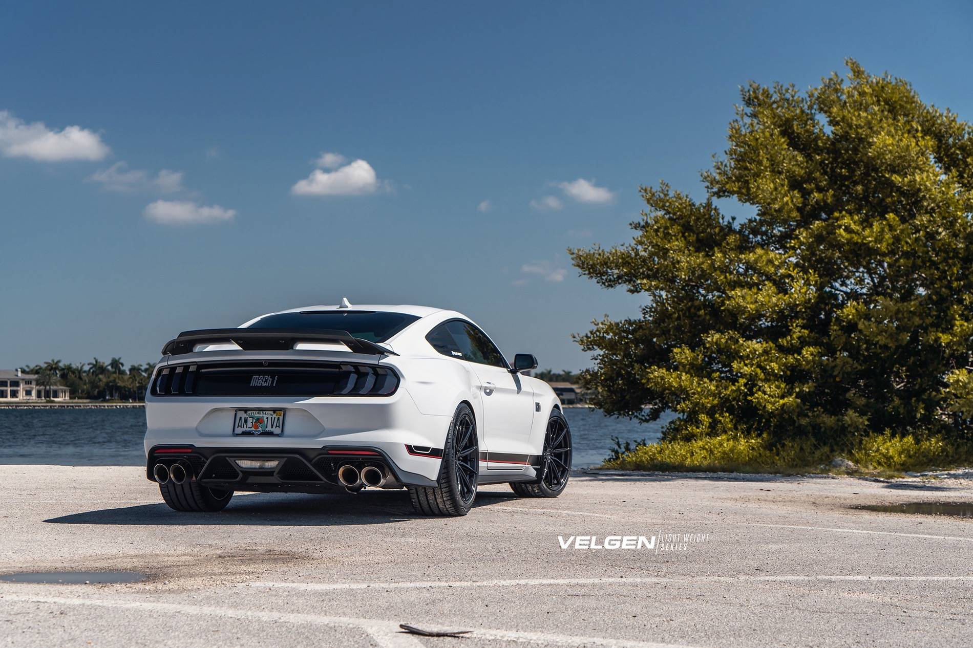

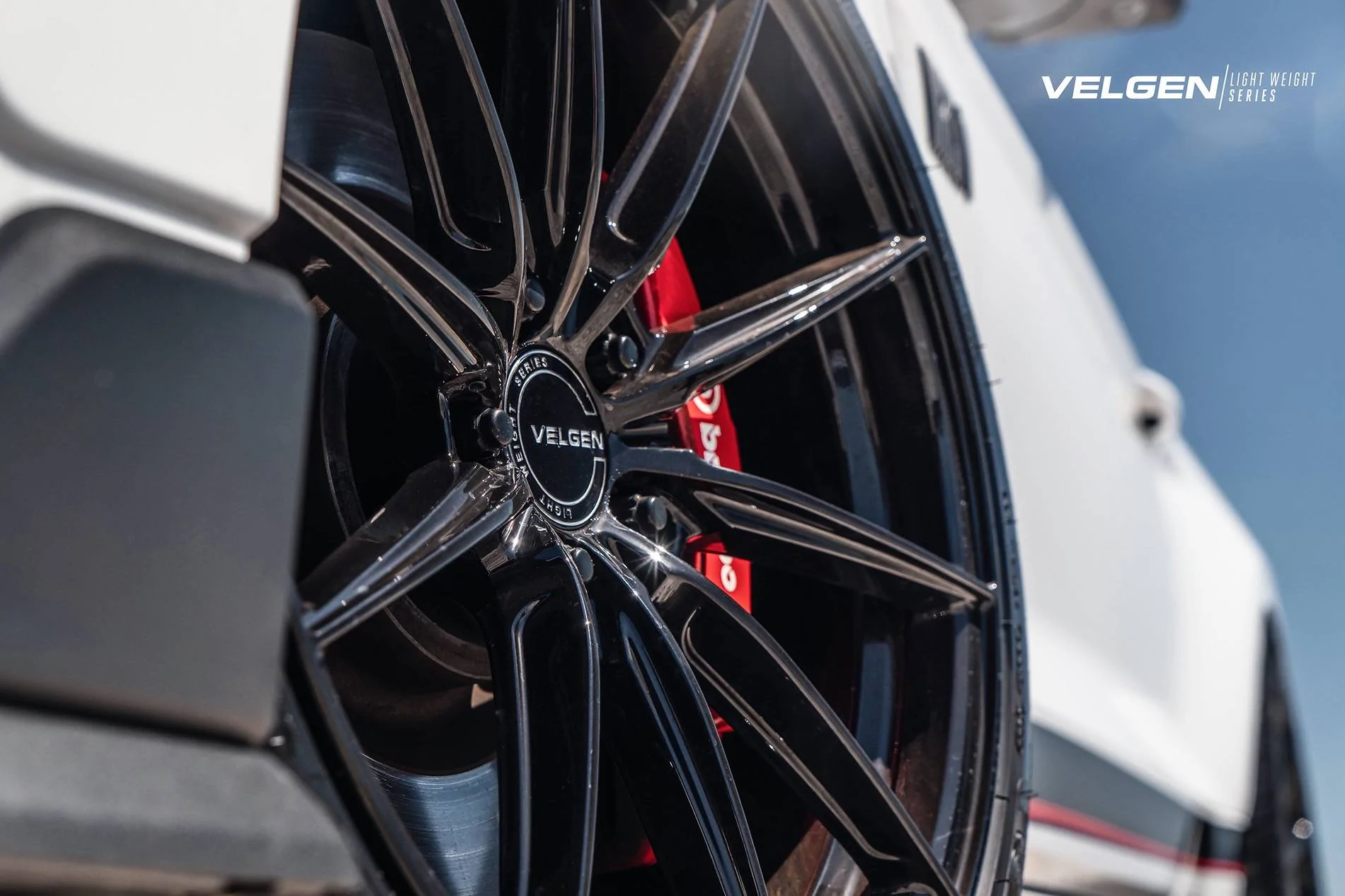

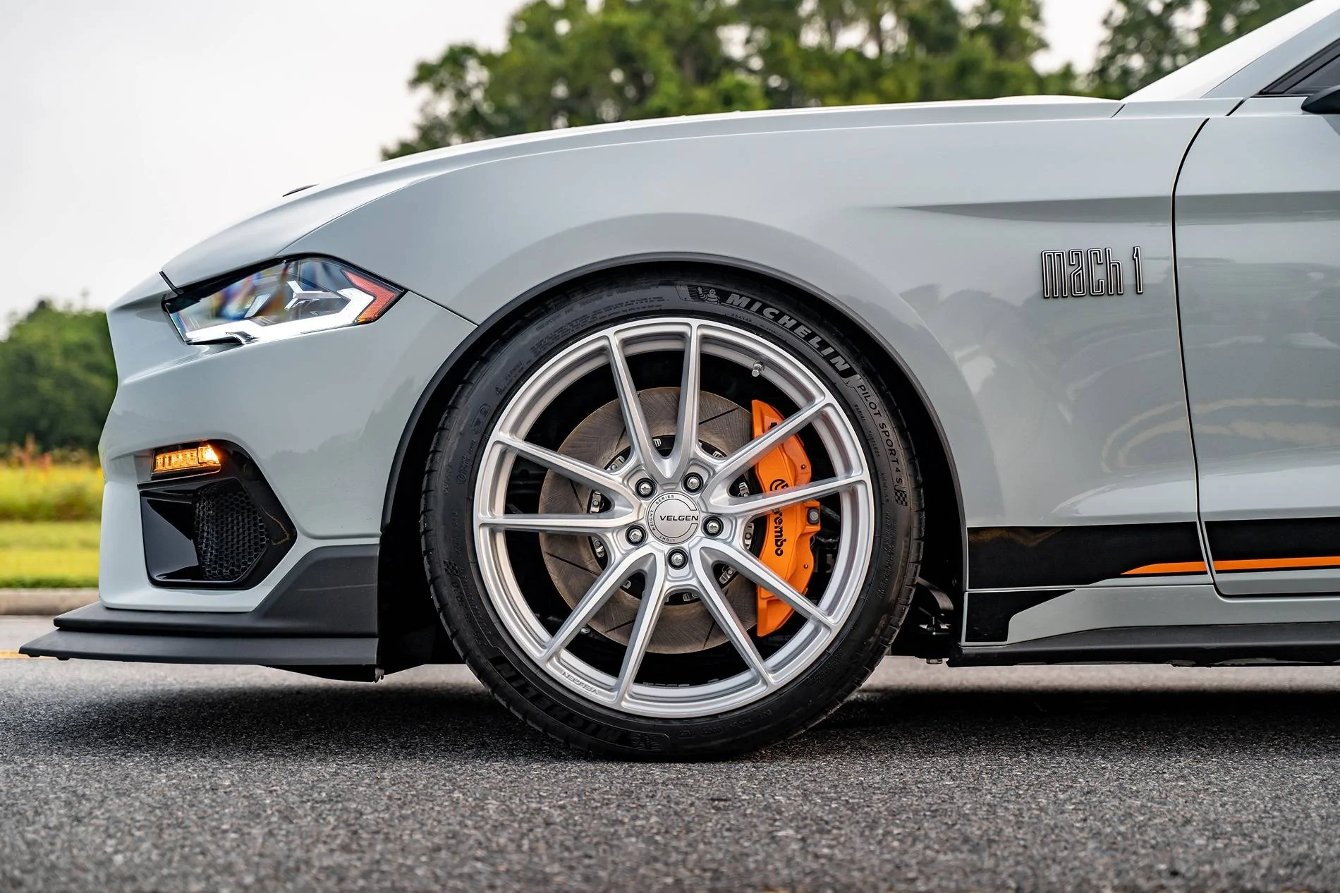

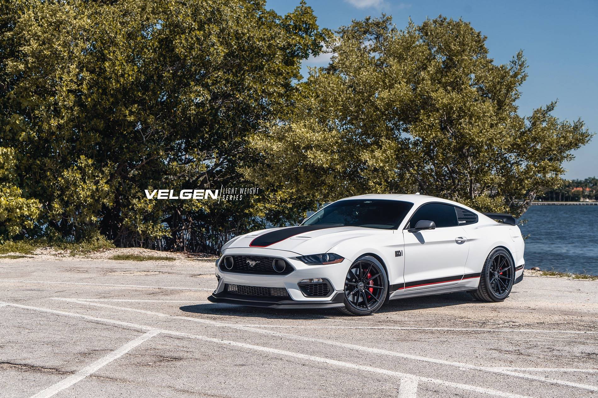

Well, for the street I run the Velgen's 20 inch on my 2022 Steeda Mach 1.
