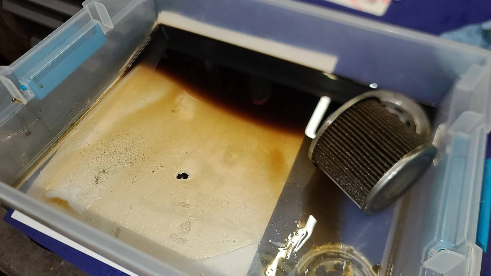

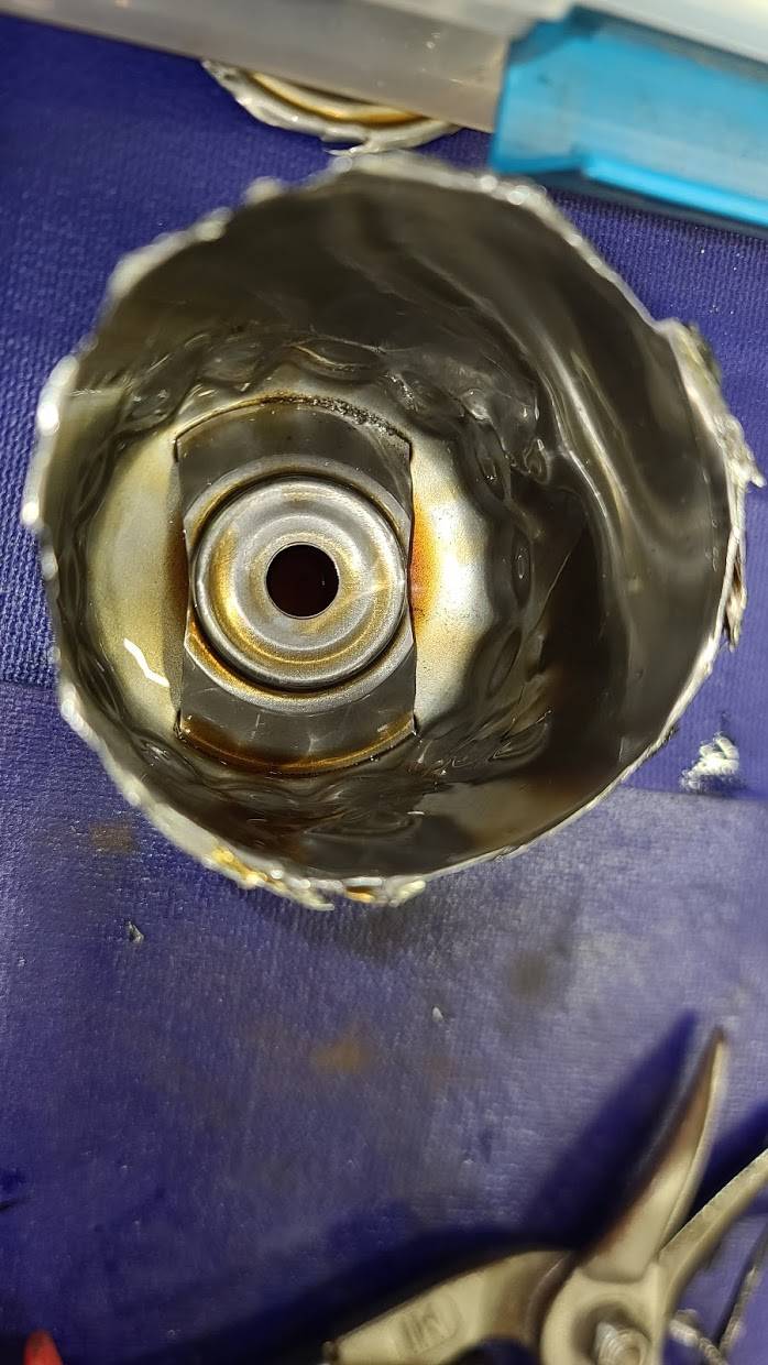

Very small fine pieces of metal sand at the bottom of the can:
Very small fine pieces of metal sand settled out at the bottom of the tray. The black piece is a paper thin, brittle piece of plastic that might have come from the filter itself:

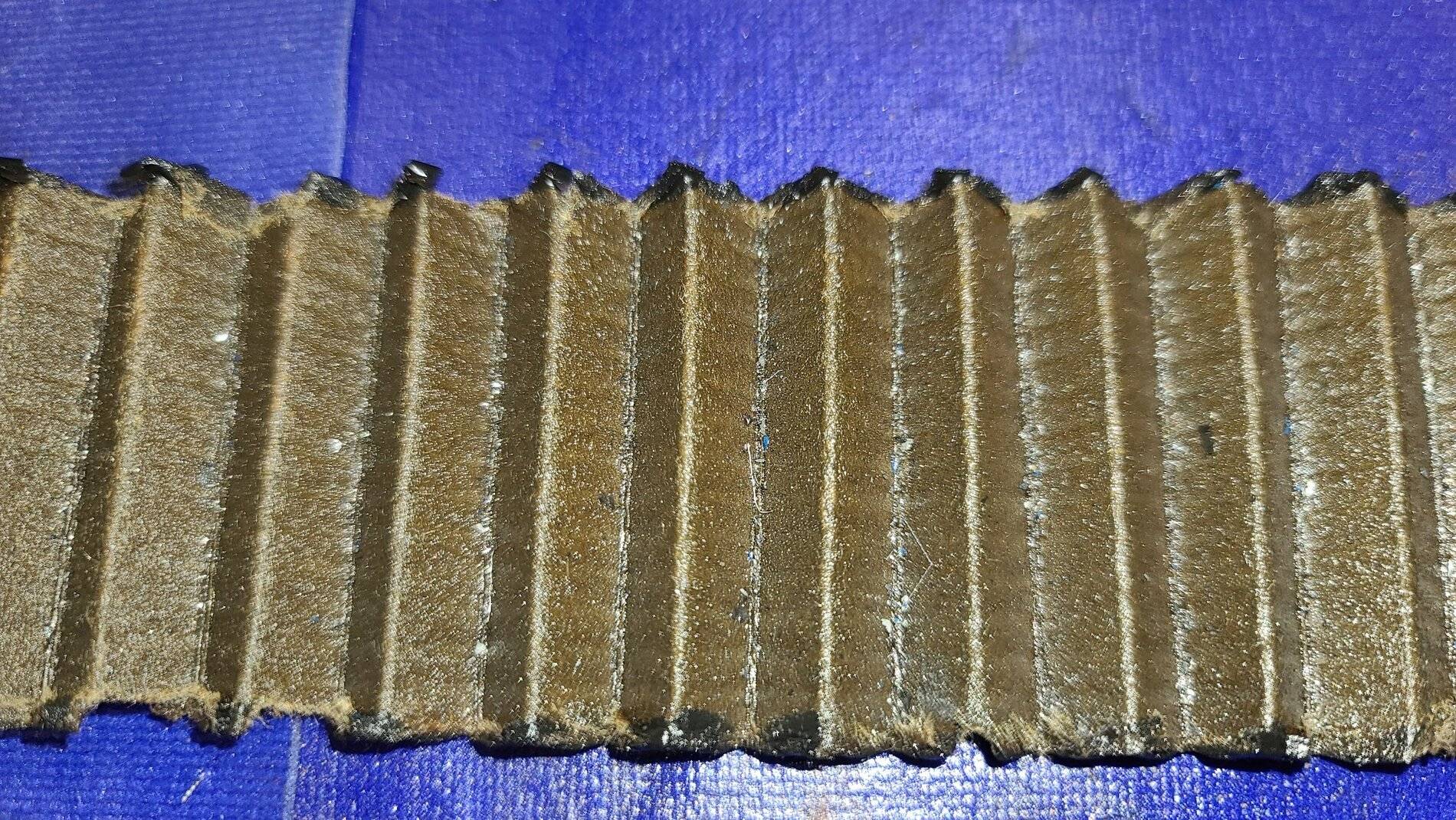

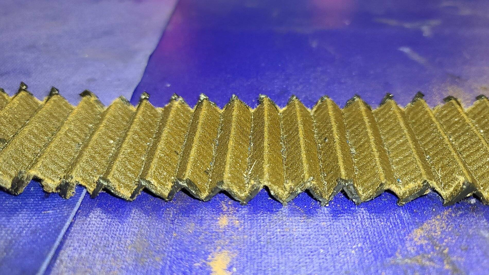

More fine pieces trapped within the filter element:

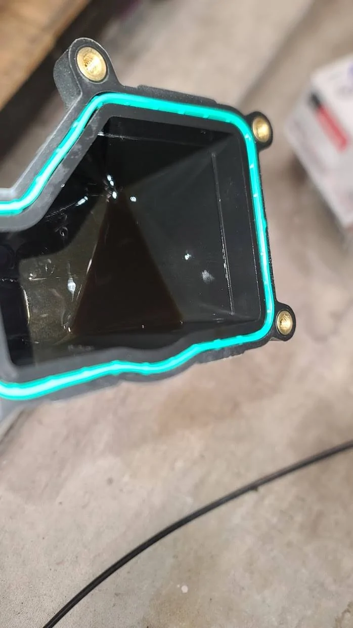

Also, I installed an oil catch before the previous track weekend. Here is how it looked after a 300 mile road trip and 200 track miles:

Interesting findings... Is this good, bad or normal?
I just did mine last weekend at 2800mi and everything went smooth. First time at track this Thursday night with full synthetic in the pan. I installed FP Oil seperator at 700mi and it only had a couple drops in it... less than my 15GT had all the time.
I am surprised you went this many track days with no oil changes... isn't every track day recommended?

Well all I can say is 40000 street miles, which is far more punishing, the factory ford filter which I cut open had nothing in it, and my last filter had nothing in it. Oil in the catch can was around a 1/4 ounce per oil change since new.

Yeah… metal shavings are never good..
Raidernixon, you abused her! Lol

The metal shavings are pretty normal on the first oil change. Just being broken in.

The big thing is to make sure the oil level is being maintained (you can see in the catch can how quickly blowby can happen in extreme conditions). Over time, the oil will break down regardless of the fill level and it is important to get it swapped out before that happens. It seems most of the track guys I've locally met like to change the oil after every second track weekend or so (every track day would be a bit much lol). I did want to see how to oil life indicator responded to the abuse and my plan was to change it out at 3,000 miles regardless of what it said. Apparently the oil life indicator was on the same page since it squawked at 3K miles.
Going forward, this car will be on the every two track weekends schedule since I am not getting any easier on her (she likes it).
From what I understand, these fine little shavings are totally normal and the next oil change should be cleared up quite a bit.
Exactly, as well as finding minute amount of debris particles that couid be from initial engine assembly, normal bearing wear, normal cylinder wear, and/or residue from cast. It's not surprising to see the debris pictured on an initial oil change coming from a brand new vehicle.
Also to note, how the OP dissected the oil can is exactly how to do it and is the method used by any Auto Service Center if/when needing to open an oil filter for XYZ inspection.
