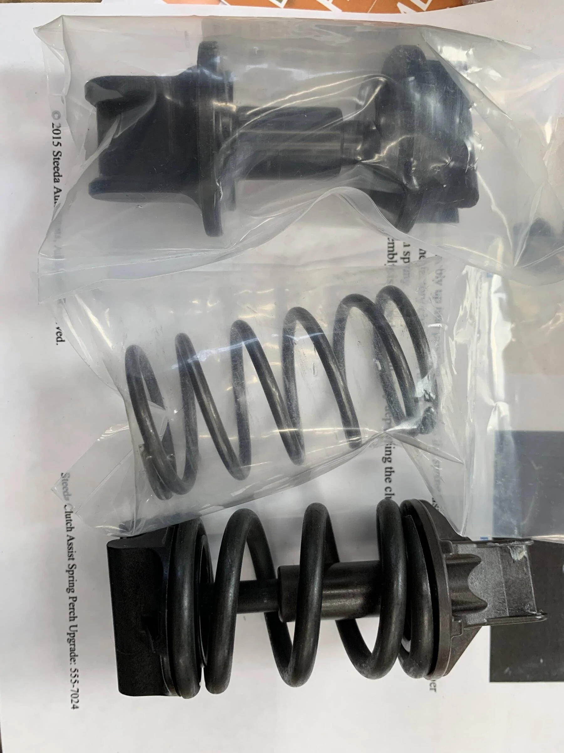

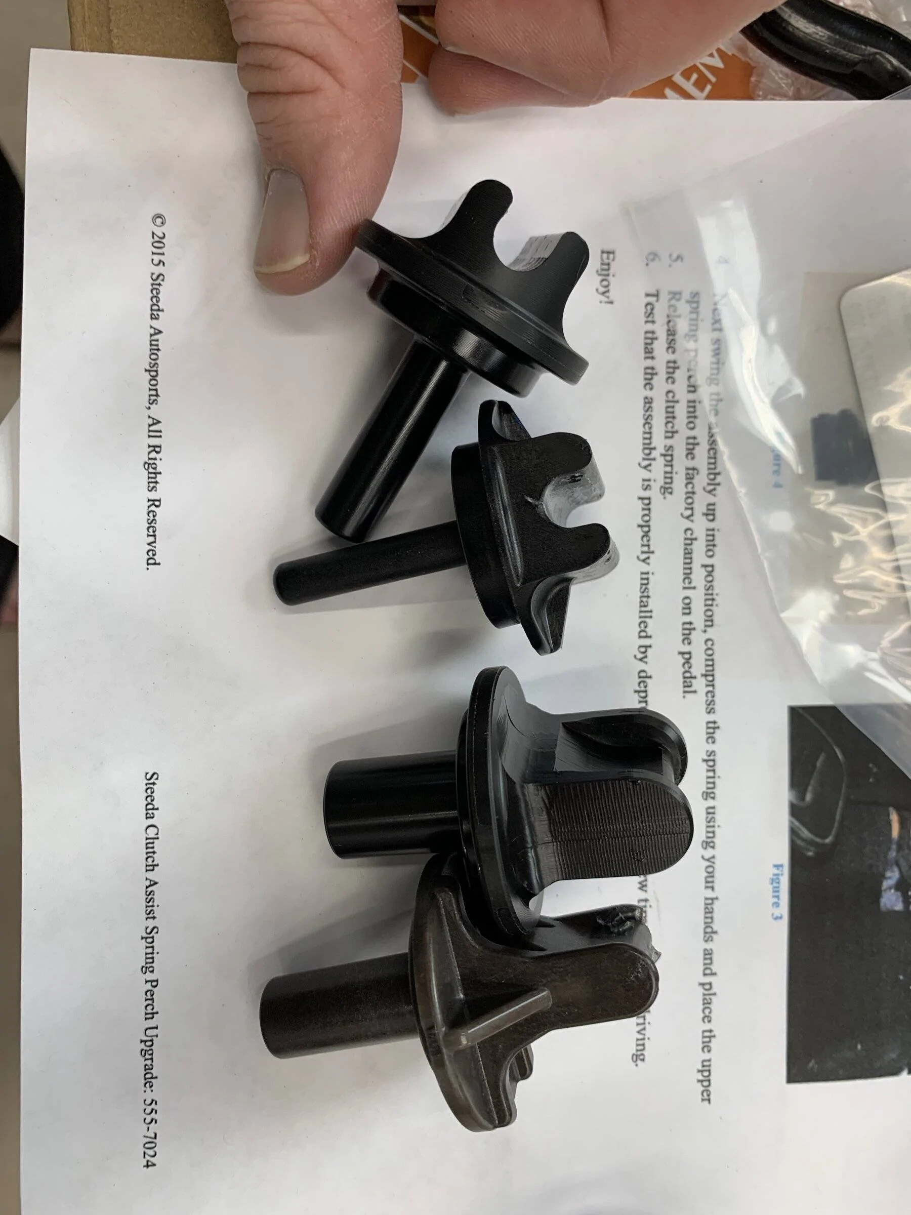

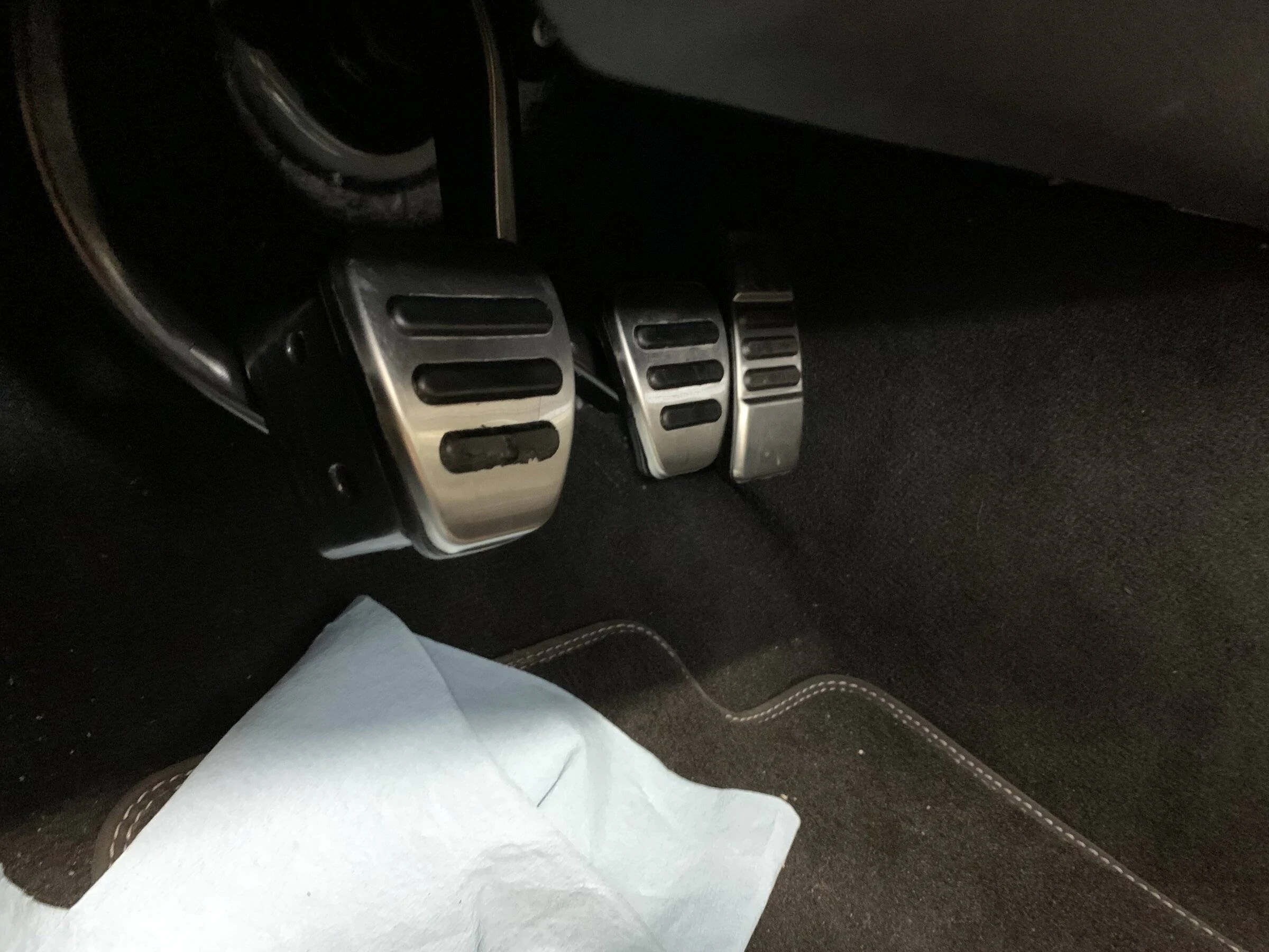

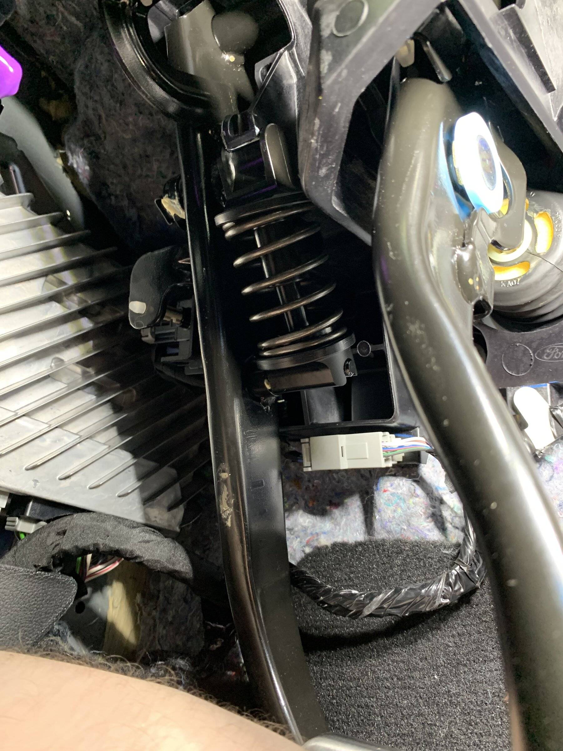

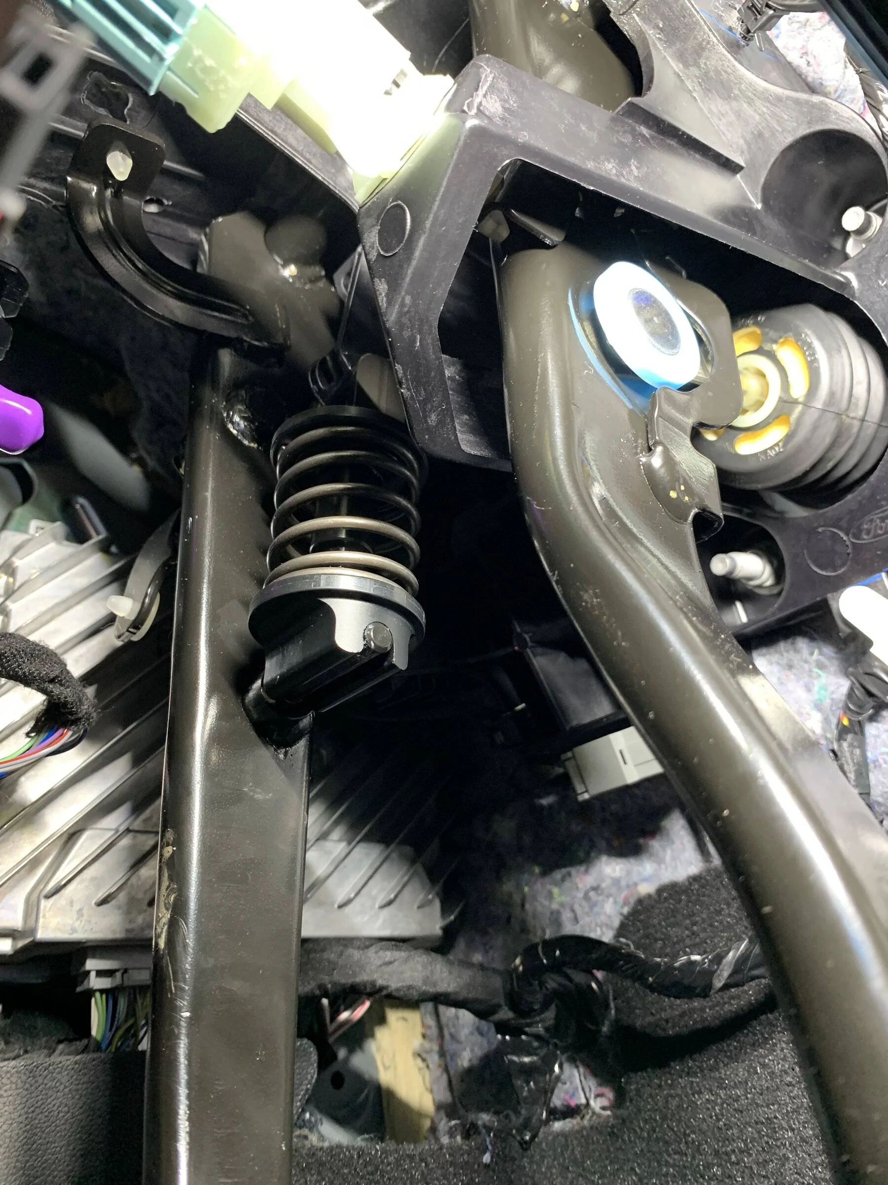

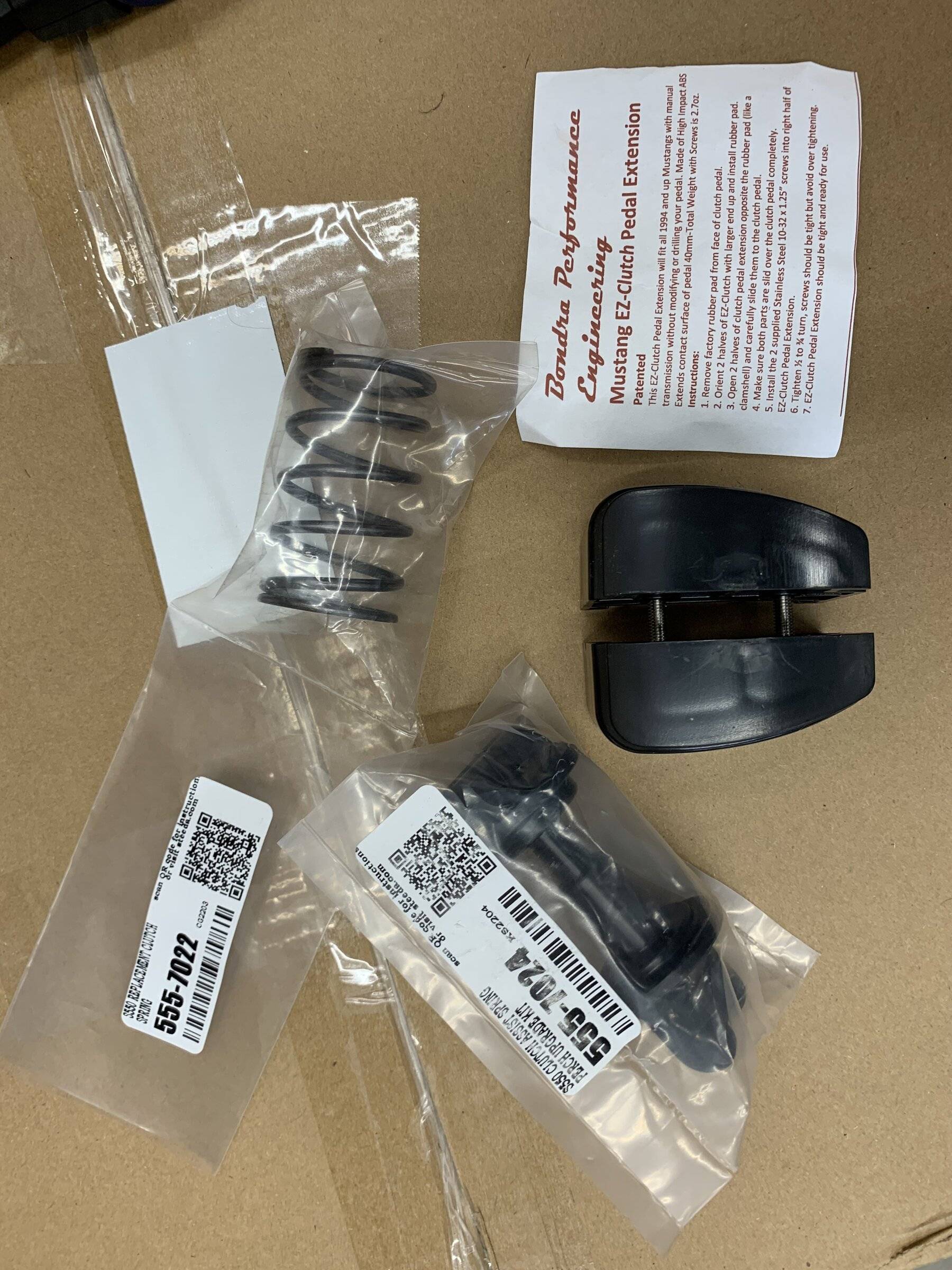

Steeda clutch spring and perch installed today along with a clutch pedal extender. My wife is short and although I'm 6' tall, I have a long torso and very short legs (30" inseam jeans are a touch too long) and the extender makes it easier for both of us to be comfortable with the clutch pedal. The pedal pad I learned the hard way is not meant for the rubber and metal to separate. Anyways a heat gun and prying got it on. I may replaced it where the rubber got mangled. Looking into whether or not the Steeda aluminum pedal covers could be made to work with the extender. I believe they would have to drill through the extender and the pedal both.
The spring I'm impressed with, the clutch actually has feel now and not so numb. It's def a lot easier to find/feel the engagement point. I'm glad I got the updated perch as I clipped an ear on the OEM one prying it out.

wow, steeda doesn't t make a clutch pedal extender for the s550. I called. ??

so you had to home rig the aluminum pedal cover?

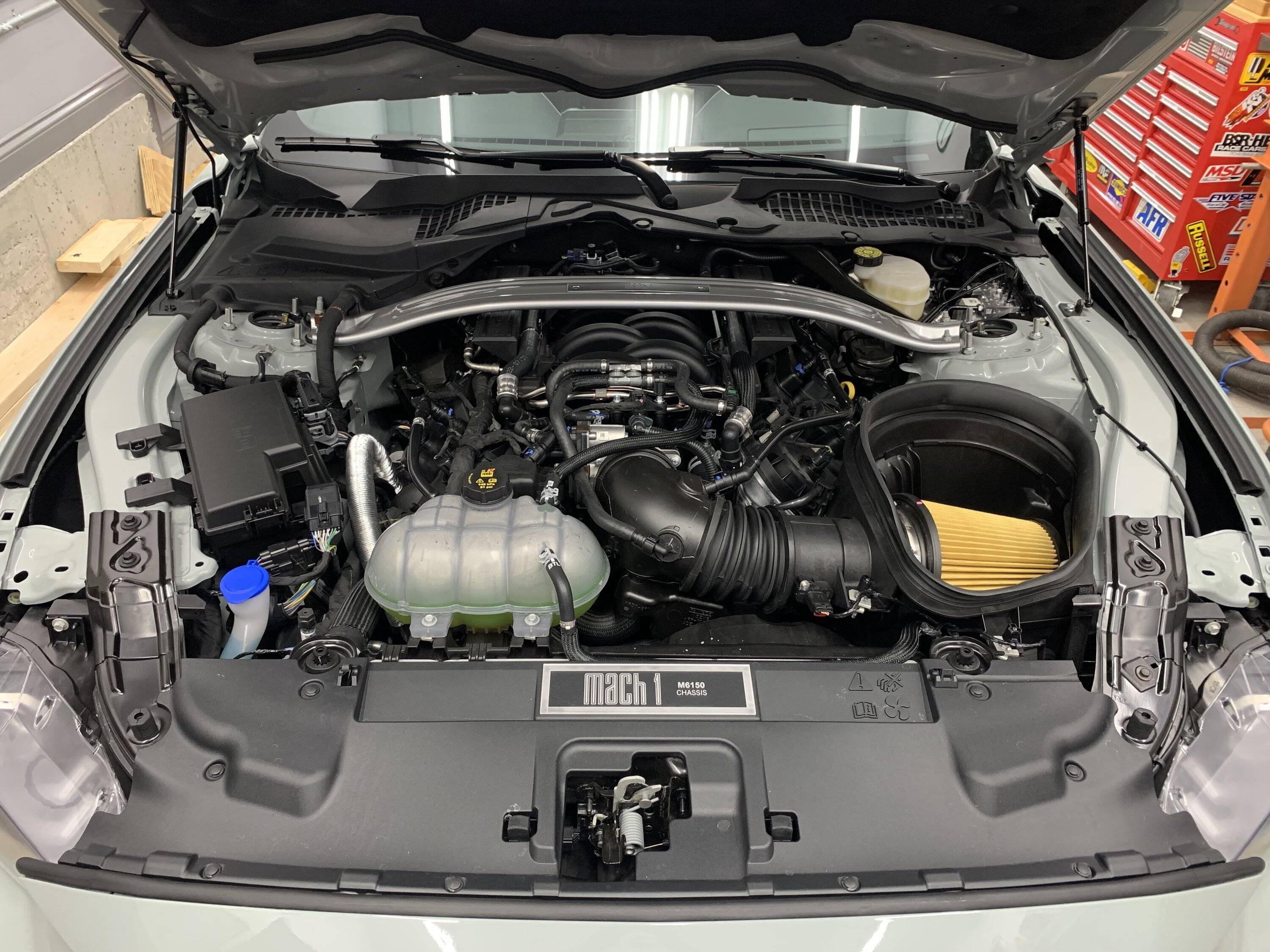

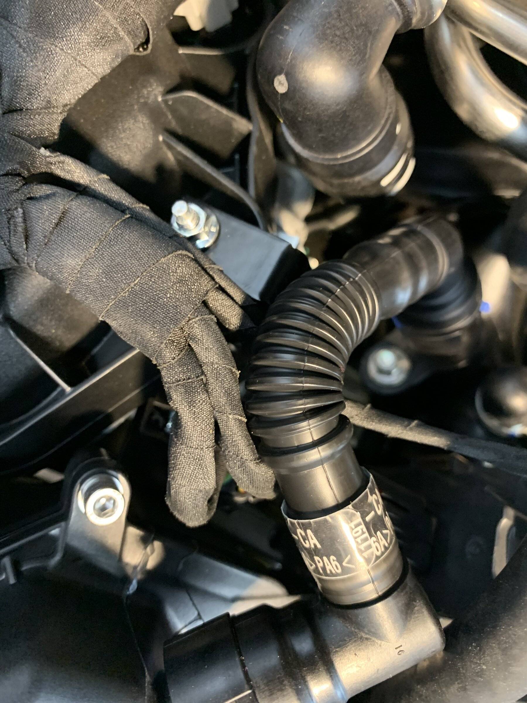

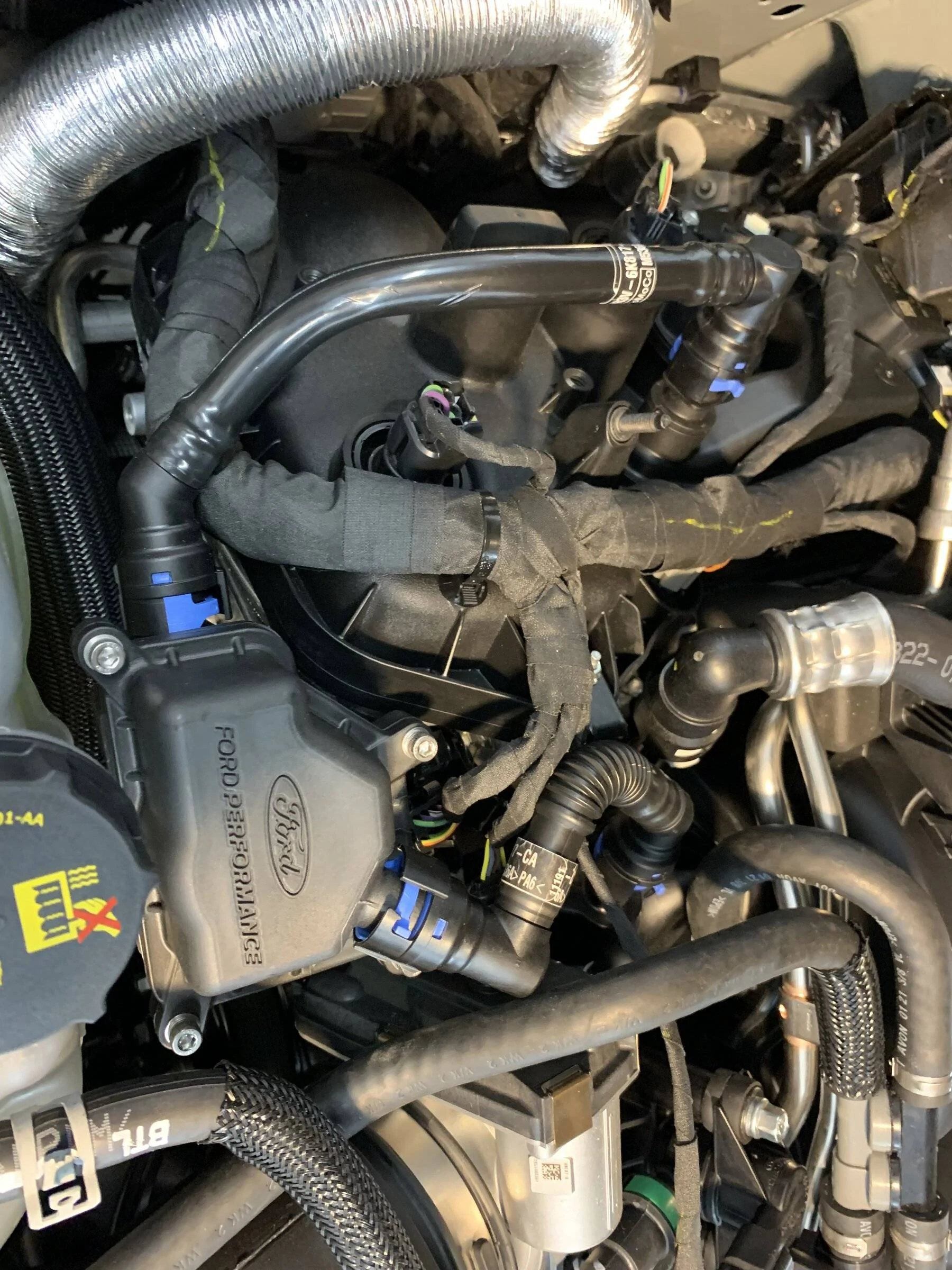

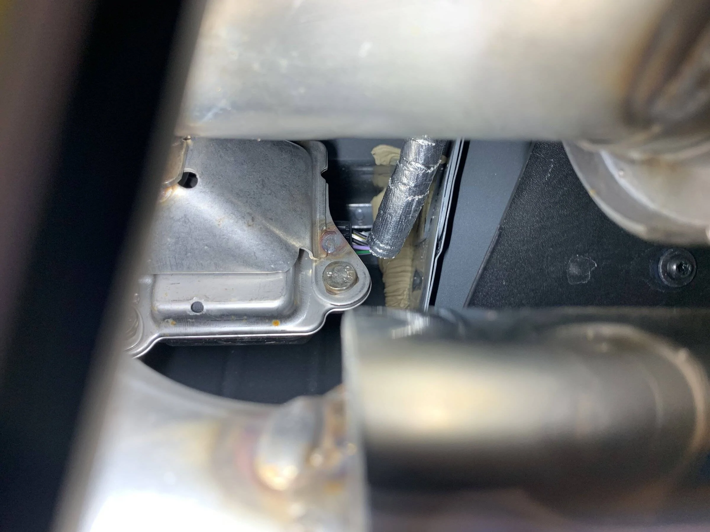

Today's mods:
Ford Performance Oil-Air Separator M-6766-A50A
I had to bend the upper bracket some so it would seat on the replacement valve cover stud-the added but made it too high
Easy install-no need to unclip wires
Be easy with the harness clip on the lower stud-I used a tiny flat blade screwdriver to relieve tension so I could take it off with little force without breaking it
I found the intake manifold side hose installs easier when backwards-less strain on the ports and electrical harness this way

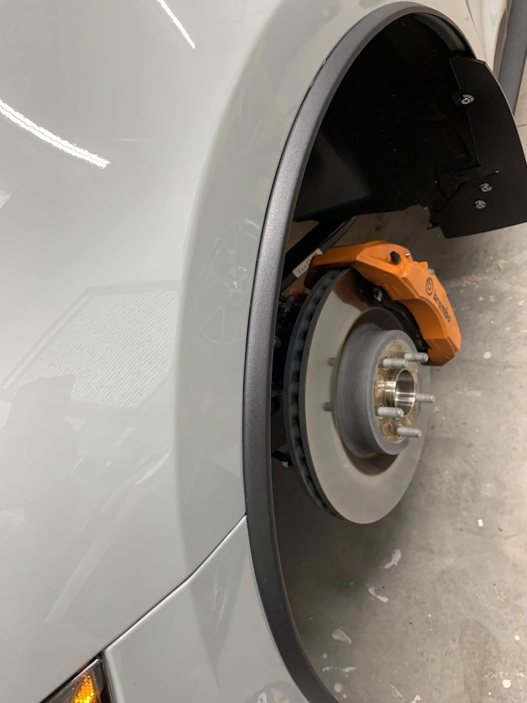

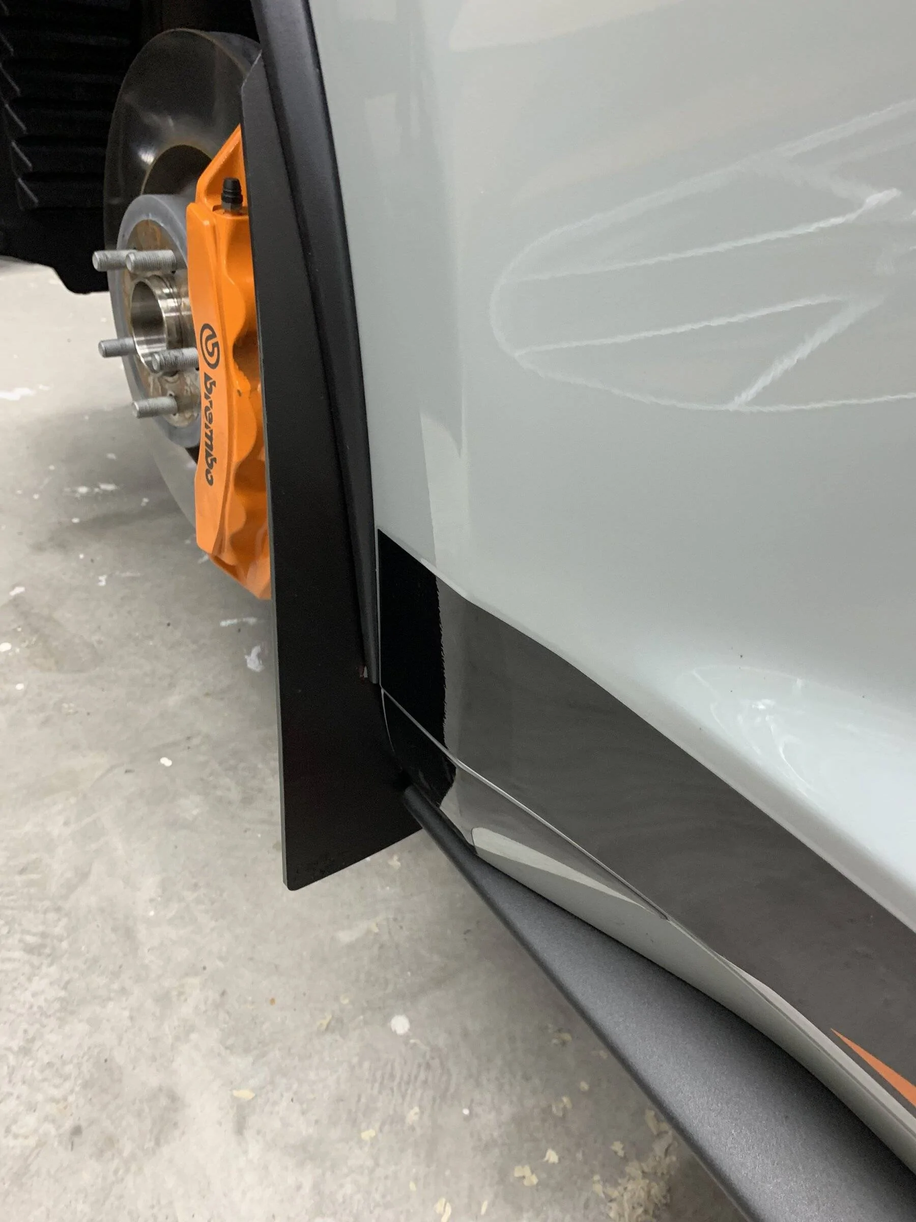

Handling Package Front Fender lip molding
Easy install
Prepped twice with denatured alcohol, then adhesion promoter
Install top pin first then slowly peel back tape ribbon and press firmly-recommend a dry run before.

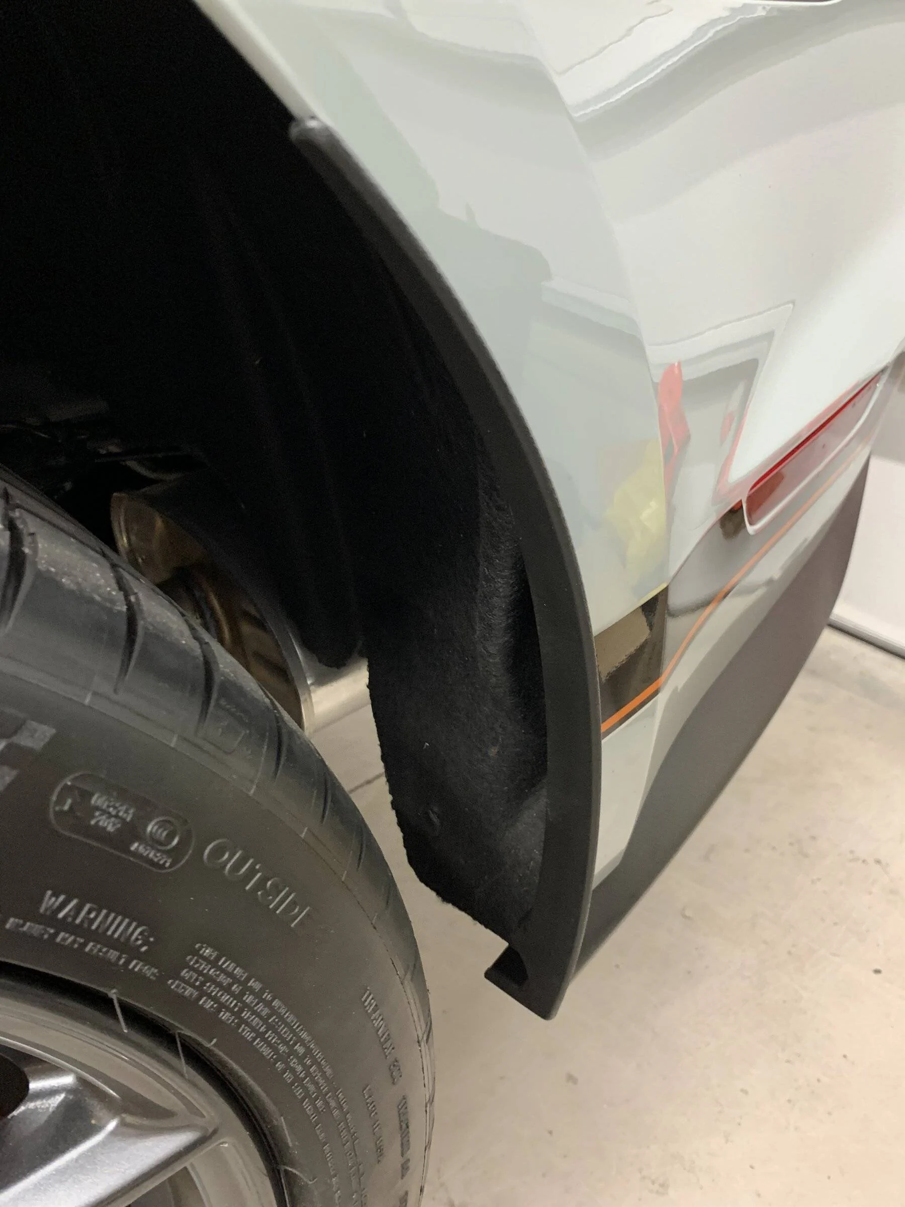

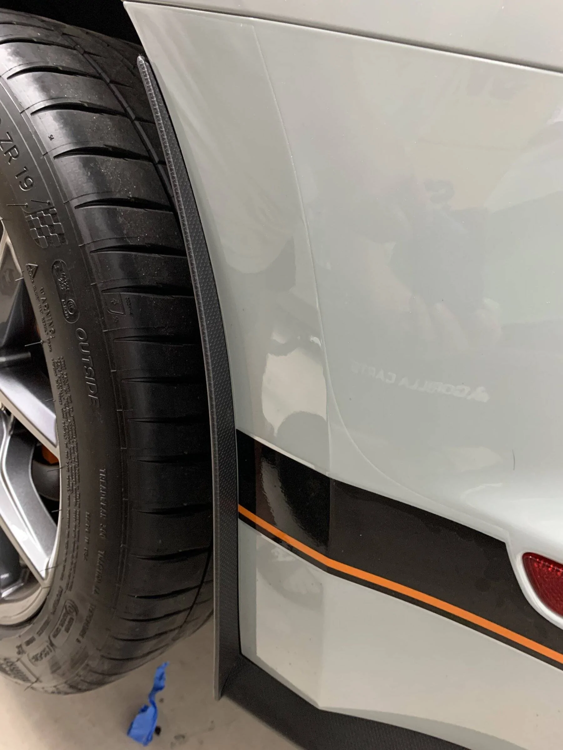

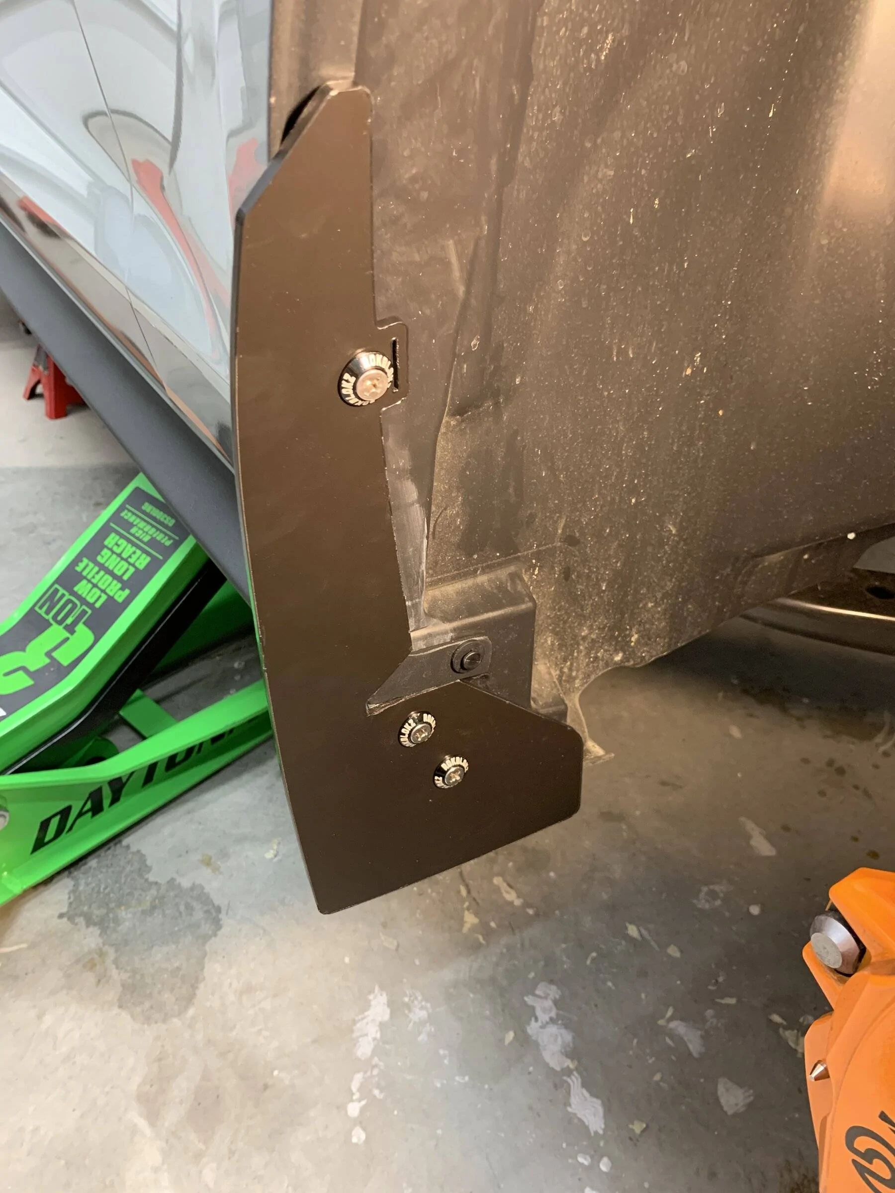

Handling Package / GT500 rear tire spats
Easy install and looks great

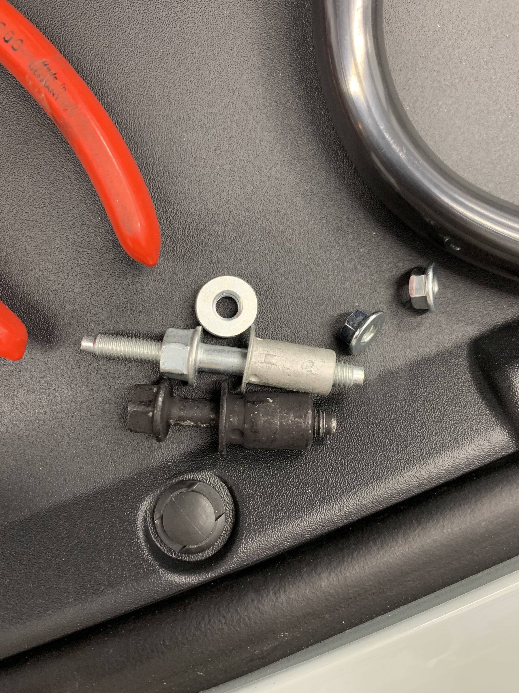

Be sure to order plastic rivet, nutserts/clips, and correct screws (there are two part #'s floating around, but you want the one with the bigger washer built-in, I'll update with part #)

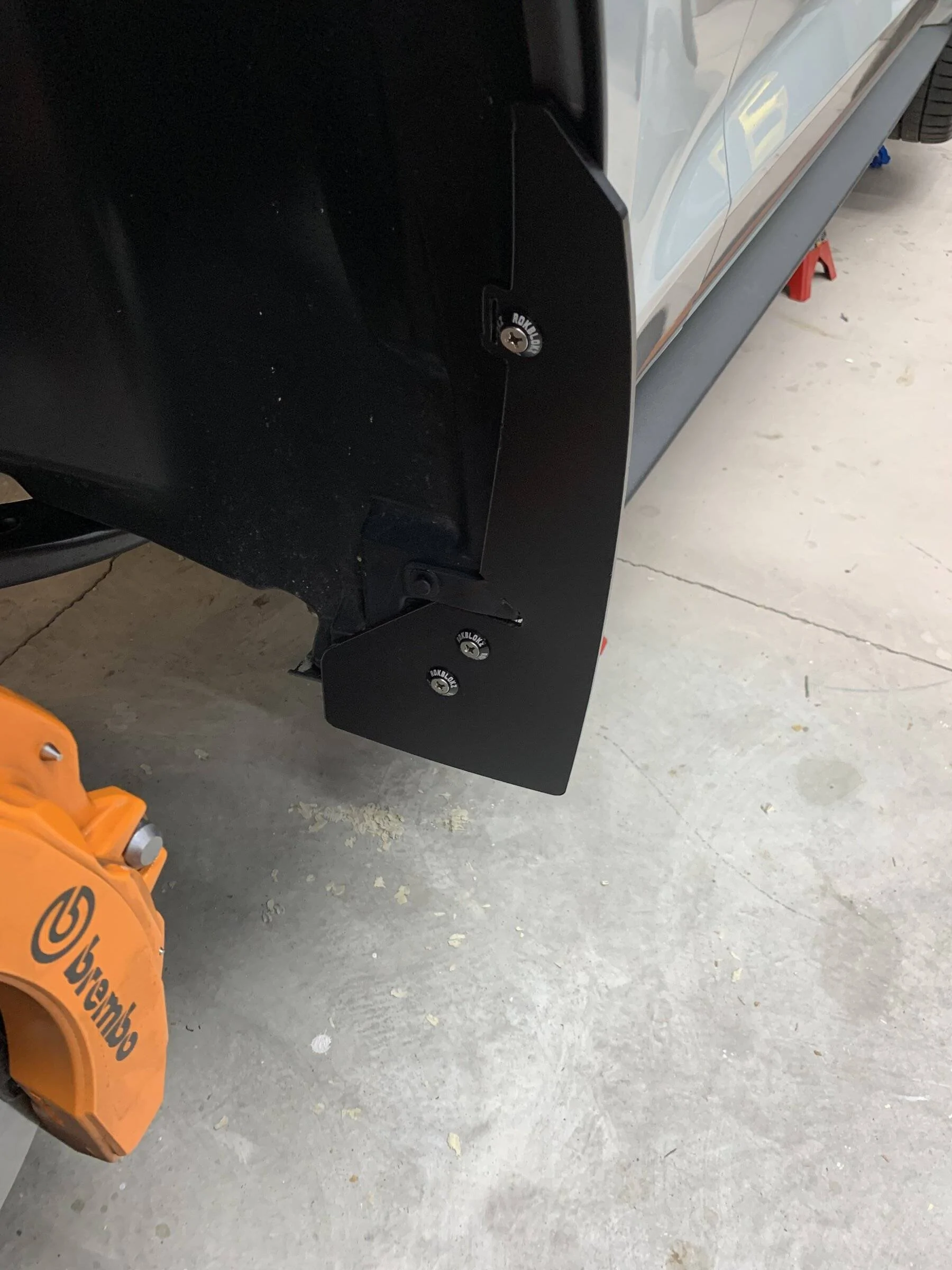

Rokblokz PP2 side front rock guards
I trimmed these to fit better with the HP lip molding
If I had to do it over again, I'd consider trimming the fender lip molding short and use the rokblokz unmodified
Only potential issue is the top secures with a plastic clip that doesn't really like the added thickness of fender liner/fender/lip molding, but I think it will be okay. Worst case I can glue it with black silicone or 3M-need to test on material
YES, they are large, but I'll be running 19x11's up front (SVE's w/25mm OP spacers), but if they end up too big

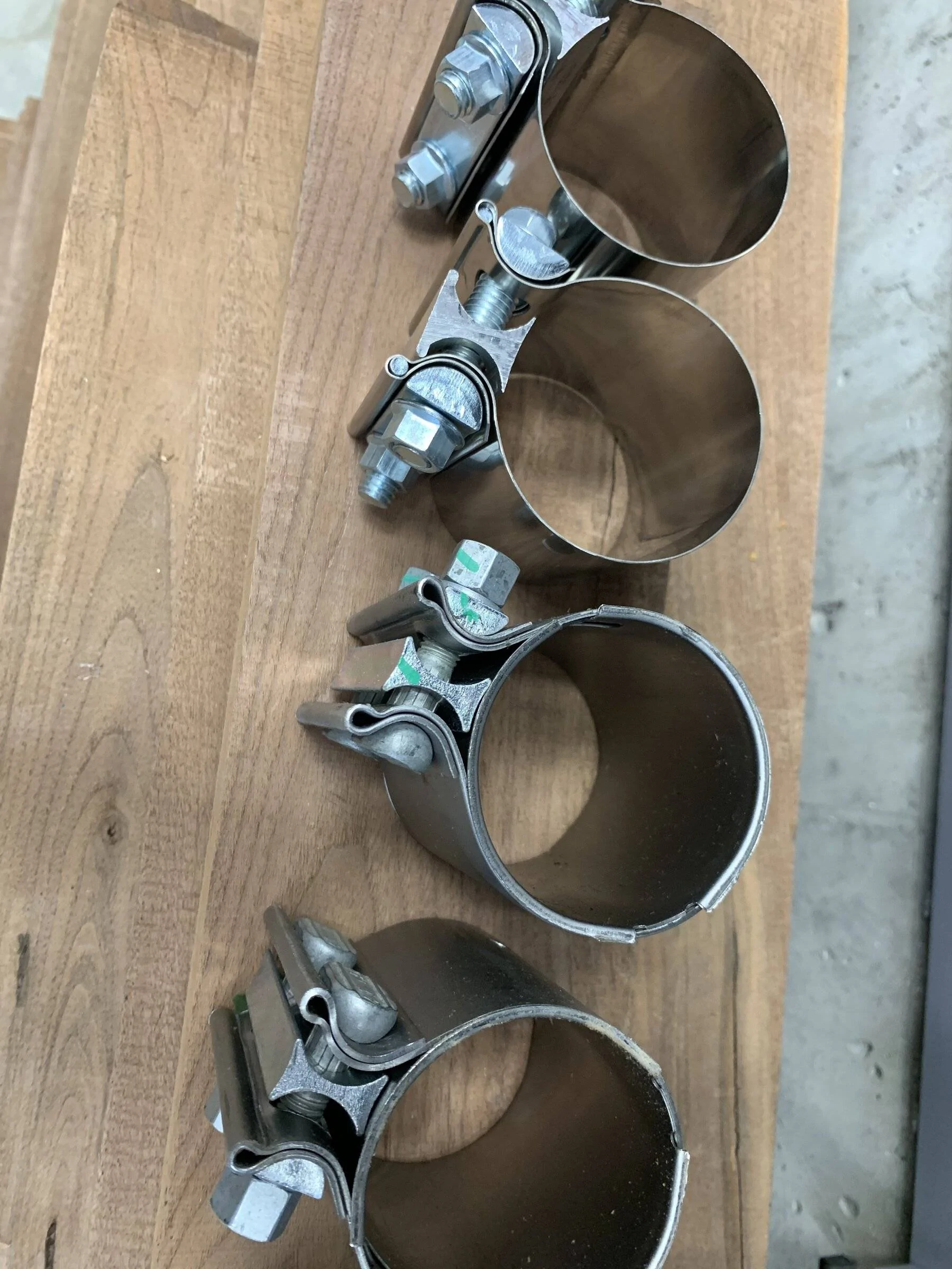

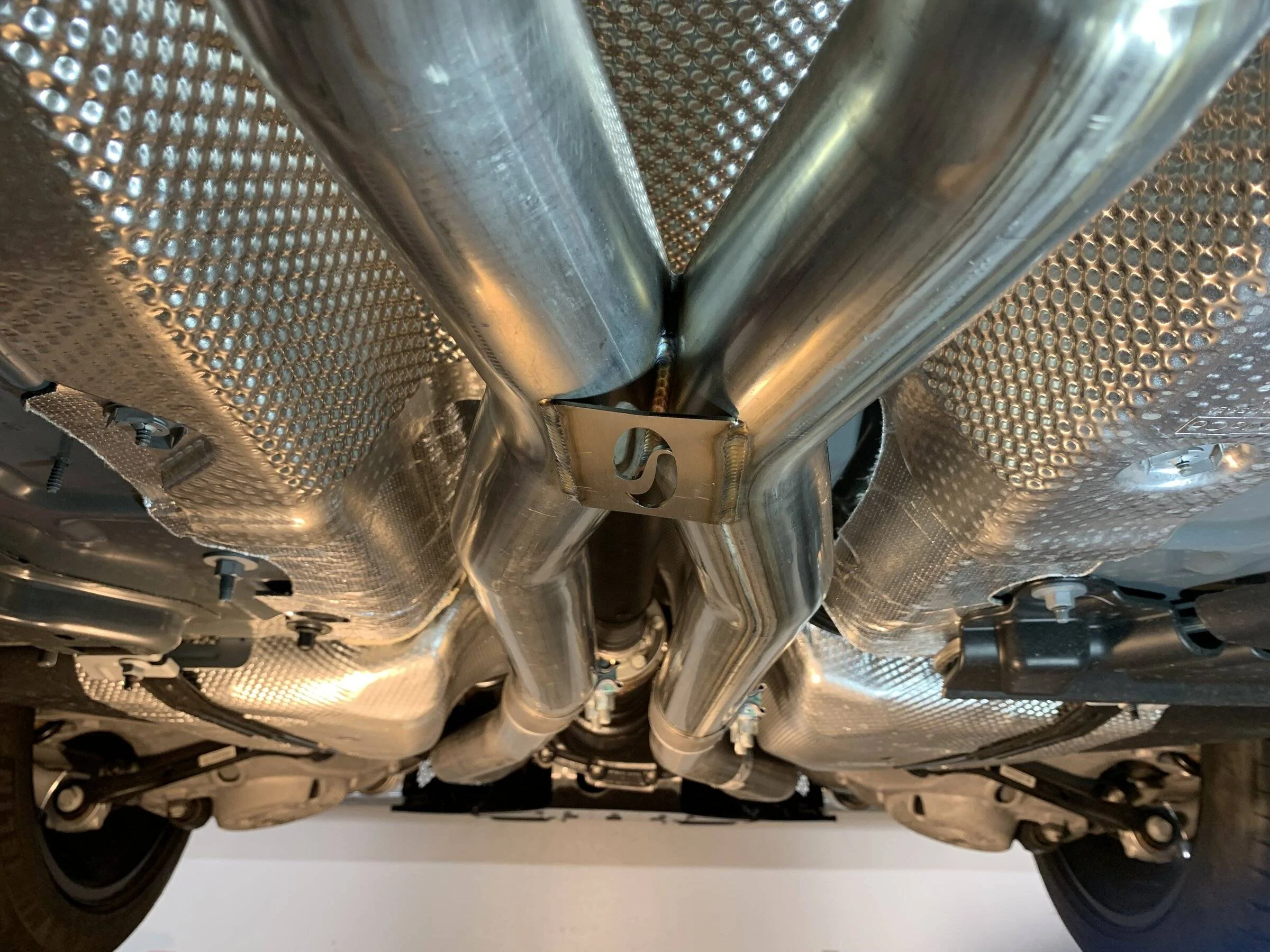

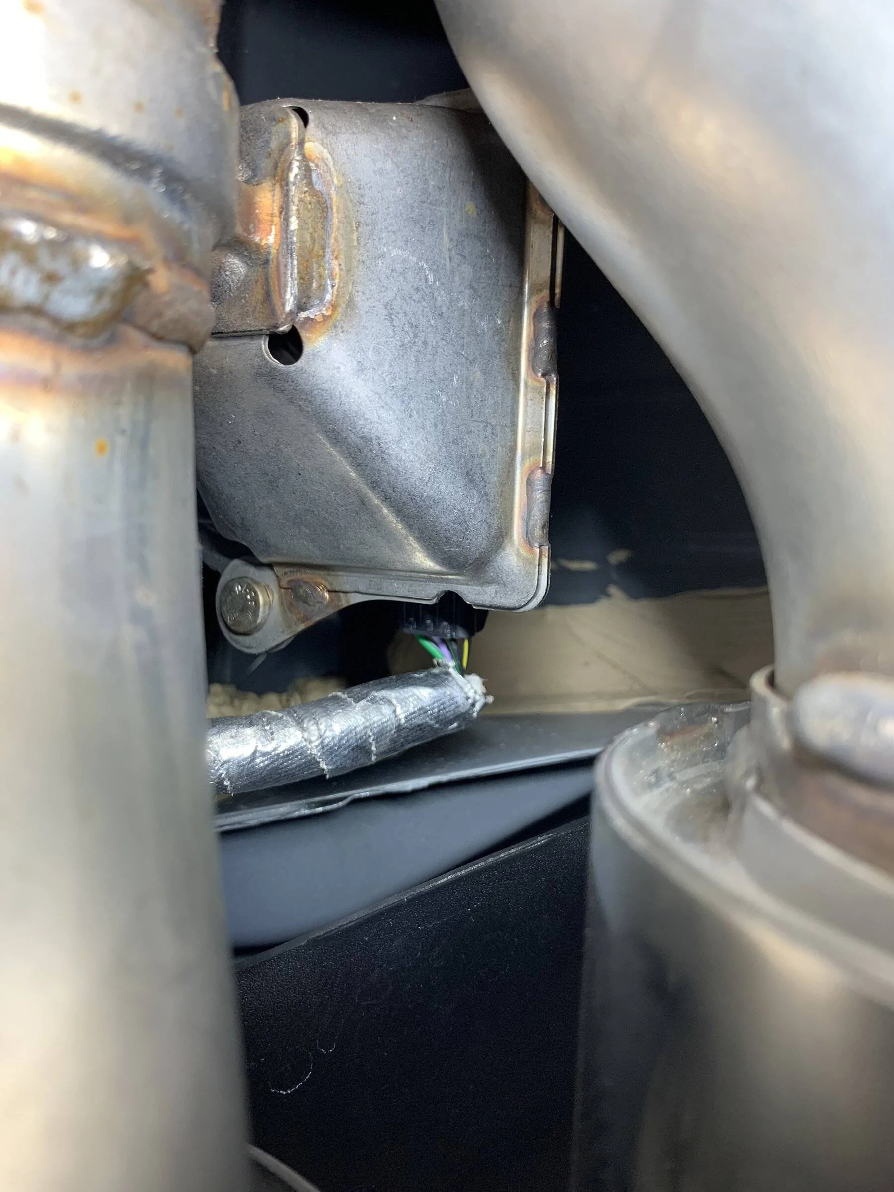

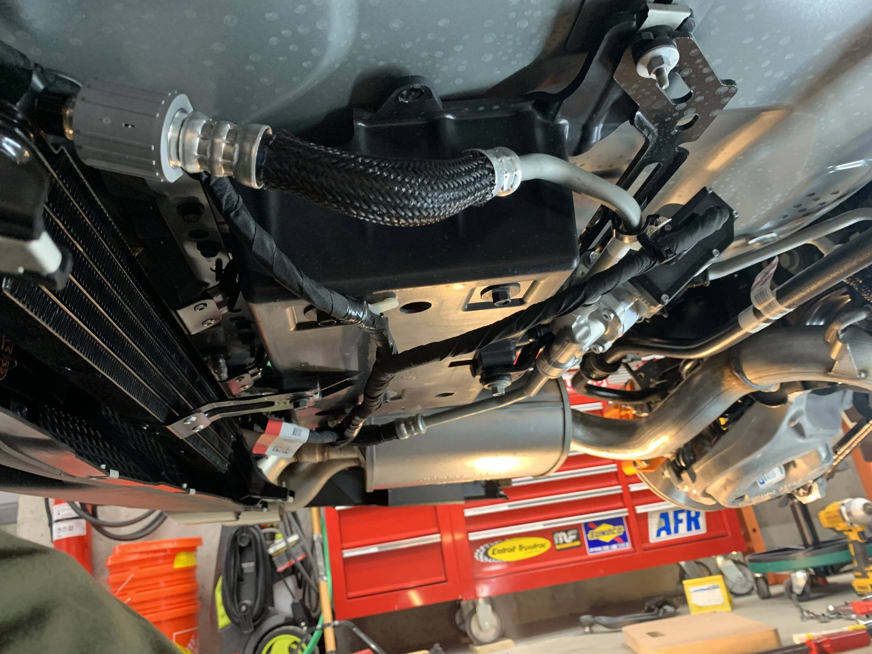

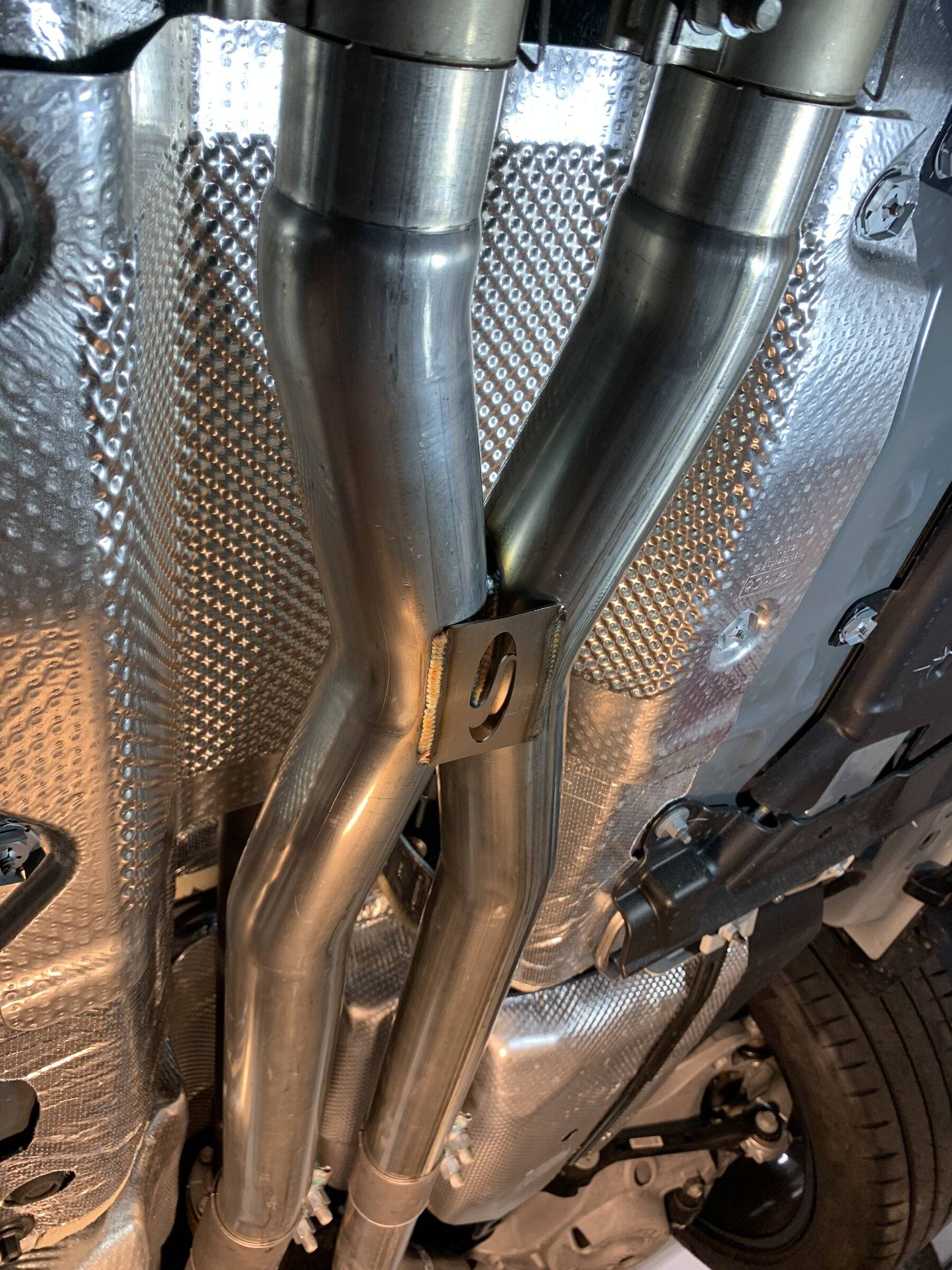

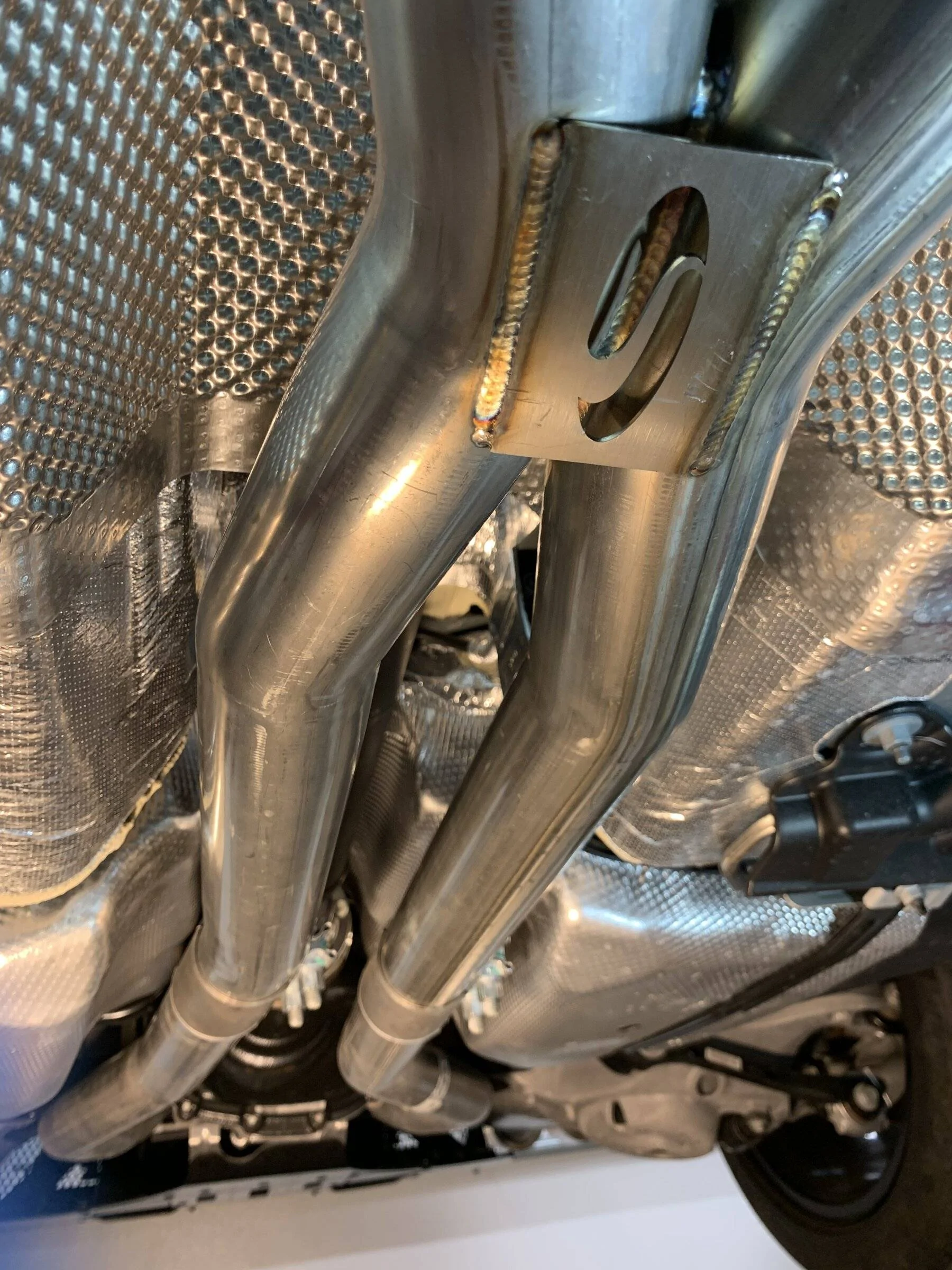

Steeda X-pipe
Nice piece, good fitment
Welds, although pretty, have some undercut which I don't care for personally. Part of my day job is boiler and pressure vessel repair (read: 1000's of pressure welds that have to pass x-ray or phased array testing) and I've been over a lot of jobs with so I'm picky and prefer quality over instagram. #rant
Cheap clamps-inferior to OEM, upgraded to double wall Vibrant clamps
Used multiple jacks and jack stands to adjust and hold muffler and tip alignment before torquing everything down.
I unplugged the active exhaust both sides to protect the harness and connectors

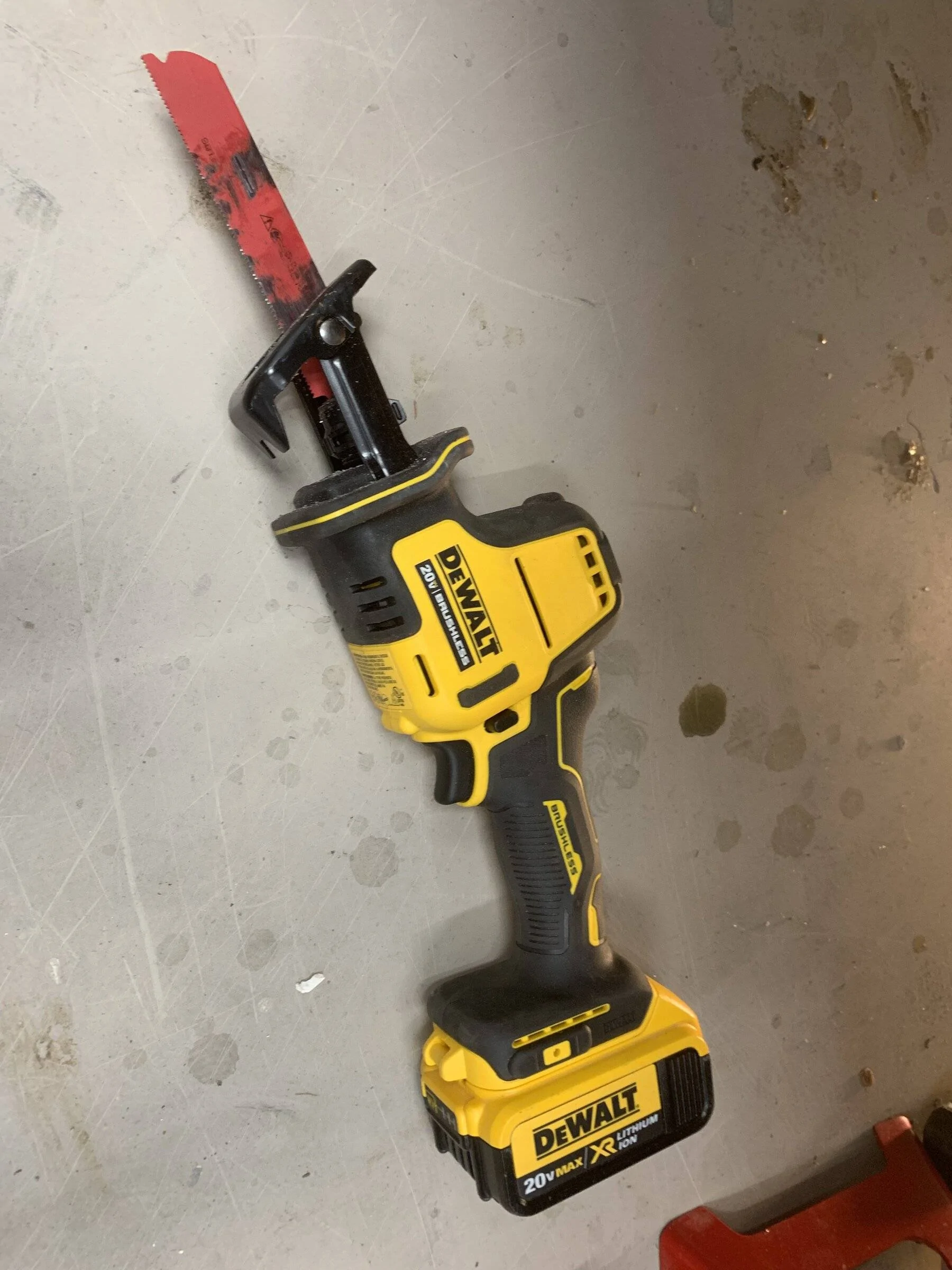

It's possible and easy to do alone, I used a jack and 12" x 12" piece of plywood to hold the x-pipe against the resonator to mark cuts. I loosened the OEM clamps up front and pulled them back to verify the x-pipe was dead even with the factory exhaust. I marked a circle on both with blue painters tape and made it about 1/4" shorter than stock to gain clearance between the AE harness & plugs versus the body. I also verified I now have what looks to be plenty of clearance on the AE plugs and harness as shown.
Dewalt single handed "hackzall" is awesome.
Haven't started it yet-it was 10pm and I really like my neighbors
Easy install
Steeda X-pipe
Great !! TIP OF THE MONTH!!! Ford oil separator , the shorter hose was so tight, switched it to backwards and fits better with less tension.
I triple checked the part number to ensure I had the correct kit. It's crazy how they want that hose to attach and route. And before anyone replies I know the hose ends can rotate on the hose. IT fit much better backwards on mine.

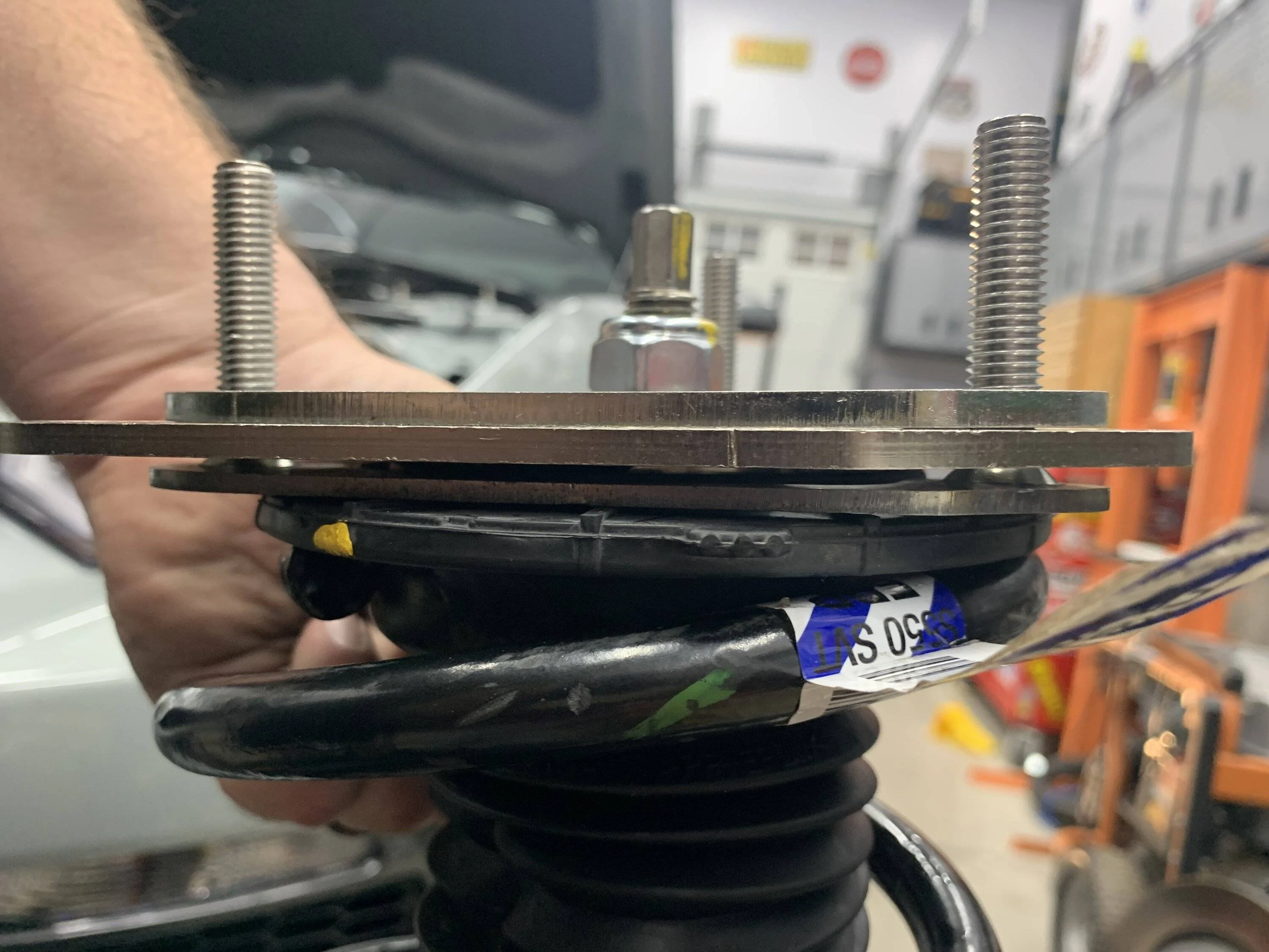

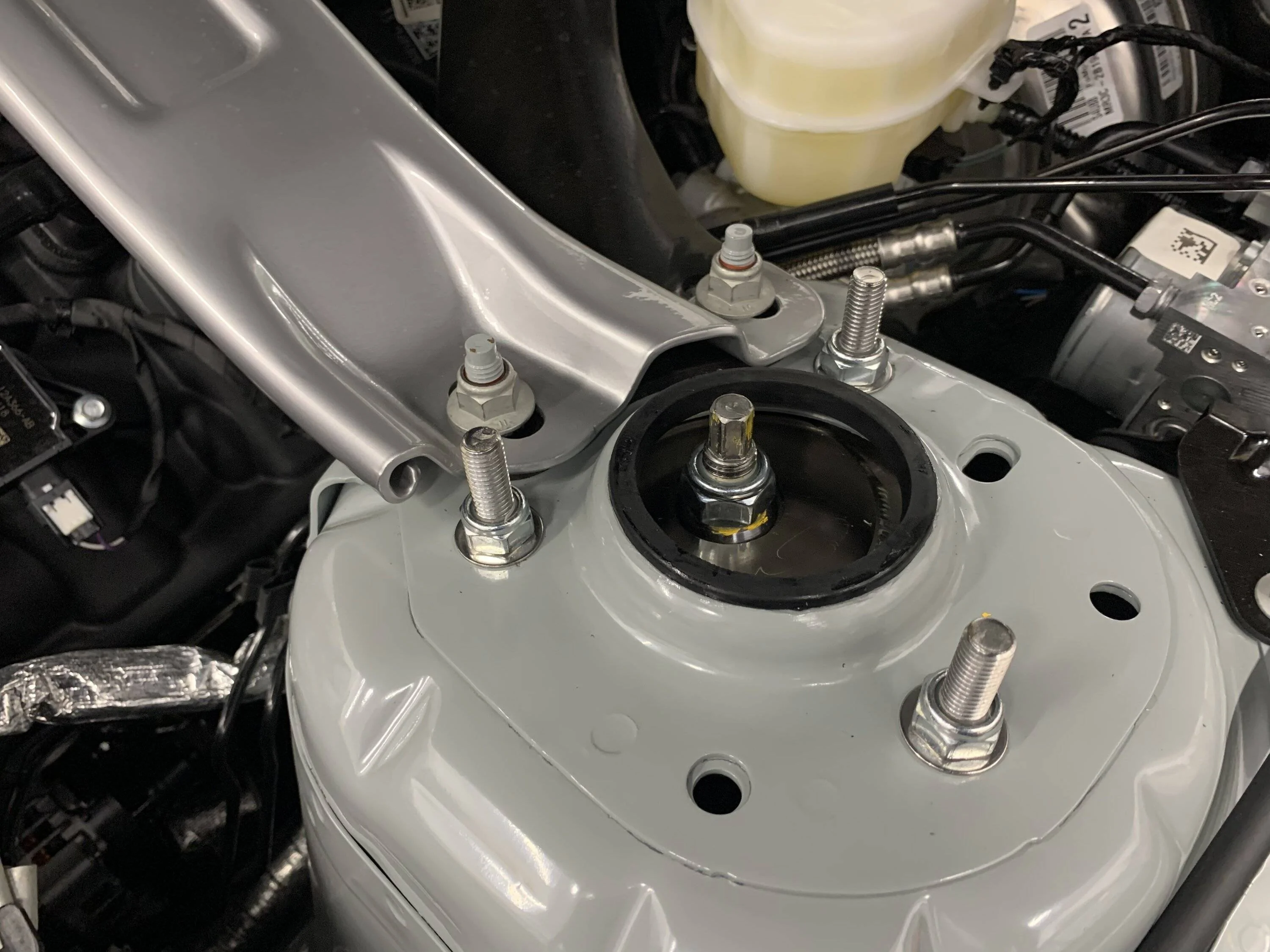

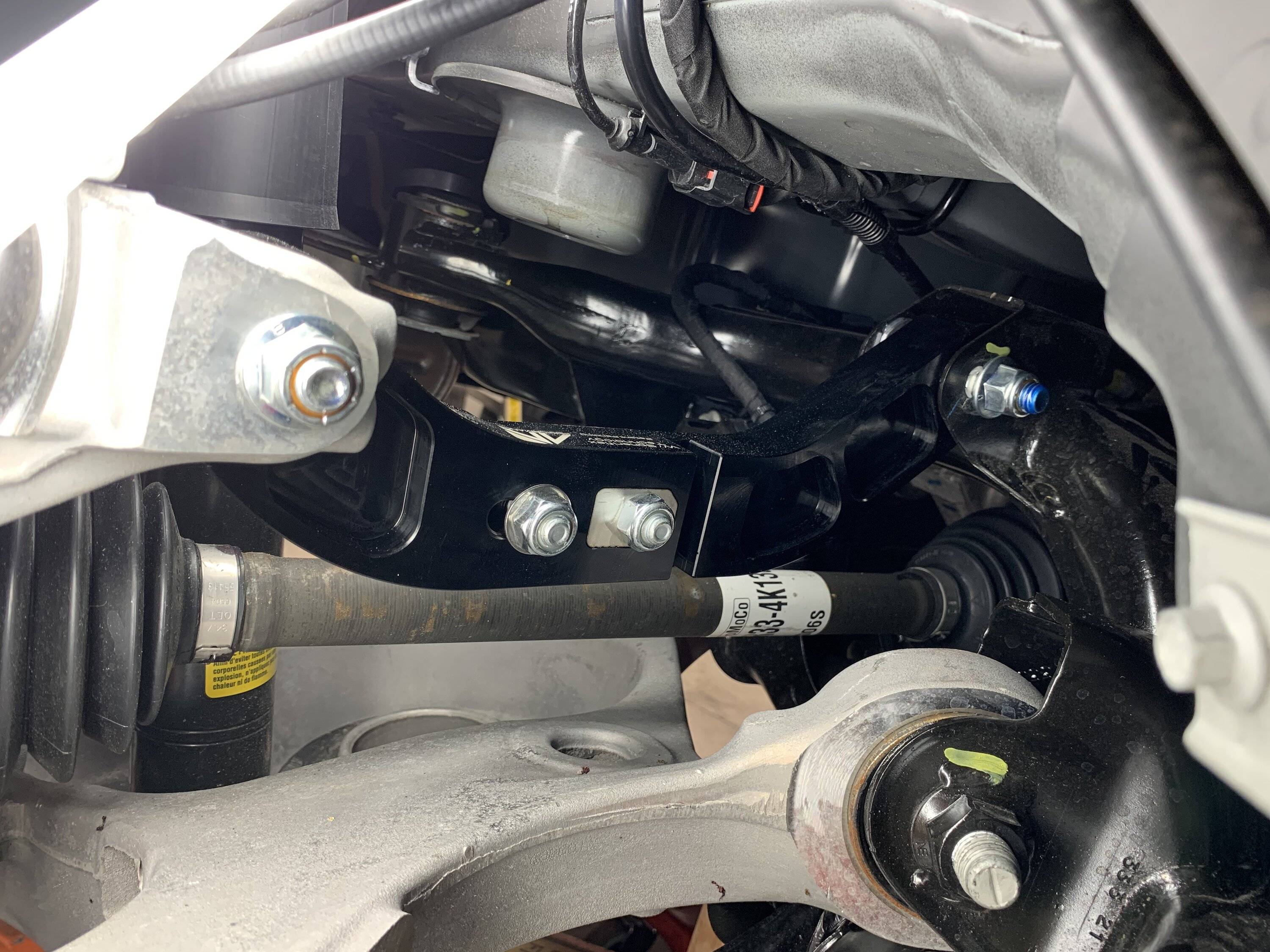

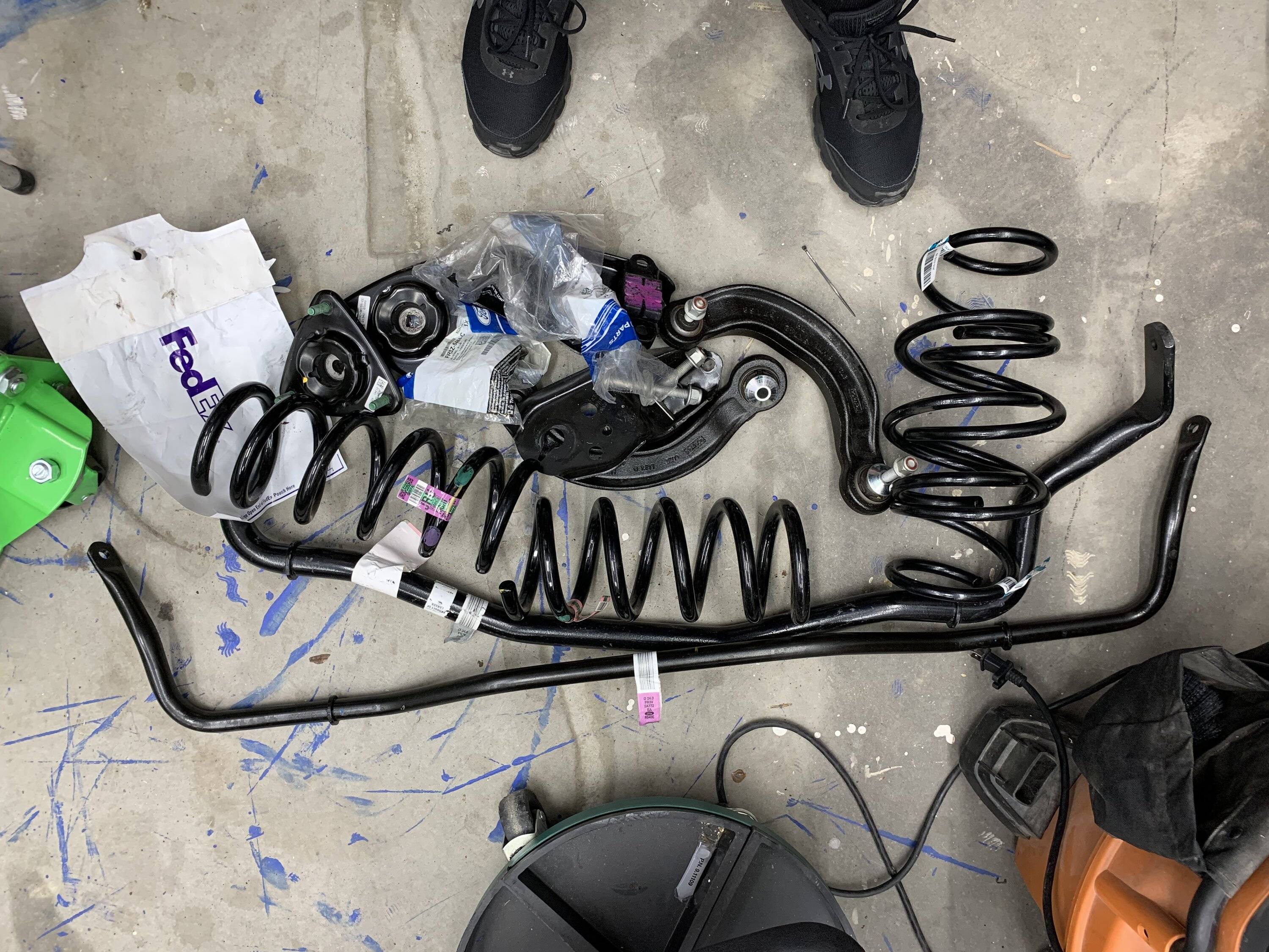

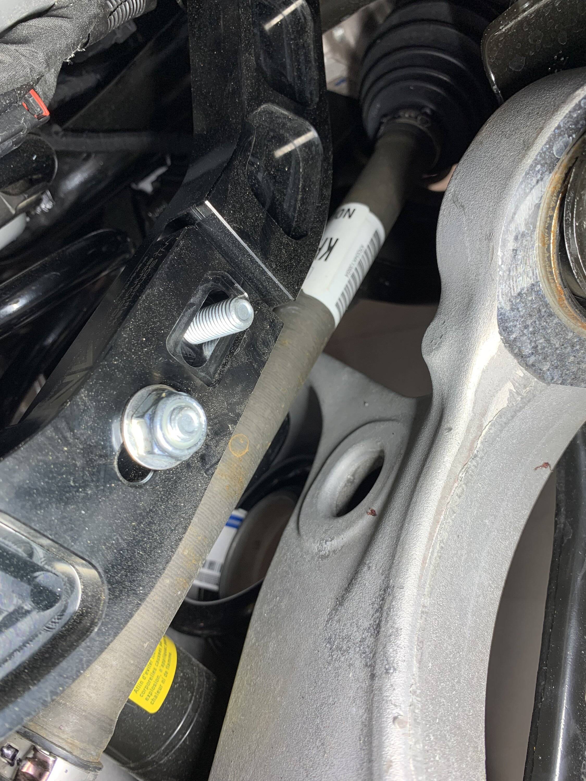

Most of the suspension is now installed.
Today I finished installing (don't ask how slow I am):
Ford Handling Package front springs
Ford Handling Package rear springs
Ford Handling Package rear sway bar
BMR CB005 Cradle Lockout Level 2
AAD Rear Camber Arms

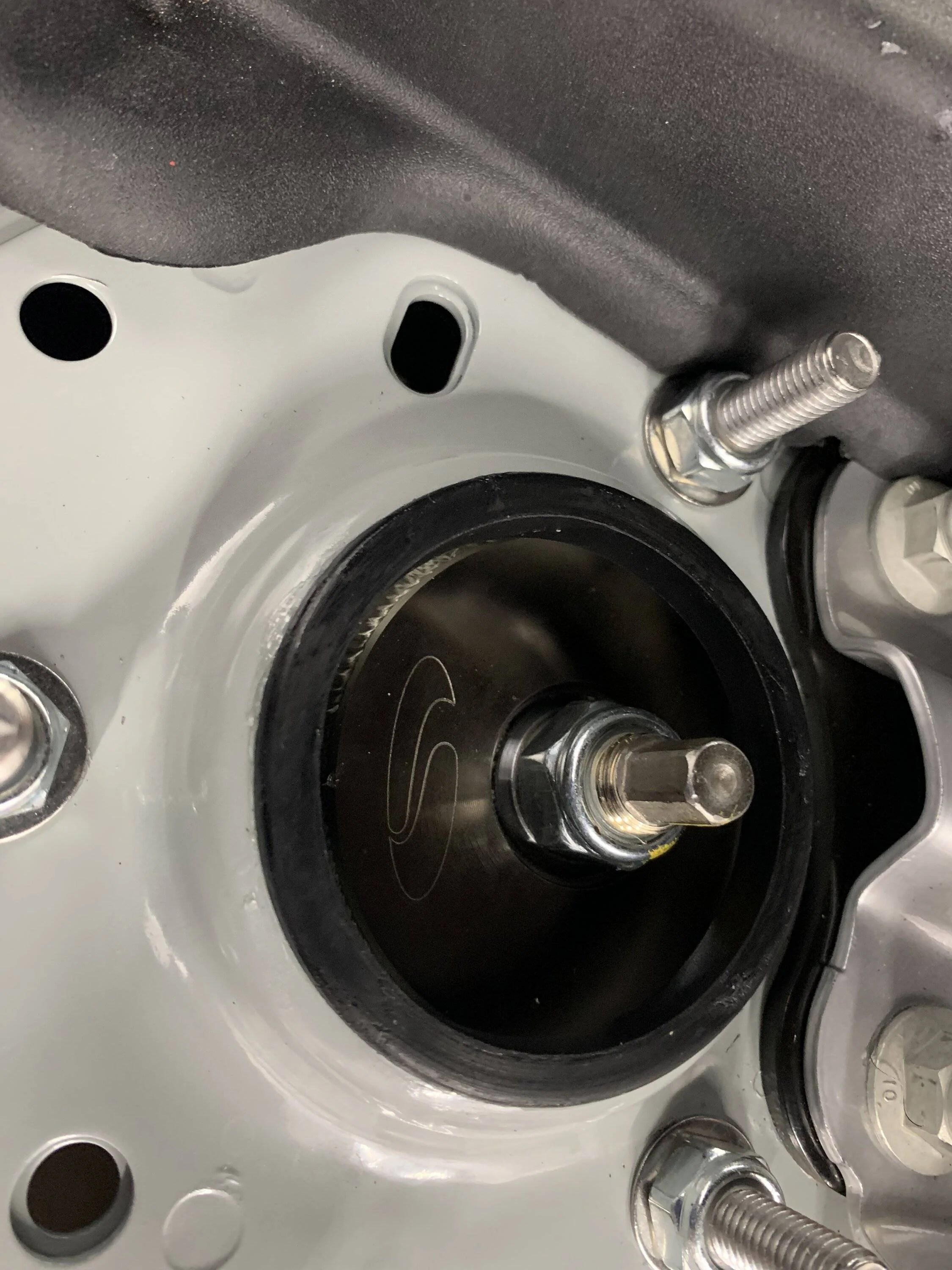

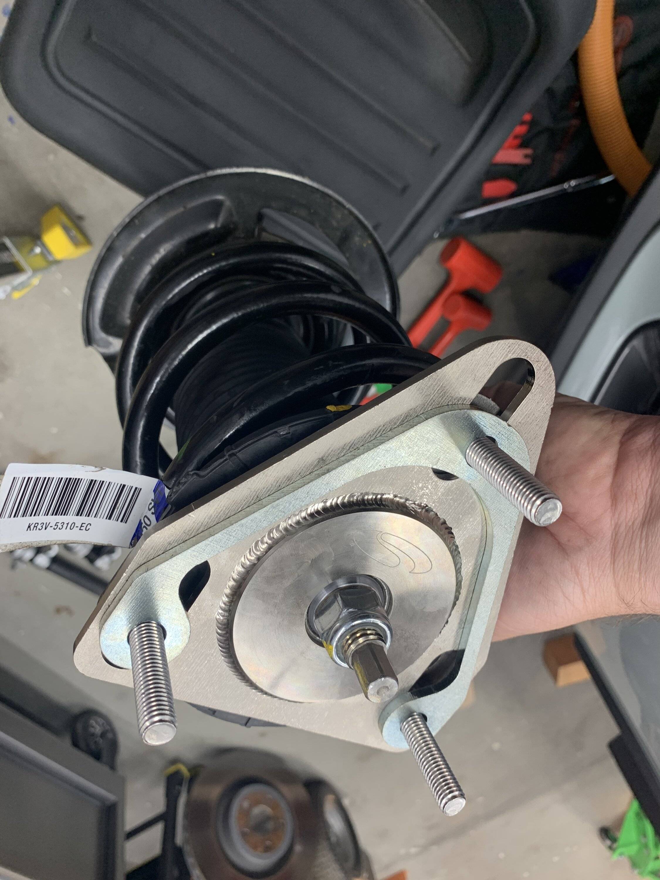

Steeda Camber Plates

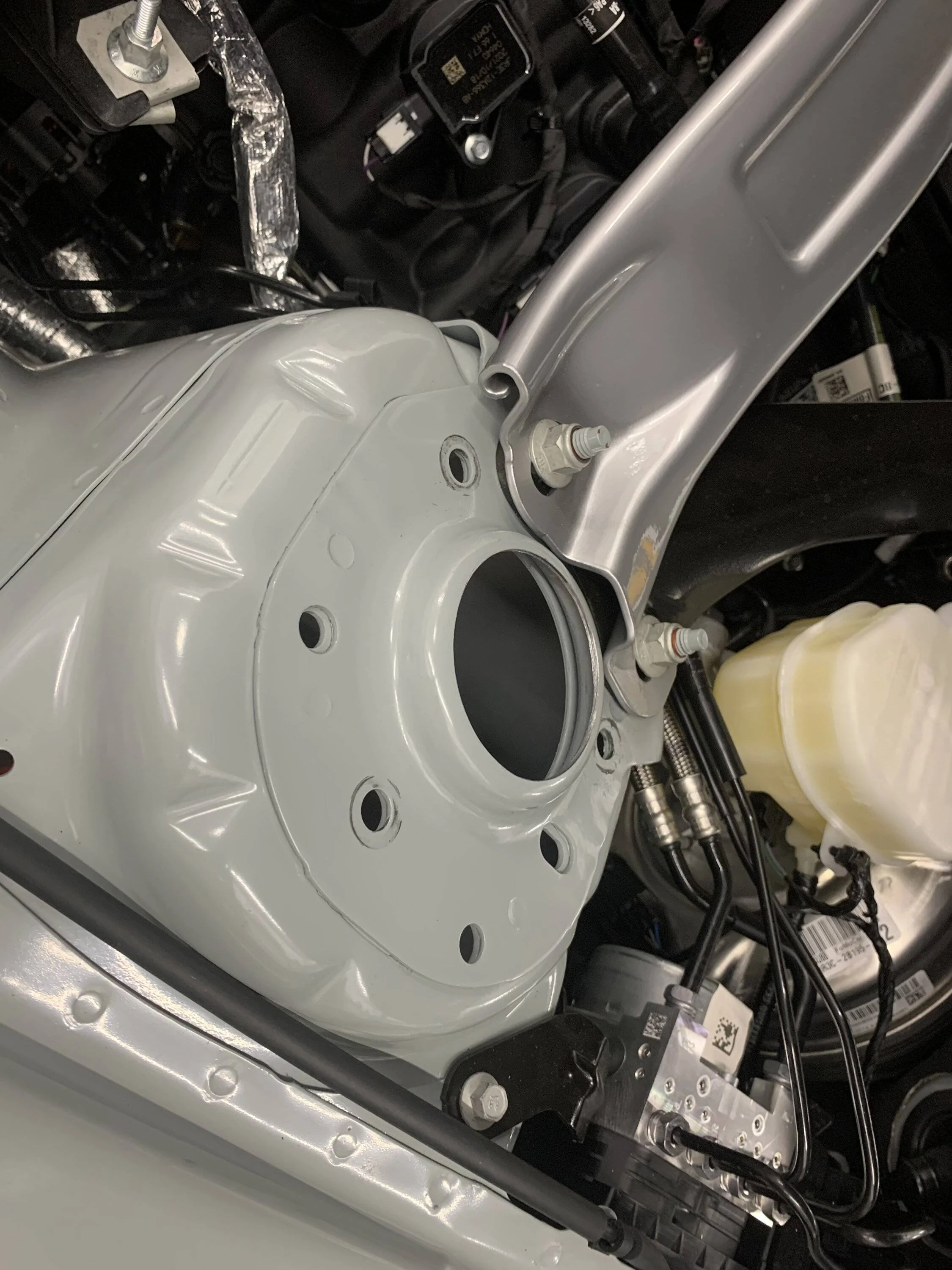

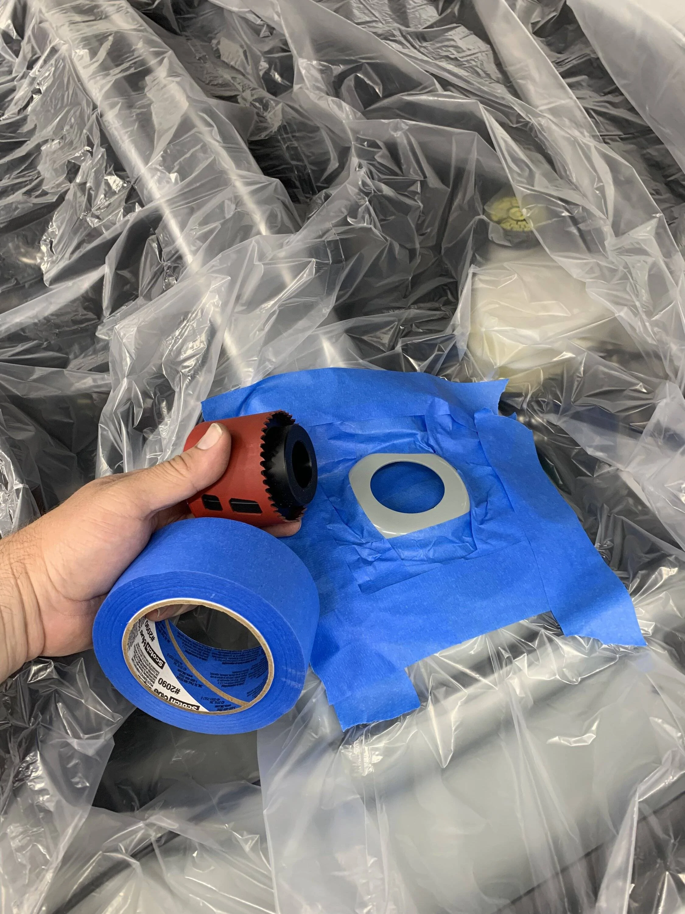

Strut tower opening enlargement to 2.75" from 2" w/Steeda hole saw delrin insert

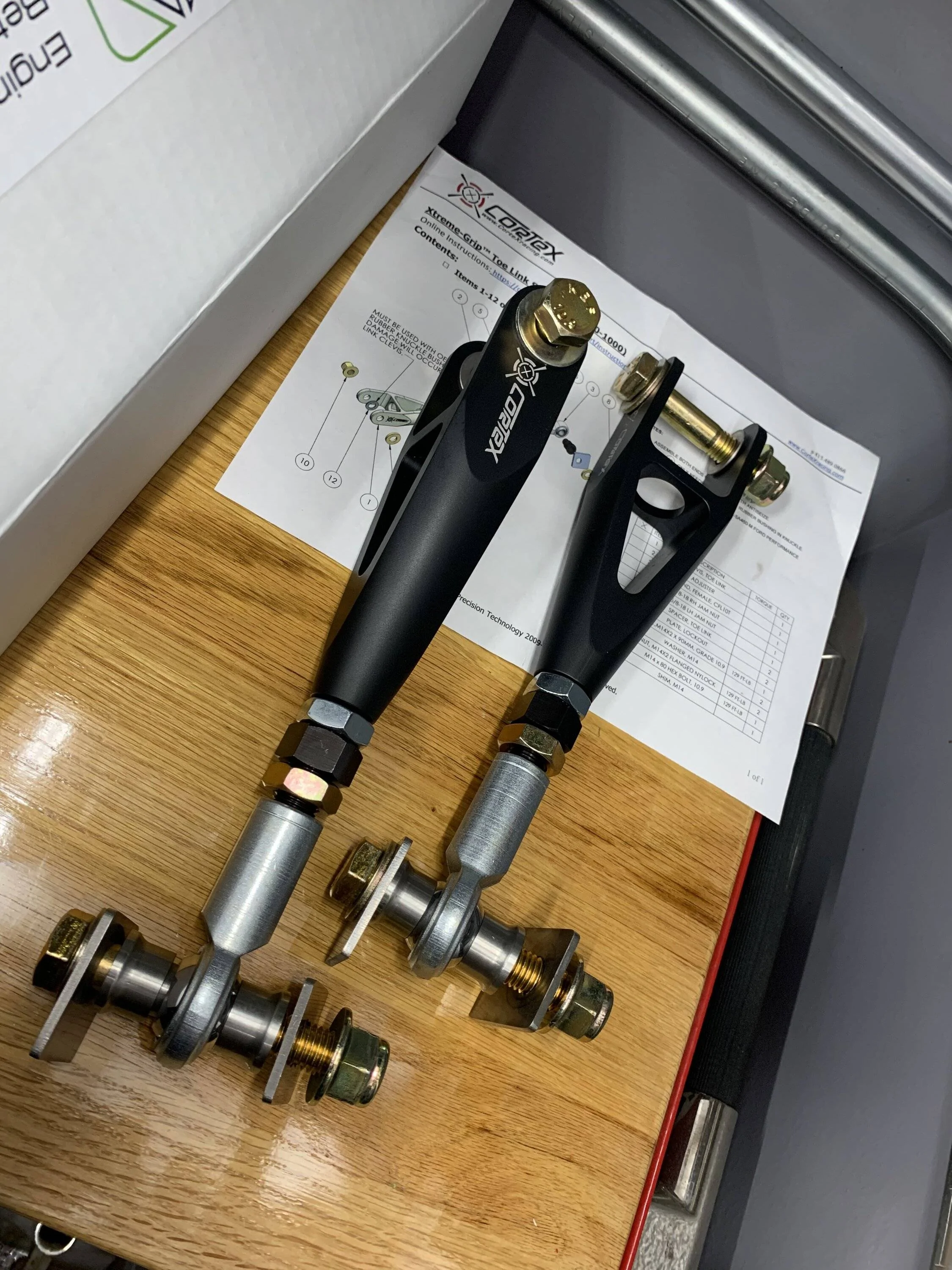

I have a set of Cortex toe links to install, but will likely do those tomorrow, but I'm half debating due to NVH concerns.

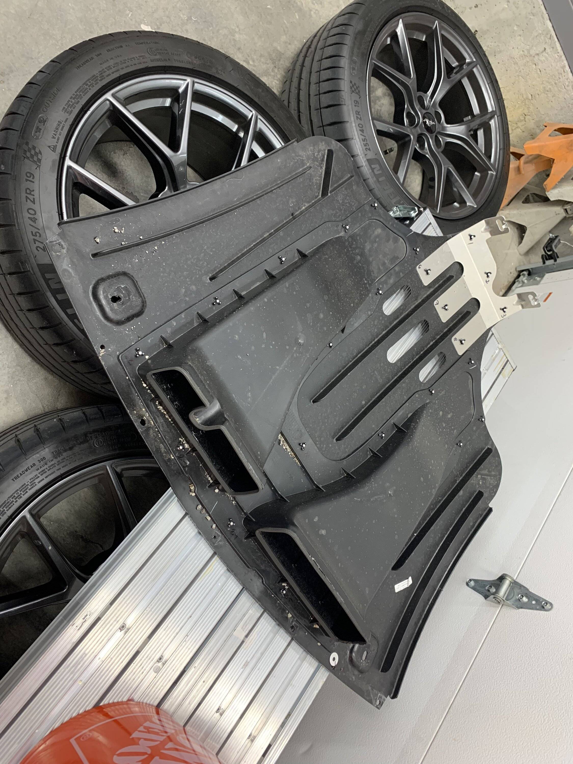

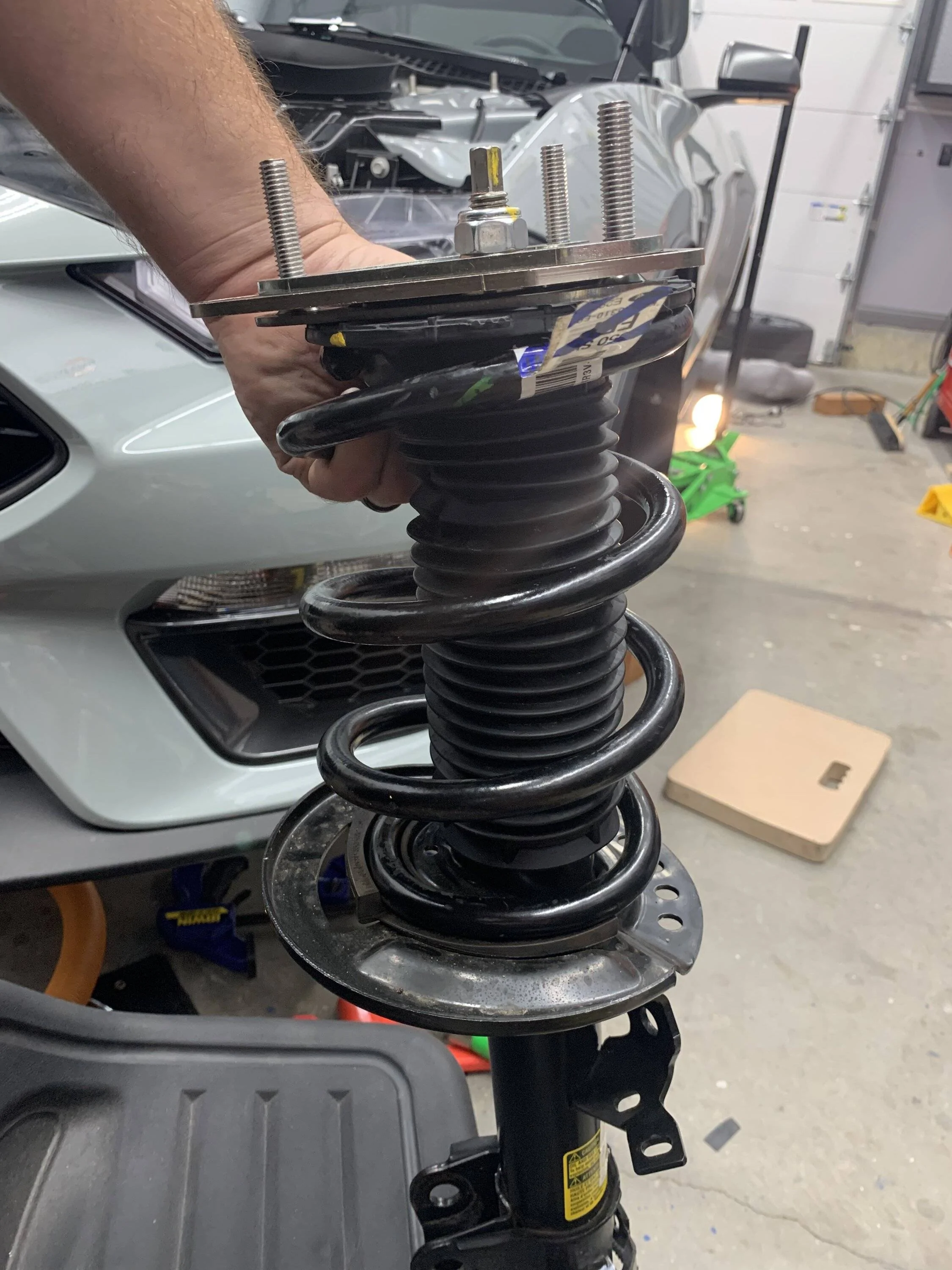

Last minute changes to my plans as in last week were Steeda camber plates, AAD rear camber arms, and cortex toe links. I discovered the factory camber plates are very limited in camber, Vorshlag was on backorder so I chose Steeda since they use the upper sprig mount-hoping this keeps NVH low. I also looked at the rear suspension camber adjustment and saw what a mess it is to adjust and maintain so I chose AAD camber arms. The toe links I have, but haven't put on yet.
I got so far as ready to pull the front sway bar (all bolts removed) and replaced with the GT350R unit and then stopped. I didn't want to fish it around all the A/C, brake lines and other delicate pieces without help. The factory front bar is also a bonded bushing bar so I'm not sure the 350R bar will be a lot stiffer-if I go to that effort in the future it will be a BMR 35mm front bar.

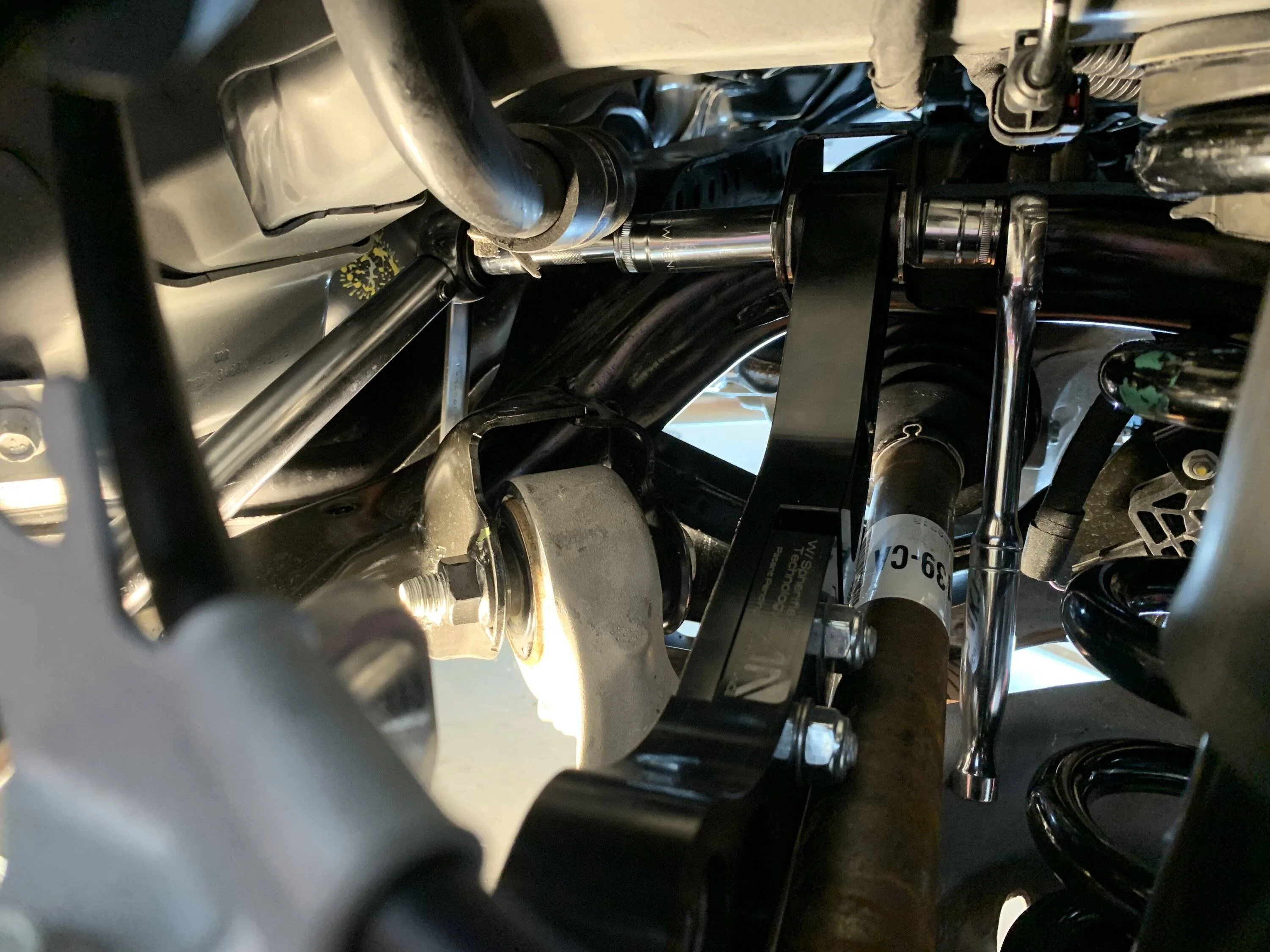

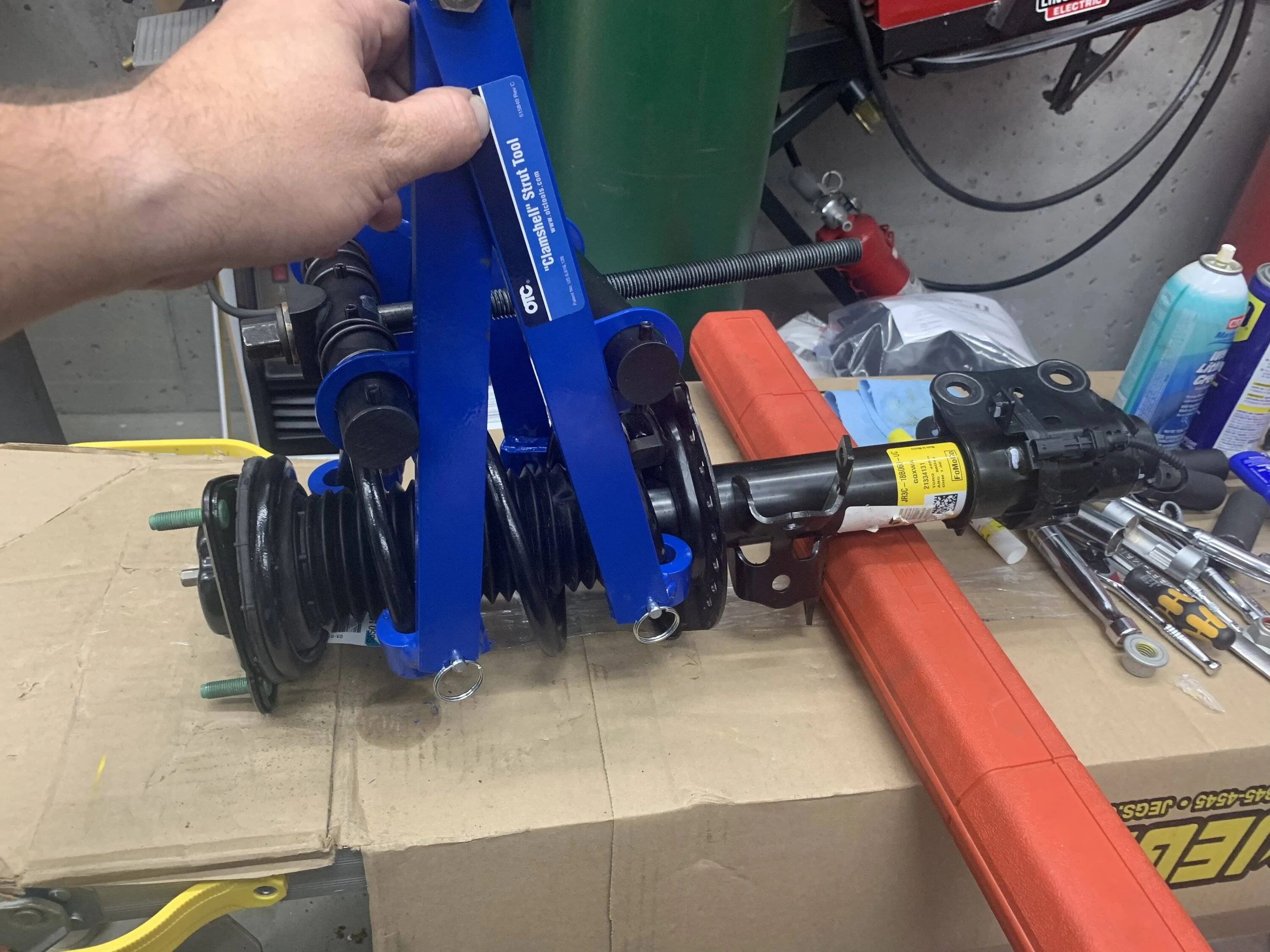

Up front: I used and recommend an OTC 6494 spring compressor. I lost 2 days because I assumed my conventional spring compressors would work. Front end work wasn't bad, but you have to be careful routing the wheel speed sensor and magneride wiring to avoid damage. The lower strut bolts need to be hammered out: 3 of the 4 were easy, but one required a ton of hits with a 4# hammer and the jack changing load at the hub. I replaced with new bolts. One bolt had difficulty going back in and seating fully but it eventually did at 184 ft-lbs. The endlinks were actually a bit of a pain to get installed and lined up-complicated by tight fit and bonded bushings/preload.
In the rear I used the CJ pony method of dropping one side of the cradle at a time by removing the front and rear cradle bolts and slowly lowering the jack. I still had to push on the control arm with my chest while using my arms to remove the rear springs-they come out pretty easily this way-but remember to pull out top first. I installed the BMR lockout kit at the same time-well made but a pain getting all the bolts to go in-the cradle does not want to move-and didn't much-the bolts all went in so it must be good. Dropping the cradle also makes the camber arm install super easy and possible to actually torque. The AAD arms and lockout tabs fit-but it was very tight.
I've only done a brief test drive and everything is quiet and seems fine. I did initially have a suspension fault, but that's from when I started the car to turn the wheel to help lineup sway bar endlinks with the struts unplugged and ride height sensors mechanically disconnected. It has cleared since and drive modes are all available. Tomorrow, I'm going to see which of the two local race shops can get me in for an alignment before a road trip-if not I'll align it myself (dear lord please no). The car does actually feel stiffer-even with the modest rate increase and only a 20 minute drive. I'm debating the toe arms at this point. Only other mods left are to install the front ARP wheel studs for the 19x11’s.
Fortunately the wife was away with her sister this past week and didn't watch me (other than the security cameras) disassemble a $60k+ car with only 985 miles. The last pony car I had was a '94 Camaro and this suspension makes it looks like a dinosaur. I was constantly worried about delicate electrical connectors on the struts, ride height sensors, and everything else on the car.

Nice job on all of your mods!đź‘Ť. That inside bolt on the rear drivers side camber arm is a bit of a PIA indeed.

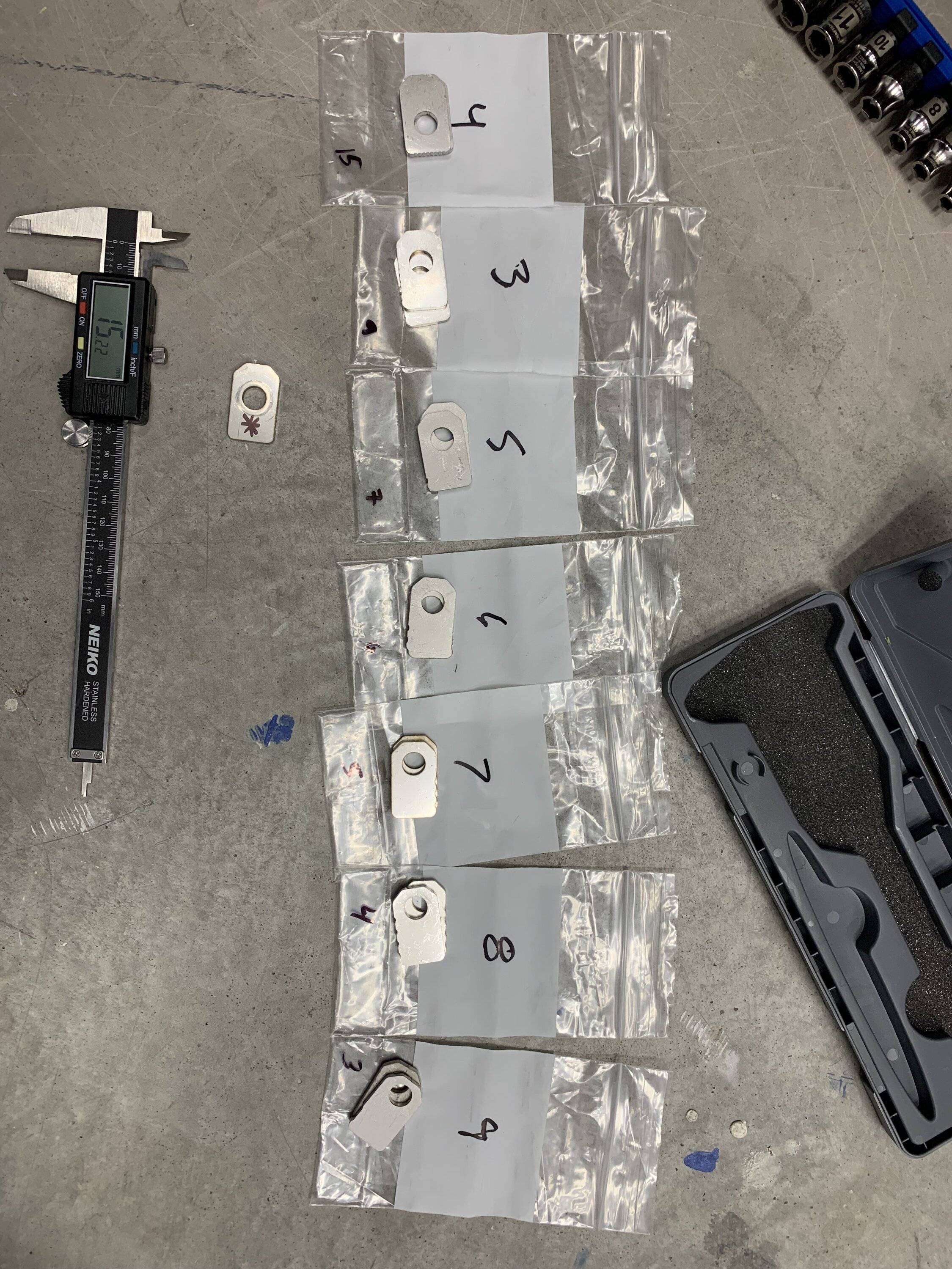

Life got busy, in addition to an unexpected funeral there is also a wedding this week so the car is on the backburner. On top of that the local race shop cannot get me in until next week for a custom alignment. It's also meant I didn't have time to align myself. I did however play around with camber front and rear. I nailed the front dead on on my first try and have -3.0* both sides.
The rear with AAD camber arms, stock +2 tabs, and index plates with holes at inboard/most negative camber position were -2.3*drivers side and -2.8* passenger side. I changed the passenger tab to one that made the camber arm ~4mm longer, this moved camber to -2.0*. The driver's side will get moved 1 to 2mm. Given the uniqueness of the arms I'm trying to make the shop's job shorter. I've seen AAD claim ~.15* per mm for Ford and .25* for Mopar.
Here's my target spec's I'll give the shop
Front
-2.9 to -3.0* Camber
Zero toe
Rear
-2.0 Camber
0.30* total toe in (evaluating this one)
