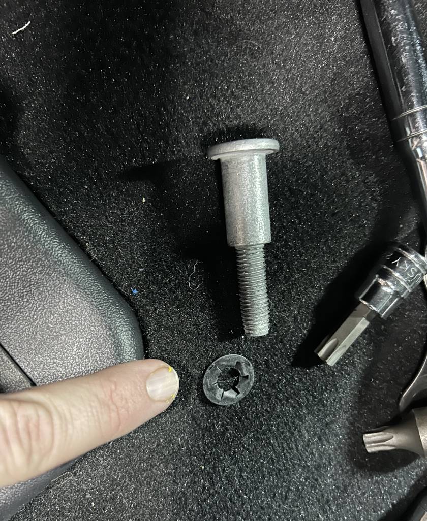

The rubber bump stops unscrew as I recall and a trim removal tool helps with the plastic clips and rivets all over the car. It yes the trunk liner has to be removed for the middle two.
Thanks. Already finished. Just went for it

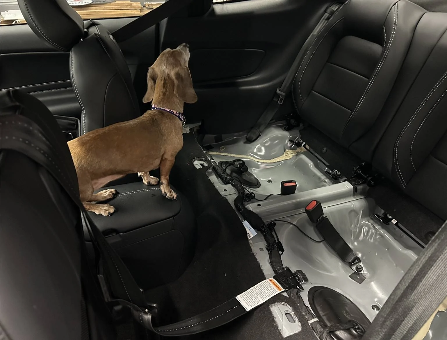

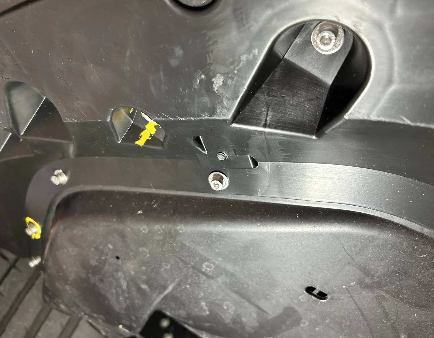

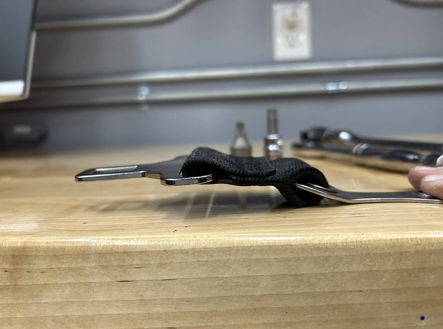

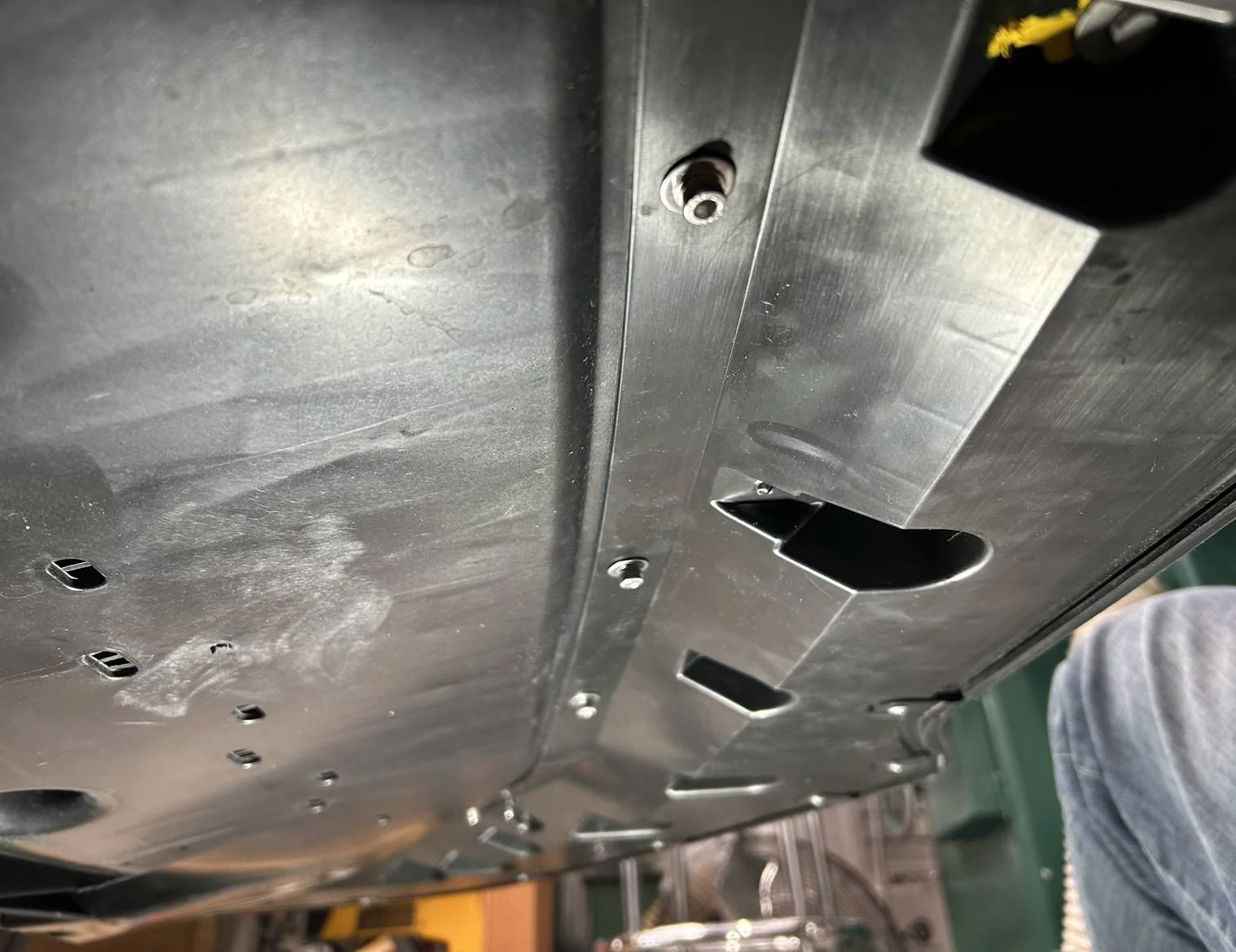

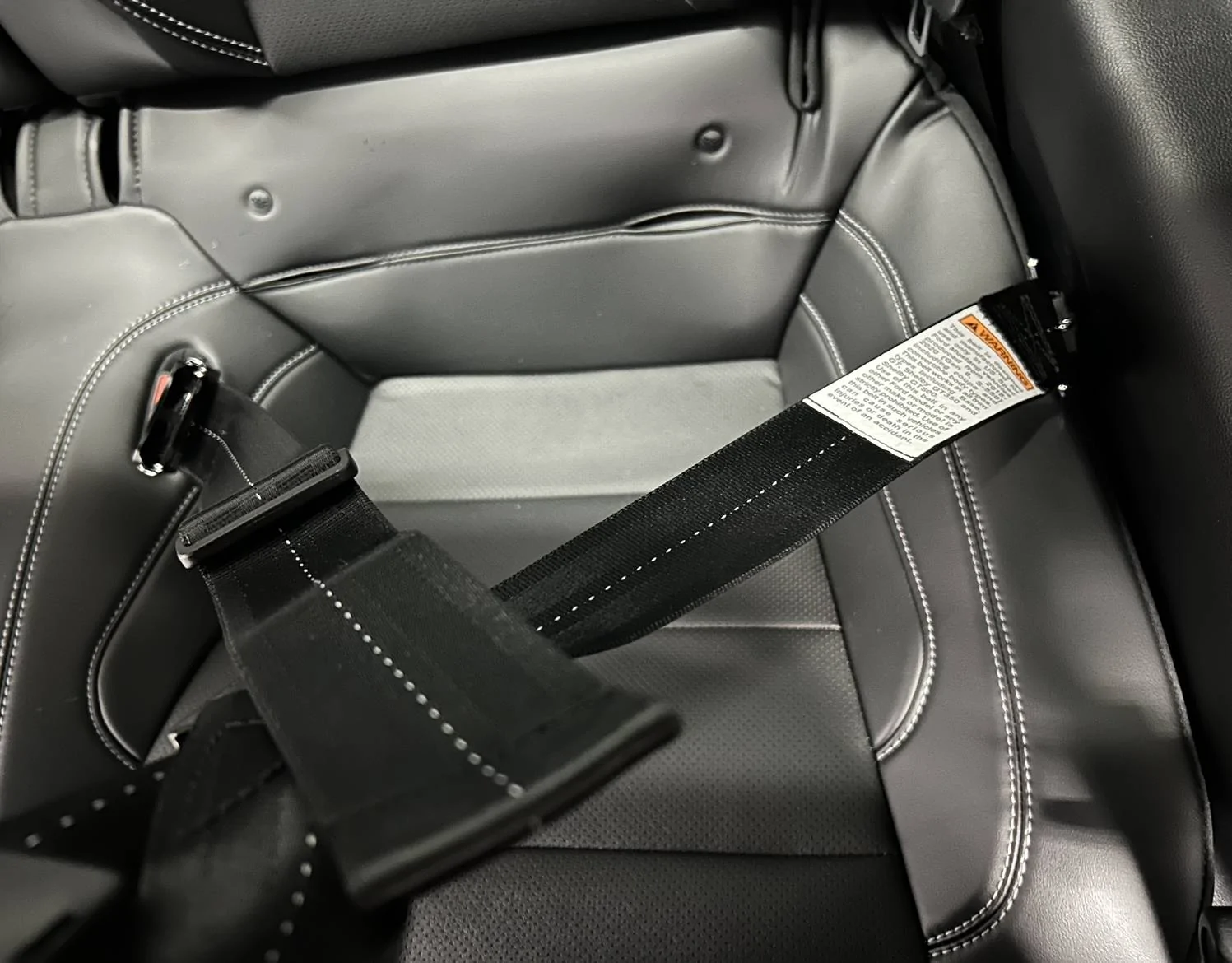

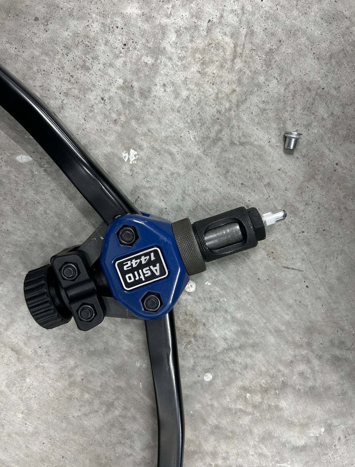

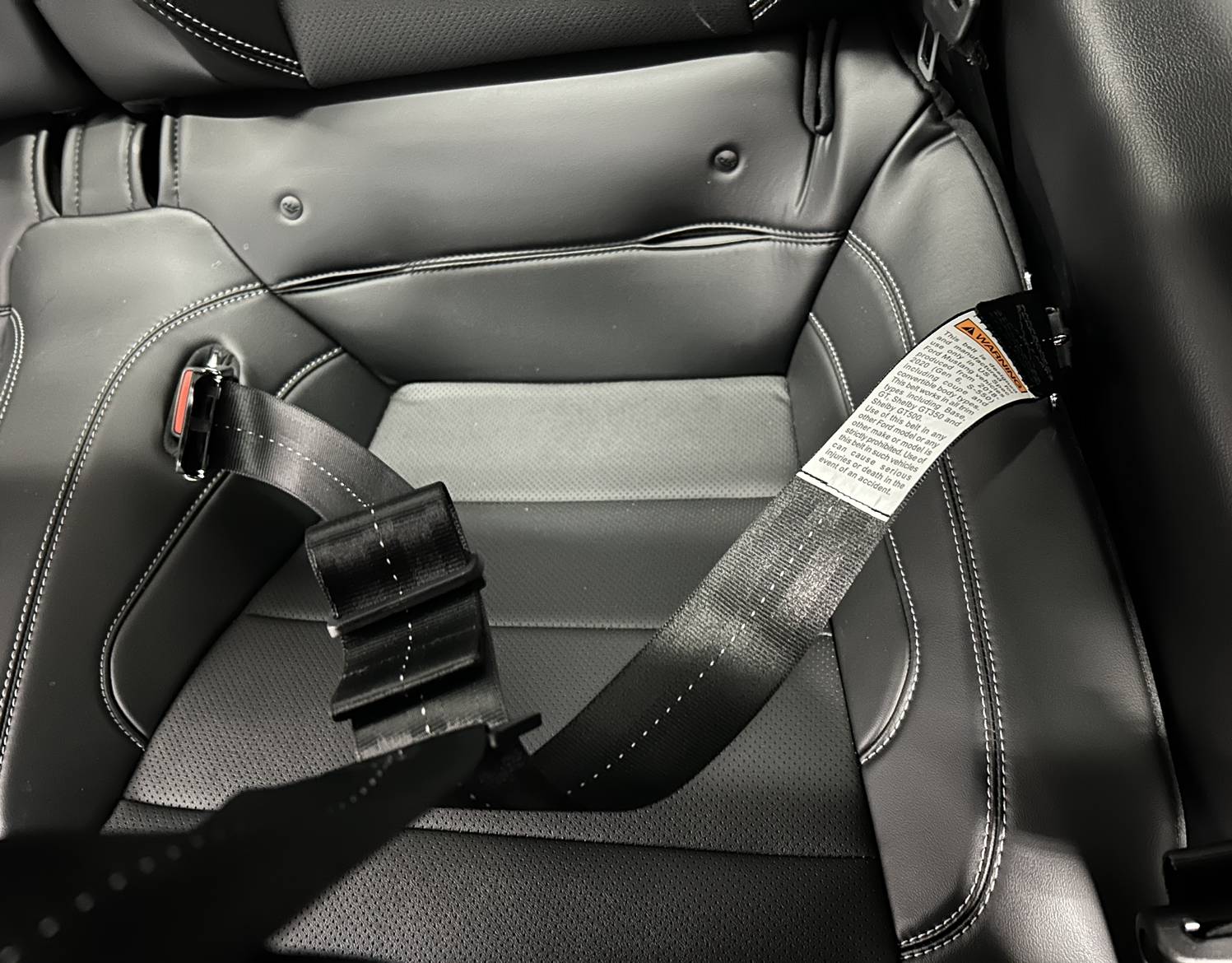

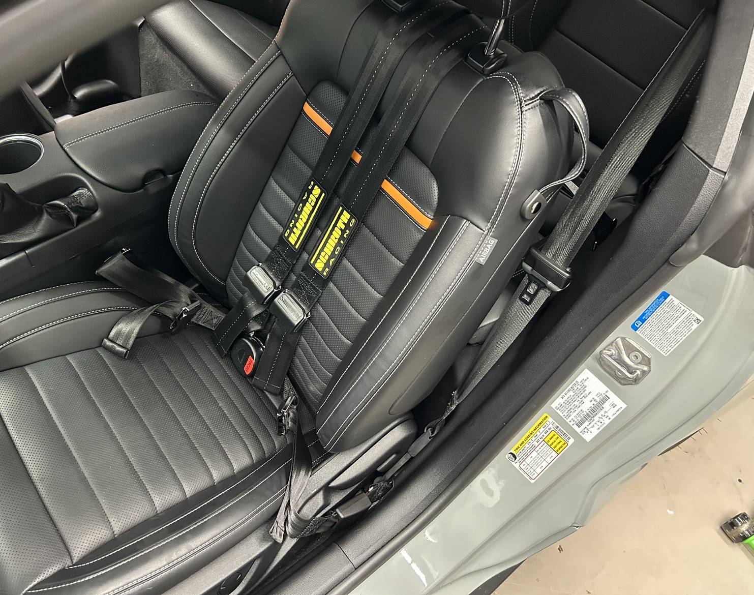

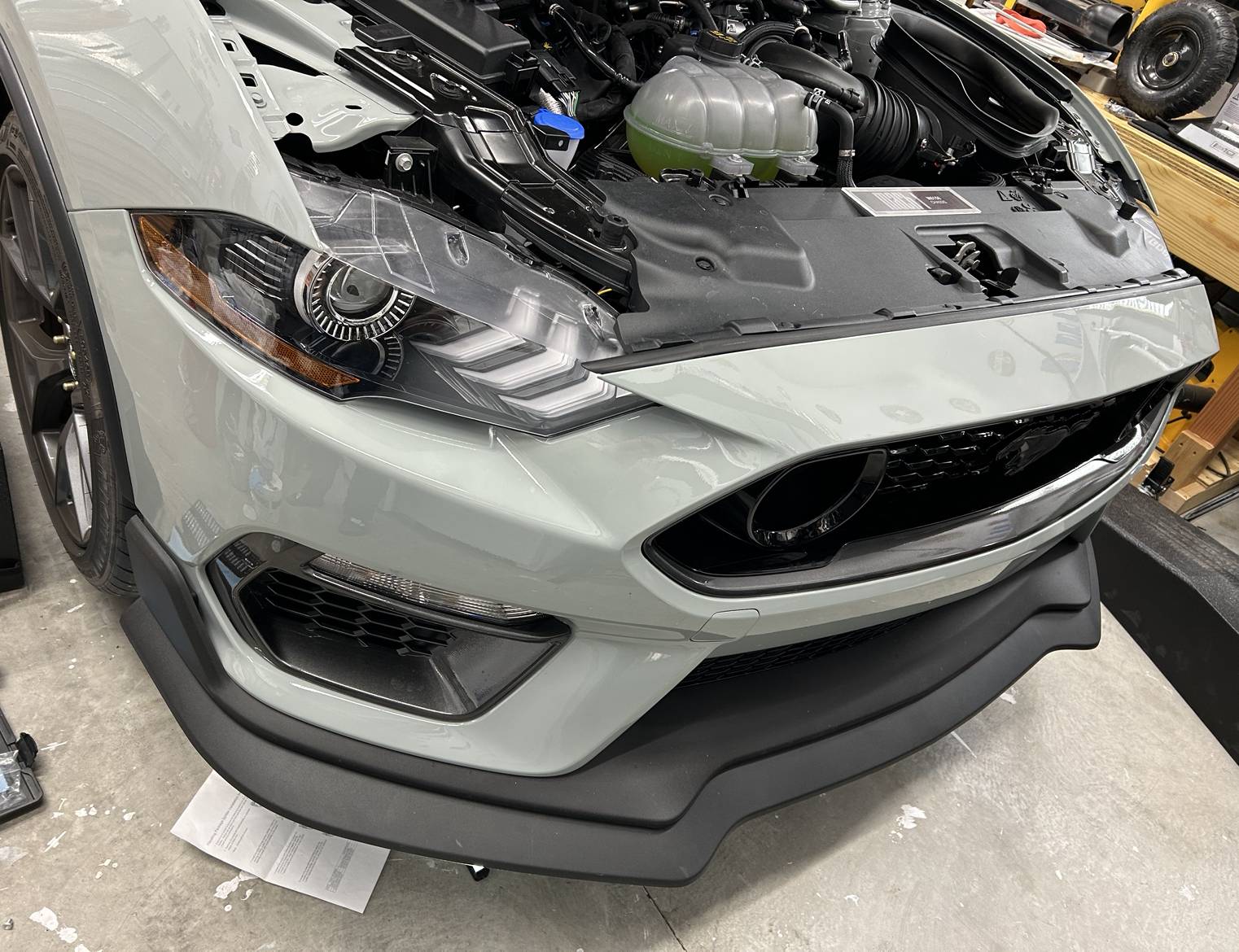

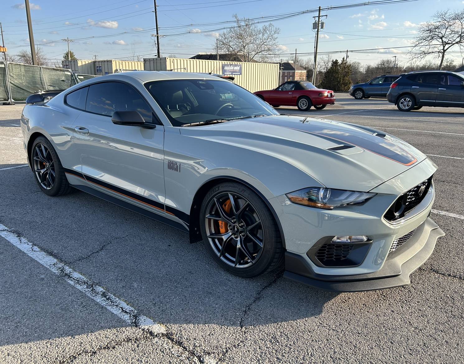

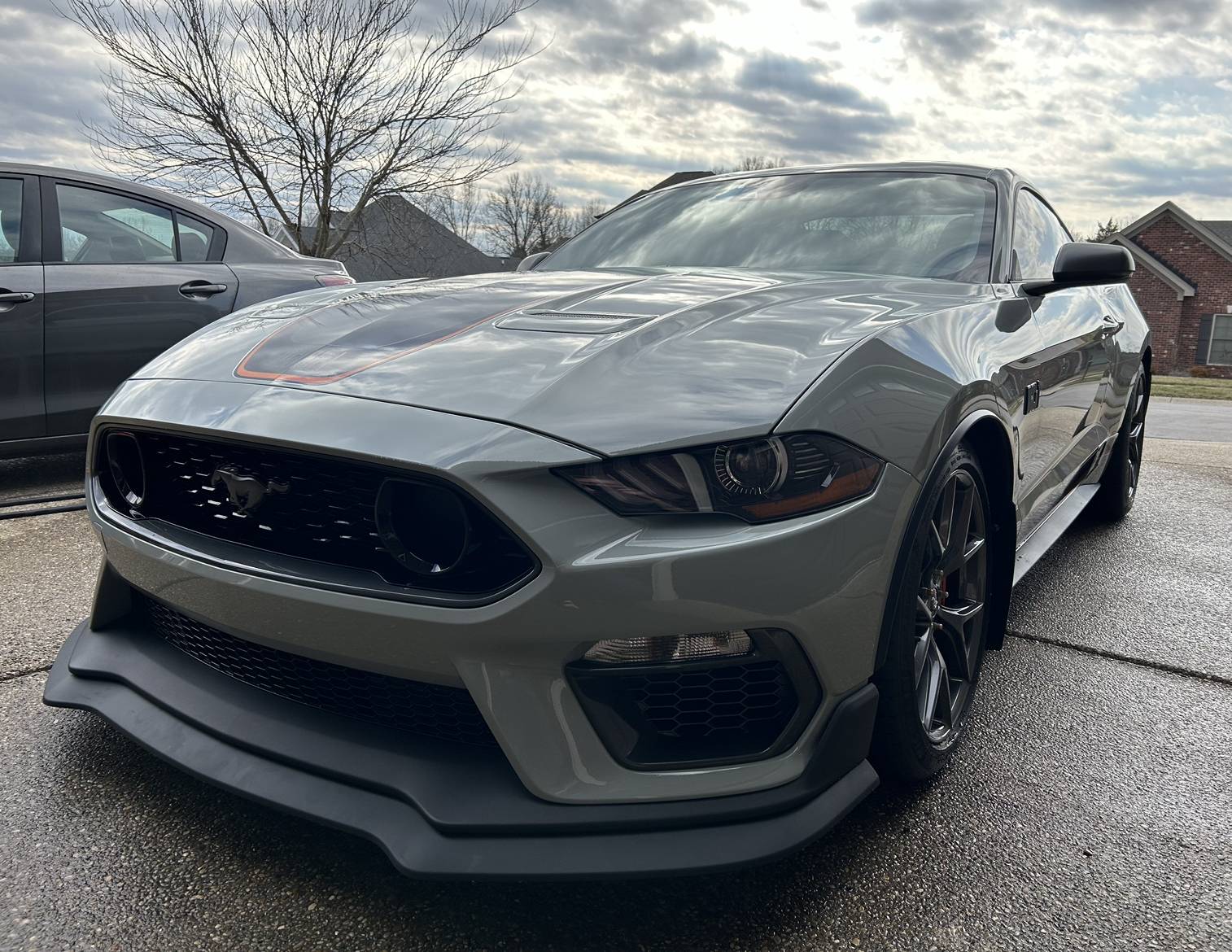

Installed a few things this weekend:
1) Handling Package lower splitter with M5 rivnuts and stainless socket head cap screws.
-Take care not to overset the rivnuts in the plastic I did with one of them
-It's removable, but it will take a while to remove and install
-Looks so much better and more balanced visually
-Need to get some pics with the 19x11's installed up front

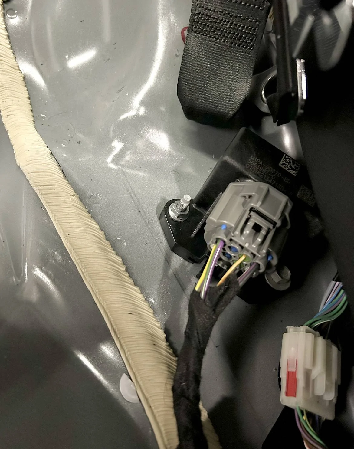

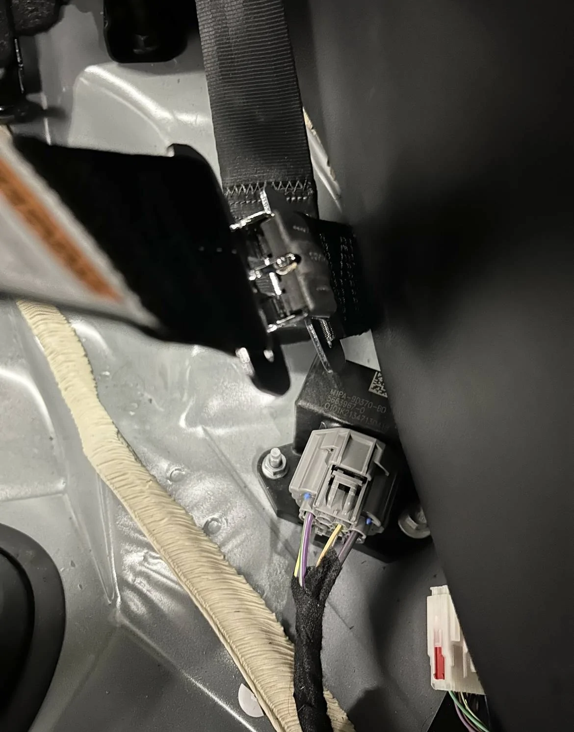

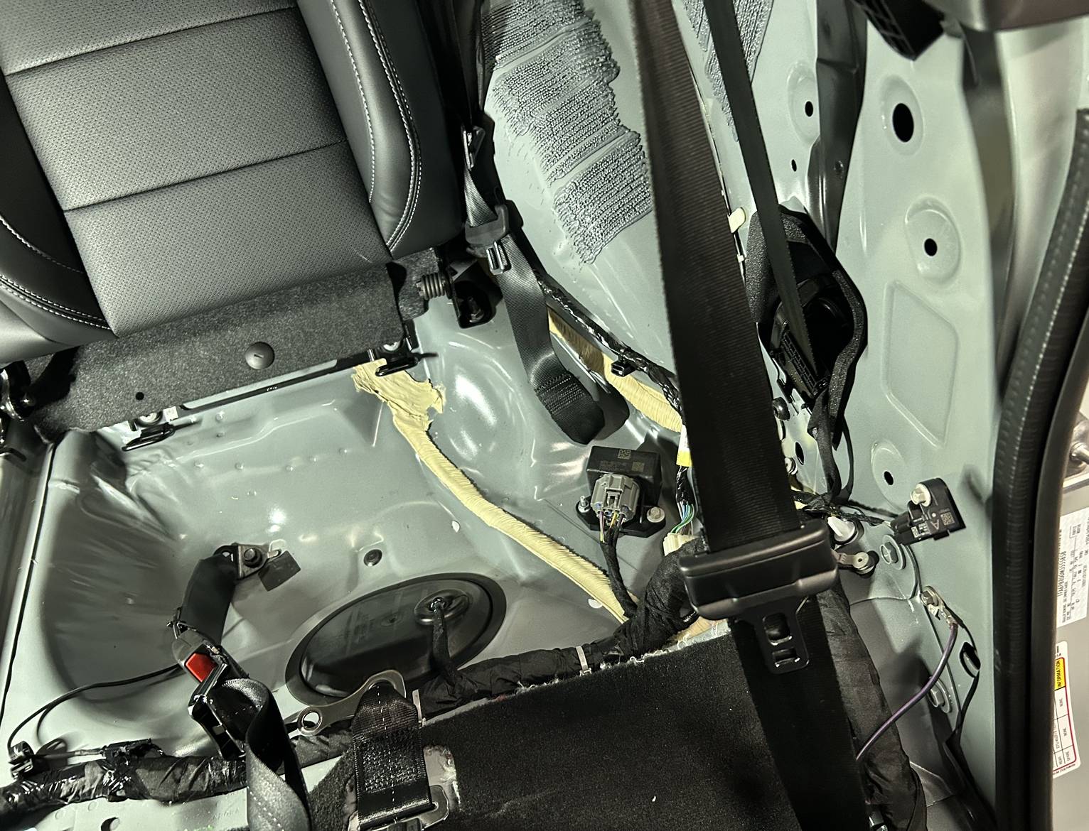

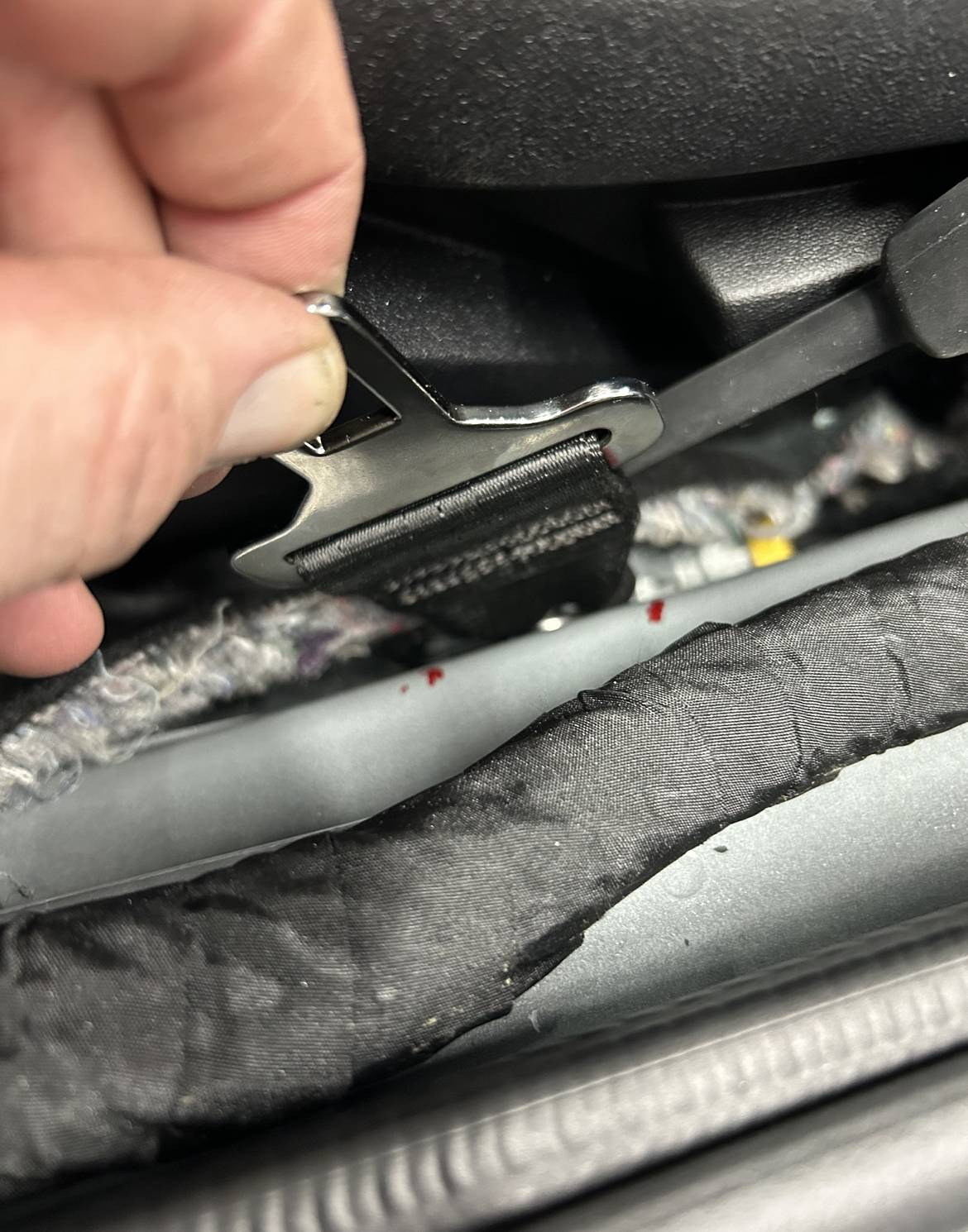

2) Schroth Quick Fit Pro 4pt harness
-Not bad install, I had to bend and tweak both driver's side brackets to get the right angle and clearance
-Driver's side rear adapter took a good amount of work to tweak and align to ensure it wouldn't load the factory module in pictures, other install pics I saw did'n't have this.
-Driver's side front adapter required a slight tweak and trimming of the sail panel plastic-4 iterations before I got it right
-Note: this will be used for autocross
3) Pioneer Subwoofer TS-A100D4
-Easy install, depinned harness, removed trim ring with zero damage, modified subwoofer to fit stock enclosure, added 6-8 oz poly fill to box,
-GREAT improvement in sound quality at all volumes
Bonus pics of my rescue dachshund, Penny coming to help on the harness install.

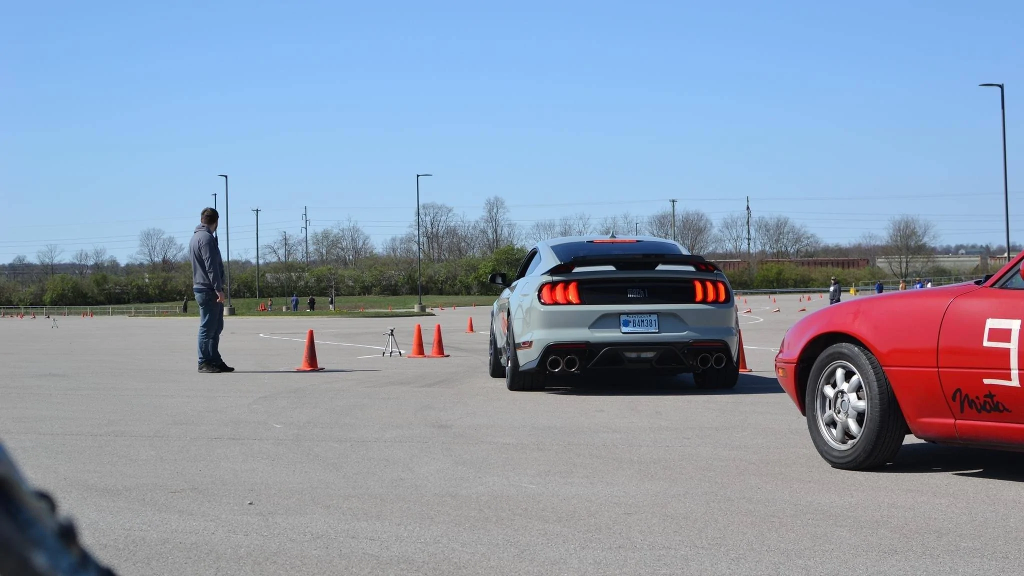

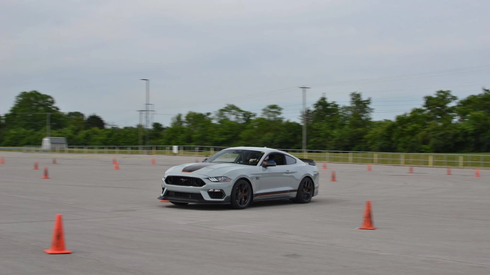

I attended my first autocross in a LONG time (15 years) with the car this past Sunday. I was off pace by 2 sec but considering how long it’s been I’m happy. It was below 50 degrees with brand new RT-660’s and they felt really loose. Hopefully next time they’ll grip better being warm and broken in, but my driving didn’t help matters. I’m going to attend an autocross driving school next month and try to get back into the groove.

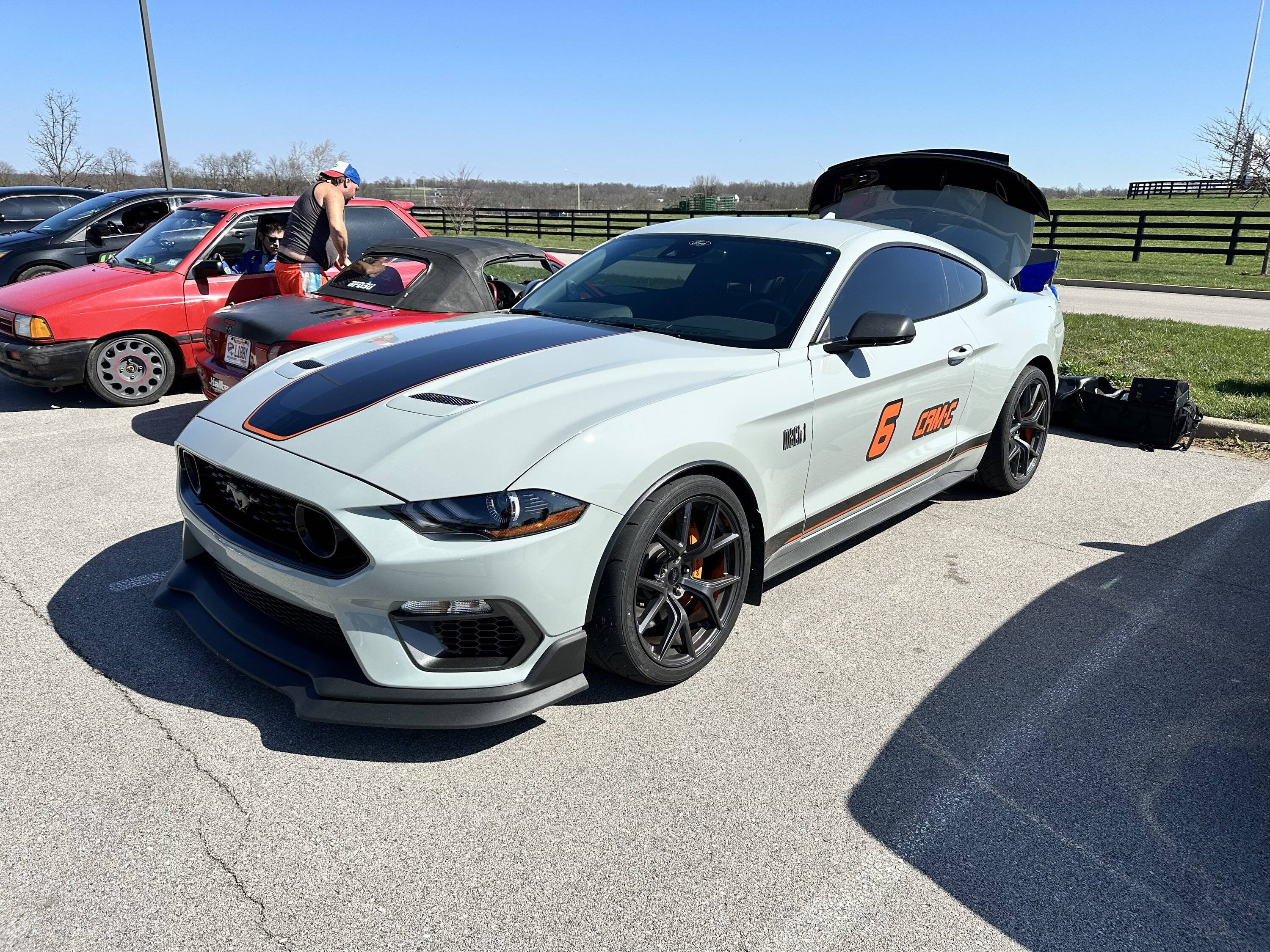

Shaking off cobwebs

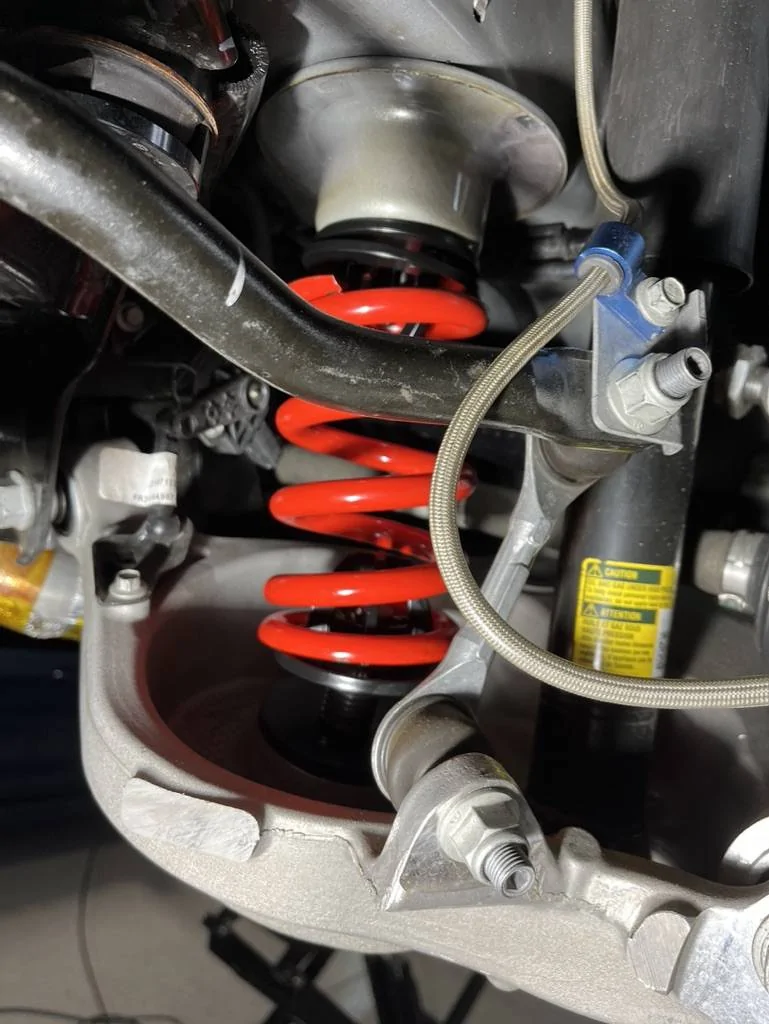

Local SCCA region driving school last weekend. First time with hood weather to get the 305’s warm enough to see what the car can do! I got 24 or so runs in and the car is great. I really think more people should drive these cars before throwing on parts or entire packages from vendors that have good branding and marketing. Granted I have a few upgrades but they’re small and it’s mostly HP package in terms of springs and sway bars. I’m glad I had restraint to start with HP springs and sway bars while the car was apart. Oh and for anyone that hasn’t be sure to drive these cars in track mode with AdvanceTrac turned off-it’s way too intrusive even in track mode to use and be fast. I remember the dirty looks I got and lecture when I asked to turn AdvanceTrac off at the Mach 1 track attack. I do understand why they wanted it on given the nature of the school. The only reason I found to keep it on is with 200TW tires at 42 degrees…. but I shouldn’t have been on those tires anyways.

This might not be your "cup of tea" yet but these coil-over spring set-ups are more cost effective, in the long run, and easy to change ride height and spring poundage. I have a front and rear set up. If you do a lot of track work you'll eventually want something substantially stiffer that what many of the big retailers offer. These are the only two companies I know selling these kits. Both are high quality and reputable.
Have fun installing those toe link bearings, they are a bit challenging.
https://ajhartmanaero.com/s550-chassis-rear-adjustable-spring-perch-kit/
https://ajhartmanaero.com/magneride-front-coilover-conversion-kit/
https://mikemaierinc.com/products/2...stang/2015-mustang-mod-rear-height-adjusters/
Looks like Steeda has one too.
https://www.steeda.com/steeda-555-8176-mustang-hardcore-rear-adjustable-ride-height-system

I don’t get what you mean all this work? It’s spoiler, splitter, fender molding, springs and a sway bar. The actual HP parts were installed in a weekend (minus the spoiler and splitter), the rest are upgrades. For instance I would’ve been dropping the rear subframe anyways to install the cradle lockout kit and upper control arms-so the springs and sway bar came out same time. Up front i ended up taking out the struts to replace the junk HP camber plates with real camber plates and enlarging the strut tower hole. I can get way more negative camber than a factory HP car. The labor was the same either way. I’m guessing you weren’t trying to buy one in late ā€˜21 or early ā€˜22. A lot of HP cars in ā€˜21 were cancelled by ford and ā€˜22 production was delayed. My October order was still not scheduled as of April the following year. If you wanted an HP car in late ā€˜21 or early ā€˜22 you either couldn’t find them or you were paying $10k markup if you didn’t order the car. I also ended up with a set of lighter and better wheels than the HP car.
