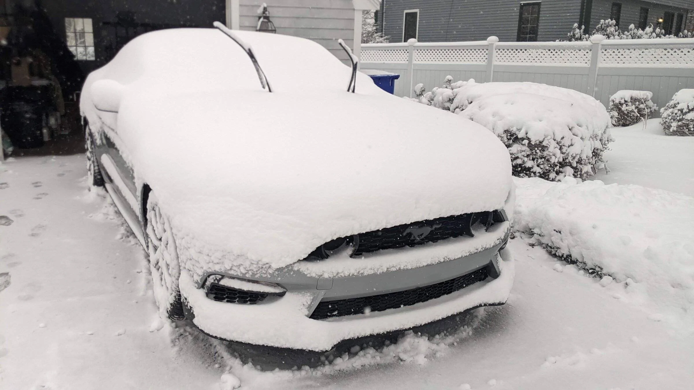

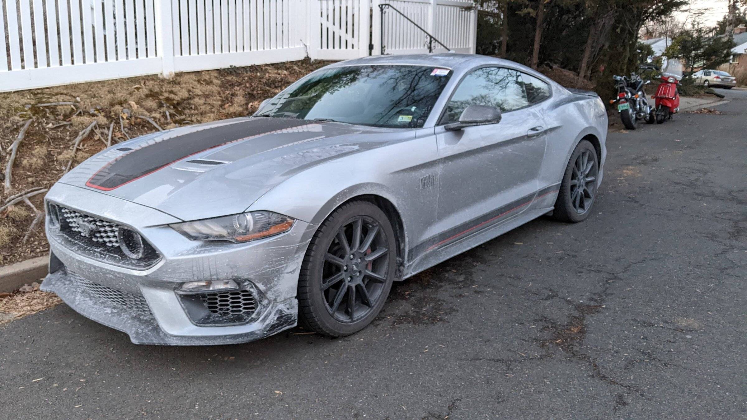

Right with you for "the usual". In fact, the A/S tires were "handy" on yesterday's return from Massachusetts (pictures attached - "before" snow coverage in MA and "after" road spray in VA), and the jacking rails make it so much easier to change from OE wheels with 4S tires to my square A/S set up. Only additional mod I'm considering is resonator delete, but it has to stay subtle since I like staying in stealth mode when appropriate. Like when Waze tells me there's police ahead and the fool in the Charger or Camaro decides to try to get me to step on it -- Quiet mode works wonderfully and I'm not the one who gets all the attention!
