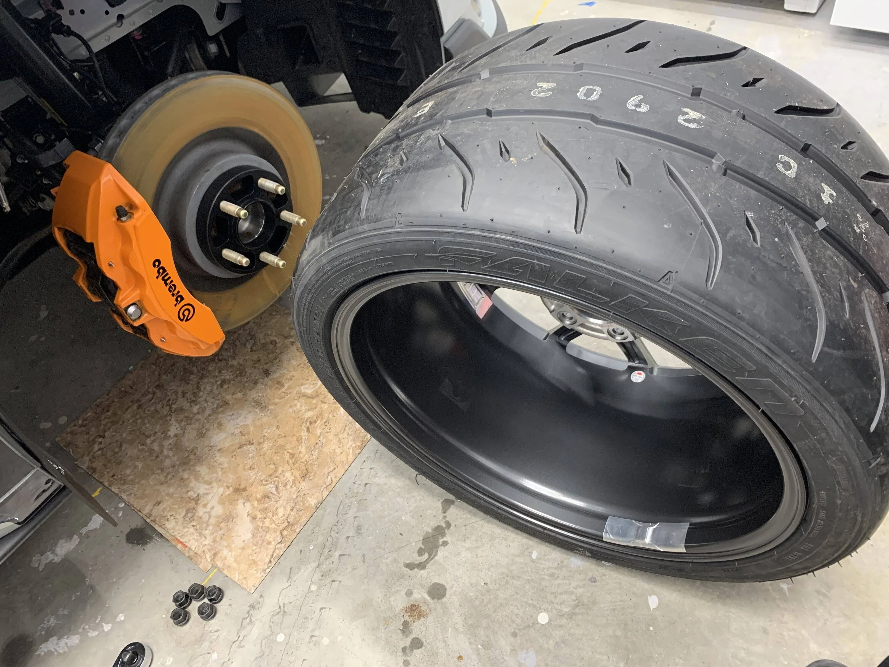

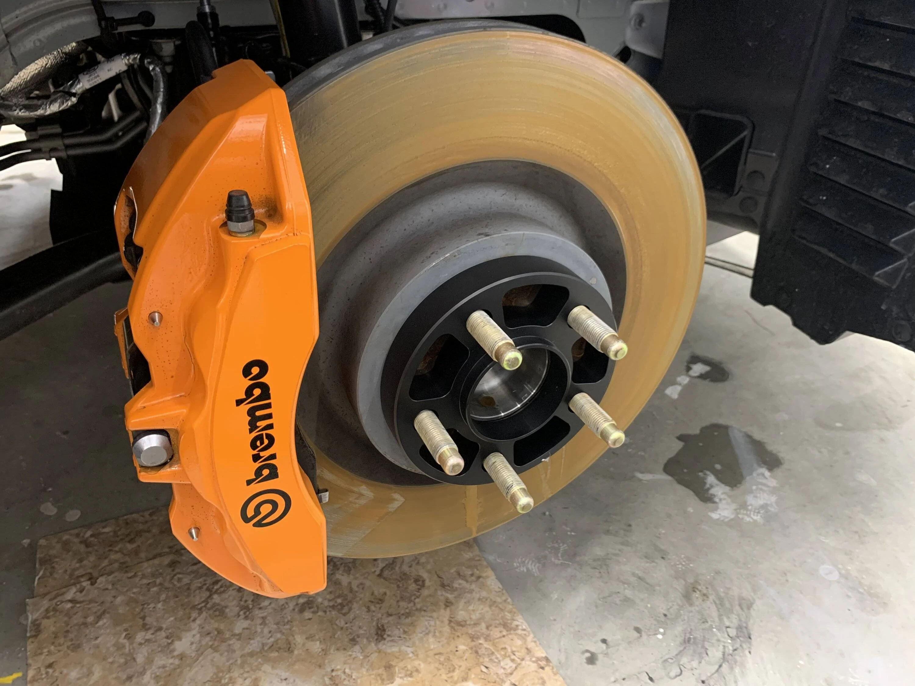

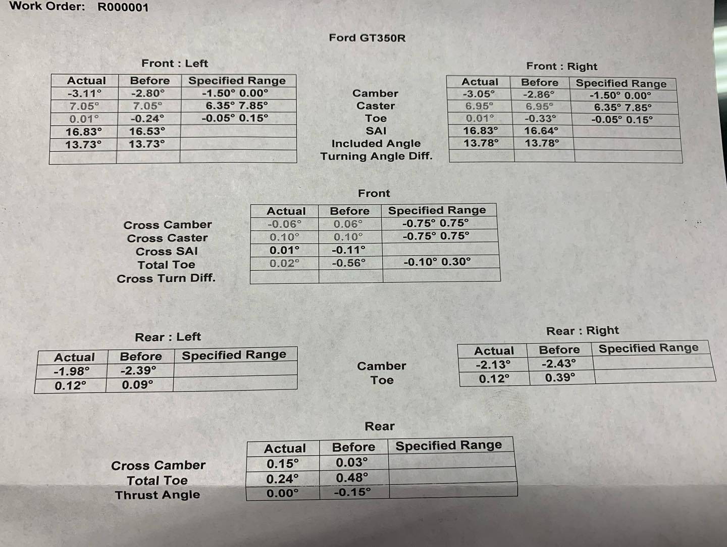

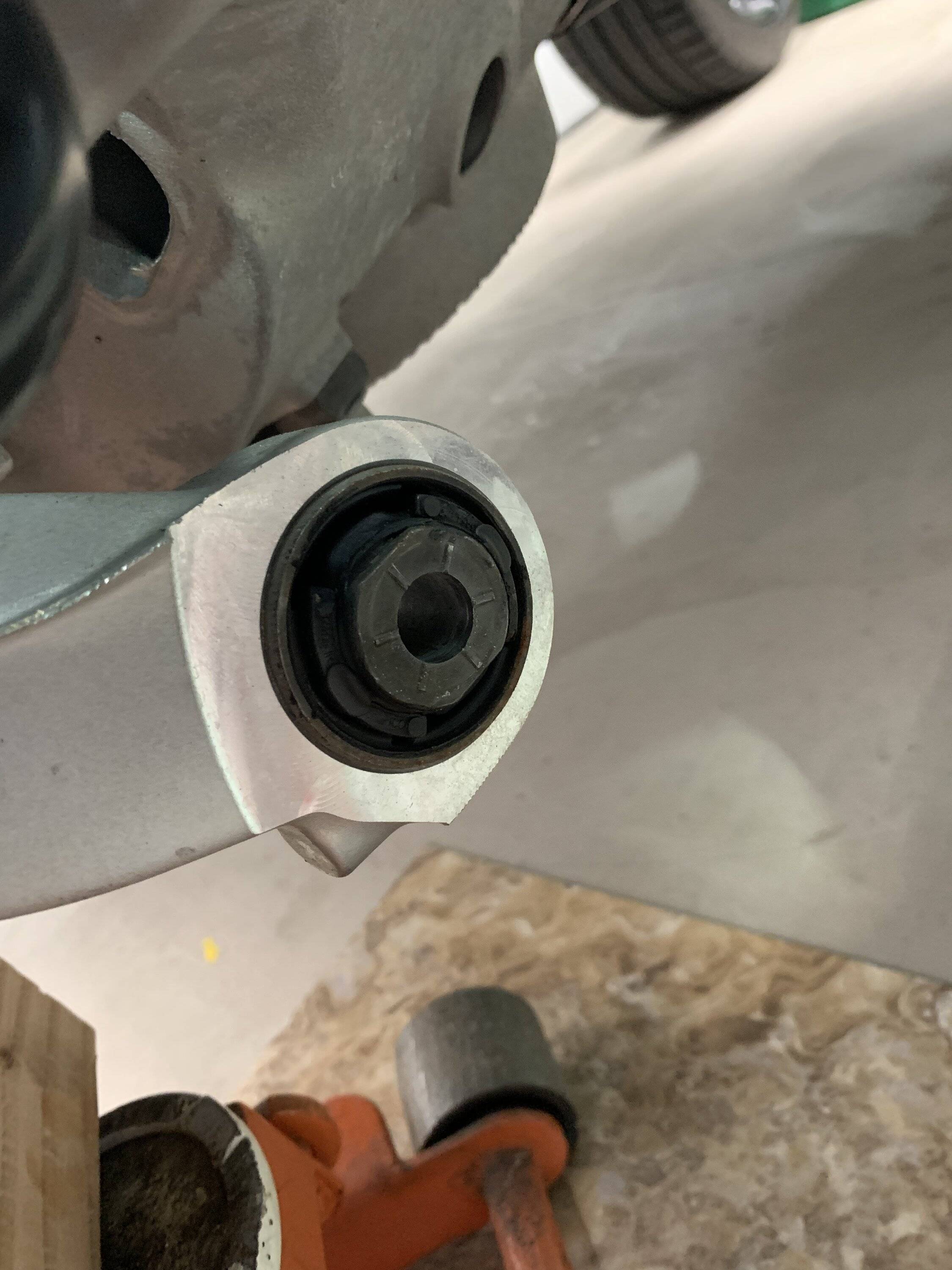

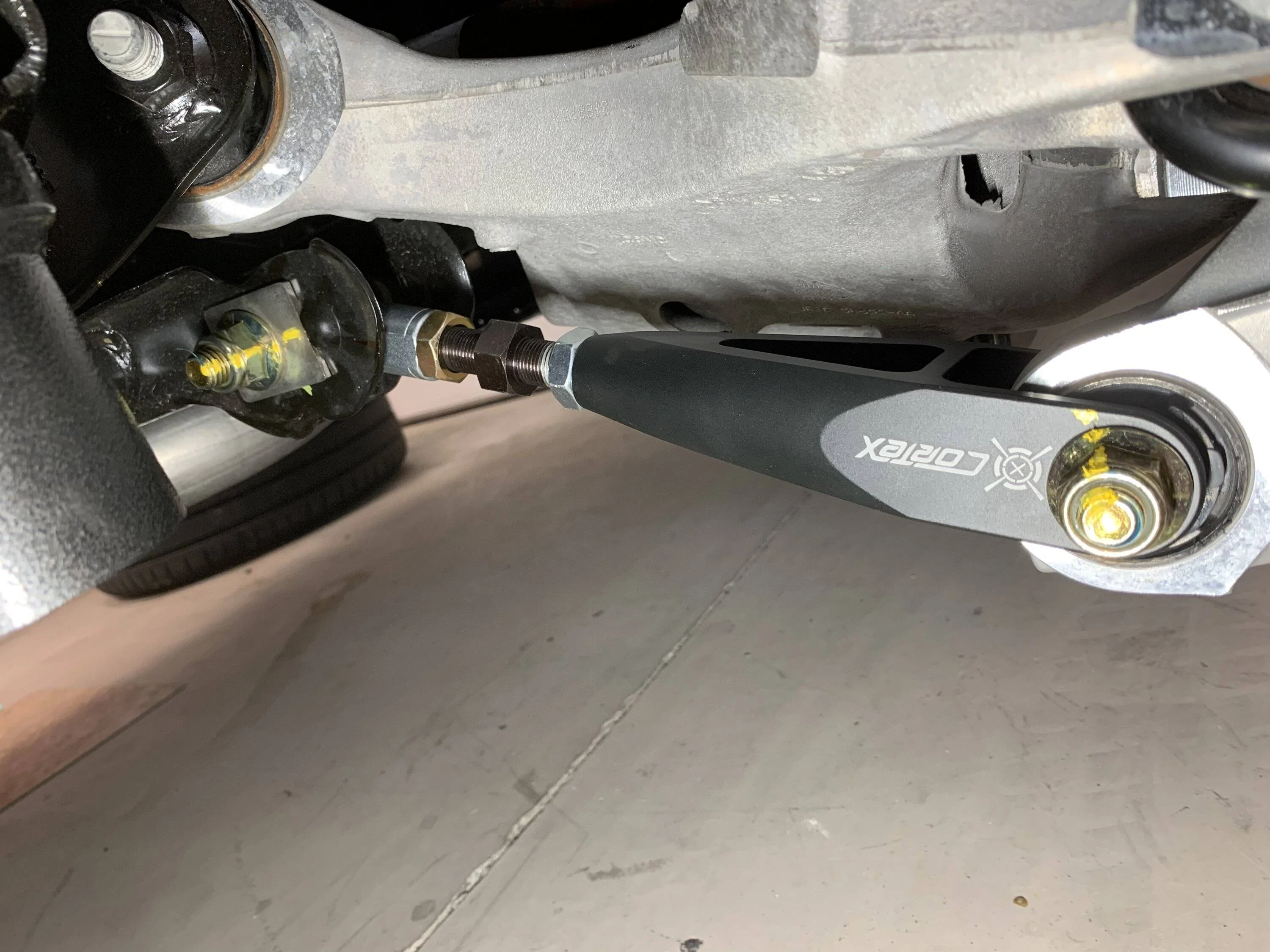

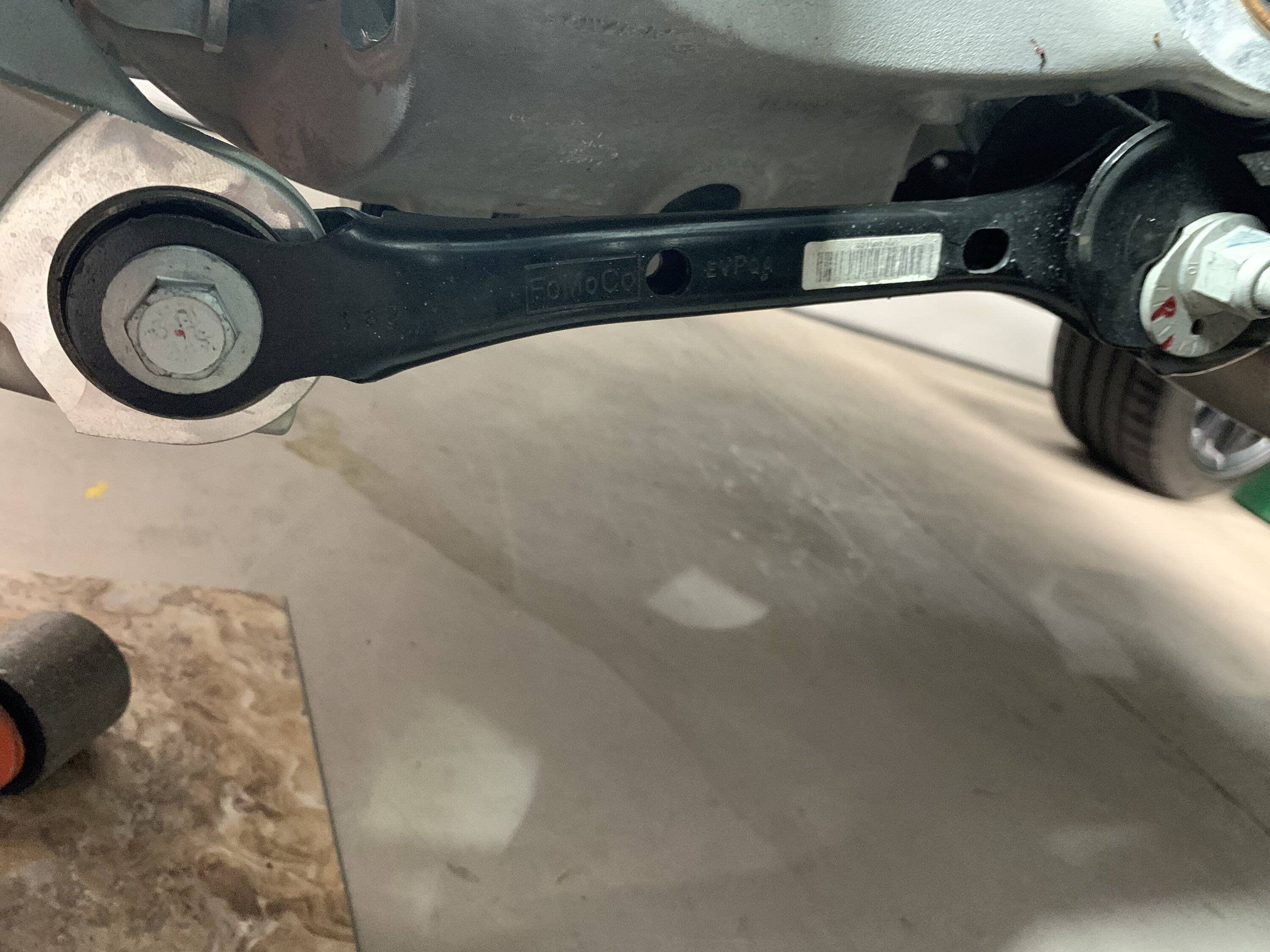

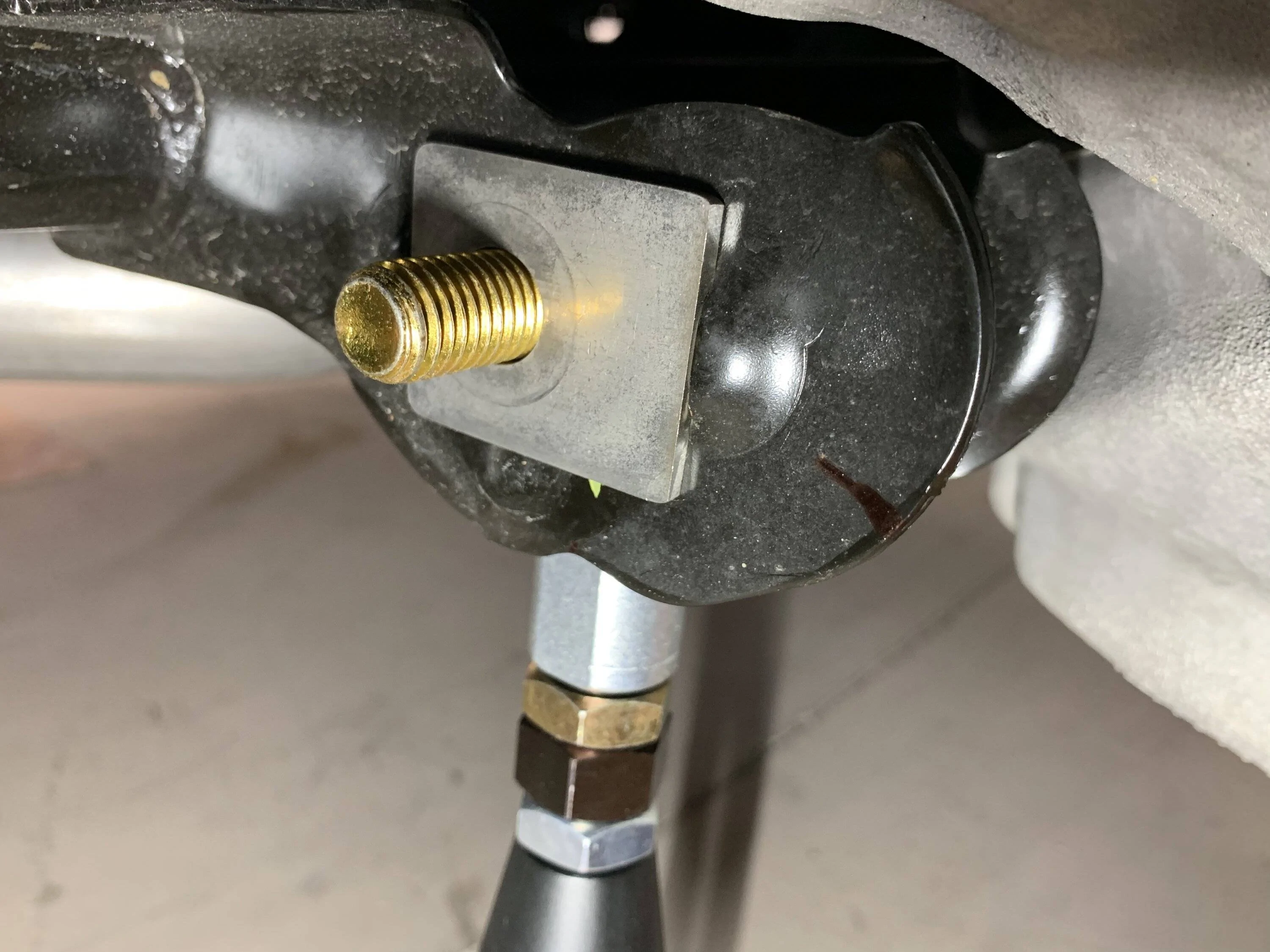

Cortex Toe Links installed today in prep for tomorrows alignment. Had I better researched I would’ve installed the Ford spherical bearings on the knuckle, I didn’t realize the cars had rubber bushing in this location. I used the supplied shim to account with the width difference. I’m dropping the car off for its alignment tomorrow-and also asking if they can reseat the passenger front dustboot retainer/dust seal I evidently knocked off when doing the springs. Doh!
