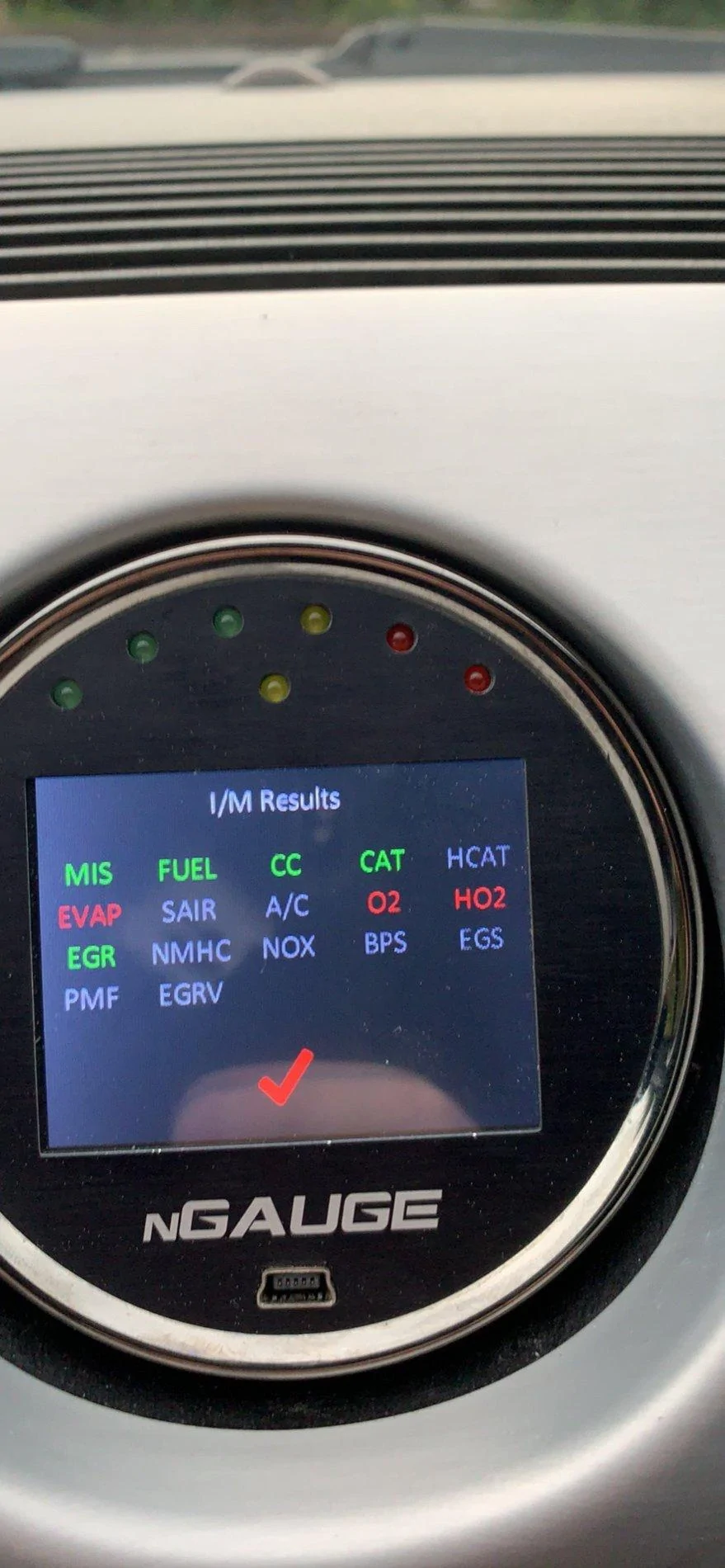

So I've got the second revision now that I'm running on and my CAT is now green from a 15 mile drive to work. Fueling is much closer or close enough to where it needs it to be to set according to Jon Jr. I need to get a few more miles on the car and I think I will be full green. The aftermarket mods throw off the values and those are what have to be tweaked in order to meet the ready status.
It is definitely the tune and your fueling has to be spot on for the monitors to be good it seems. I will report back when I'm all green. I'm also NOT running O2 spacers currently.

Yeah, that's what it's going to take to get things to go green. Spacers are one thing if you're running catless, but the fueling has to be just right for everything to work. You look at other threads of people posting about this issue and they go to another tuner then magically everything is working at that point. It's a matter of the tuner working with you and your mods to get the values where they need to be in order for you to pass. Of course it's not their responsibility for you to pass emissions but it is possible for them to get the values right through some logging.

I passed with that tune. It took a good while to get all of the IM monitors to go green though. I think the EVAP and O2 ones were taking the longest and then one day i just gave it 2 good revs to like 7k and it put them to green. Use the IM monitor on the ngauge to verify that the things being monitored are A) ON and B) Green.
From my understanding:
Green = Good
Red = Not Good
Gray = Not on
For reference I had long tubes w/high flow cats

I just threw a P0420 code finally for cat inefficiency.

The last 3 times my monitors have set, CAT has always gone green.
I'm down to the O2/HO2 going green now. P0420 code was disabled so I'm trying to get them set again. Not sure if I need to try a very specific O2 spacer like the angled Big Daddy's or the Vibrant J style ones to pull the O2's out of the flow.

Try driving about 40 mph for 5-6 minutes straight. Mine look just like yours now, but my EVAP is green. I have catted pipes.
Next option is O2 spacers to pull them out of the direct flow. I think I will grab the Big Daddy's angled ones if I can't get them without them. You may need them since you're catless. Your rear O2's are seeing the same flow as your fronts which normally triggers a CEL, but he probably disabled the codes.

Update: O2/HO2 are still red. P0420 code is disabled in the current tune so I'm not sure if that's messing with the ability for them to go green or not. I also just filled up my gas tank again yesterday.
Purchased Vibrant J-Style spacers. I will install those tomorrow with the small insert when they arrive and flash back to my previous tune with the P0420 code turned back on while on spacers and do more testing.

Your fuel trims probably need to be a bit tighter in your tune then if your CAT is still red. That's the biggest change I noticed right away when I talked to Lund and did 2 data logs and had revisions sent.
