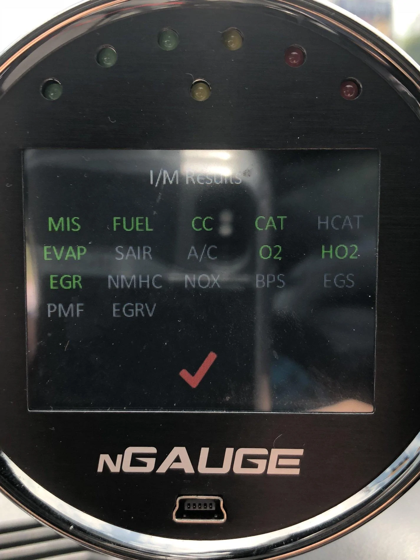

Sorry for reviving a dead thread but I just loaded my emissions tune from Lund and had all the monitors set in about 20 mins of driving. Mods jlt intake,18 manifold lu47s corsa cat back, stock cats.
Same here lol, sorry for reviving this dying thread. I have the exact same mods and I received the Lund tune emissions file and loaded it and the car just wants to continually die unless I give it gas. Not to mention the IM monitors never fully come on regardless of how much driving I do, I also get many DTC errors...so odd

I'd love to see someone who got everything to go green that has long tube headers. That's the struggle currently.
