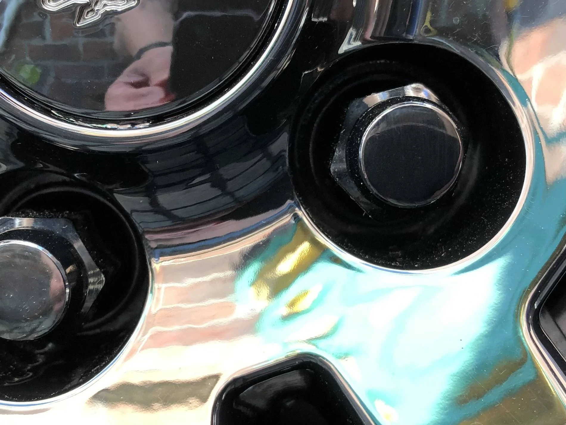

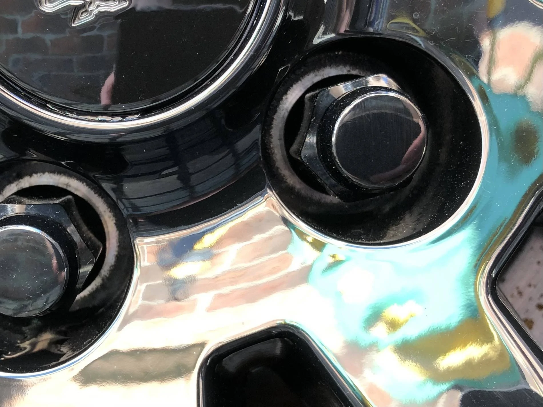

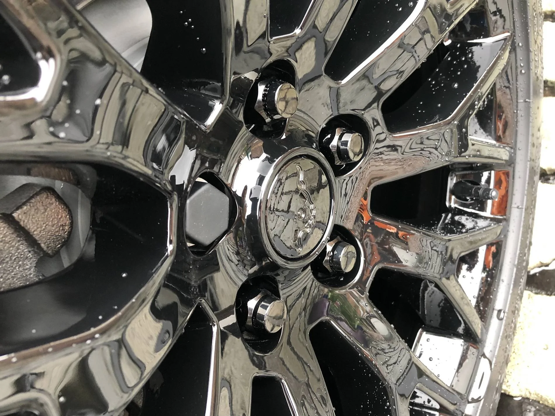

Sorry I hit the reply button before typing, but I bought the McGard nuts and had them on a previous high performance Gt Falcon and the finish and fit is very good. You will, if you are prepared to get down on your knees, see a small fraction of the silver on the rim but to be honest it's unnoticeable from any other perspective, and in any case even when you can see it this does not look out of place.
The quality of the McGards is second to none and I highly doubt you would be disappointed.
I remembered your post and manged to find it :like:
The silver rings (if your interested enough to get down on your knees and look directly down the lug nut bores lol) :
A quick fix :
24.5mm ID / 3mm section EPDM O rings :like:
I really like the quality of the McGard nuts and the finish is supposedly tougher / more corrosion resistant than the Gorilla's - time will tell :like:
