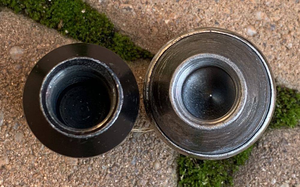

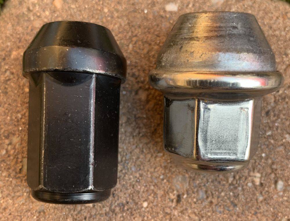

I ordered a set of black lug nuts, which were supposed to be compatible to 2019 Mustangs, so I assumed they should work on 2020 as well. But I guess Ford changed the design in 2020, because here's how they look versus my OEM ones:
Left: new nut (2019-compatible). Right: OEM nut (2020)
The thread is the same, the angle of the cone is the same, the overall length doesn't bother me, but what really worries me is the height of the cone. It's obvious that the OEM nut has a bigger contact surface.
So, I guess they wouldn't be safe to use with my wheels, would they?

NightmareMoon
Nov 22, 2015
7,200
6,500
Austin
2016 Mustang GT PP w/ Voodoo
I would say those black lugs are more meant for aftermarket wheels with smaller lug holes where the OEM lug nut is too large to fit.
^ this. Many (most?) aftermarket wheels have narrower lug nut holes and cone seats.
Gorilla makes some full size black replacements which are really good quality. I wouldn’t use the narrower ones on stock wheels except in a pinch.

That makes sense. Indeed, if I read Steeda's description more carefully, they actually mention that the slim design is aimed at aftermarket wheels.
Slim design. No more scratching your wheels or damaging the finish of aftermarket wheels when installing or removing lug nuts. The small diameter lug nuts provide added clearance between the wheel and the socket to ensure that your wheels stay looking like new. Some aftermarket wheels require the small diameter lug nuts for proper fitment.
OK, that's settled then. I won't use them.

But that does beg the question: why is the smaller contact surface safe with aftermarket wheels? Why do OEM wheels need fatter lug nuts?
They should be fine with your OEM (if im not mistaken, idk never used the OEM wheels.)
It doesnt state they are ONLY safe for aftermarket, it means that aftermarket requires that style in order for the lug nut to fit/not damage wheel while torquing it.

Probably because of the amount of power that the cars have? I don’t know. More surface area holding down the wheels maybe?
You’d think they go for a bigger spacing instead of 5x114.3. I know most Hondas are 5x114.3 yet the Civic Type R is 5x120. Would be interested to know Honda’s reasoning towards that.
Reasoning is re-using Acura NSX parts. LOL.
Wheel is held up by clamp and friction against the hub. Surface contact area on the lug doesn't matter that much as long as it is sufficient enough to transfer the clamp of the joint into the wheel without yielding / surface cracking. Those lugs are fine.

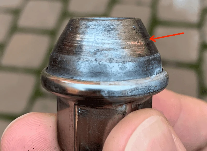

In the meantime I did some reading. Apparently there's a name for those fat lug nuts: they're called bulge nuts, or nuts with a bulged cone. And the purpose of bulged cone lug nuts seems to be just aesthetical, namely to fill the bigger holes of OEM wheels better from a visual point of view. In fact, they do not contact the wheel on the entire surface of the cone, as I first thought. Indeed, if I look at the OEM lug nuts I can see a clear line where they actually press on the edge of the hole:
Only the tip of the cone, from that line upwards, is actually in contact with the inner wall of the hole in the rim. And that tip is the exact same size as the entire cone of the non-bulged lug nuts.
So I think I was worrying for nothing. I decided to install them after all.
