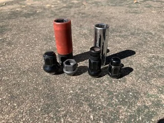

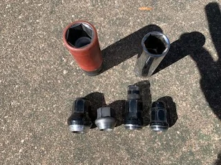

Some lug nuts.....
Gorilla large 61148CX - 1.2" wide, 21mm socket - bought these to replace the poor factory lugs on stock wheels.
Ford Performance open-ended - 1.05" wide, 21mm socket
Gorilla small extended 45048BC - 0.935" wide, 19mm socket 'forged steel'
Gorilla small 41148BC - 0.87" wide, 19mm socket. 'black chrome' marked HT for heat treated. Good stuff and my go-to lug for small seat aftermarket wheels.
This 19mm socket is 1.02" diameter, the 21mm socket pictured is 1.22" at the rubber.
These have been used a lot. especially those small closed gorillas, so they show a little wear and minor chipping on the corners. None of it is really visible when they're on the car and IMHO should be expected for as much as I use and abuse them.
Its worth noting that for the Gorilla part numbers 91148BC are 'bulk where 91147BC would be sold in a plastic clamshell set. and 91147BCB would be sold in a bag.

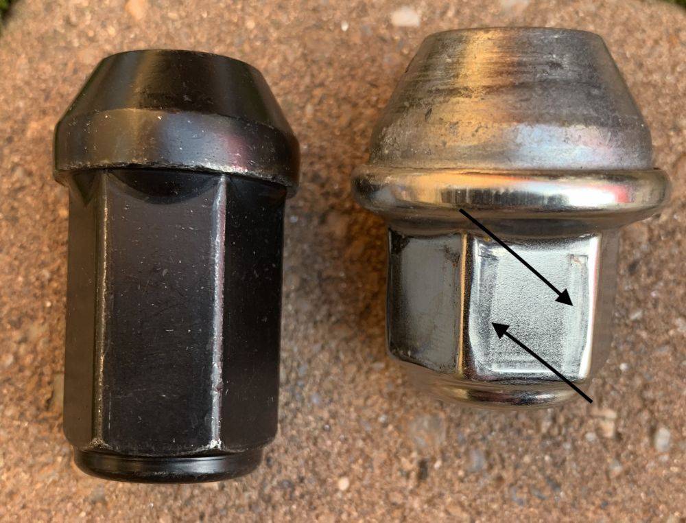

Question, did you ever use an impact to remove the wheel in the past?
Here is the reason for the question, you can see the damage caused by an impact. Look closely and you can also see it was removed and installed with one. Top arrow install, bottom removal.
Further more 13/16th and 22mm are real close, it's possible the user, had the wrong socket. Not to blame the OP, but shops/dealers are loaded with half wits, that don't give a damn.
While on this rant, the use of an impact can be controlled and not damage the lug. What did I say, yes instead of using the impact like a jack hammer, short trigger burst will knock the nut loose
As to replacing, lower the air pressure or lower the impact toque. So the nut is just snug, use a ratchet if unsure. Then lower the car almost, so as the tire will not turn when final turque is applied.
Just saying
